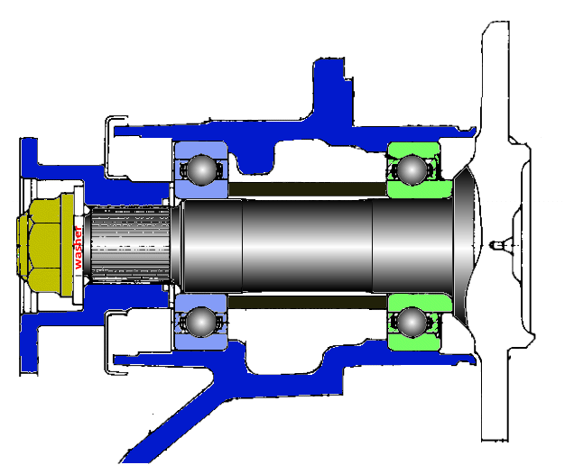

February 10, 20187 yr comment_541943 On 2/8/2018 at 2:56 PM, 240260280 said: When I look at this picture from Blue, there seems to be a washer under the inner hub piece against the inner bearing(shown as white piece on left of lt. blue part). Is that in place? If you left it out it's gonna be too short. Link to comment https://www.classiczcars.com/forums/topic/59500-rear-wheel-bearing-install-issue/?&page=4#findComment-541943 Share on other sites More sharing options...
February 10, 20187 yr Author comment_541945 Yep the stun axle is facing the right way. I’ll take a quick pic of how it’s installed. I just bought a caliper gauge that I will try to measure the races and see if they are within spec. The weird thing is that both driver and passenger bearingings bind or get stuck as I tighten the axle nut so don’t believe there’s anything wrong with the bearing housing themselves. Last thing I think that maybe incorrect are the inner bearings which I think will have to come out for inspection. Really lost at this point. Might even go as far as posting a video just so you all have a better idea what’s going on. Also the washer is for sure used with the axle nut. Link to comment https://www.classiczcars.com/forums/topic/59500-rear-wheel-bearing-install-issue/?&page=4#findComment-541945 Share on other sites More sharing options...
February 10, 20187 yr comment_541947 Could be that the axle and/or bearing removal procedure caused a problem. Bent something maybe. Did you use a slide hammer or a lever it out with a pry bar.? Maybe everything is right but you just have a small bent area. A ding. When looking at Blue's pictures study the blue part and the black "distance" piece. The purpose of the distance piece is to hold the inner race at about the same distance as the outer race. The chart in the FSM shows that they calculated a 0.001 to 0.002" preload offset. That's small. But there's a "huge" overlap of tolerances, so it almost doesn't matter. It's weird, not even attributable to translation error, that the numbers don't just match, or they just say that one can't be more than xxx thousandths bigger/smaller than the other. Basically they just want the inner race and the outer race to be on the same plane, within a few thousandths. I also just noticed that they typo'ed a 6 for a 5. Link to comment https://www.classiczcars.com/forums/topic/59500-rear-wheel-bearing-install-issue/?&page=4#findComment-541947 Share on other sites More sharing options...
February 10, 20187 yr comment_541960 11 hours ago, fairladyz432 said: Also the washer is for sure used with the axle nut. I am not referring to the washer under the axle nut that is labeled in red. I am talking about the white space near the end of the splines and the light blue bearing. It looks like a washer draw in section Link to comment https://www.classiczcars.com/forums/topic/59500-rear-wheel-bearing-install-issue/?&page=4#findComment-541960 Share on other sites More sharing options...
February 10, 20187 yr comment_541966 The white washer in the picture is the noise reducing copper washer used in the 240's and later dropped on the larger/thicker splined 280 axles. None of the washers has any effect on the bearing position once tightened. Link to comment https://www.classiczcars.com/forums/topic/59500-rear-wheel-bearing-install-issue/?&page=4#findComment-541966 Share on other sites More sharing options...
