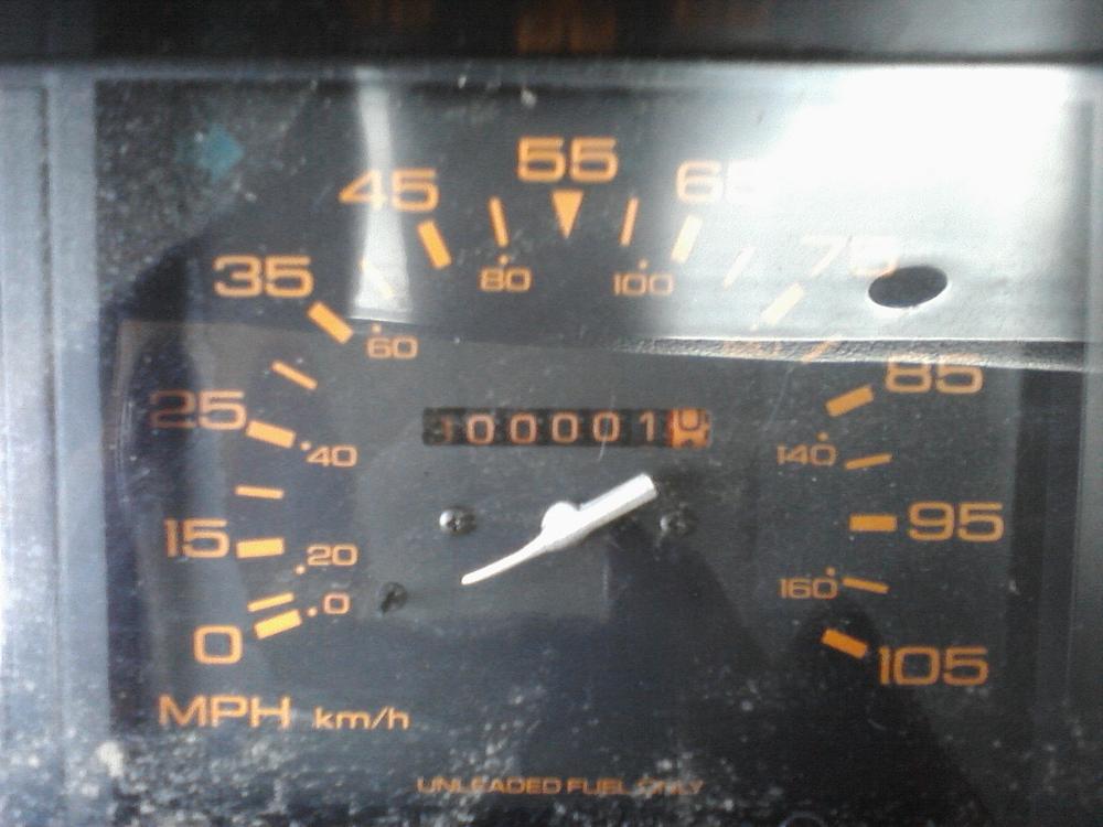

300,001 back in November 2013.  Now it has 350,000 without any major work, clutches spark plugs and oil.
