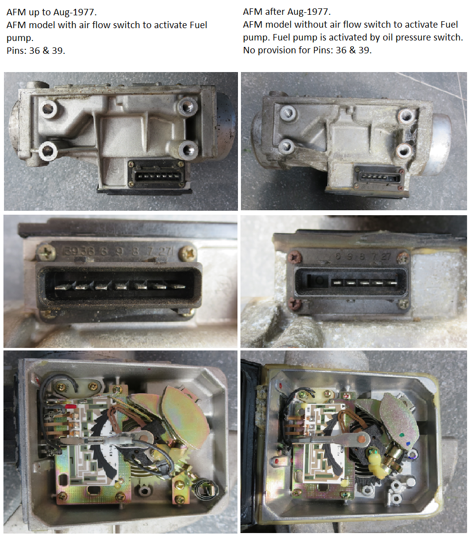

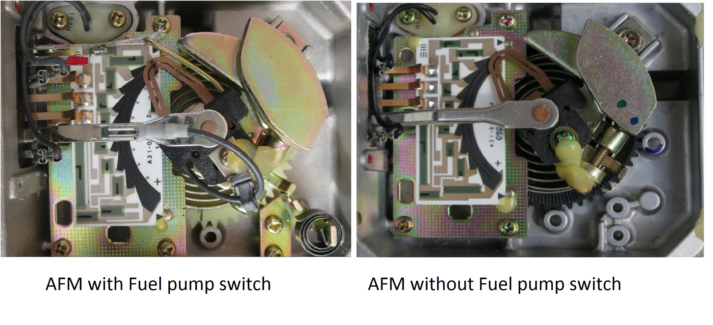

The AFM switch is a common cause. The AFM has a cap with silicone kit. You can gently cut the kit and remove the cap to check the switch. Check the switch adjustment by reaching in from the air filter side and moving the vane or turning it by the counter weight by hand.

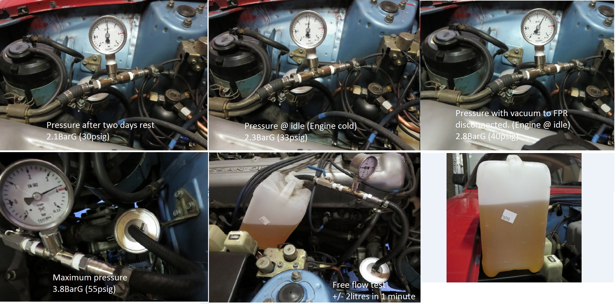

Fuel pressure and pump capacity are also things that can cause your problem. Buy a simple gauge and you can do some symple test to check the pressure and flow. A blocked filter can be so bad, that the car will idle, but the pressure will drop right off when you open the throttle and need more fuel.
The fuel system has infact two filters, one in the pump inlet and the filter at front right side of the engine. See the instruction in the pdf. It is for checking leak down, but the flow test and basic pressure check while running engine is what you need.

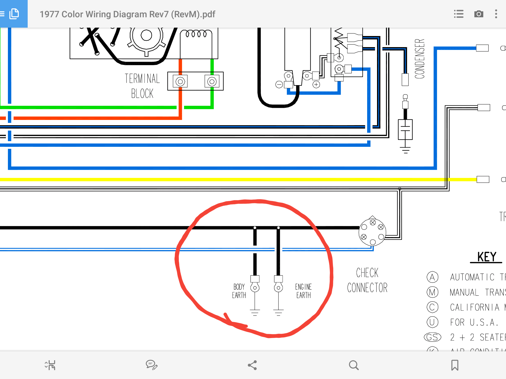

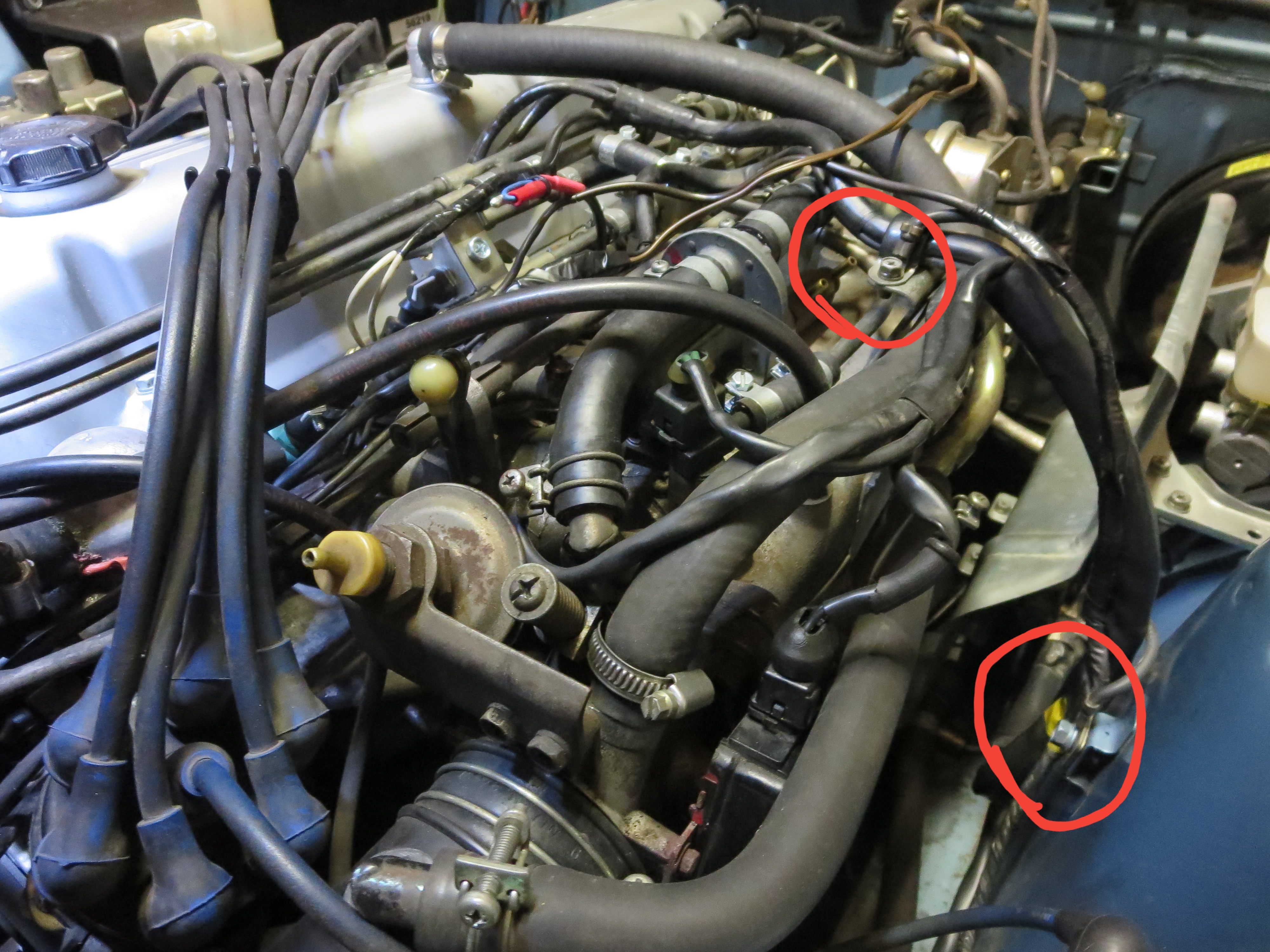

Check the earth terminal on the top of the inlet manifold. It is very important for the EFI. And check where it connects to the body on the side of the strut tower.

the weird thing is that i dont have non of those grounds on my car the two that it shows on the picture and i will see what is happening to my afm

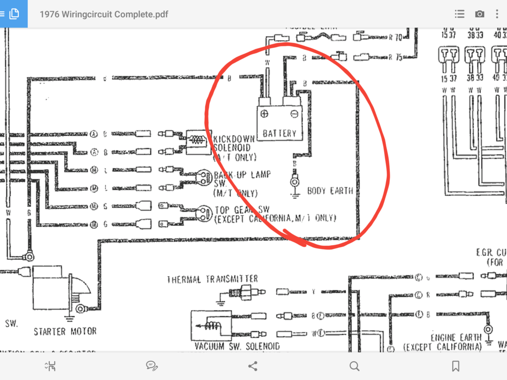

Jesus, When you check the earth wiring, check at the battery as well. The photo I posted is from a 5/77 model. Somewhere in 76 they changed from earthing the body to the battery to the style in the photo. Not sure which month they did it.
Yours might be ok, just located at the battery. If that is the case, check the negative battery post for three cables, the large heavy duty cable for the starter, another cable with a connector (ECU ground) going over the firewall towards the brake booster and one going to the body just behind the battery.
I made a couple of screenshots to show the difference.

If you mean disconecting the 7-Pin plug, then yes it will start, but it will never run more than a couple seconds because the fuel switch is in the AFM.
The fuel pump is activated by the key contact when it is in start position and after that it is operated by the contacts in the afm.

Interesting adjustment method on the 76 model. It uses a screw on the counter weight like the 78 where the 77 has a tab in the housing. Not helping you any, but just interesting to note the small changes.
