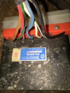

Posted January 16, 20187 yr comment_539952 hello all new here have been having problems ever sense i got the car my first problem was theĀ distributor problems so i swapped that out for a 79 280zx one then swapped out the coil then the car ran more better the problem was that when it got up to temp it will go to a like limp mode it still did that after the new parts so after that i had an idea it was my transistor so i swapped that out for a gm controlĀ module then after that it only runs for a few seconds then shuts off and when i get it to run if i touch the gas it shuts off right away my car is a 1975 280z federal i get spark and fuel i dont know what it can be thanks for the help in advancedĀ Link to comment https://www.classiczcars.com/forums/topic/59384-need-help-car-starts-but-will-turn-off-after-a-few-secs/ Share on other sites More sharing options...
