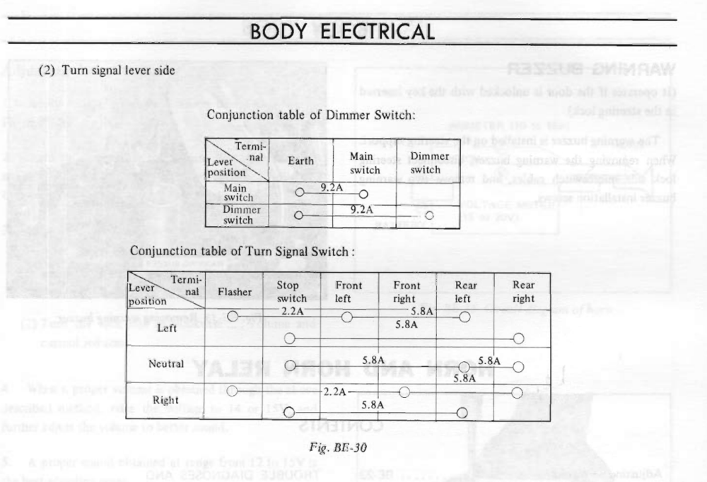

The ground path is in the dimmer switch at the base of the turn signal stalk.  You can take it apart or just spray cleaner in to the internals.  Pretty common for the lights to not work at all because the dimmer switch is gummed up.
There are ground wire connections from the dimmer switch that can be pulled apart and cleaned.
On a 240Z? I am not sure what you mean by “dimmer switch”. You must not mean it in the normal sense I am used to (As in a rheostat for dimming the lights on the dashboard or over the dinner table). Are you referring to a high-low beam switch?

It's always been a dimmer switch to me.  Nissan too...  1972...  How do you do...  My name is Sue...
Dear Sue,
So just to be clear, when I say high/low beam switch and you say “dimmer“. We are talking about the same thing, right?
