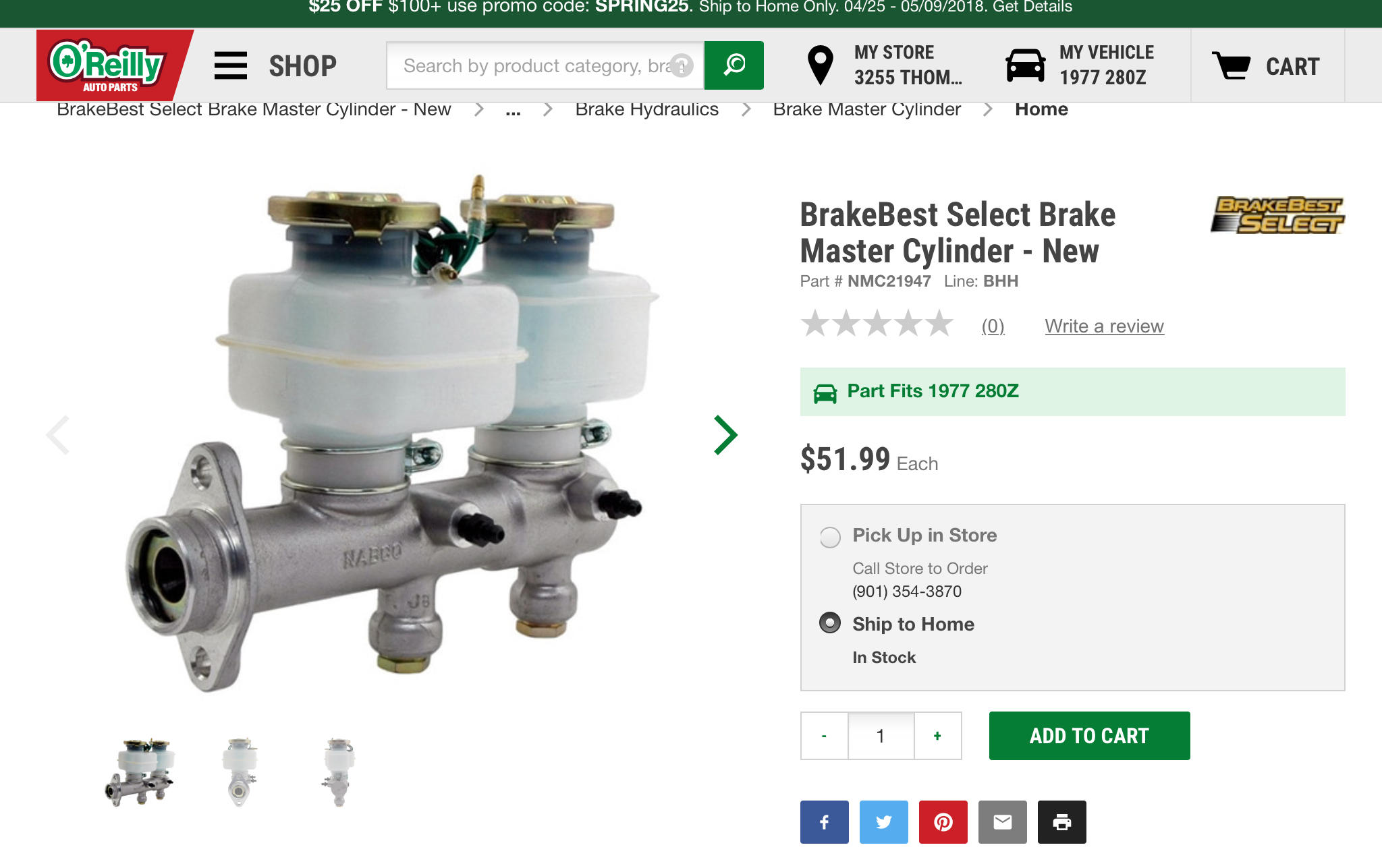

May 7, 20187 yr Author comment_548871 O’reillys has a master cylinder for $52. Its made by Nabco (same co that made my OEM clutch master but is not a Tokico.) An OEM Tokico one is online from $250-$329, not sure if thats worth it. Link to comment https://www.classiczcars.com/forums/topic/59296-bringing-a-1977-z-back-life/?&page=26#findComment-548871 Share on other sites More sharing options...

May 7, 20187 yr comment_548901 7 hours ago, Av8ferg said: O’reillys has a master cylinder for $52. Its made by Nabco (same co that made my OEM clutch master but is not a Tokico.) An OEM Tokico one is online from $250-$329, not sure if thats worth it. Several of us have found that the main problem with the aftermarket or reman hydraulics is that they're dirty inside, with machining swarf/grit left over, that will eat the new seals pretty quickly. Just disassemble and clean them and you'll probably be fine. Link to comment https://www.classiczcars.com/forums/topic/59296-bringing-a-1977-z-back-life/?&page=26#findComment-548901 Share on other sites More sharing options...
