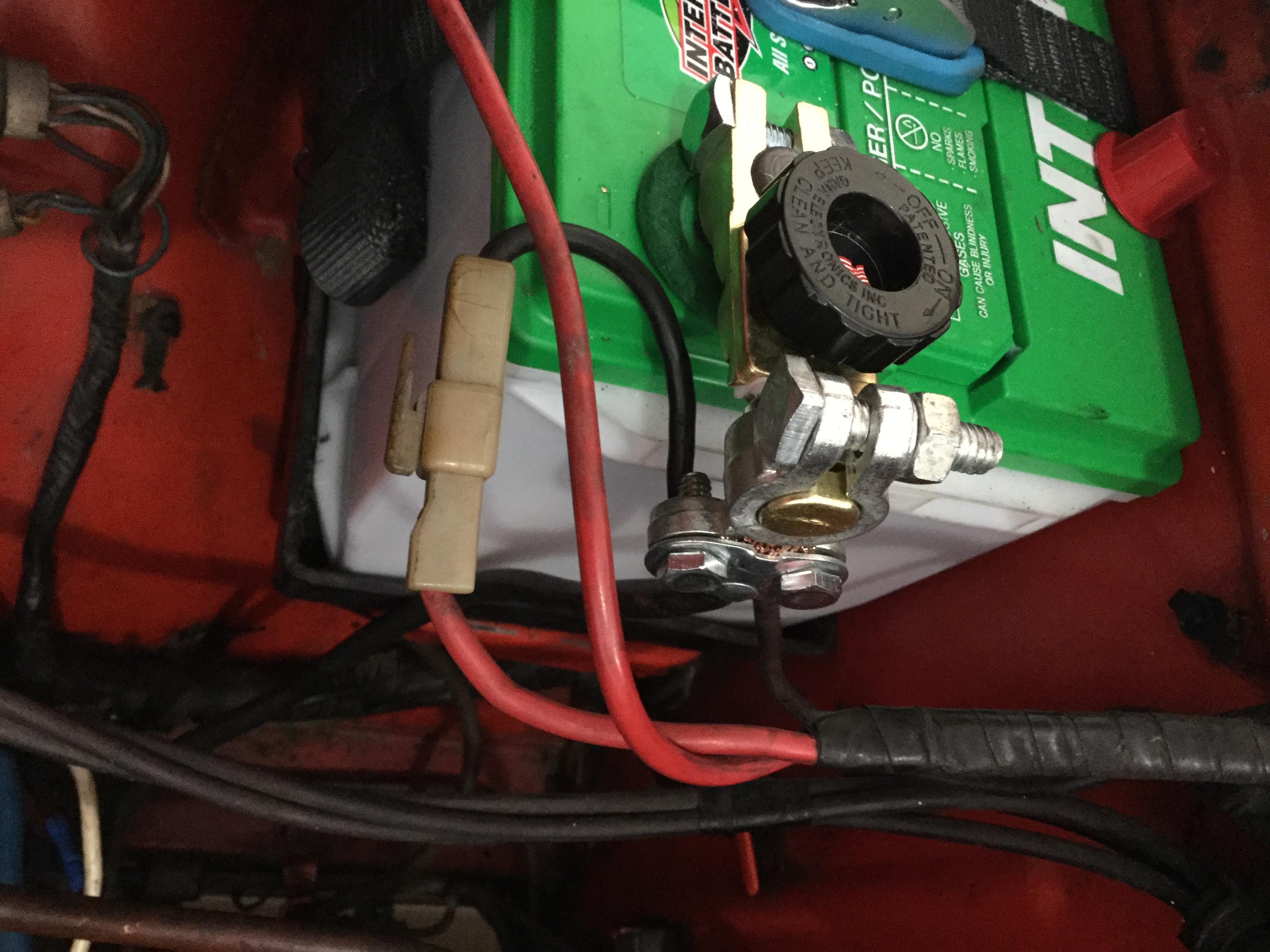

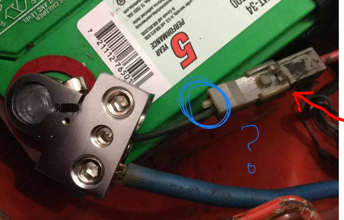

February 22, 20187 yr comment_543025 6 minutes ago, Av8ferg said: On a side not. I discovered I had some battery connection problems. The two red wire coming from the fire wall were both connected to the positive terminal, looking at the cars wiring diagram one is supposed to go to negative and the other the positive. My battery positive side fuse link had on of the two wire cut, I don’t know why there are two small wires from that connection but I connected one back to the positive. Does this look right now? They are not two wire on the fusable link. One is a clear plastic cord so the fusable link will not be stressed when pulled. Looking at the photo, someone cut the plastic cord off when they fitted a new battery terminal. Second, I had trouble in the begining when I looked at the two wires going to the ECU. Both red doesn't make much sense. You would expecg yhe negative to be black, blue or something other than red. Link to comment https://www.classiczcars.com/forums/topic/59296-bringing-a-1977-z-back-life/?&page=13#findComment-543025 Share on other sites More sharing options...
February 22, 20187 yr comment_543026 Btw. The fusable link is still intact, although it looks like it is a little shorter. Looks like it has been cut and reconnected to the new battery terminal. Link to comment https://www.classiczcars.com/forums/topic/59296-bringing-a-1977-z-back-life/?&page=13#findComment-543026 Share on other sites More sharing options...
February 22, 20187 yr comment_543028 how did you determine which red wire from the harness went to which battery terminal? Link to comment https://www.classiczcars.com/forums/topic/59296-bringing-a-1977-z-back-life/?&page=13#findComment-543028 Share on other sites More sharing options...

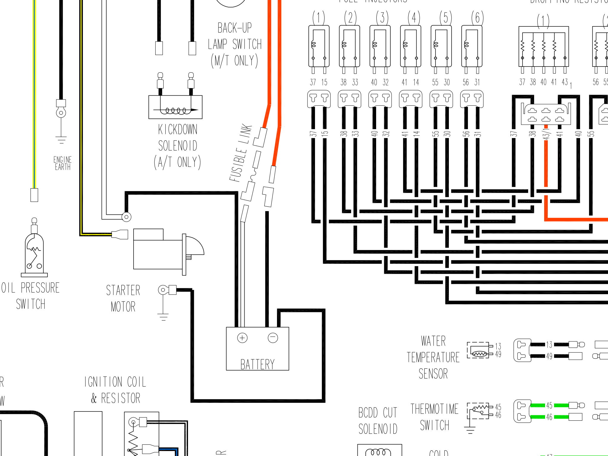

February 22, 20187 yr Author comment_543029 Dave, I referenced the 1977 wiring diagram in the attached photo. It shows the one with a male connection off of the harness going to negative terminal and the one with the female connection going to the positive. Also the one with the fuse link apprears to be on the positive side. I cannot connect it to the other because it would be male on male.....? Link to comment https://www.classiczcars.com/forums/topic/59296-bringing-a-1977-z-back-life/?&page=13#findComment-543029 Share on other sites More sharing options...

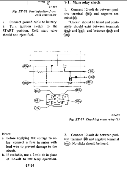

February 22, 20187 yr comment_543030 48 minutes ago, Av8ferg said: I just pulled the power relay off.. Is there a way to test this off the car? Here some close ups of it. There is. Copied a snap from the 76 FSM, EF chapter. There's another page of tests after that. Looks pretty brown. They run hot and can burn up after a while. Link to comment https://www.classiczcars.com/forums/topic/59296-bringing-a-1977-z-back-life/?&page=13#findComment-543030 Share on other sites More sharing options...

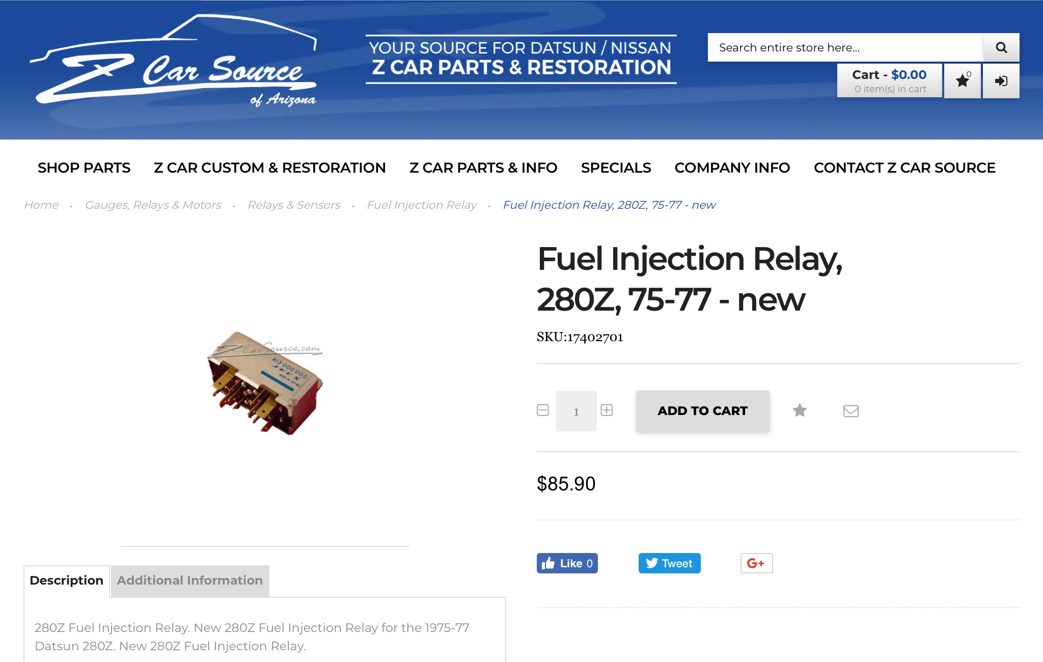

February 22, 20187 yr Author comment_543031 Any votes here that I should buy a new Fuel Injection Power Relay? They’re not cheap. Can only find them on Z Car Source for $85 https://zcarsource.com/fuel-injection-relay-280z-75-77-new Link to comment https://www.classiczcars.com/forums/topic/59296-bringing-a-1977-z-back-life/?&page=13#findComment-543031 Share on other sites More sharing options...
February 22, 20187 yr Author comment_543032 ZH, thanks Ill test it now. ? Link to comment https://www.classiczcars.com/forums/topic/59296-bringing-a-1977-z-back-life/?&page=13#findComment-543032 Share on other sites More sharing options...

February 22, 20187 yr comment_543034 I would test using the diagram above it 1st see if you can figure out what's going on. that being said I guess a spare would not hurt, just remember to test it in the car once you get everything sorted. Link to comment https://www.classiczcars.com/forums/topic/59296-bringing-a-1977-z-back-life/?&page=13#findComment-543034 Share on other sites More sharing options...

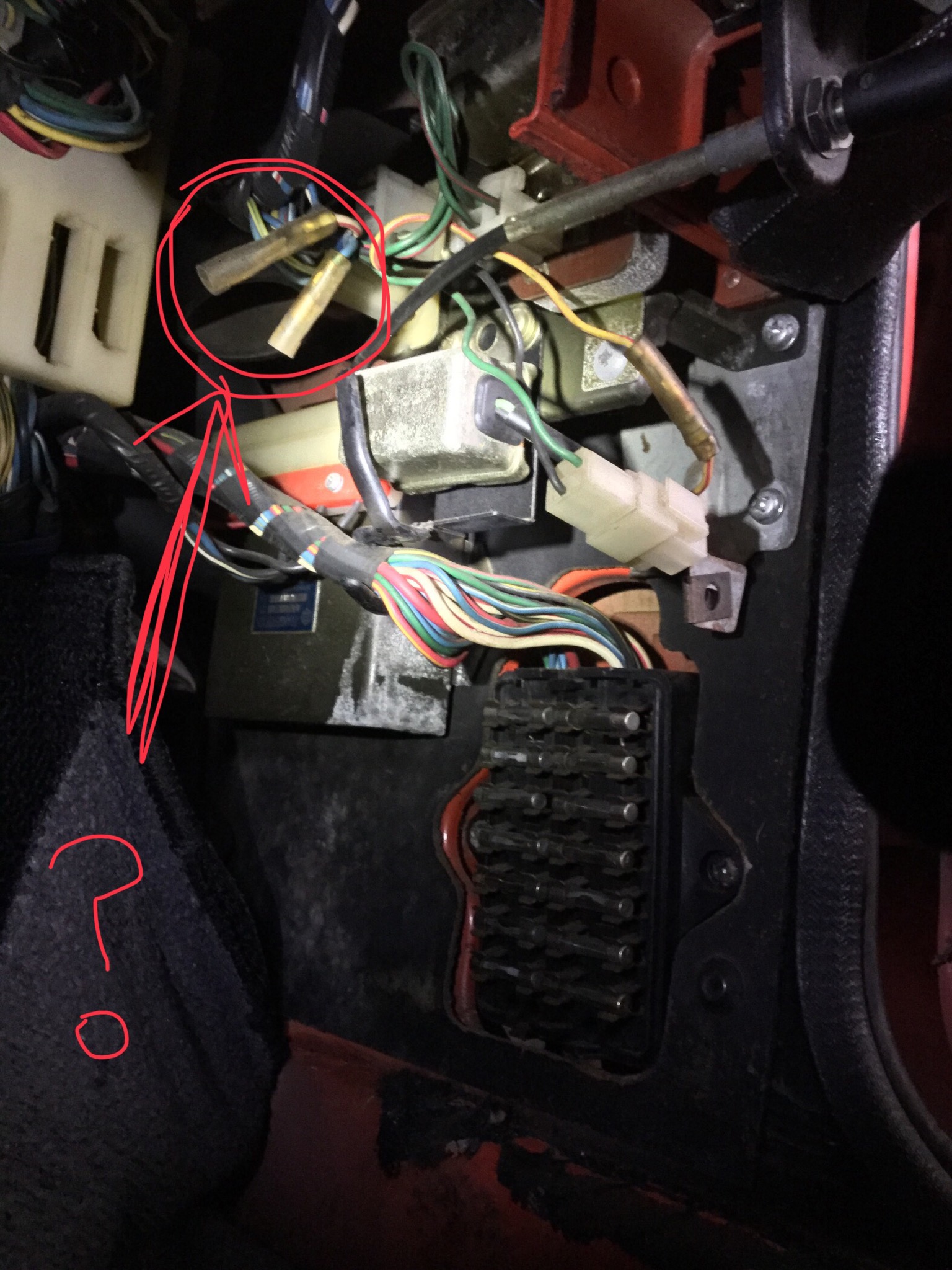

February 22, 20187 yr Author comment_543037 Okay, absorbing all the advice. ZH, tested voltage to the battery fuse link and got 12.7v. Fuel injection power relay tested good right out of the FSM. The bad news is I cracked the board when crimping it back into the metal cover. It’s still tests good but might need replacing now that I have compromised it. I’m going to find the power wire and see if Inget continuity now. While rummaging around looking for wiring problems I found this on the passenger side above the fuse box. Are these two barrel connecteors supposed to be connected to something? Finally can I test power to the injector plugs themselves. I’ve read I should be getting 12v on them, but I’m getting nothing. Disconnected the starter had my assistant turn key to the start position and then tested the voltage from one pin of the injector connector and other to a ground. Nothing.... Link to comment https://www.classiczcars.com/forums/topic/59296-bringing-a-1977-z-back-life/?&page=13#findComment-543037 Share on other sites More sharing options...
