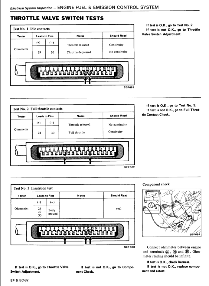

Testing TPS. Continuity checks good at the TPS, Idle and full throttle. but at the ECU plug test as set forth by AFM, I get nothing. PIN's are PIN's correct, I dont need a year specific test for the 82 do I?
Here you said the TVS (not really TPS) is good.  Here's the 82 procedure.  It's on page 82.  Too.
Did the procedure on p.82. For some reason its not testing through the ECU plug. Testing the TVS directly I get continuity on the idle and full open throttle. I do not get a good test on the insulation test. When testing through the ECU plug, do you need a ground jumper?
Thanks.
If the ECU doesn't see it it doesn't count.  Trace the wires from the ECU to the TVS, it's easier than it seems. Most of the engine's electronic components are on sub-harnesses with bullet connectors tying in to the main harness to the ECU.  Maybe yours are disconnected.  "Full throttle" is actually about 75% throttle opening or something like that so it could be a factor.  The ECU adds a lot of extra fuel at "full" throttle.  " "  "  "  "
The ECU plug has its own grounds.  The FSM tests are explicit, nothing needs to be added.  Place the probes and read the meter.
Yeah, disregard, had the TVS disconnected, so.......
Its 25 degrees tonight in N.FLA, been back and forth between fire place and garage, forgot to hook the TVS back up. So at least I dont have to chase wires tonight.
So if the TVS does not pass the insulation test, I'll at least need to replace. Would this cause my issue?
