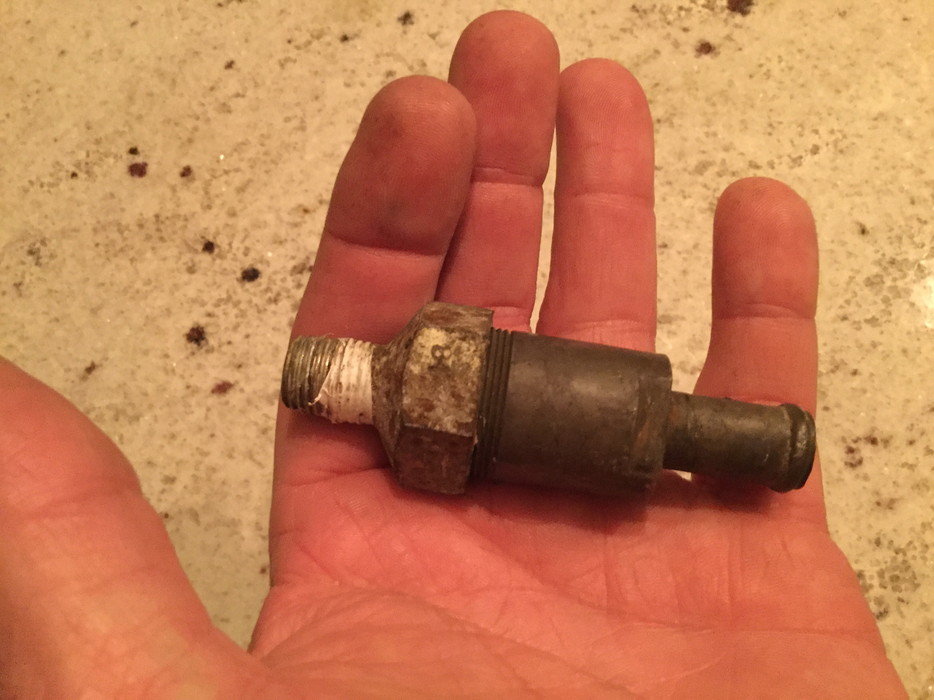

Is this it? I have had it in that draw for so long it's yours free if you wish. No clue if it's any good.

48 minutes ago, Captain Obvious said:
I wouldn't mind opening one of those up and poking around inside
IIRC, it's just a typical spring-loaded, wax-pellet type check valve.  There's a cut-away drawing buried somewhere in the FSM.  While it is possible to screw off the end cap, it doesn't really show you too much of the inner workings (not that there's that ,much to see).  I think I soaked mine in a calcium-rust-lime-remover product overnight and then put it back together.  It worked OK before cleaning, and it worked equally OK after cleaning... so the cleaning was obviously an important step ^_^ .  I suspect that the long-term health of these valves was directly related to whether the car's cooling system was run with plain tap water rather than coolant.

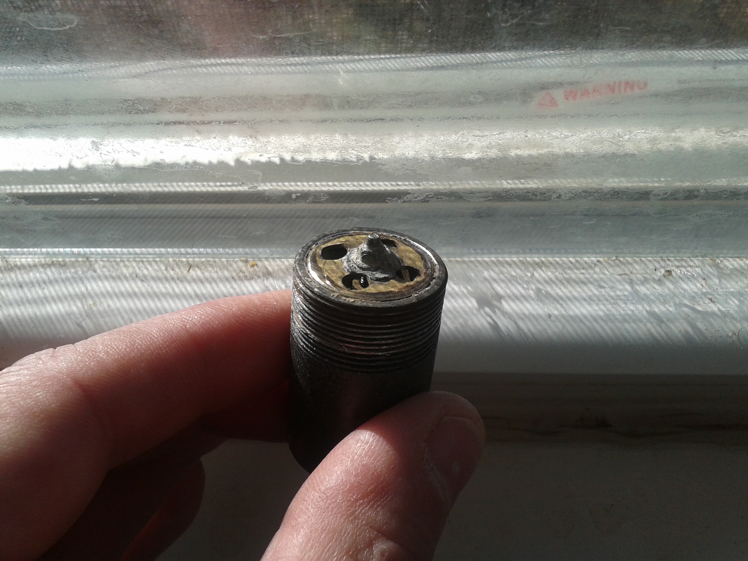

Did you get to the inside?  I can't figure out how to remove the brass part.  I can jab a screwdriver into the inlet and feel  pretty tight spring that is against that brass end.
Maybe I should just donate it to Dr Frunkenstein's layboreatori.

I blow it up on my phone and see that's a small nut on a threaded post under all that crud. I'll wire brush that and see if I can break the nut loose.
