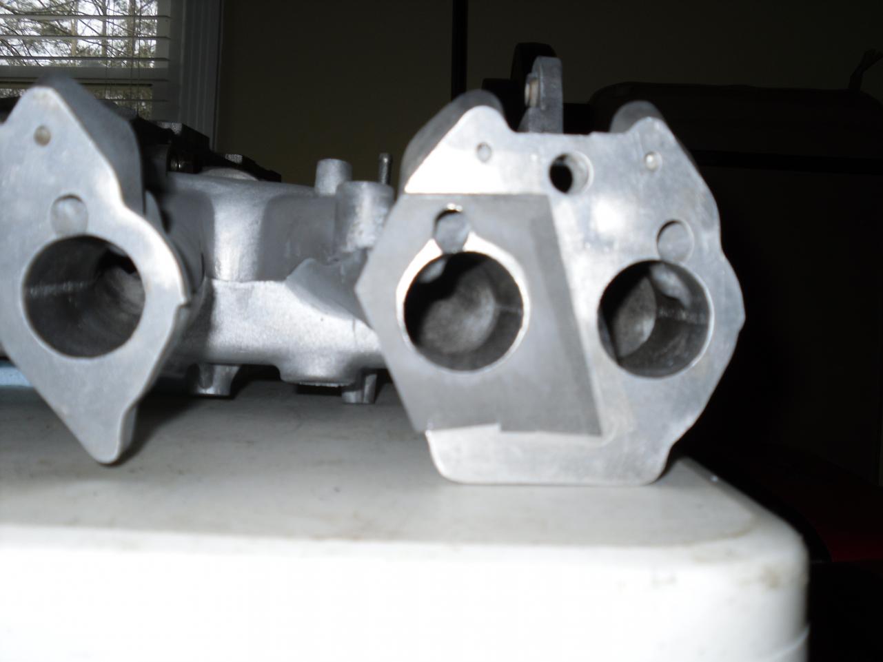

December 2, 20177 yr comment_536440 If you lay a gasket over the intake you'll probably see the intake's holes are smaller. I scribed around mine and used a grinder to match the ports, intake holes are now the same as the cylinder head's holes. While you're there, the slide begins but it's winter and fun if you have the right tools. Here's a shot of my 280's intake, same way on the 240. Link to comment https://www.classiczcars.com/forums/topic/59059-is-removing-the-intake-manifold-risky/?&page=2#findComment-536440 Share on other sites More sharing options...
