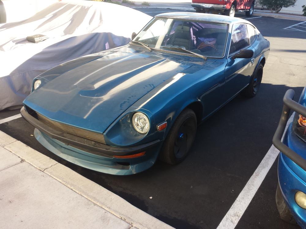

Here is the story...and it's a long one!
I bought this 71 back in the late 80's, I think I paid $1000 for it.
Naturally it had to be hot rodded, the engine and trans(5 speed were swapped from a 77) still got the original engine and trans in good shape), the head was ported and polished, titanium retainers, the cam came from Ed the armenian (rip)
he worked for Smokey Yunick btw, header , dual webers, electronic ignition, ansa exhaust, adjustable Tokicos, suspension techniques springs ...and so on,  You get the pic.
Got married in 91, had a baby and this thing stopped being practical, my younger brother wanted it so I sold it to him (don't remember for how much, not important)
Anyway...he drove it for a couple of years till some kids stole it from his buddies house (how typical), the ignition lock locked up on them and they crashed into a pole, (front right corner), it was taken to a body shop , fixed and painted...all fresh rubber..that was in 94 or 95. he drove it for another year or so, until him and his gf took a weekend trip to Santa Barbara (from Northridge CA), he got 2 speeding tickets over 100 mph, one on the way there, one on the way back....into the garage it went, covered and left for dead.
I been hounding him over the years to do something with it but he is a lazy computer engineer driving some fancy Bimmer....so it sat, in spring of 2016 I get a phone call: come and get it. its yours.
Trailer hitched I head to Socal to pick it up and home it goes, Parked it in a buddies warehouse and started work, drained the gas, changed fluids...changed fuel pump (dead), one accelerator pump was dead....pour fuel...started on the first crank.
since then got a carpet kit, seat skins, fixed the interior, installed aftermarket A/C(not finished yet) rebuilt the carbs (flooded on occasion), tackled the electricals (still moodey)
The day has come to get it out of there (my buddies "request")  so I pulled it out to the parking lot...crap,no starter (moody) jump started it with a screw driver and took it around the block...its drivable, time to take it home.
How was the experience you ask....it's rude its crude it's stiff, steering is hard, getting in and out is a PITA. it hates to be driven civilly. zero sophistication...zero, it stinks of exhaust fumes, it forces one to step on it (and get speeding tickets), pure evil....however, I cannot explain that unwanted grin when pressing down that right foot....it's intoxicating!
Now to the final question: how the hell do you get rid of the exhaust fumes?, all the rubbers are new, including the hatch
Still have work to do... after the drive discovered the the water pump lost the bearing, temp gauge is dead, starter is still temperamental, I suspect the relay, I can hear it click but no starter. Finish the ac, the valves are noisy.. and so on...it never ends.
