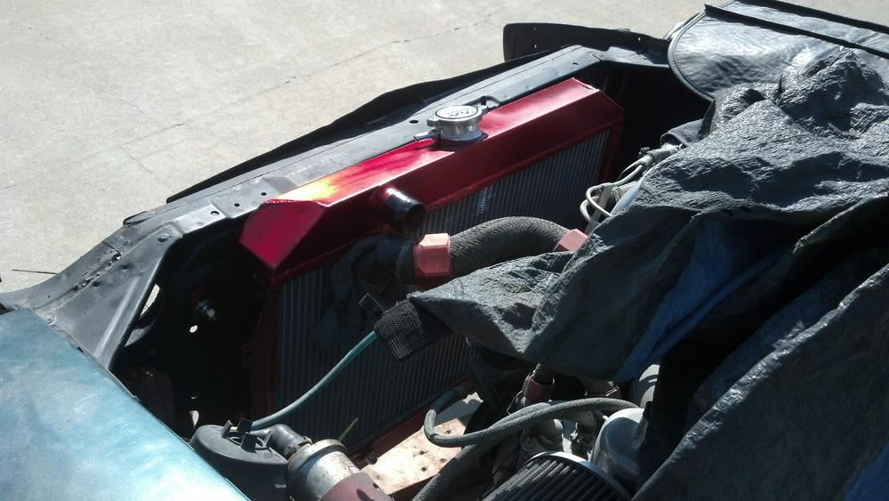

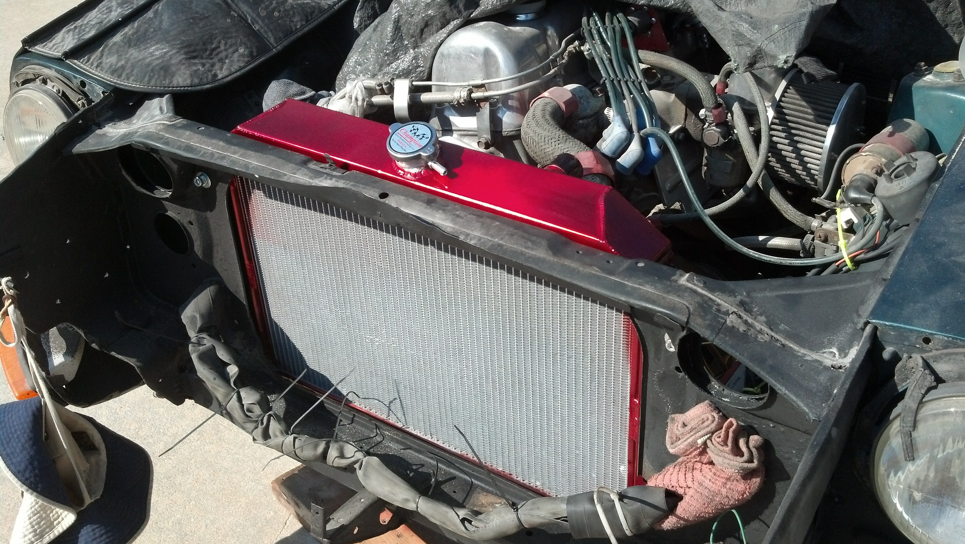

  • I bought a Champion with a desire to convert to electric fans for (A). To take the weight of the fan off the water pump (lost at least ome pump due to the weight of the original metal fan), (B). I have read that it reuslts in a few more horses, (yet to be confirmed). Champions fan attachment is not the best and in addition you have to buy the control circuit seperately. I live on the east coast of central Florida and there are some days when unquestioned cooling is essential. When I get it all installed I will give some first impressions. I painted the tanks on mine just because ...................I'm cool like that! :cool:
