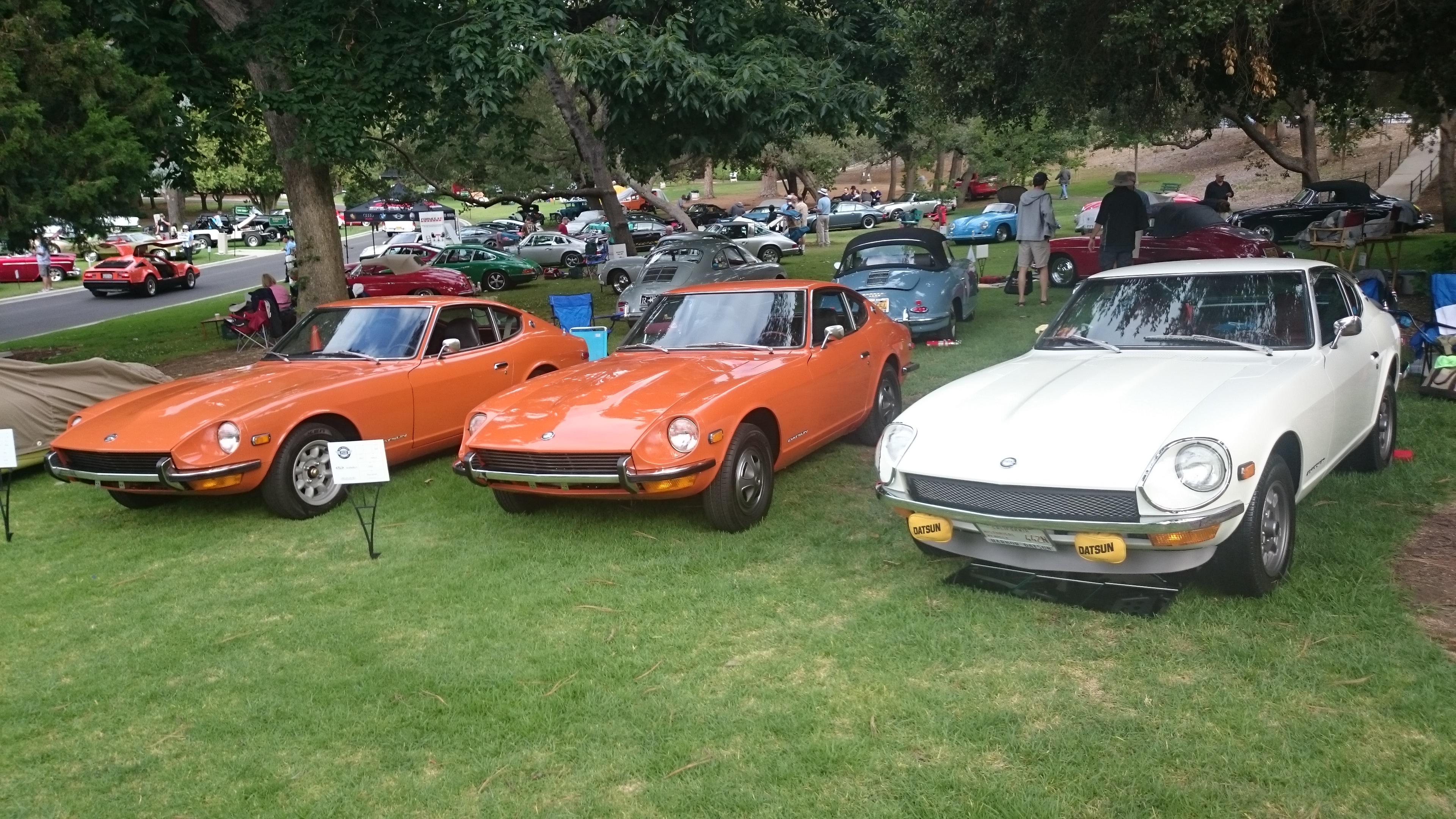

Hard to say which is really better.  I think the single stage has a bit more pop and brightness to it.  Two stage has more of a mirror finish.  Attached is a pic of two orange Z's.  The one in the middle is single stage, left is two stage.
