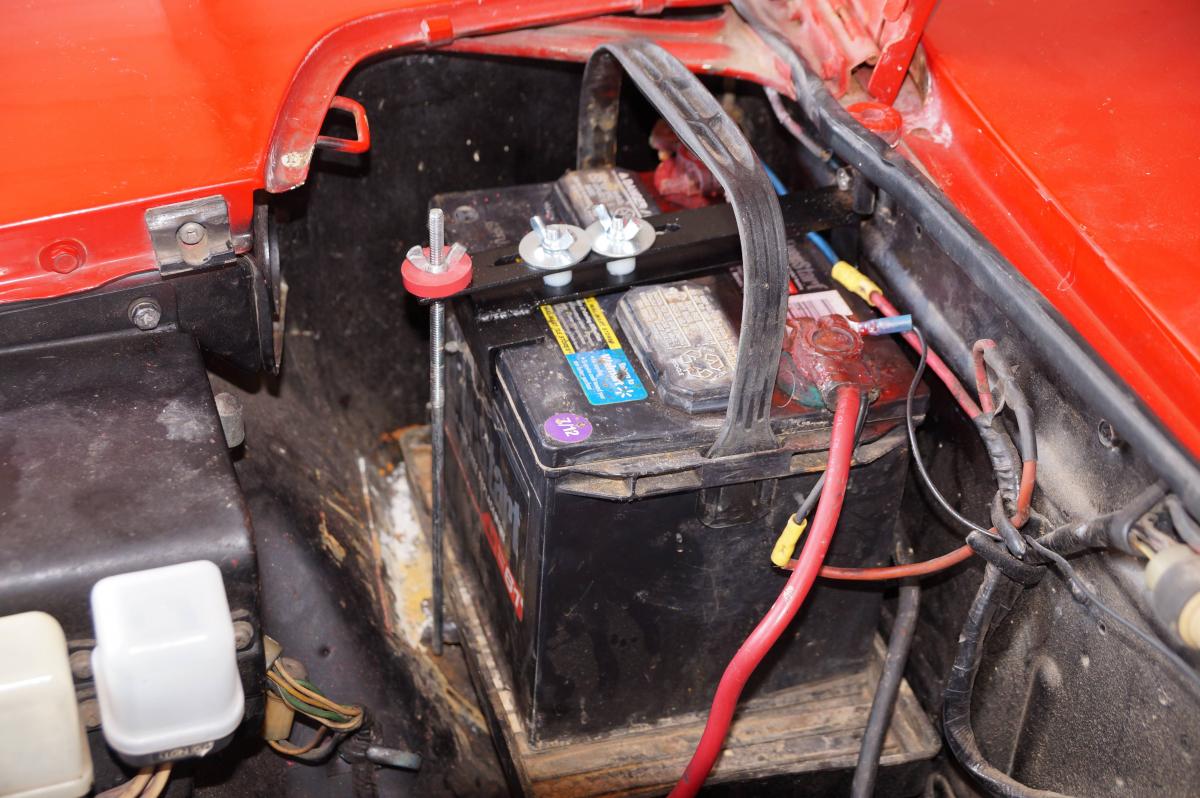

Jai's battery was tied down when I first saw her car, and the battery was smaller than stock. I made a bracket for her that would work on the battery she had, but it could be adjusted later for a stock sized battery.

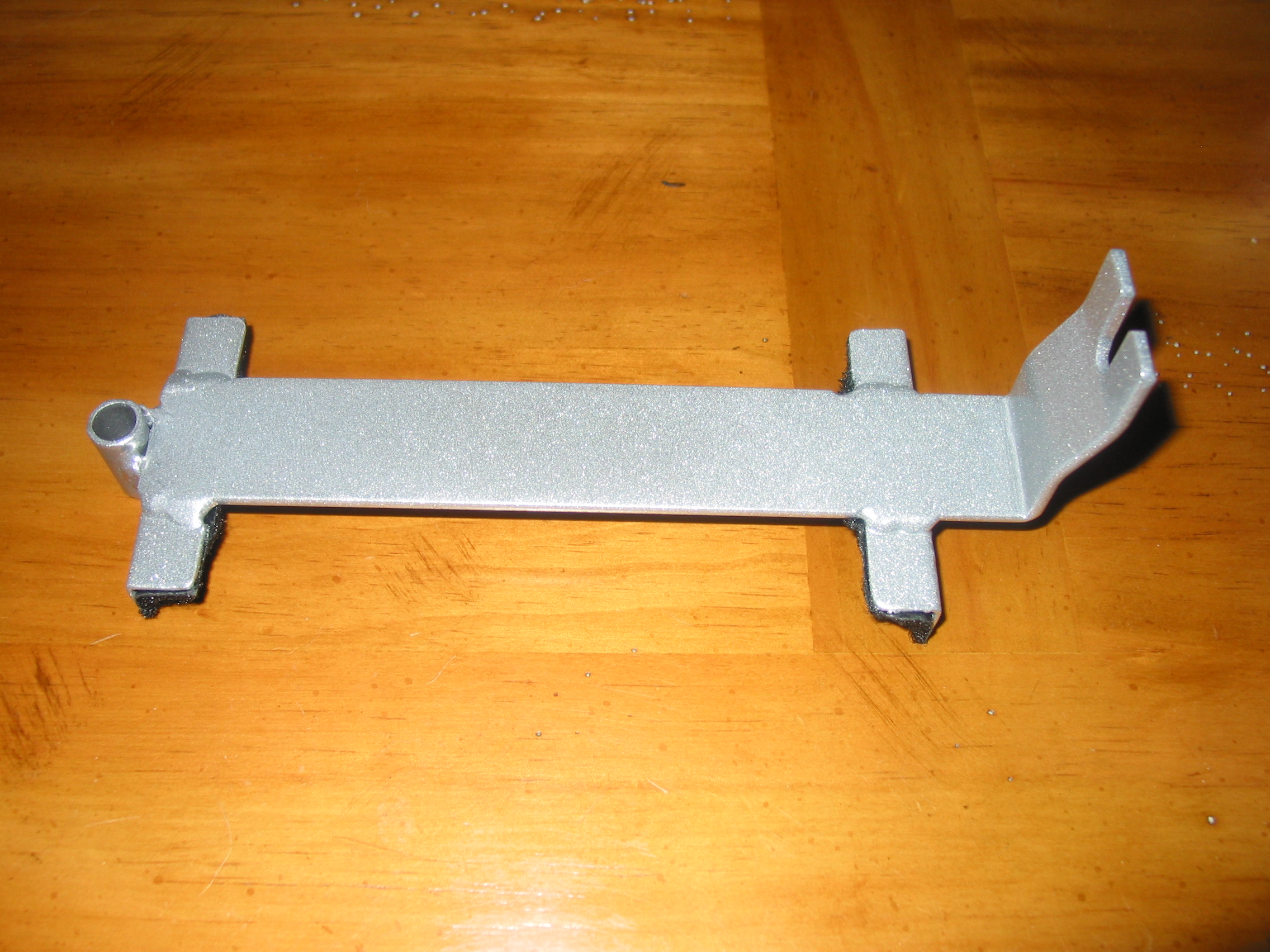

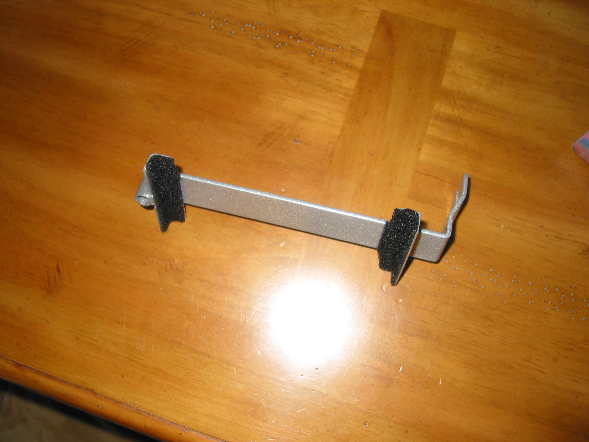

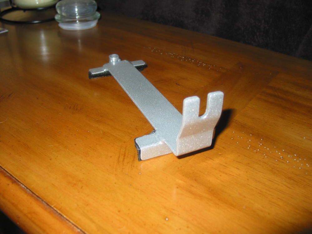

Several years ago, I posted on here the design of an Optima bracket I made.  I have never tried it with a regular battery, but I don't see why it wouldn't work exactly the same with a few simple mods.  It doesn't look stock like yours, but it was pretty simple to make.  I have one in my street car and another in my race car.

The brackets are made from very simple materials I bought at Home Depot and cut/welded together.  I think they took about an hour to make.  I did powder coat the silver one shown.  The previous one was painted in black wrinkle finish.

Jeff, your homemade bracket looks good. I've seen styles like that which are narrow through the center in case it had to fit between raised fill caps. You didn't need to worry about that with the Optima.
