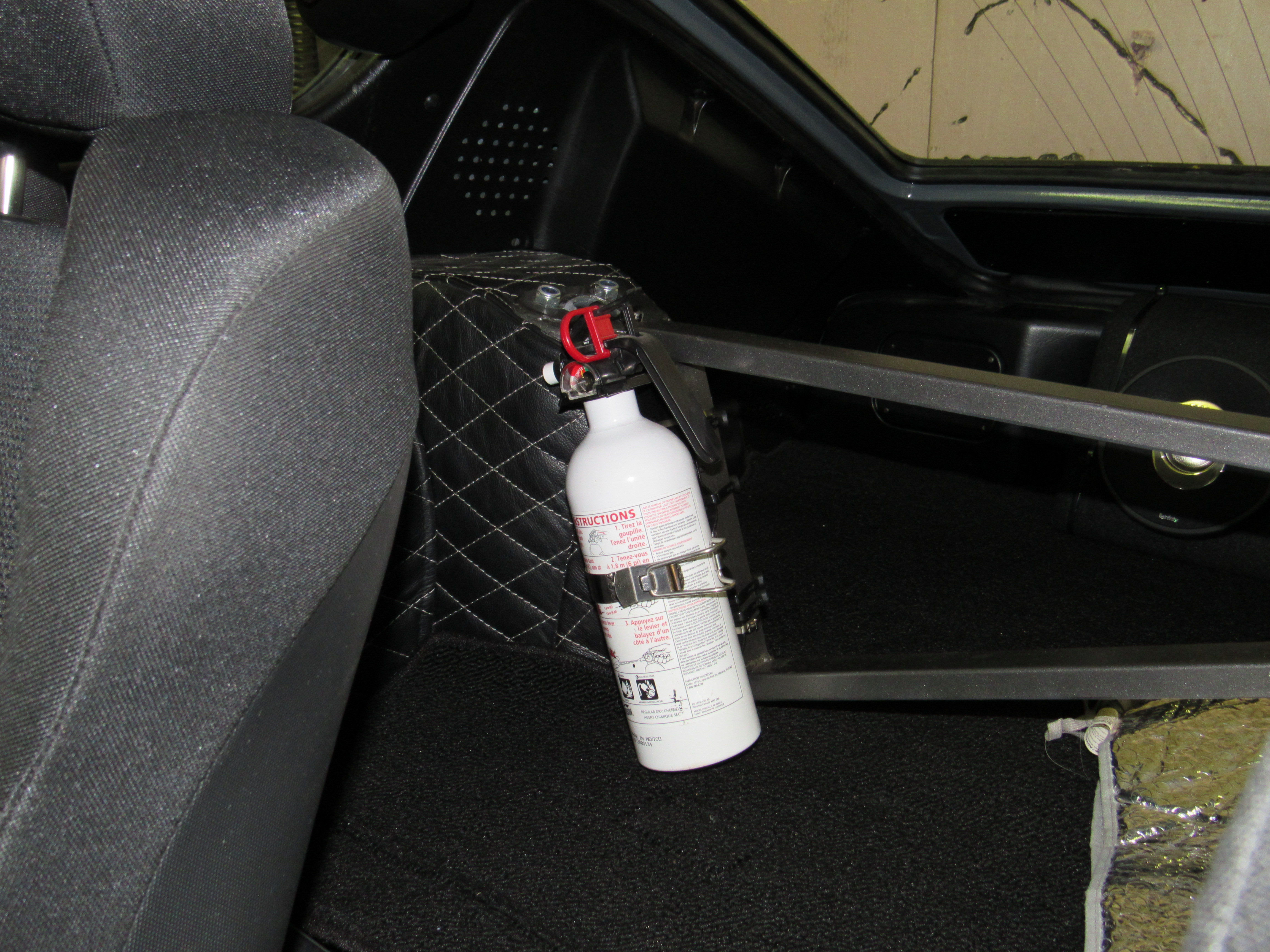

Cliff - I have one with the same mount.  I have it on the forward side of the right side shock tower, mounted upright.  Its an easy reach from the driver's seat, is not in the way when putting stuff in the rear deck area.
Jim
Just remember that if your car comes to a VERY sudden stop the canister will become a fast moving projectile heading toward you and your passenger, a steel bracket and straps are a good idea.

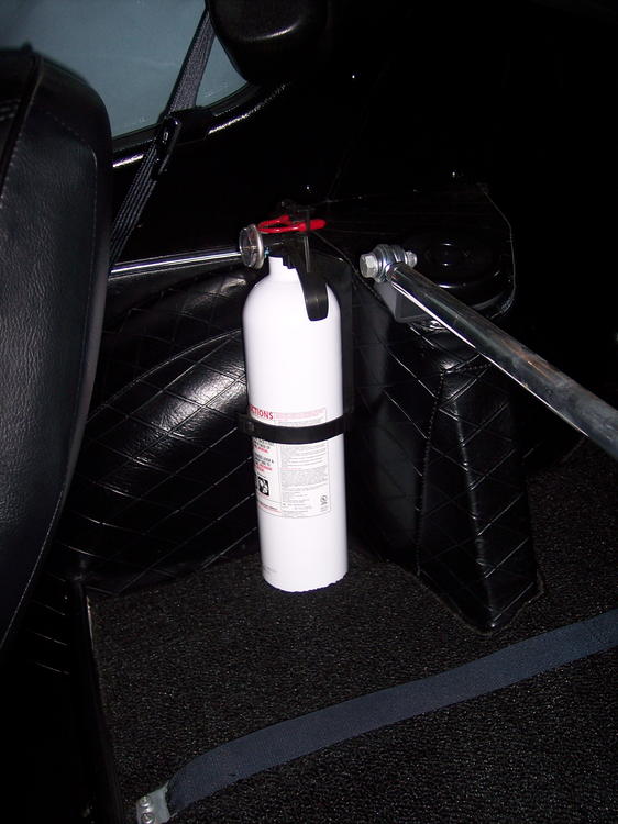

If I put it in the corner like Mr Arnett's it would hit the back of the passenger's seat, right?
Also like the idea of using preexisting holes as JSM suggest. I'll see if that's a possibility behind the passenger's seat too.
Thank you all for your replies. I tried the front of the seat base but the nozzle wouldn't allow it.
Thanks again, Cliff. :)

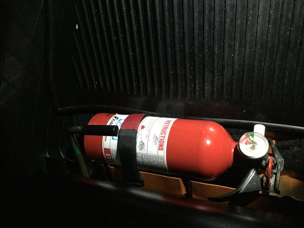

I mounted mine in front of the passenger seat and held in place with a
ribbon of Velcro which is passed through a hole in the seat foreward
support and around the extinguisher.  Pull the red Velcro tab and it’s free.
