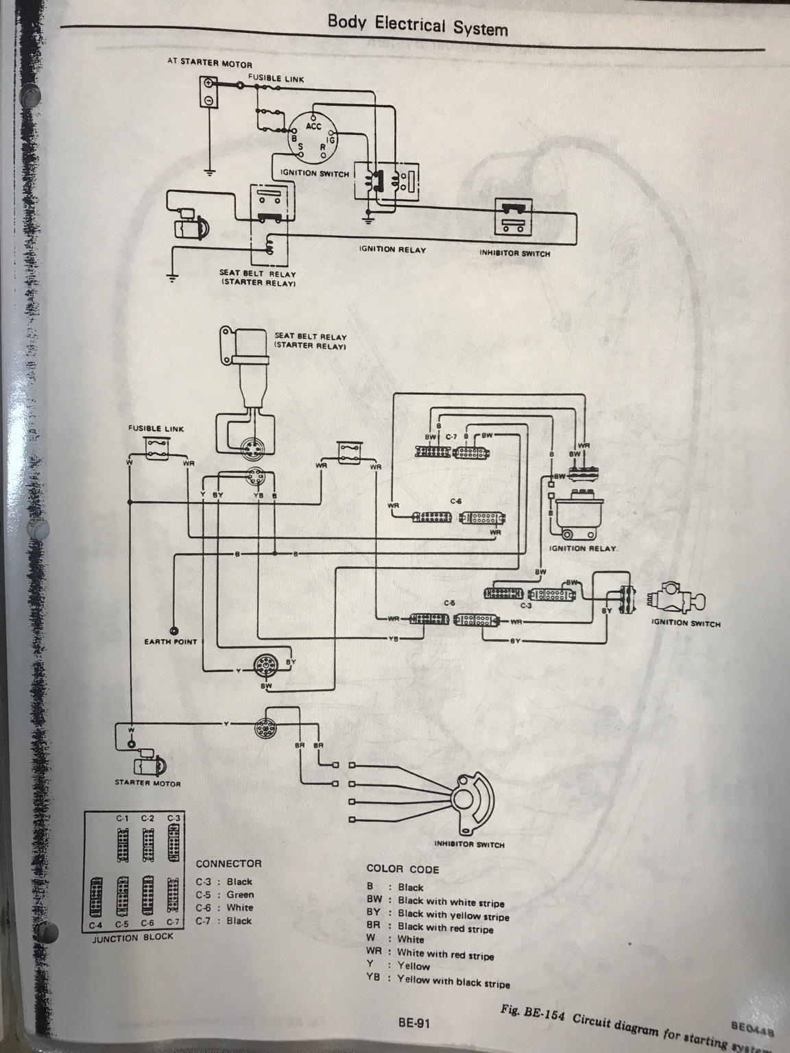

it has good fuel pressure during crank and run cycle dave. i dont think it has to do with the distributor because it runs great once it fires ksrosser it has a brand new fuel filter and all new gas lines siteunseen. it does the same thing when warm and cold captain obvious.   im going to try checking the oil pressure sending unit because it was doing something weird when i first got it back together and tried cranking it for the first time.   with the ignition on i could hear the fuel pump running but when i connected the oil sending unit in it would shut off.   but it seemed to fix itself.  maybe something is ****ocked there.   i really do not want to swallow my pride and take it to a shop for something that is probably a loose connection.  like i said  the car runs great but only with a small shot of ether.    all your advise is much appreciated guys and i will take all i can get.    thanks
Well if it does the same thing when you just shut if off for a couple seconds, then there's something that is inhibiting either spark or fuel pump operation when the key is in the START position. Everything works fine when the key is in the ON position, but it doesn't work right in START. So if you can get it started, it's fine in ON, but getting it started is the issue.

So I don't know the 78's like I know the 77's but it's either the fuel pump isn't running in START, or you aren't getting a spark in START.
Just as a quick way to narrow the field, when you are cranking and cranking it and it won't start... Do you get a good spark while you are cranking it?
don't forget to check out the start switch itself. you want to make sure the ON stays ON when the key is advanced to the start position, I had an intermittent ON that caused a lot of grief. You need to test it to be sure.

One of the fuel pump interlock relays or something inhibiting the ignition only while cranking.
