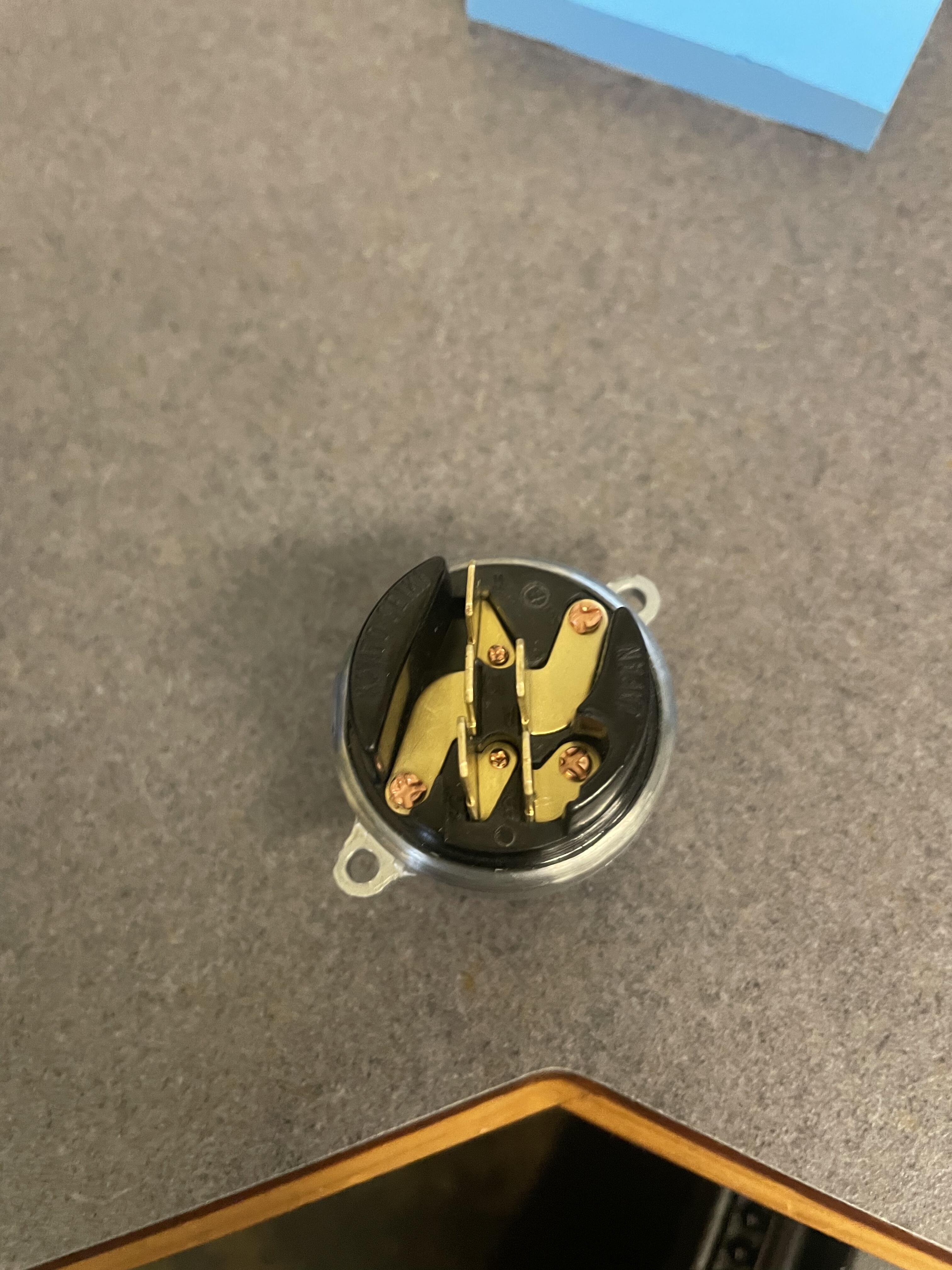

New switch has power to B/W on start, but not the G/W.  I will check again when i get home with clamps, but that is what I found.  Also my old switch if you barely turn it start, it catches 50% of the time.  That was Richards idea.
Ok, if I turn the ignition from on to start and not turn it far. My new ignition and old work fine this way. Both have issues if I turn it further to the clockwise.
My next giant question is if I turn it full hard to the right or clockwise. The starter doesn’t kick on at all. This is with both ignition switches. Is this normal?

So your question "if I turn it full hard to the right or clockwise. The starter doesn’t kick on at all. Is this normal?"
In my experience, the answer is "No, that is not normal." It sounds like your lock is travelling too far and going PAST the location that it should rotate. I've seen situations where internal wear makes it such that the switch doesn't turn far enough, but I don't think I've seen it turning TOO far.
I'll dig some lock parts out when I get the chance and see if I can come up with any ideas.

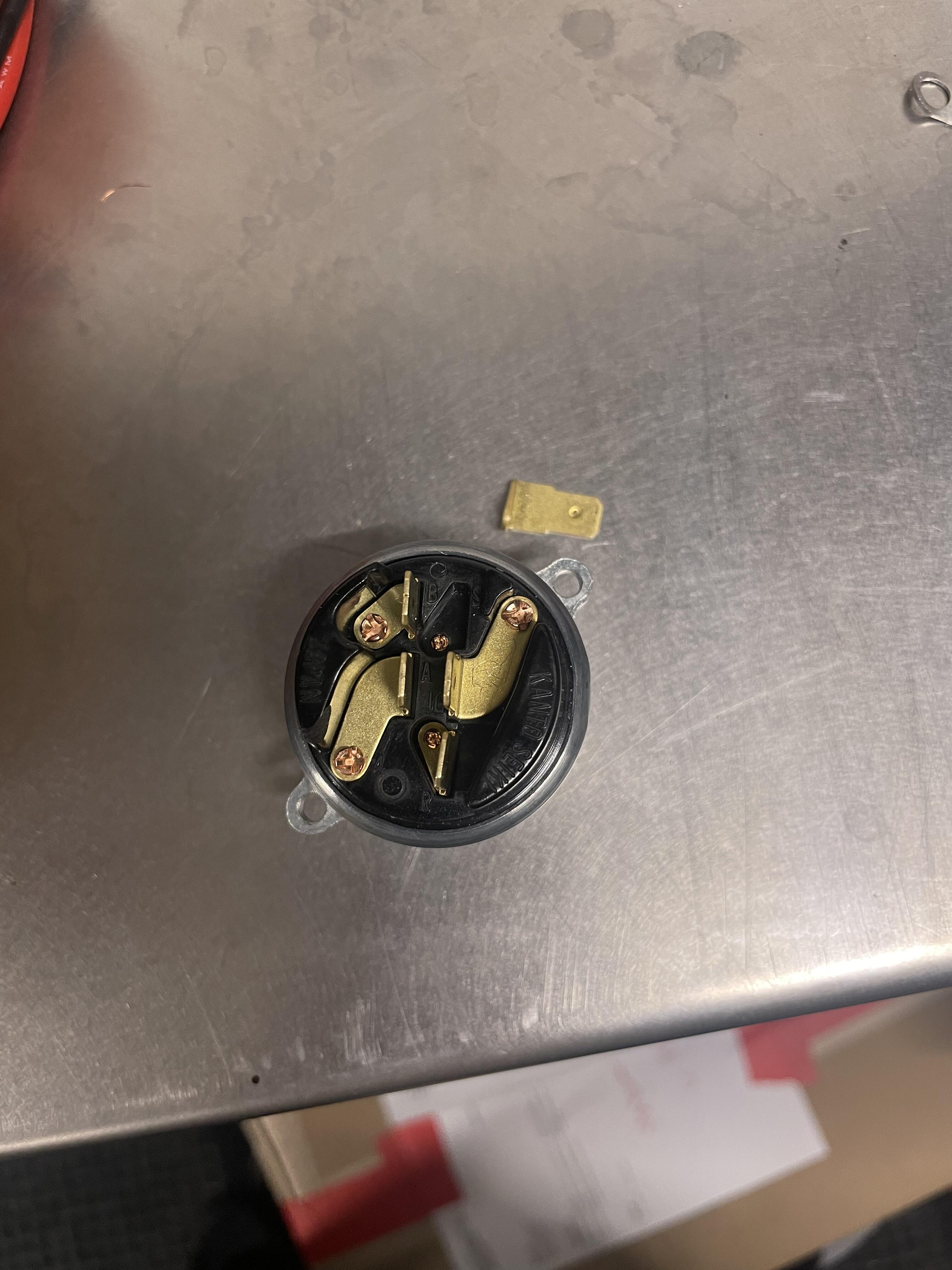

Well I am doubting my tests on my new switch. Since it had a broken terminal.
It is completely conceivable that your old switch has burned up contacts inside and turning it as far as you can (to full stop) in the clockwise direction would break the contact. And of course, it would be more concerning if your new switch did the same thing.
So check it again with your new-new switch when it arrives, and let us know. Let's hope if was the loose terminal.
Well this is the oem new switch. The B/W loses 12v during cranking. The G/W only gets 12v during cranking.
I think my option is to tie both parts of the switch together so I get 12v in the on and during cranking. Thoughts? Again, I am not using the stock coil and the stock tach wiring.
