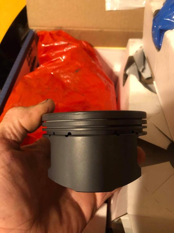

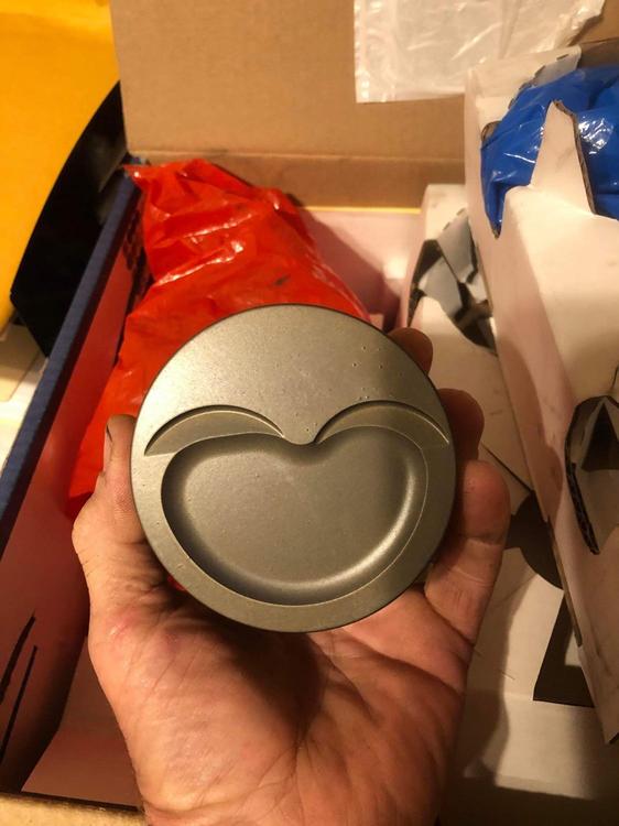

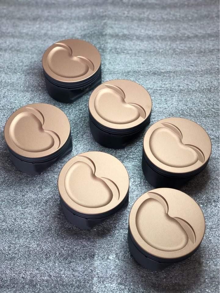

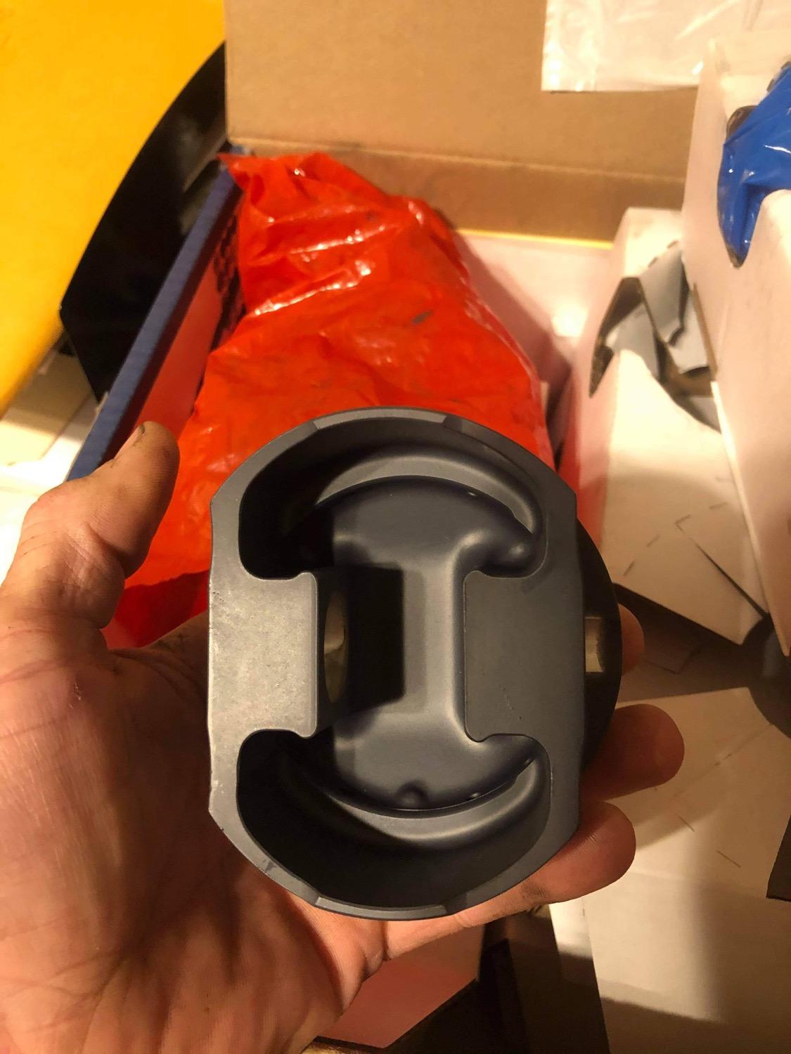

Rebello pistons just got back from ceramic coating by Performance Coatings, Inc. No clue if it was a good idea or not. But we decided to give it a try.
Ceramic on top, anti scuff on sides, thermal barrier on bottom.
The color is more of a bronze then the picture is showing.
2 hours ago, conedodger said:
Dave told me when I asked about coating, “it’s a 10/10ths thing. You don’t need it for a street engine but you could if you wanted to.”
Yeah, there are 100 little things you can do to the motor, each doesn't affect much, but added up they could.  Time will tell.

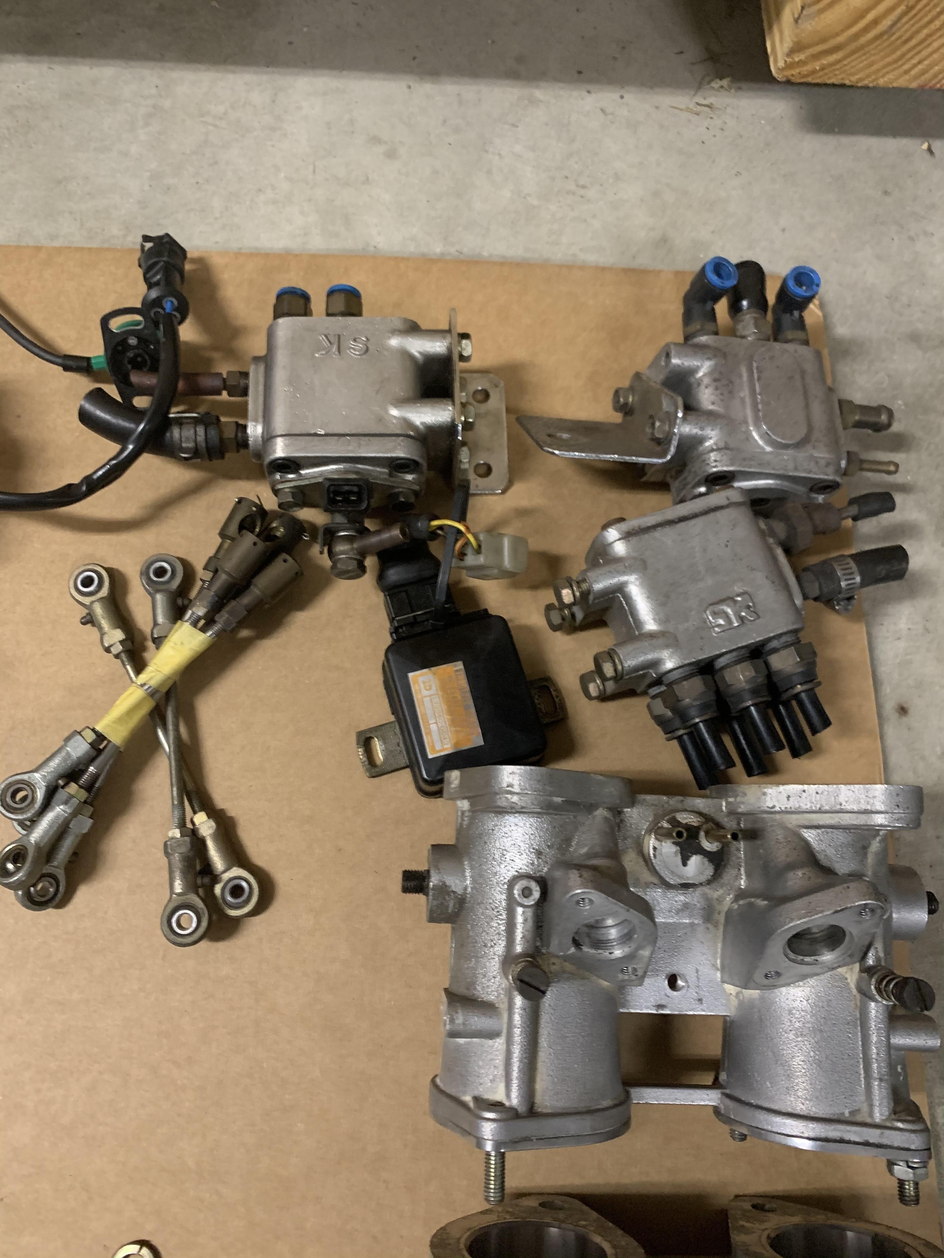

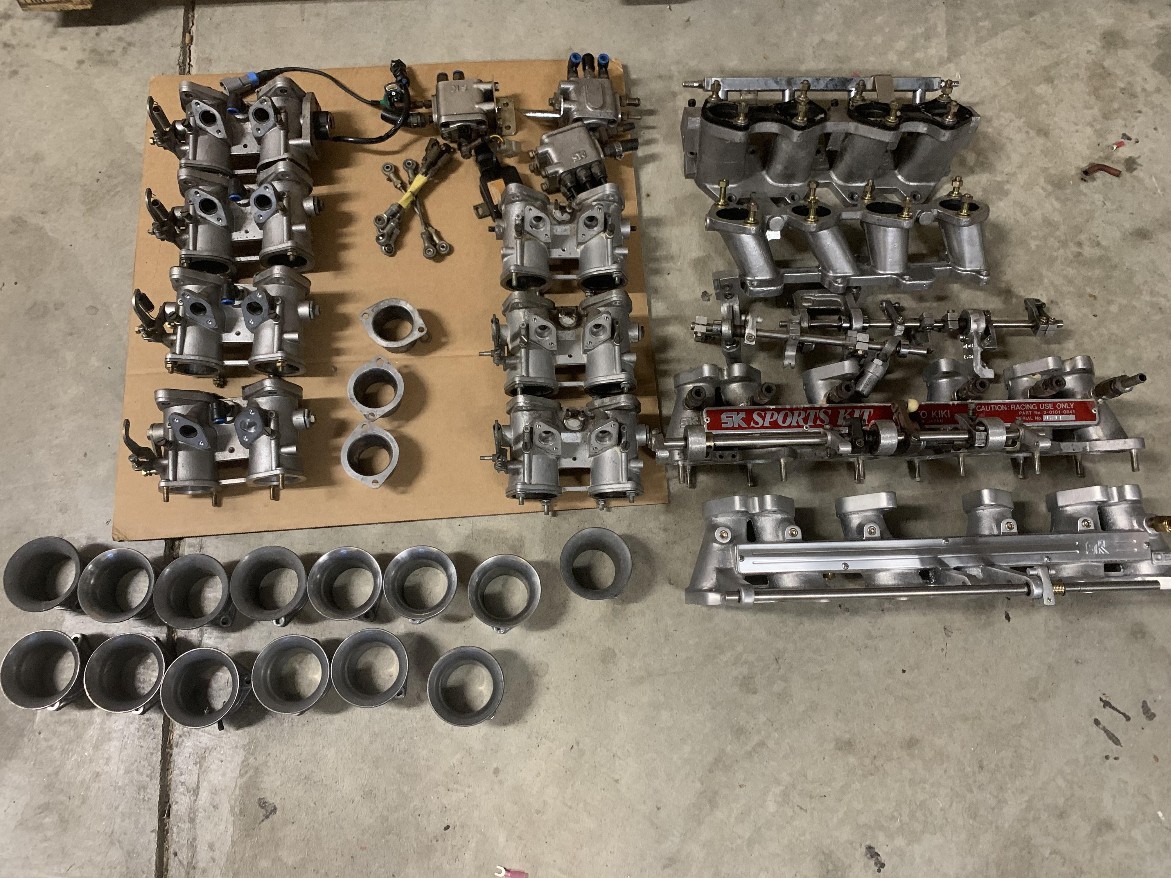

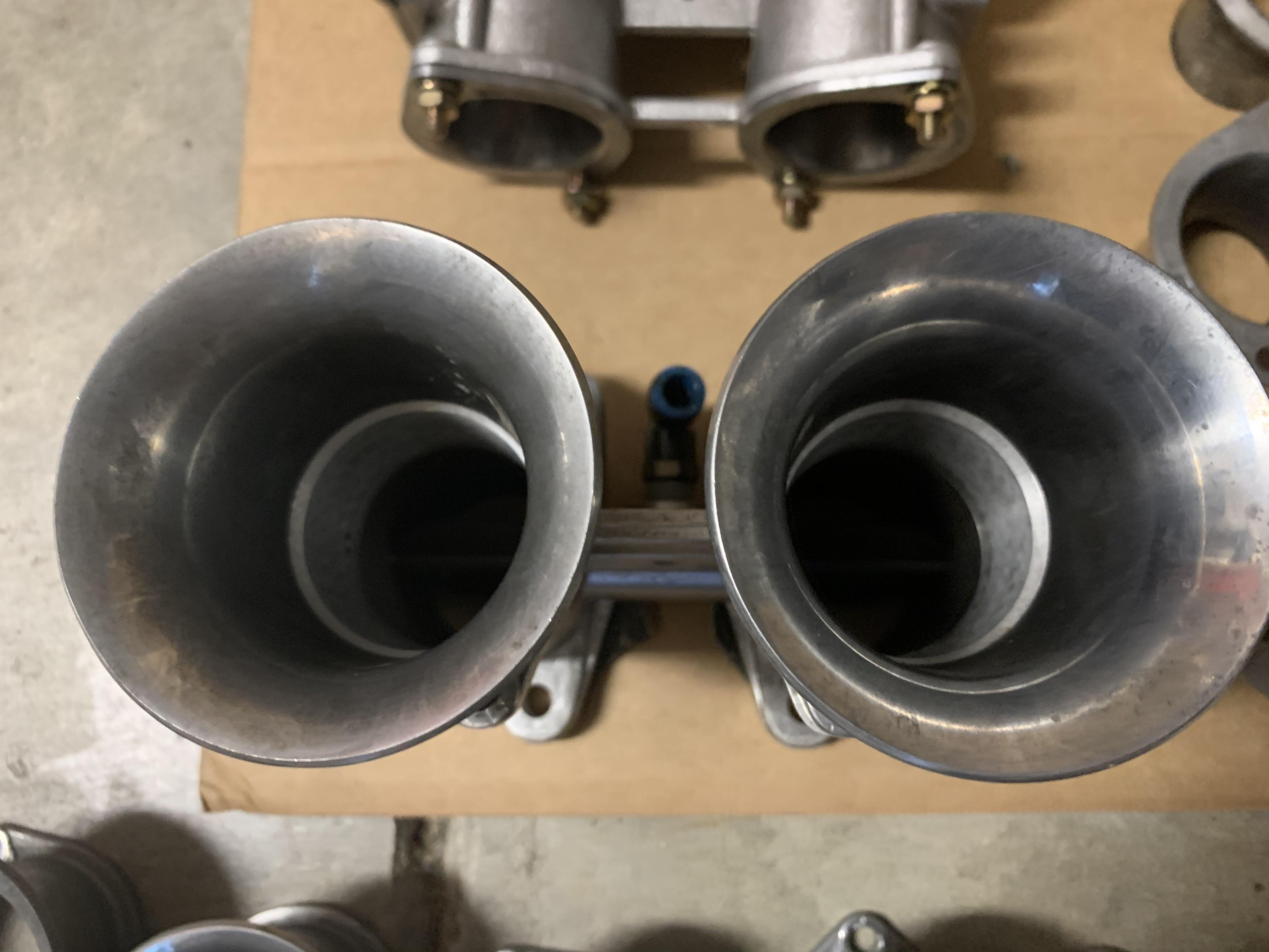

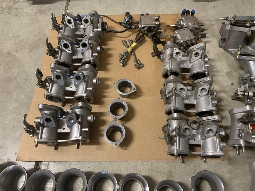

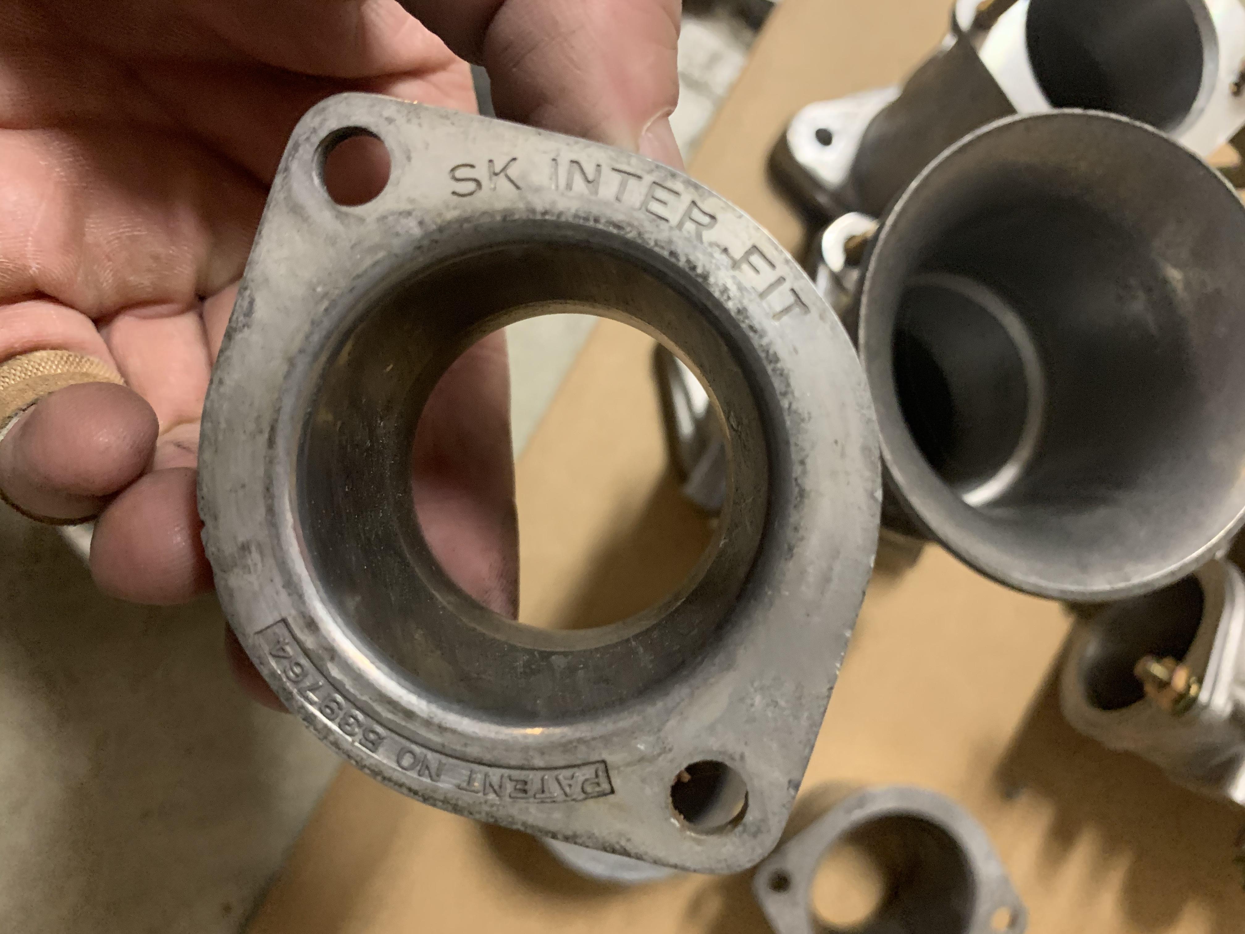

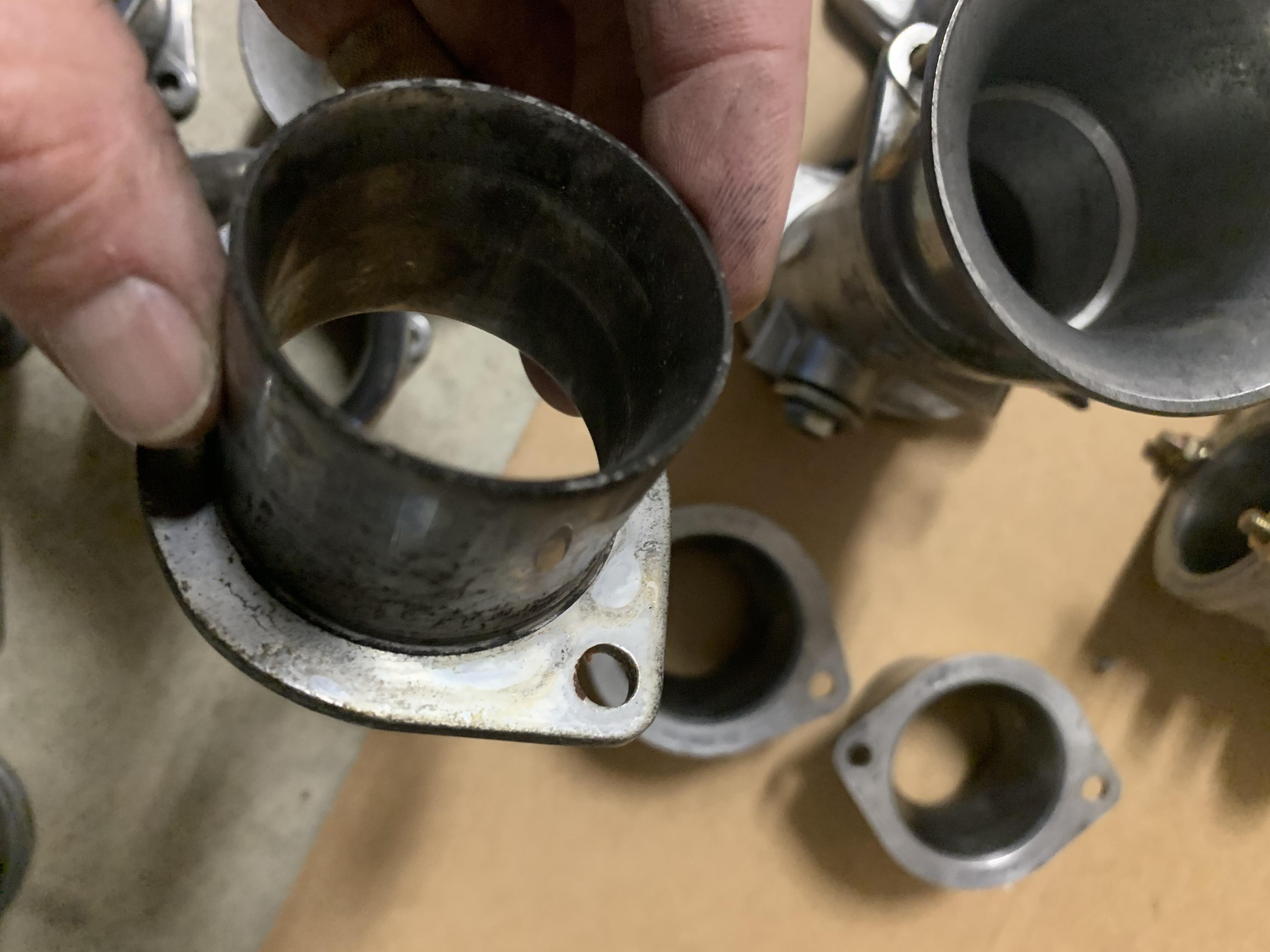

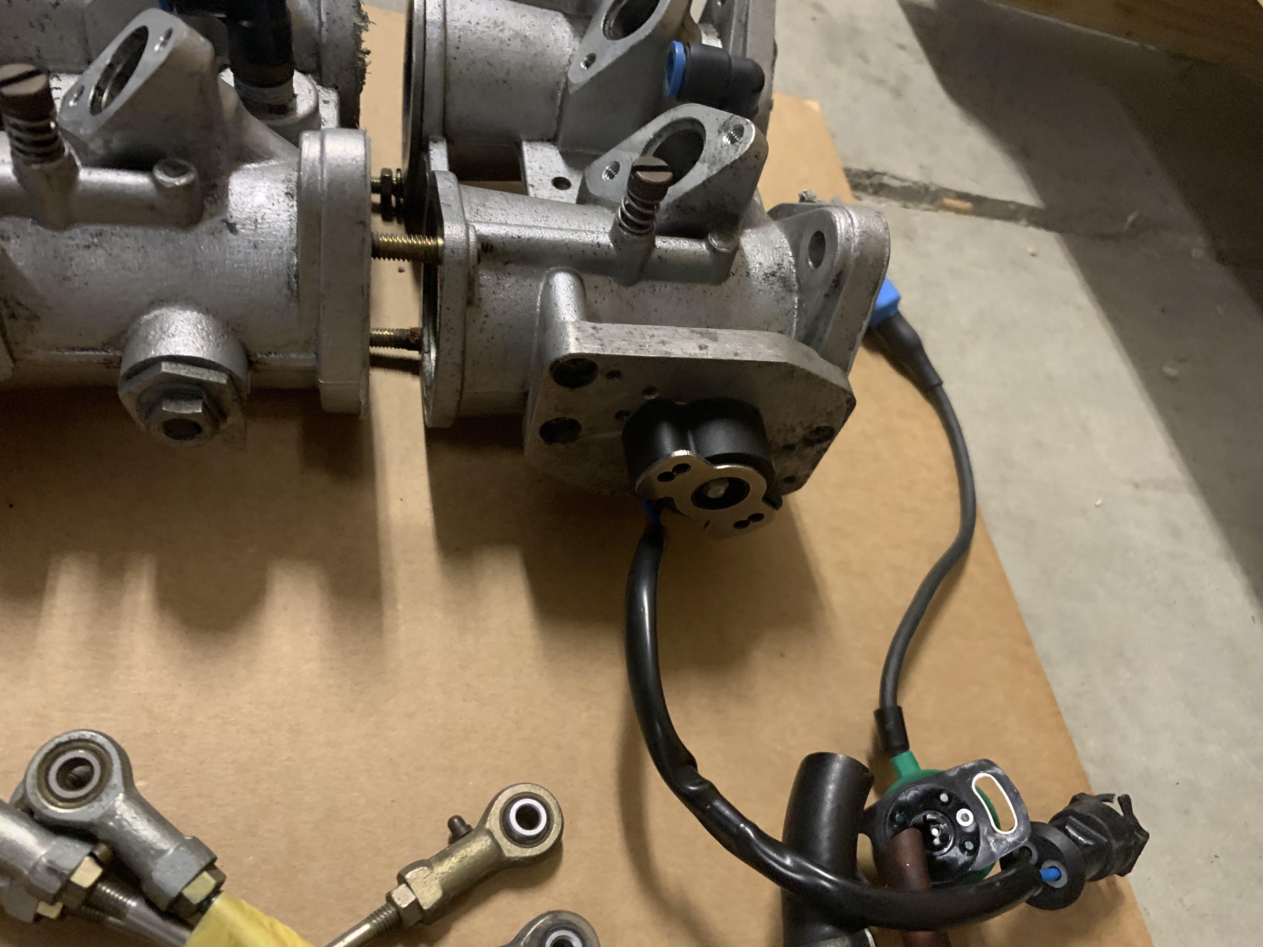

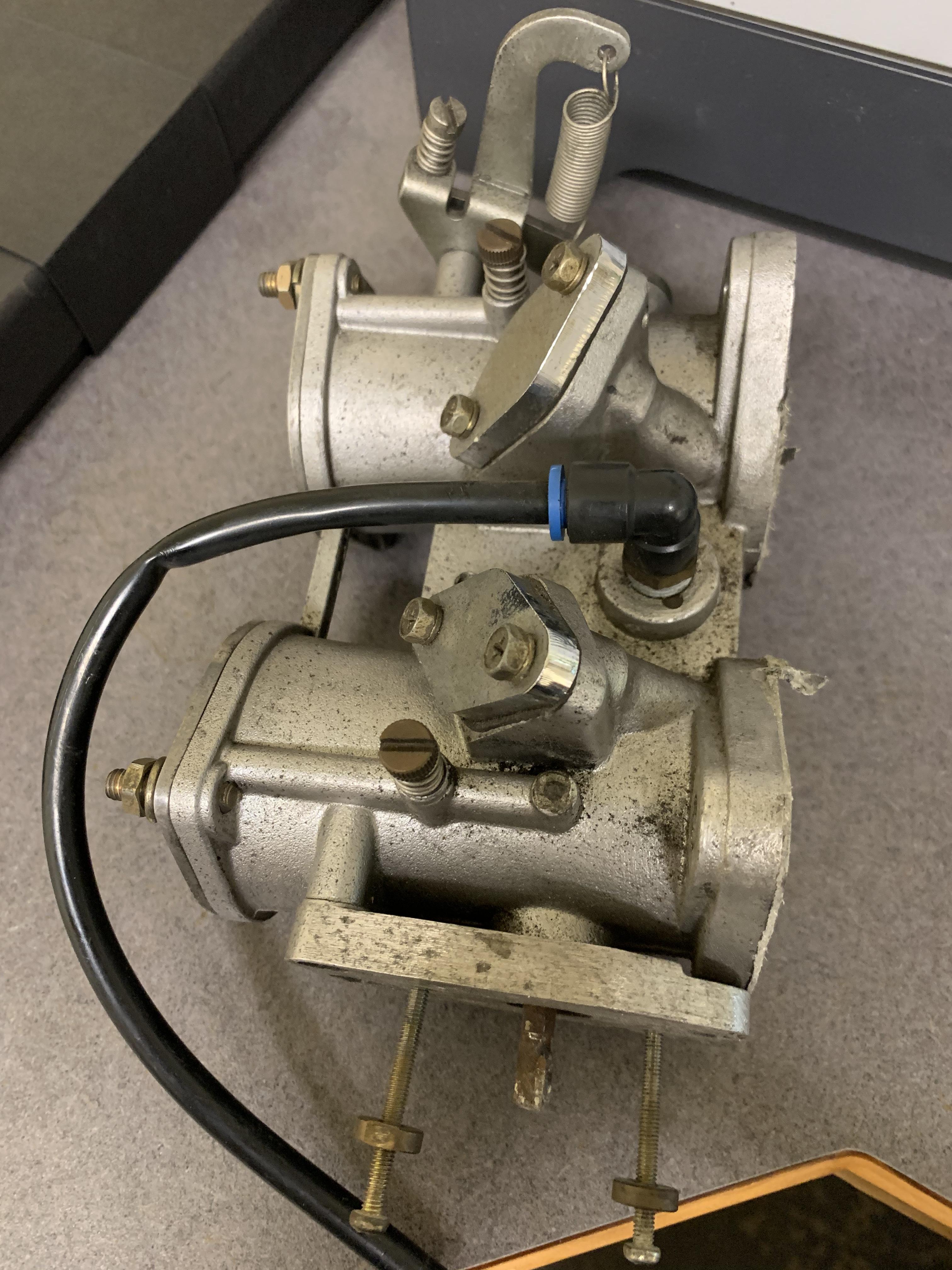

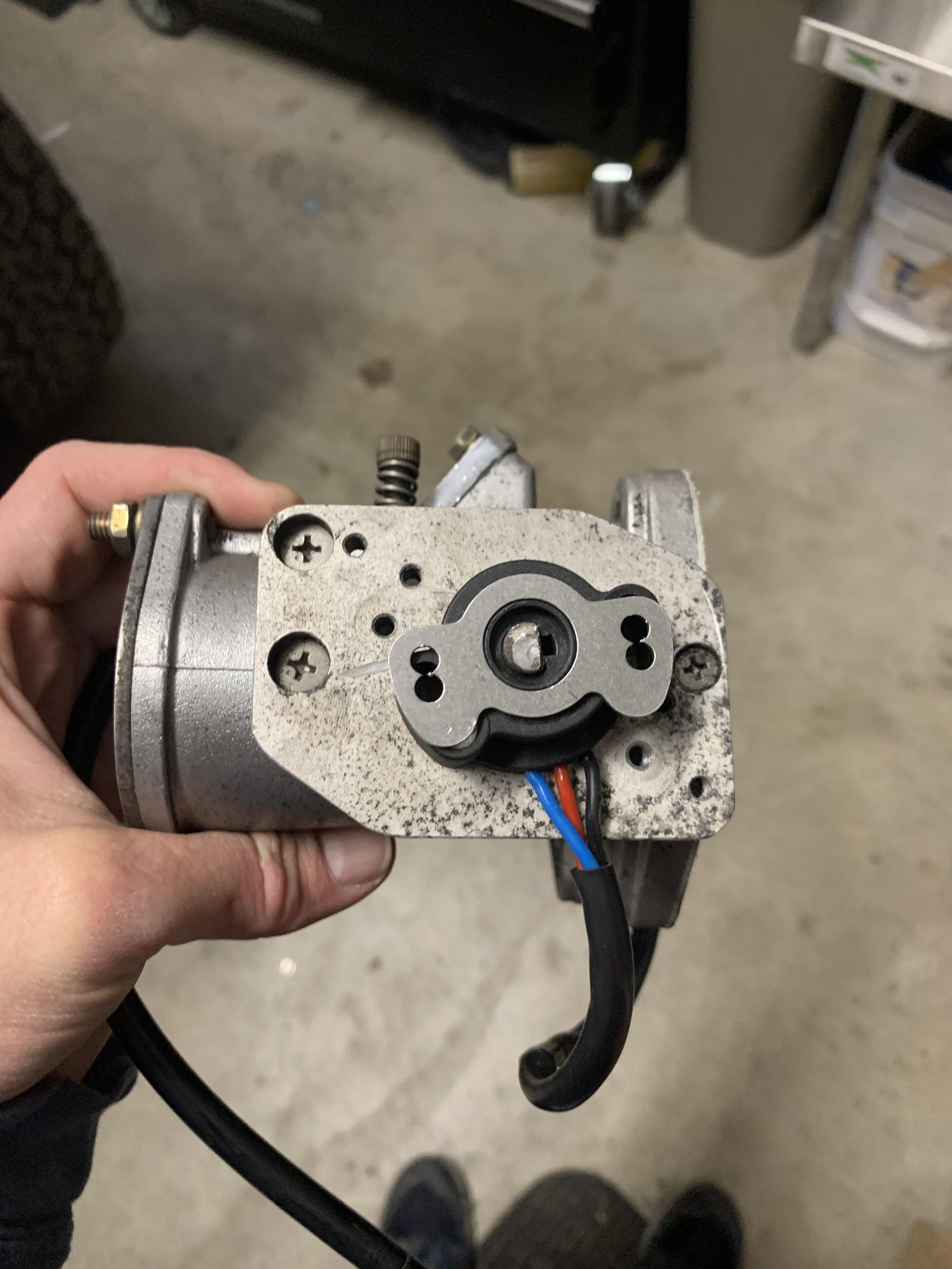

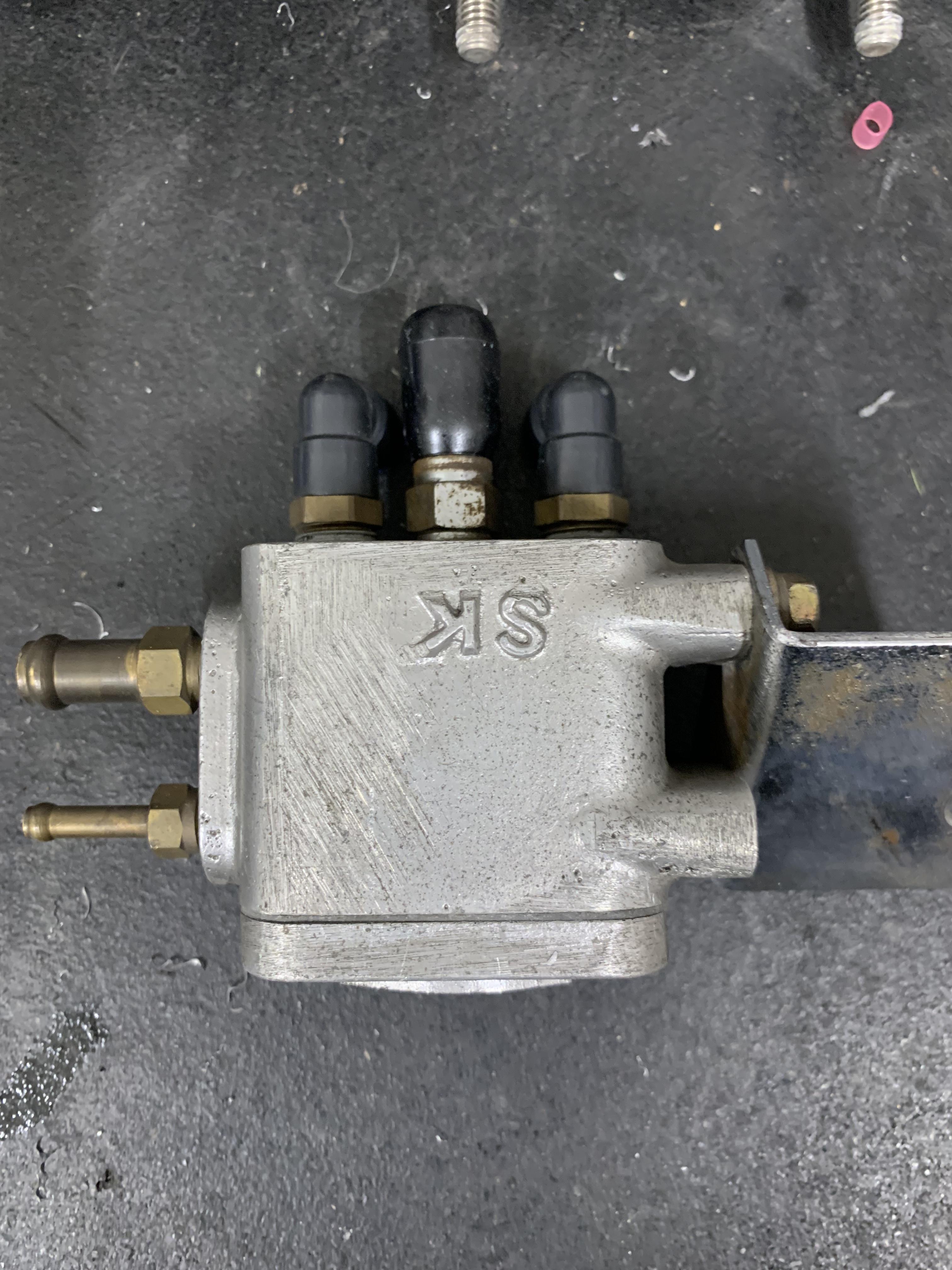

I finally got all my vintage SK throttle bodies from japan. I’m super happy with the casting and the overall design of them. The inner fit or choke they use is pretty interesting. Without its 47 tapered to 45mm. Oer actually still uses the same design, and I can buy different inner fits. The right 3 are 40mm throttle bodies. The left 4 are 45s. I believe it’s the same casting. But actually sleeved differently not machined.

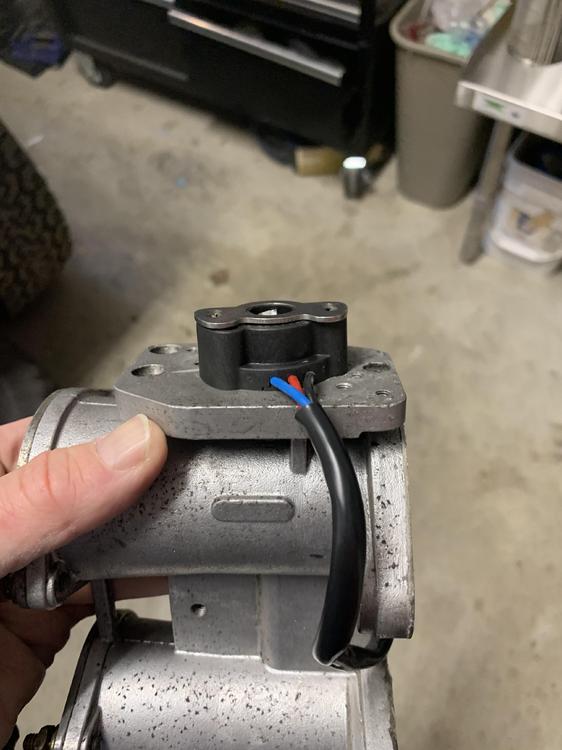

Luckily one has a D shaft end and my tps sensors all work on it.

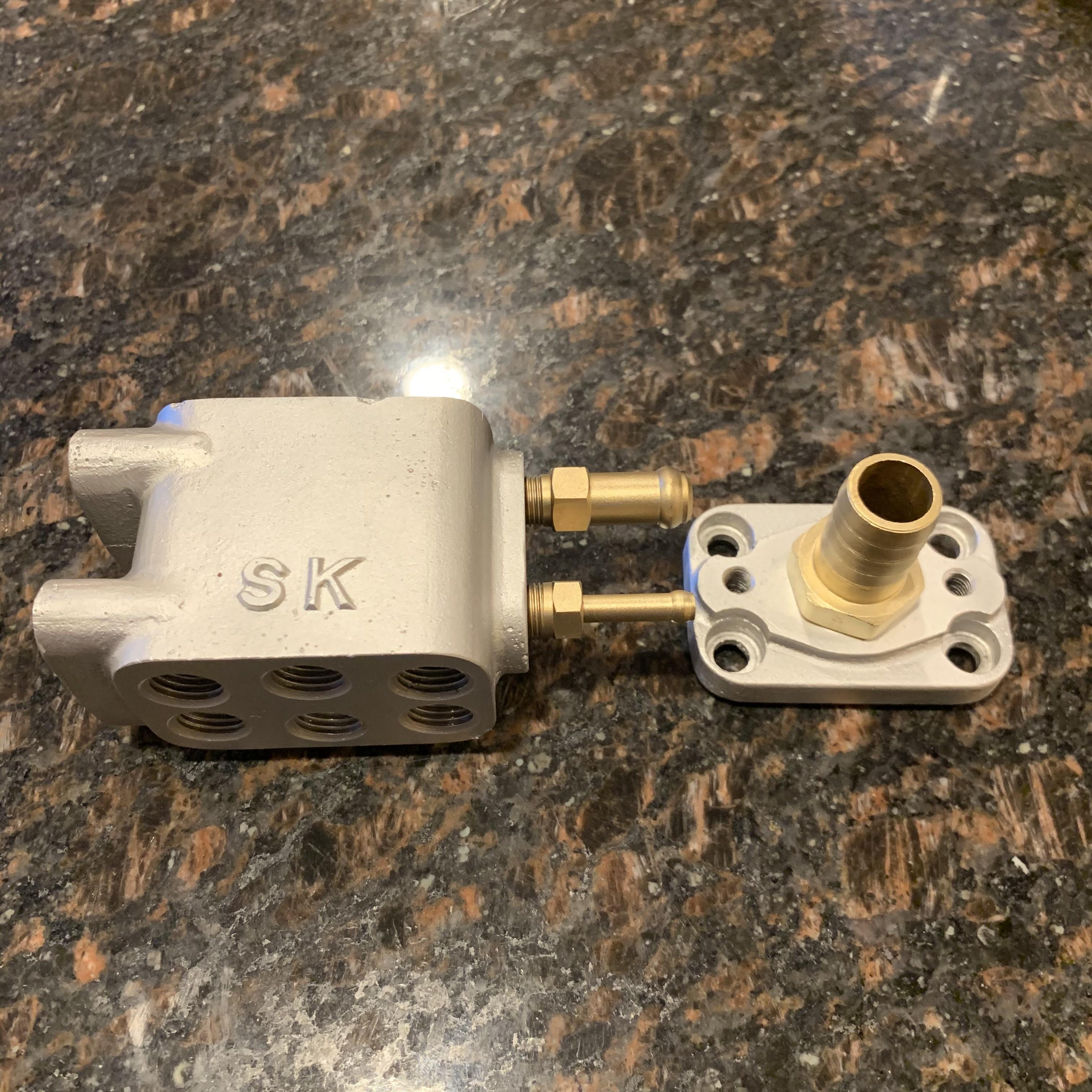

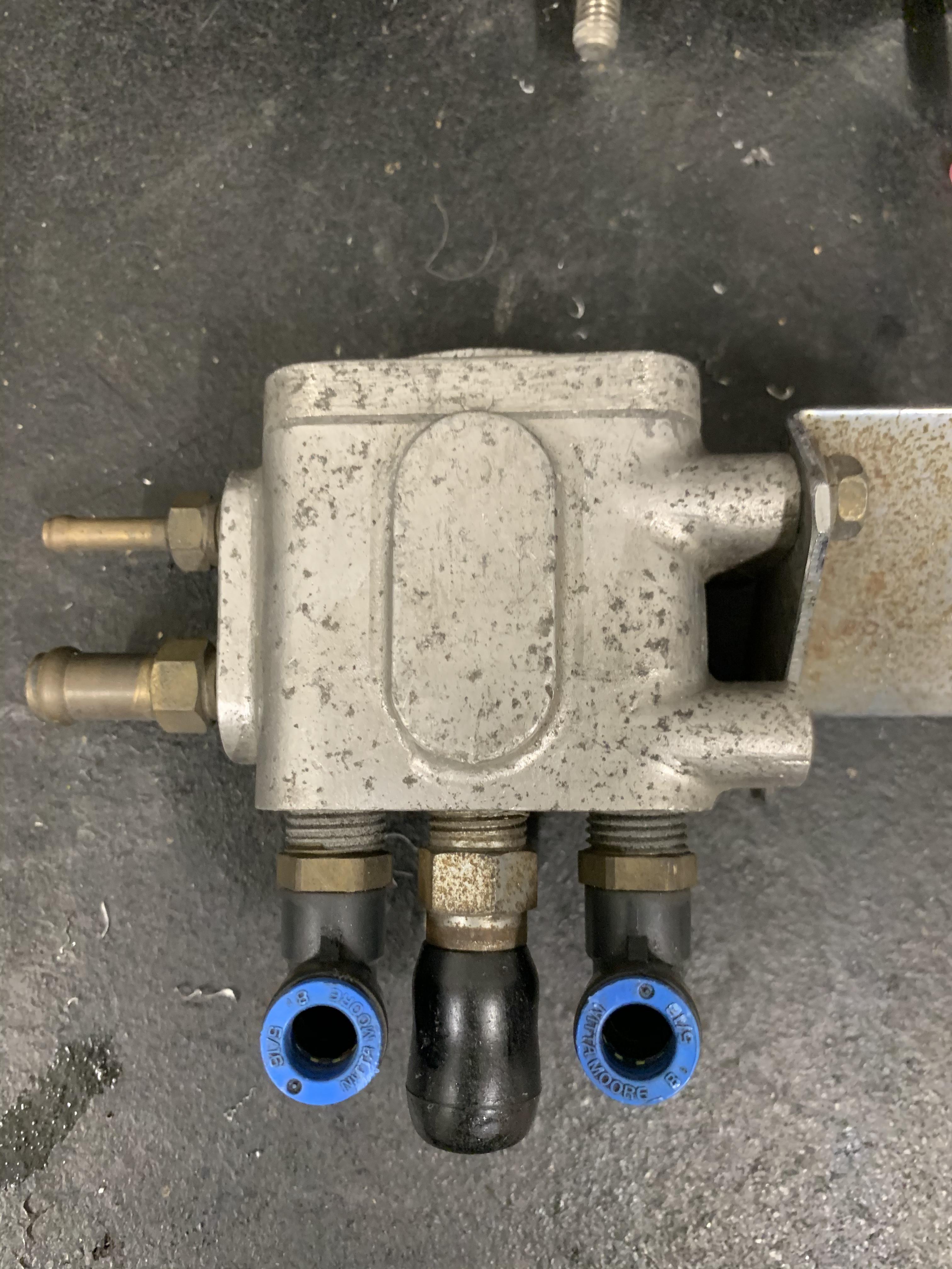

One of the vacuum accumulation block things even has either a map signal or a iac valve in it. Pretty darn cool for something so old.
I really like that they look a little more Mikuni/ dcoe carb. The stacks are super beefy.
Some L series piston porn for your Thursday viewing pleasure.

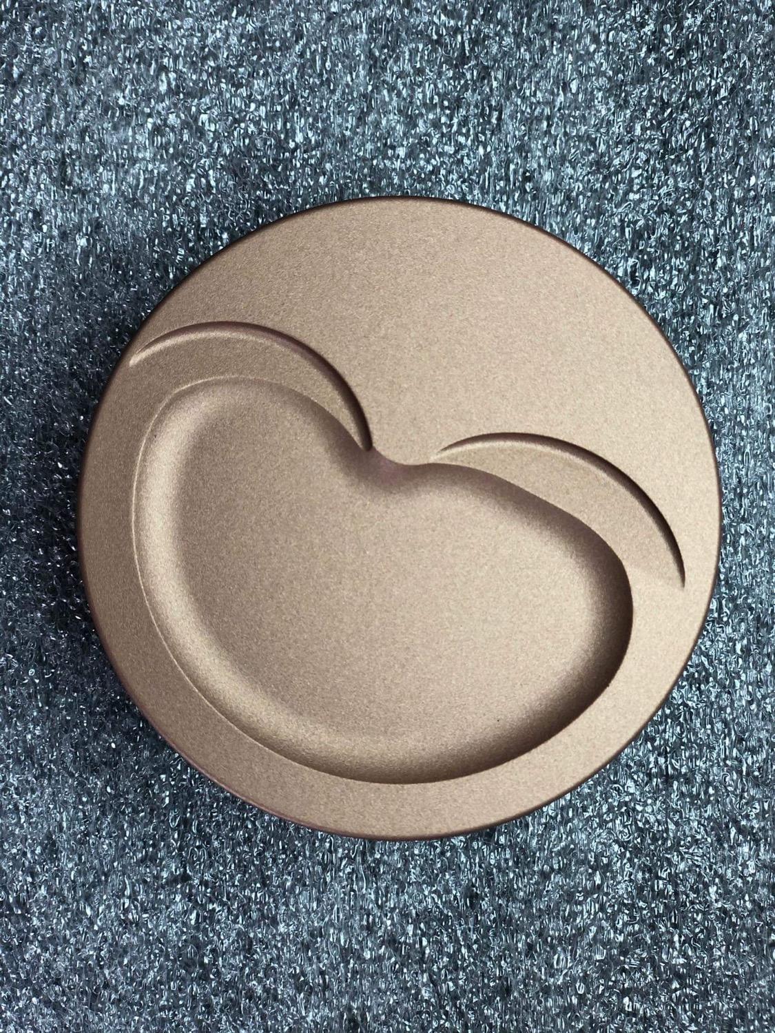

Originally the ceramic coating had some issues. I reached out to the company eagle suggested and they fixed them for me. Much better coating job.
Contact IA coatings: https://www.facebook.com/iacoatings/

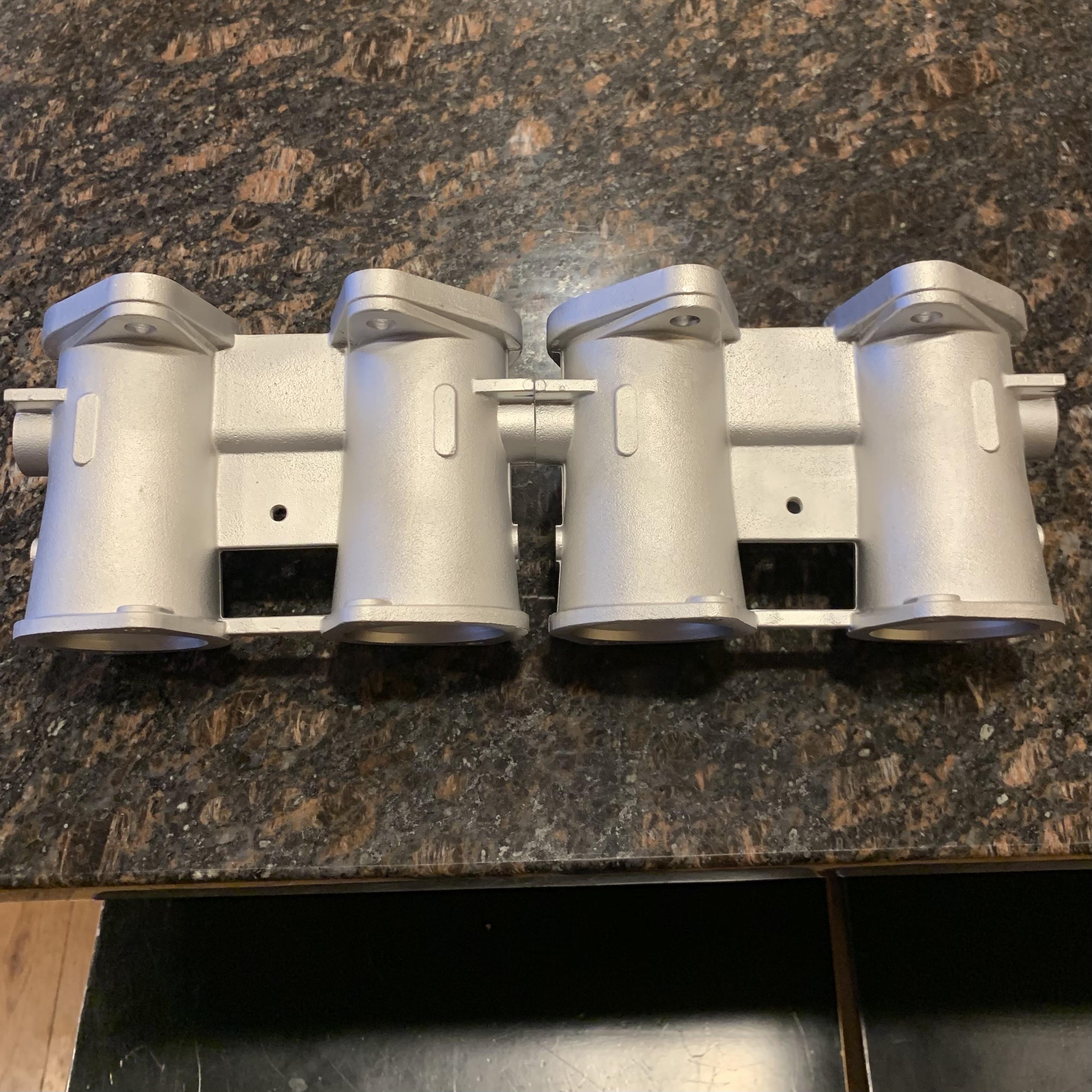

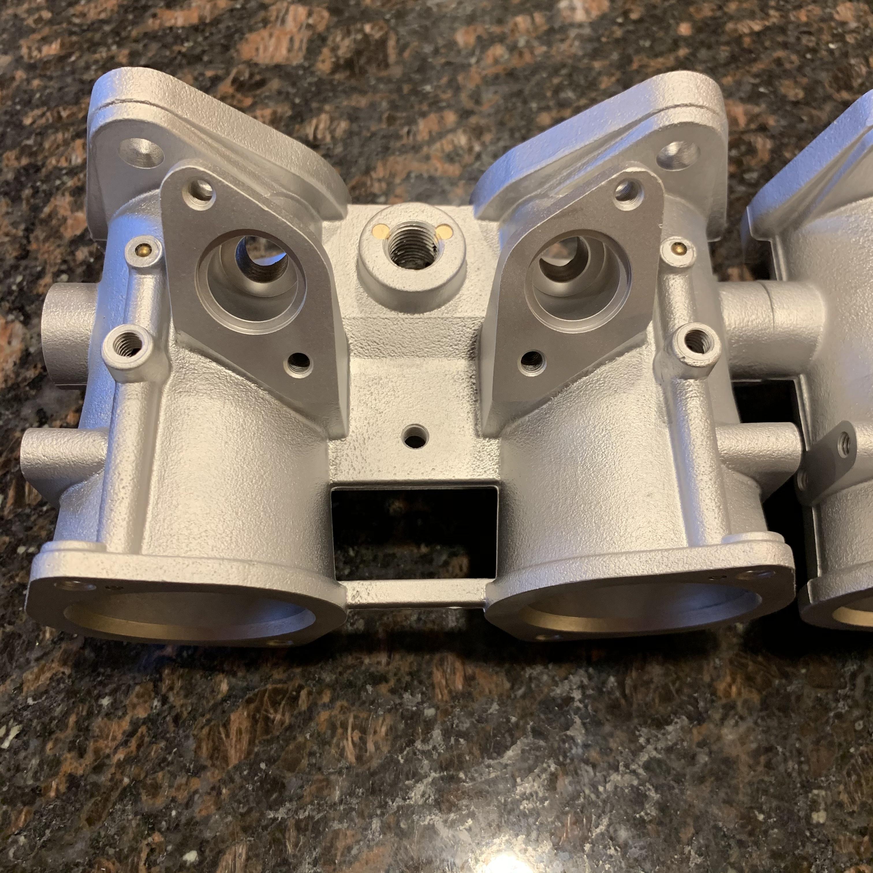

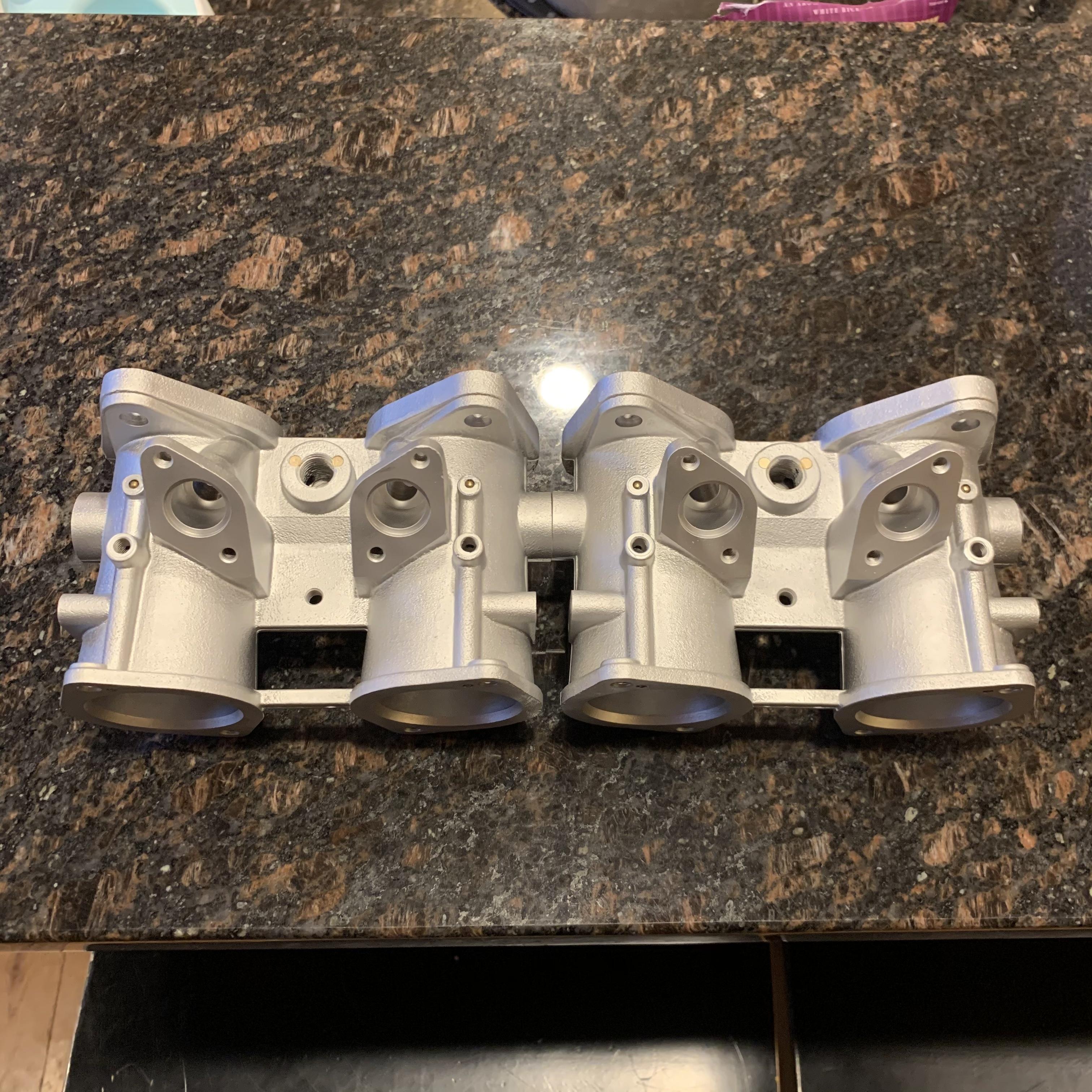

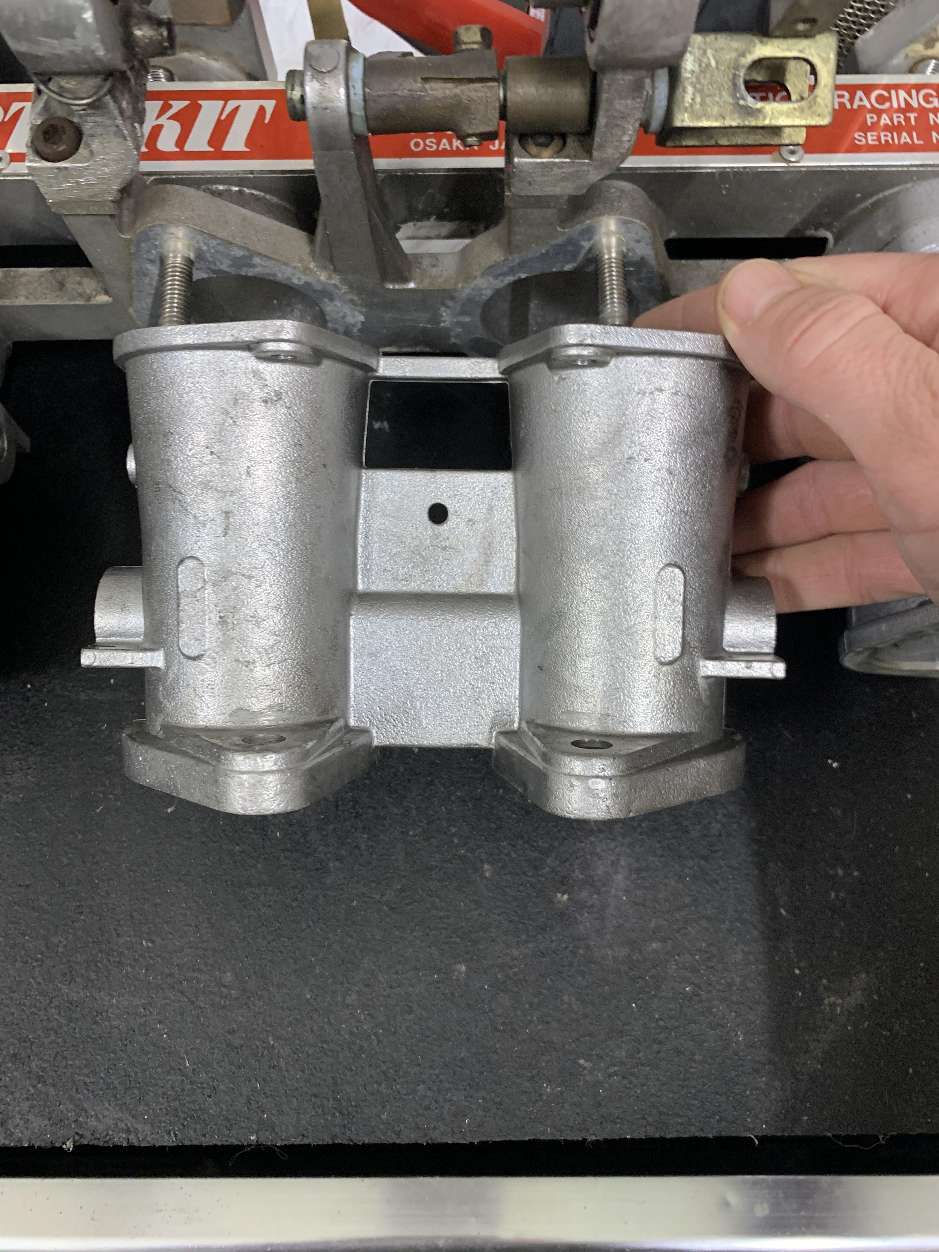

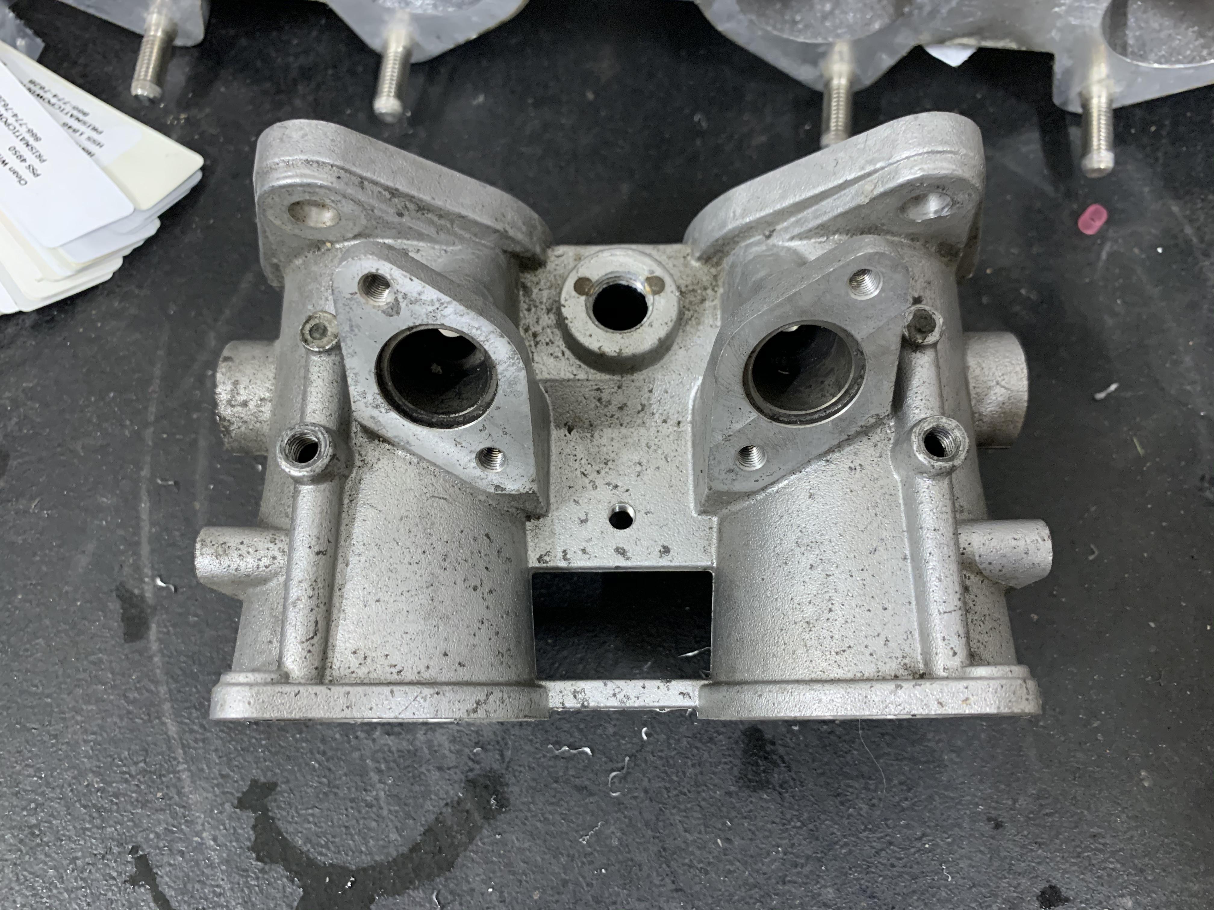

My vintage SK throttle bodies look pretty darn amazing after vapor blasting. Casting quality is good, not as good as a Mikuni carb. They should look amazing on my 240z. These are late 70s or early 80s. Now time to re zinc all the parts and rebuild them!
