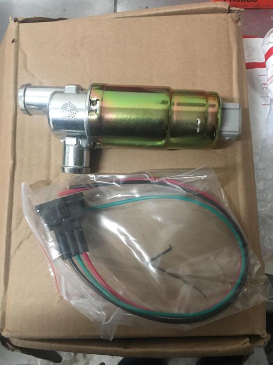

Well this bosch and all bosch IACs of this style let a ton of air by when closed.  Bosch said roughly 30-35%.  Which makes the butterflys useless at idle.  My next iac will be a ford.  Which closes all the way and only lets a tiny bit of air by.
Mines a Volkswagen version. Probably gonna have the same issue...
Was yours a three wire? Mine has a pull down resistor to ground to keep it closed.
Edited by wheee!
Well the 80s bmw iac is awesome, smaller and nice looking. Let’s no air or minimal amount by when physically closed Now to find out what pin is positive.
If there are just two connections and it's a simple spring loaded solenoid valve inside, it really shouldn't matter which pin is which. It should operate the same regardless. But if there's anything else in there (like even a protection diode), polarization would matter.

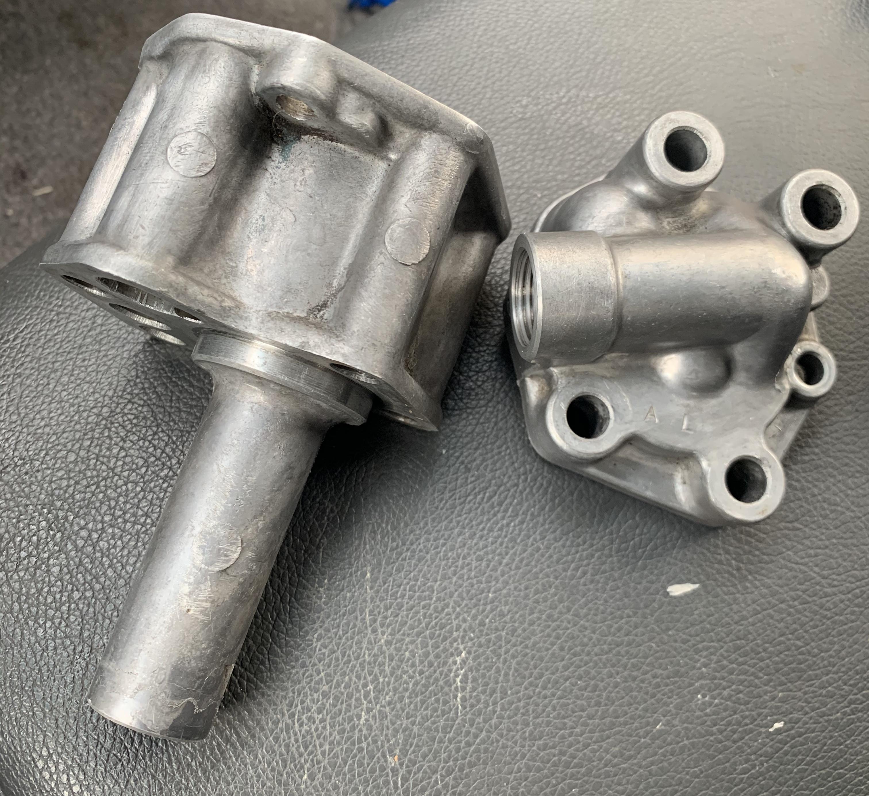

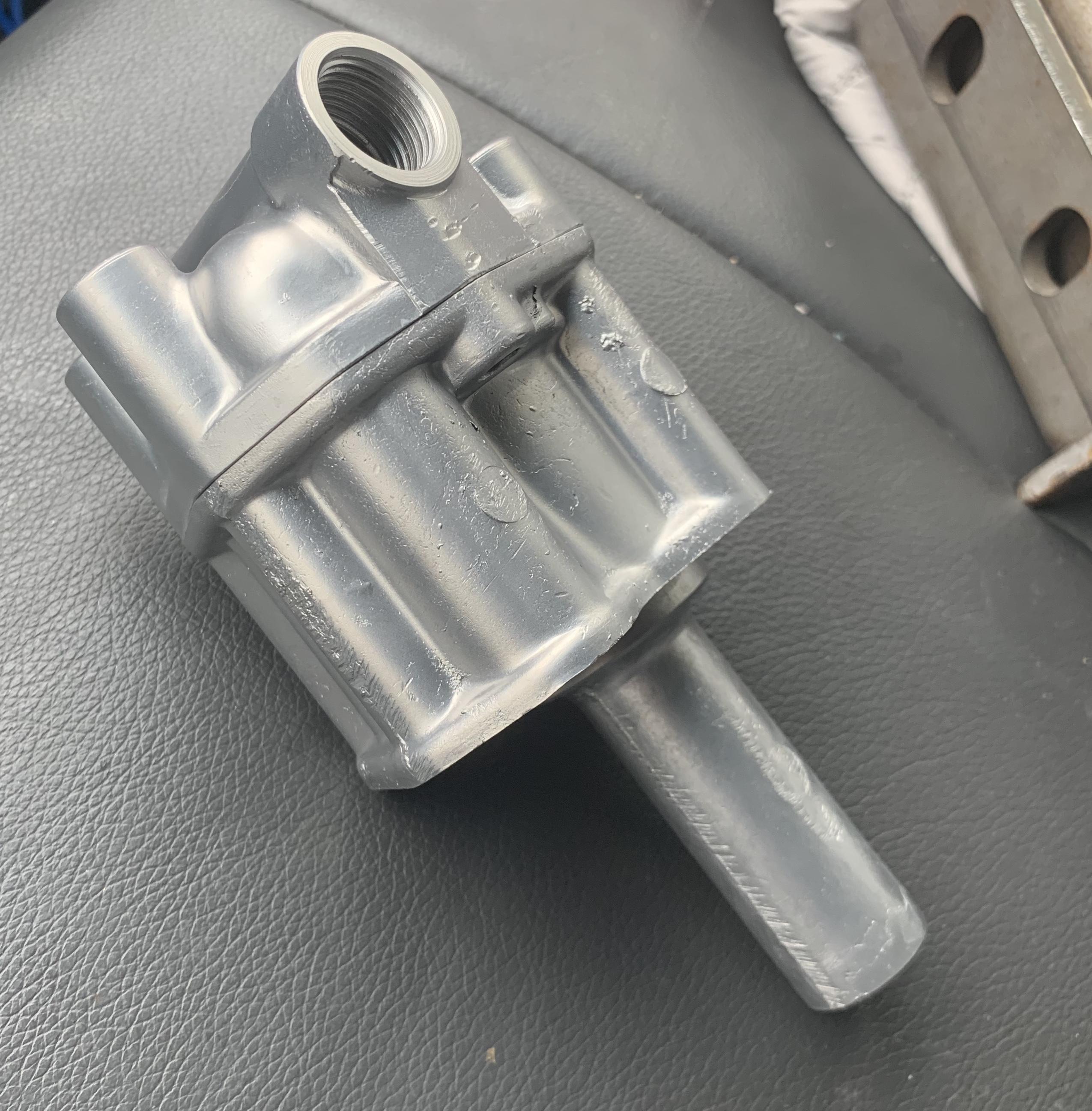

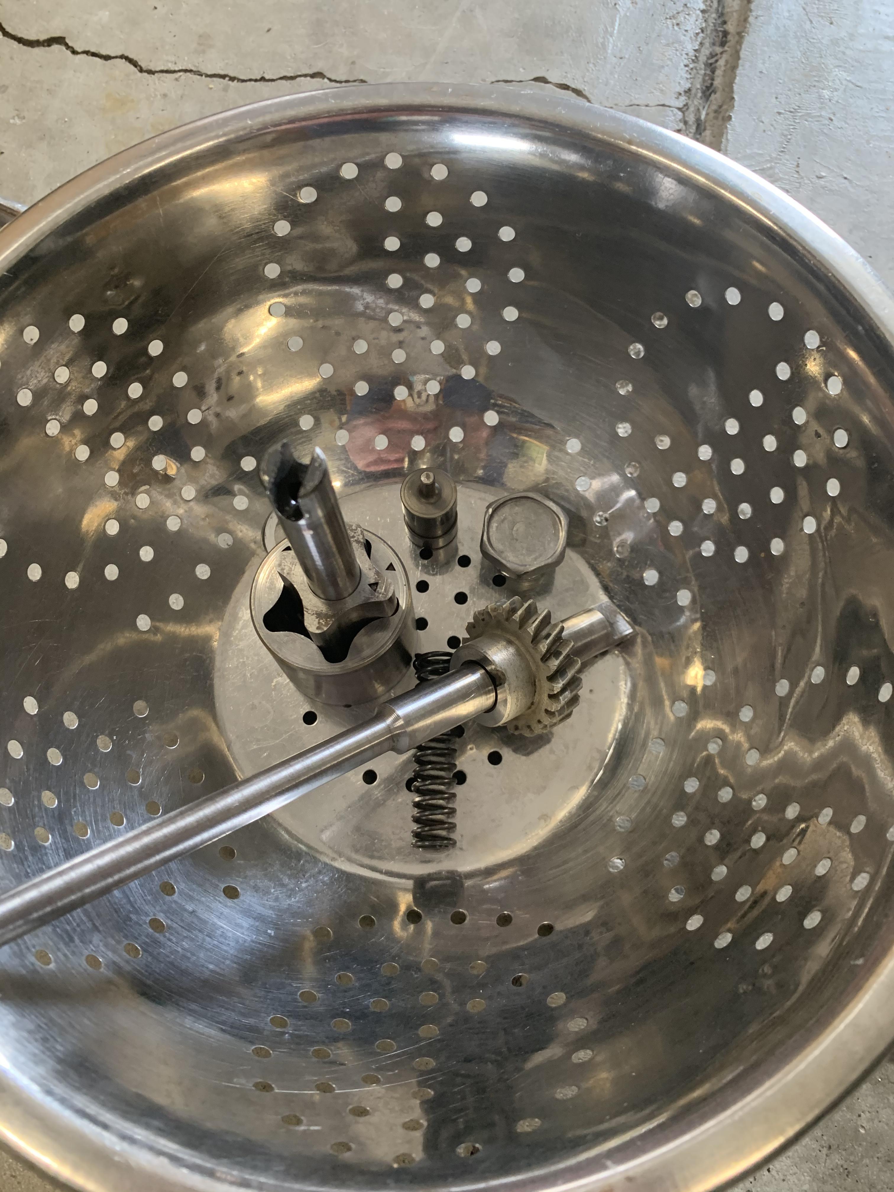

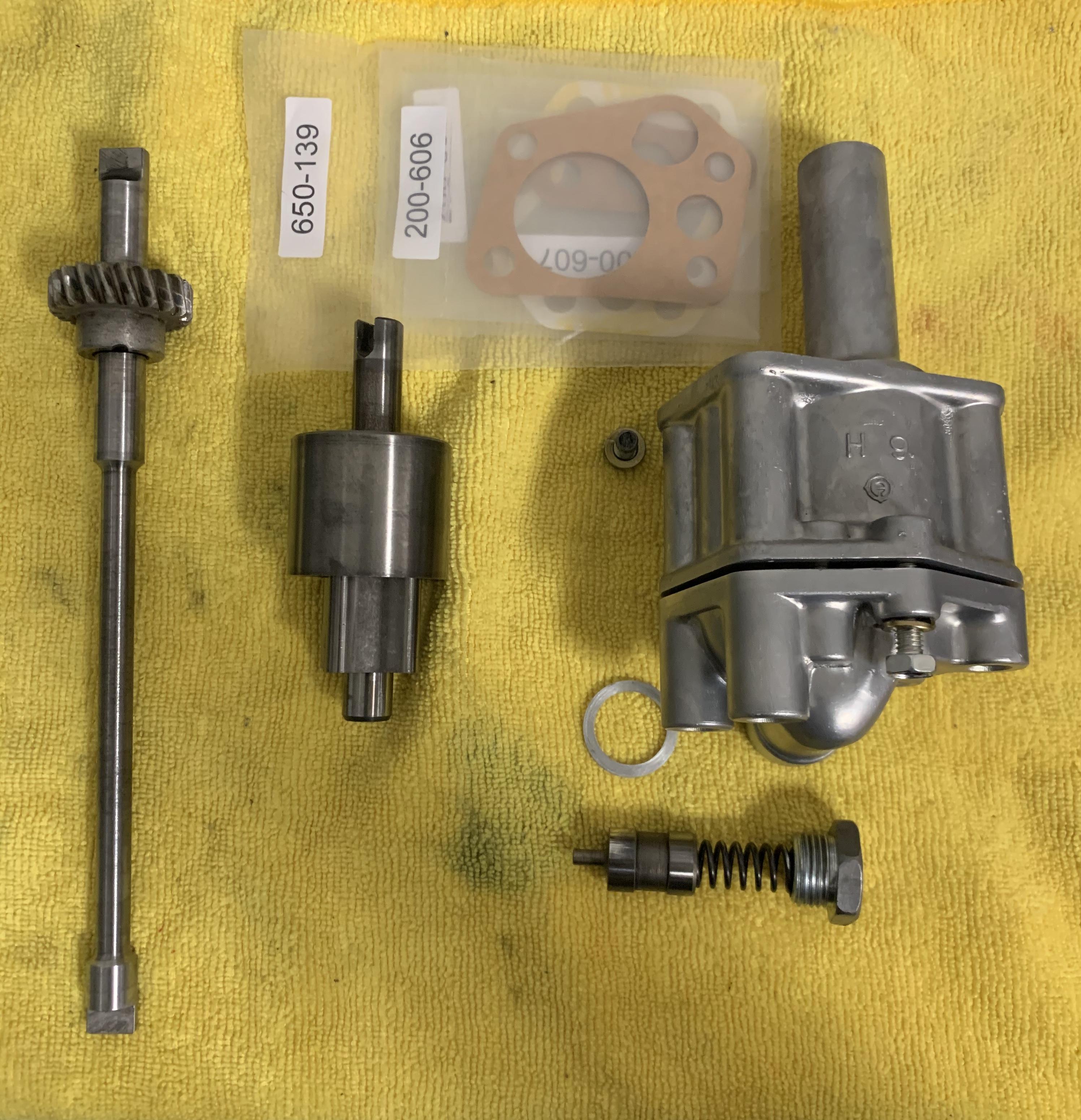

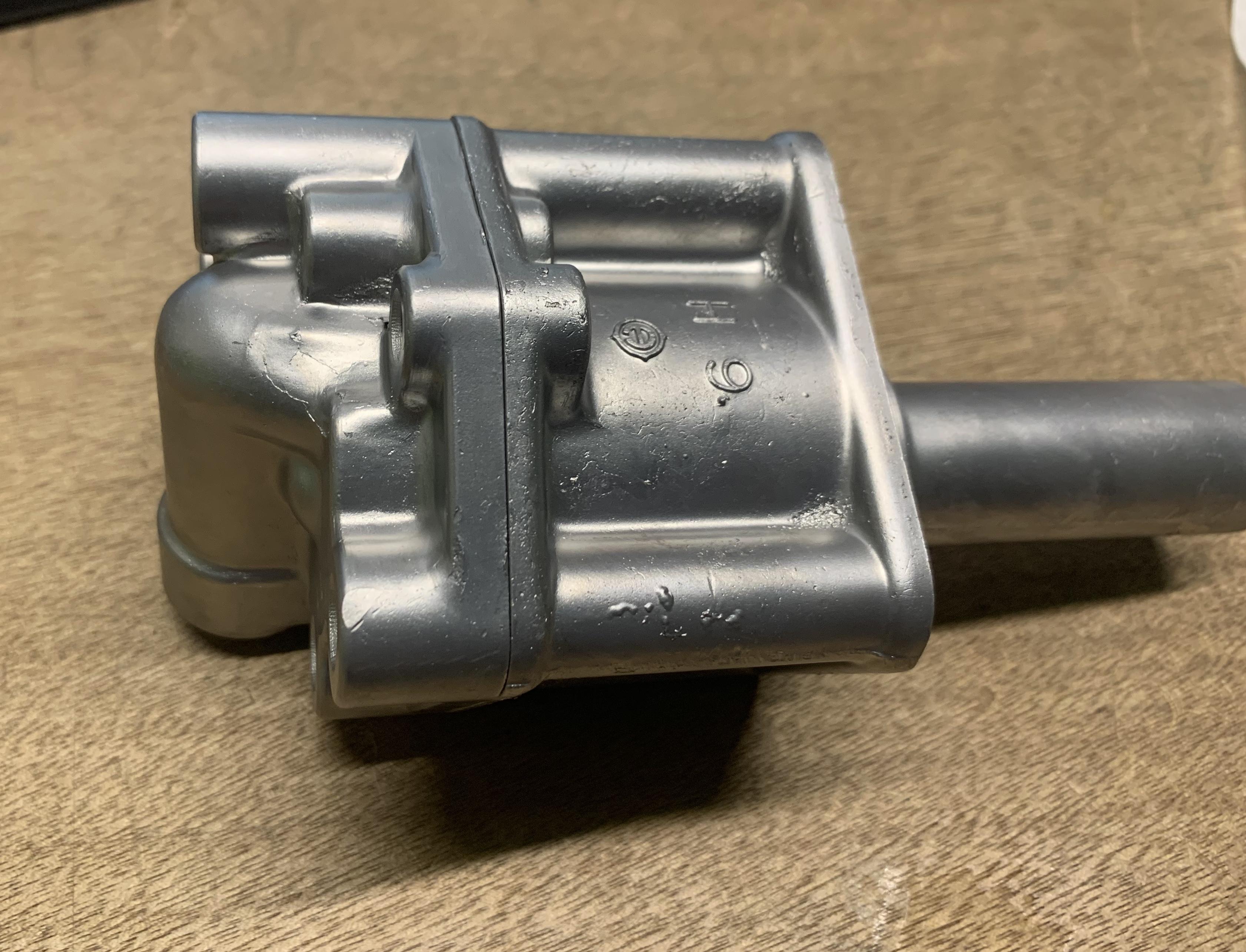

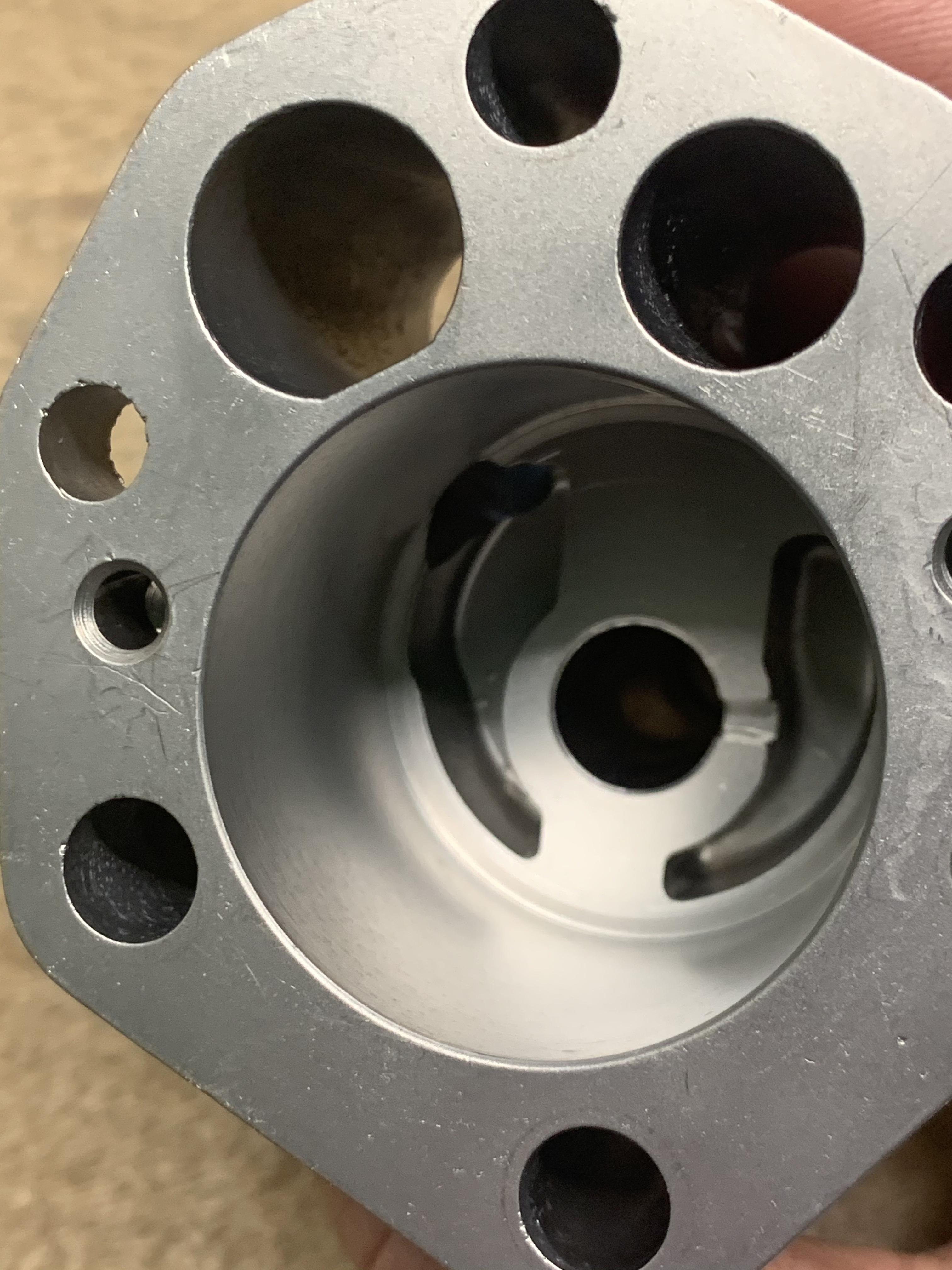

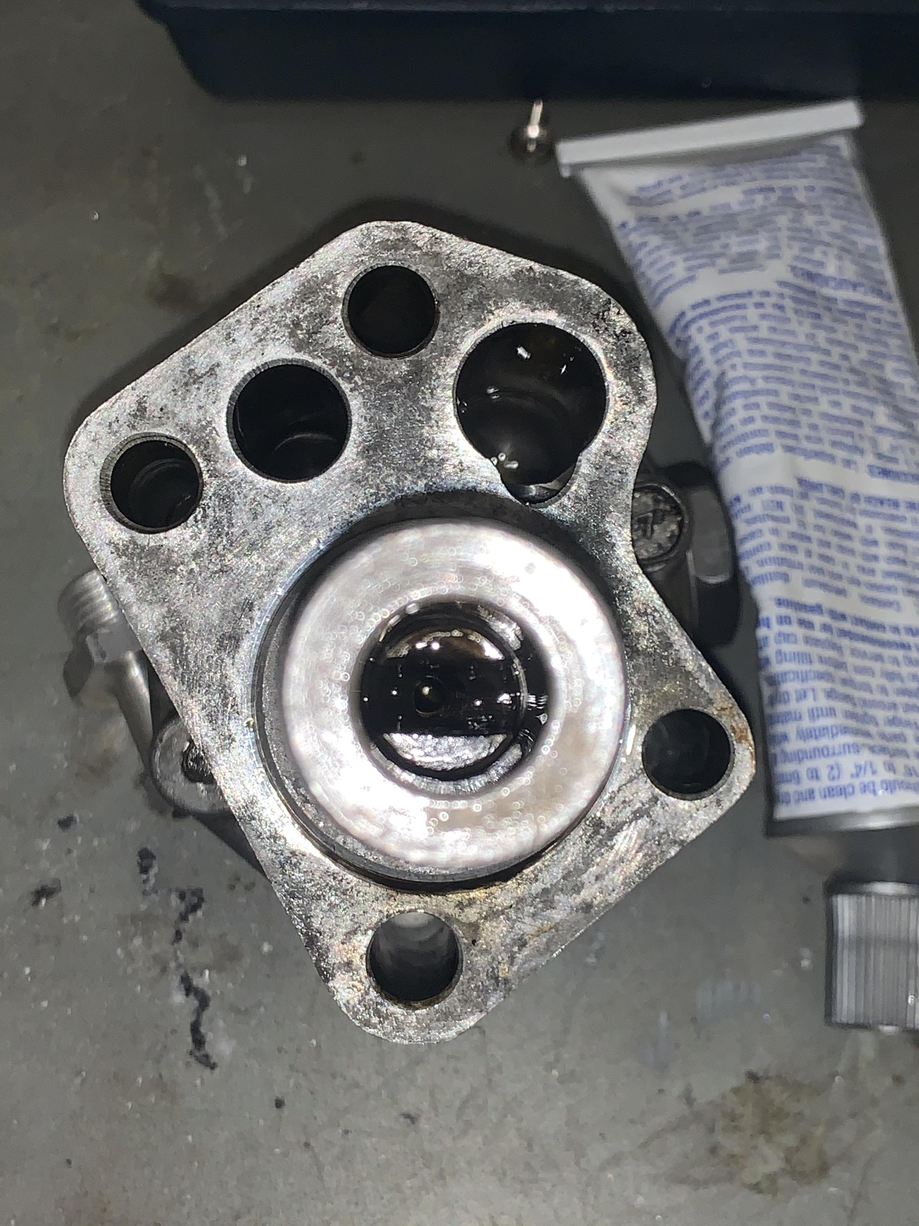

Rebuilding my stock oil pump. Really it looks brand new inside. It was the original and still had overspray on it!
