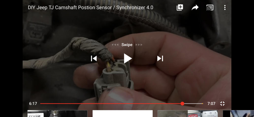

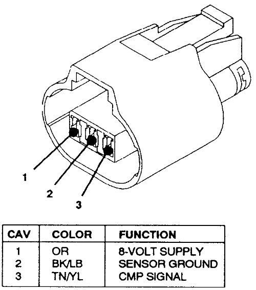

Question regarding the cam sensor . Since my pigtail came as a kit I had no ID on colors and thus no idea on pin out. Have you got yours working or do you know the pin out for the 3 wires?
thanks
thanks
This is what I went off of.

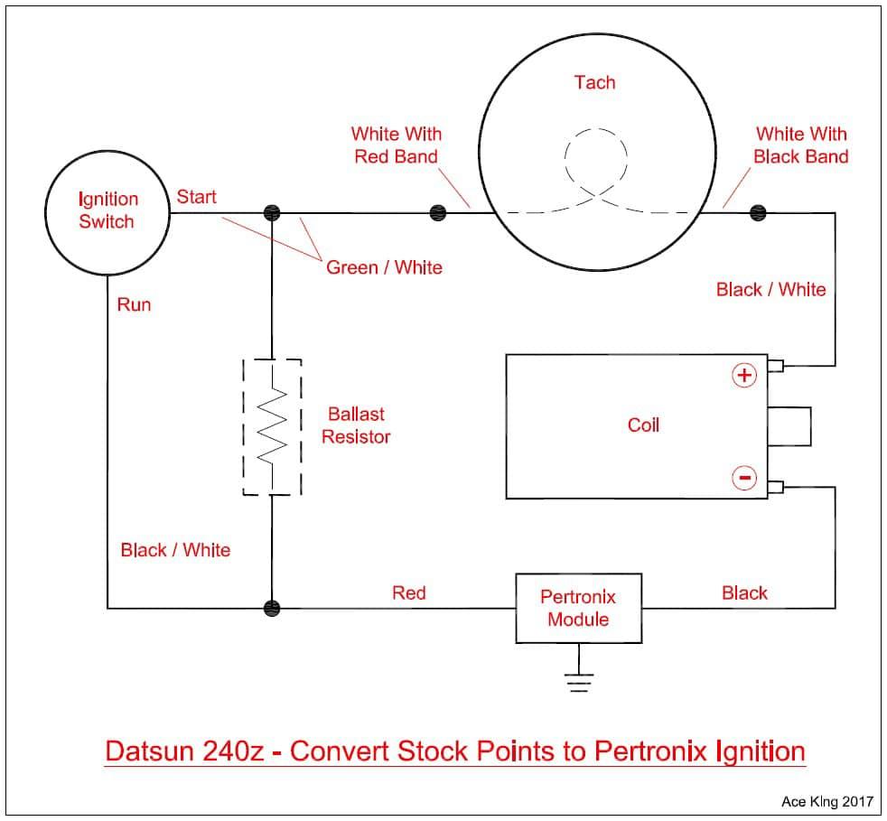

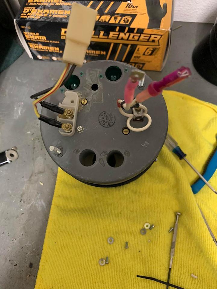

Well my stock original 1971 series 1 tach works with my fully sequential r35 coil on plug Efi system (haltech elite 750) . I literally ran the coil positive out from the ecu through the white wire with a red band then out to the coils through tachs white wire with a black band. Nothing else was needed. Added about 15” to my entire positive for the coils. I like how the tach feels and reacts the same as it always has. This would work on any 240z tach and a rb swap or aftermarket Efi with COP and fully sequential. I don’t know if it would work on wasted spark or not. Thanks Dirk Stoop for pushing this way vs the others.
Where I got the idea
https://www.viczcar.com/…/9515-getting-a-240z-tacho-to-wor…/
