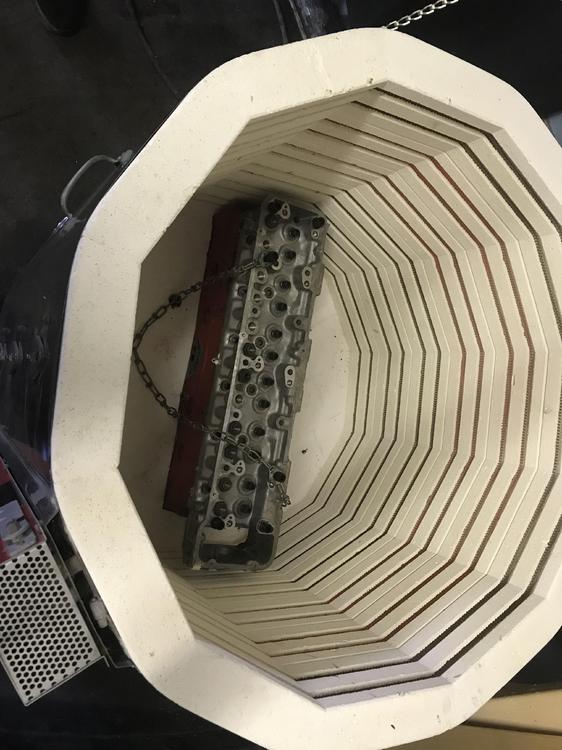

The engine was the sneaky part . I didn’t race or solo cross at all ,so not familiar with the rules as far as mods. So it looks as if he ran a stock cam on a shaved head ,bigger valves , but punched the block out to 86mm- which no one would know unless it was cracked open . It had triple Weber’s and a header at one time .
Kind of fun trying to put the puzzle together
