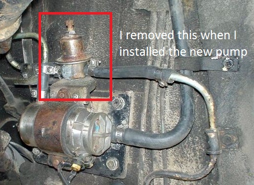

Ill will get around to it this weekend checking again over the sensors and readings. One quick one if you think its super rich, When I replaced the fuel pump I did away with the pressure regulator?? that is connected very close to the fuel pump. See photo attached. I assumed that my new 32PSI fuel pump matched that of factory so wouldnt need it. Do I need to put back in this factory part? Could that be some of my problem?
Thanks in advance.
pretty sure the factory pump is rated at 55psi, most aftermarket pumps are 90psi. I went factory since you can still get them. I pretty much use that logic on all parts (if factory is available use that). That being said the fuel damper was part of the orig design so I see no reason to assume its ok to delete it. Maybe it will be fine but you just keep adding variable when deleting or re engineering stuff. The stock setup works very well, that includes all the EFI, EGR and PCV systems. You need to get a fuel pressure gauge hooked up and then go thru the entire EFI section of the FSM in a methodical way. Things not generally covered in the FSM directly will be rust in the tank and the fuel lines. It does cover it indirectly by spec of the PSI and volume of fuel that is being pumped. Old school diagnostics start with a check of the plugs, how do they look? you can get a lot of insight into the condition of an engine by checking there. Also a good cylinder compression check is one of the 1st things to go to for overall health of an engine. But again all this is covered in the FSM,

the fuel pressure is maintained by having a pressure regulator that monitors the engine vacuum to maintain a constant pressure relative to that. 36psi is where it should be with the pump running but the engine NOT running (no vacuum in the intake manifold). at idle you are more likely to see 30psi assuming all things are working as they should. The pressure will rise and fall based on engine vacuum. A massive air leak would therefore effect not only unmetered air but the fuel pressure regulator as well. You may want to get a vacuum gage hooked up as well. Vacuum leaks can create havoc. check all hoses and don't forget the PCV hose on the crank case AND the PCV valve. This assume you have a vacuum leak issue of course.
the excess fuel provided by the pump will be returned to the tank via the return line. I suppose you will be ok with a non standard pump but again you are introducing a variable into the system. Its hard to know how to proceed unless you start by baseline the pump (pressure and volume AT the fuel rail). I started with a factory pump just to be sure I did not have an issue. What was in the car was one of the high pressure skinny long pumps that was good for 90psi.
