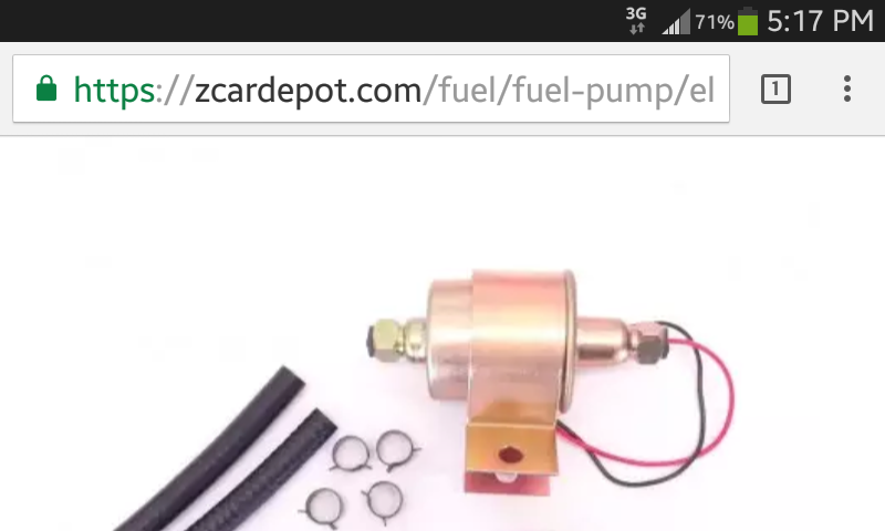

3 hours ago, siteunseen said:
You may be on their list too but I got an email from Zcardepot.com that has a 240/260 low pressure pump set up on sale for under $30. Check it out if you haven't seen it. Looks like a good one to me.
Yeah this one? https://zcardepot.com/fuel/fuel-pump/electric-fuel-pump-carburetor.html?search=Fuel+pump
Looks like the Airtex:
https://www.amazon.com/Airtex-E8016S-Universal-Electric-Fuel/dp/B000C1LW0E/ref=sr_1_1?ie=UTF8&qid=1499569897&sr=8-1&keywords=Airtex+E8016S
