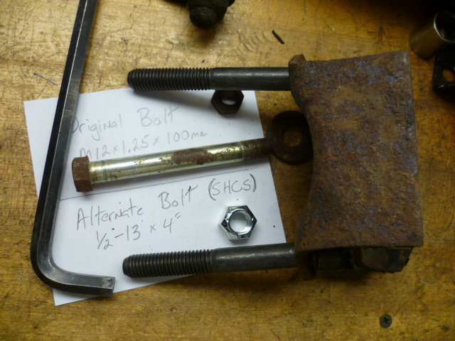

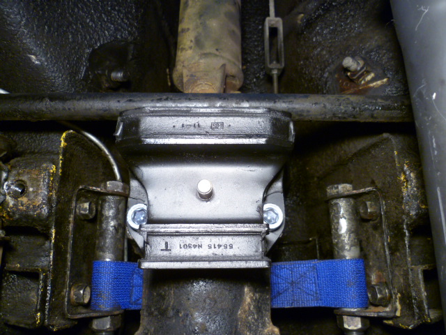

When I was messing around with my diff, I replaced the original mount hardware with socket head cap screws coming up from the bottom instead of the original hex head bolts. Here's the thread where I was talking about all of it. Thread is pretty much useless now because all pics are dead because Photobucket SUCKS, but here it is anyway:
http://www.classiczcars.com/topic/55955-my-new-diff-mount-and-strap-project/
The bottom line is if you go through the effort to take the front diff mount off, I would use different hardware when you put it back on. Here's a couple pics showing the idea:

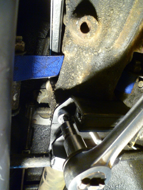

argh, so I ordered the wrong bushings AGAIN, I think I have cornered the market on outer CA bushings, so waiting again for the INNER FRONT  bushings. I will NOT be replacing any of those and now I have 6 of them. More on the diff mount, I can get at the nuts on the top pretty easy with the struts out, got a breaker bar on it but that has limited throw, so I went with my 1/2 ratchet. I put what feels like an insane amount of pull (don't want to pull the car off the jack stands) and nothing, tried PB plaster and penetrating stuff to no avail. this is when I really wish I had that induction heater tool. Anyway since I have to wait for the bushings I will try one more thing, the freeze spray stuff. If that does not do it I will just leave as is. This has got to be the longest my Z has not been started since I have owed it.
Which hardware is giving you an issue at this point? You indicate you are working on the diff mount and you have the struts out but I cannot picture which fasteners are giving you trouble.  I did a full rear suspension rebuild on the '72 240z I owned and can't remember anything but the spindle pins giving me any real trouble.
The front diff mount, as seen in Capt O pics. Spindle pins were easy on mine. Figured while I have the struts out I would have good access to it.

Okay.  So you can get the nuts off of the top but the long bolts are stuck?  If that is the case, just drop the diff to work on getting them out.  You are taking everything else apart, getting the diff out, cleaning, painting it along with a drain and re-fill of fluid will help round out your rebuild efforts.
nuts stuck, don't know if the bolt would then be the next issue, I am sure its frozen as well. I don't have to hold it so it clearly is in there stuck too (or it just so tight it does not need to be held from the bottom). For now I am just going to leave it be, insulator looks ok, I had a new one but not worth the effort at this time. Diff has had a recent drain and refill.
