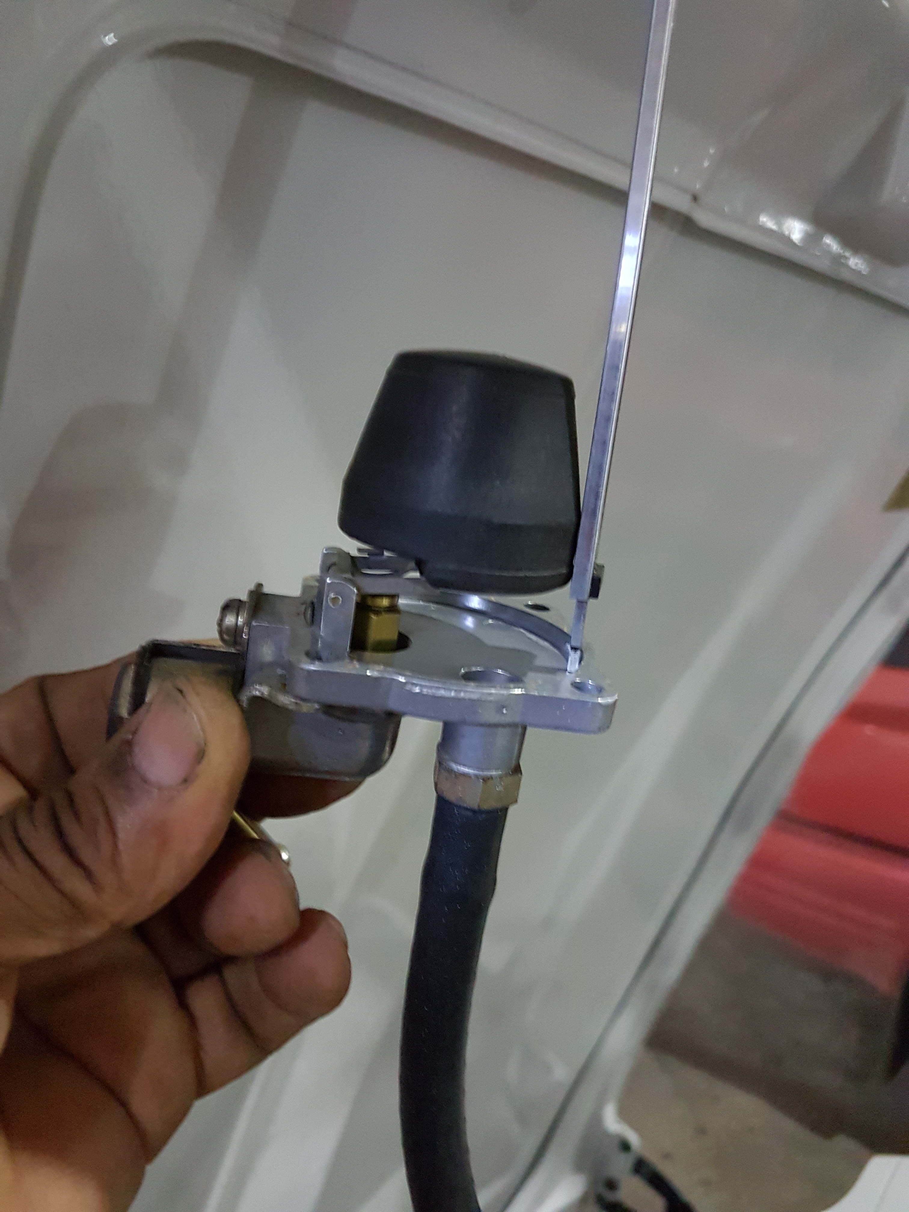

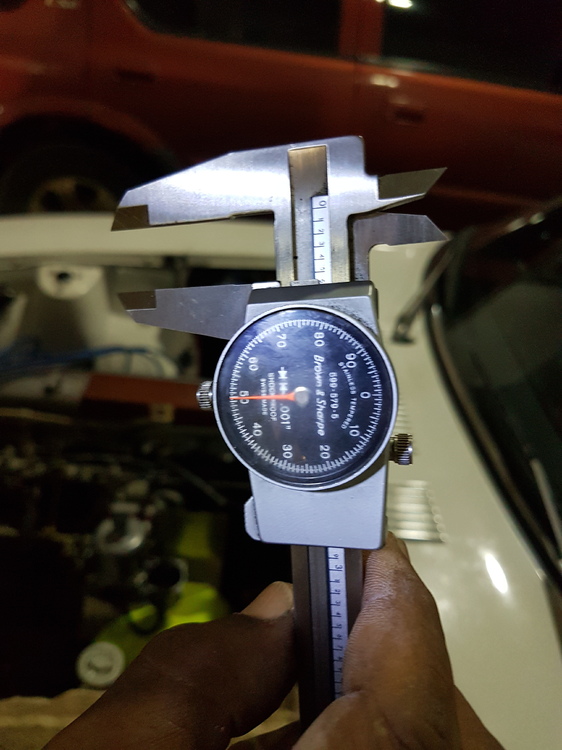

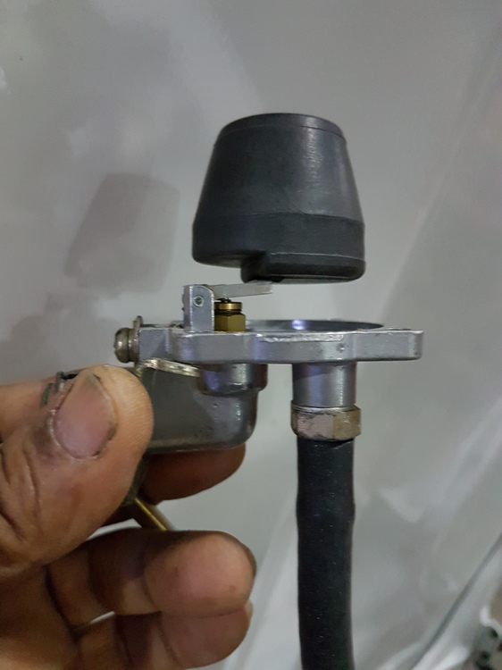

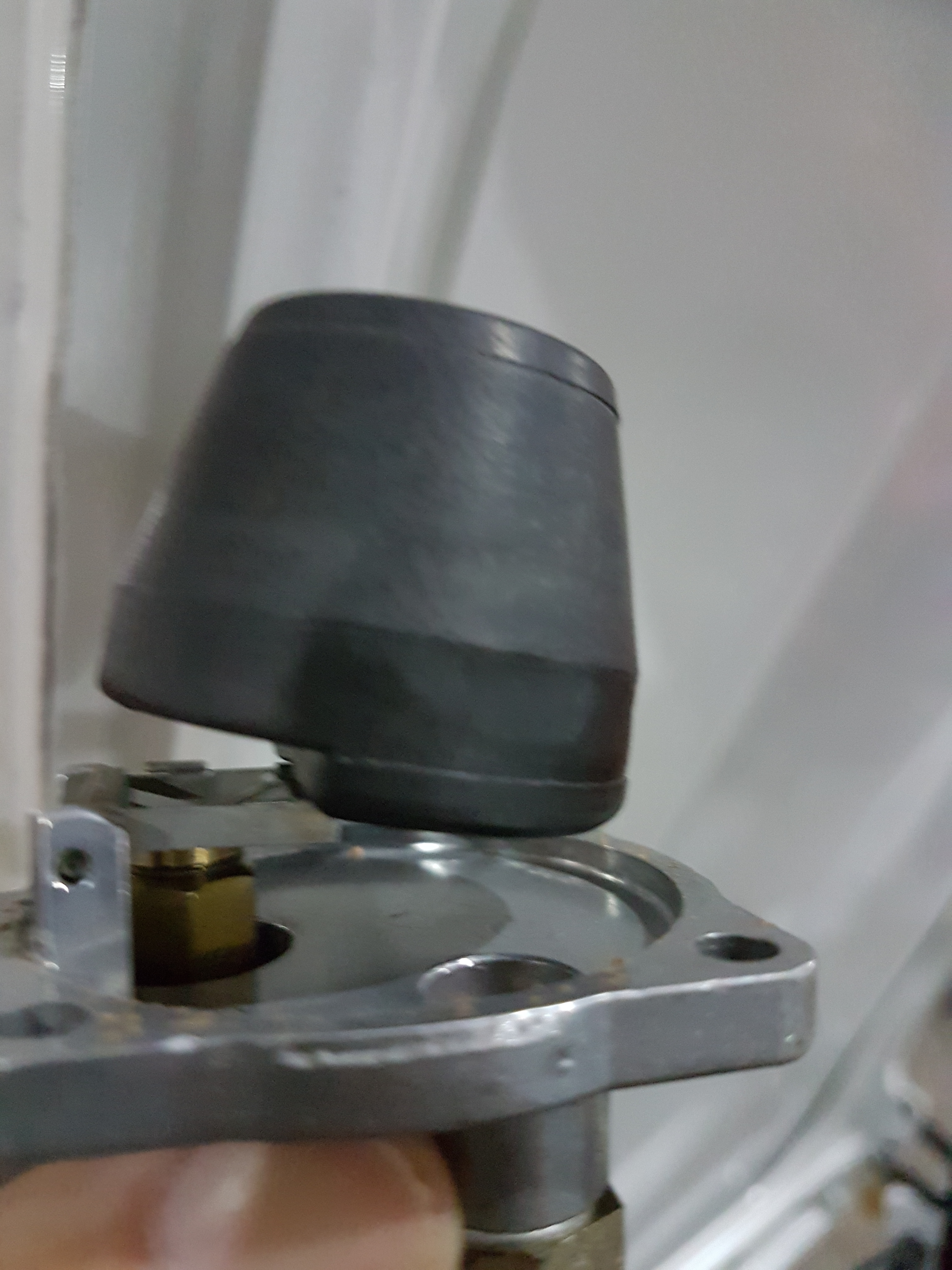

Just opened the float chambers of both carbs. The level on both of them were wrong. I have set them to 9/16 as per ztherapy sheet. Cant believe they were that wrong.
I was always told that you can't just let them sit & measure the 9/16".  You need to blow through the float bowl hole (through the needle valve) and make the 9/16" when the valve closes.
 How far off were they, and were they both the same?
The fuel level would have been too high with the floats adjusted like the first picture. Which would mean you would need 2 1/2 turns or less. At 3 & 4 turns I would expect flooding issues

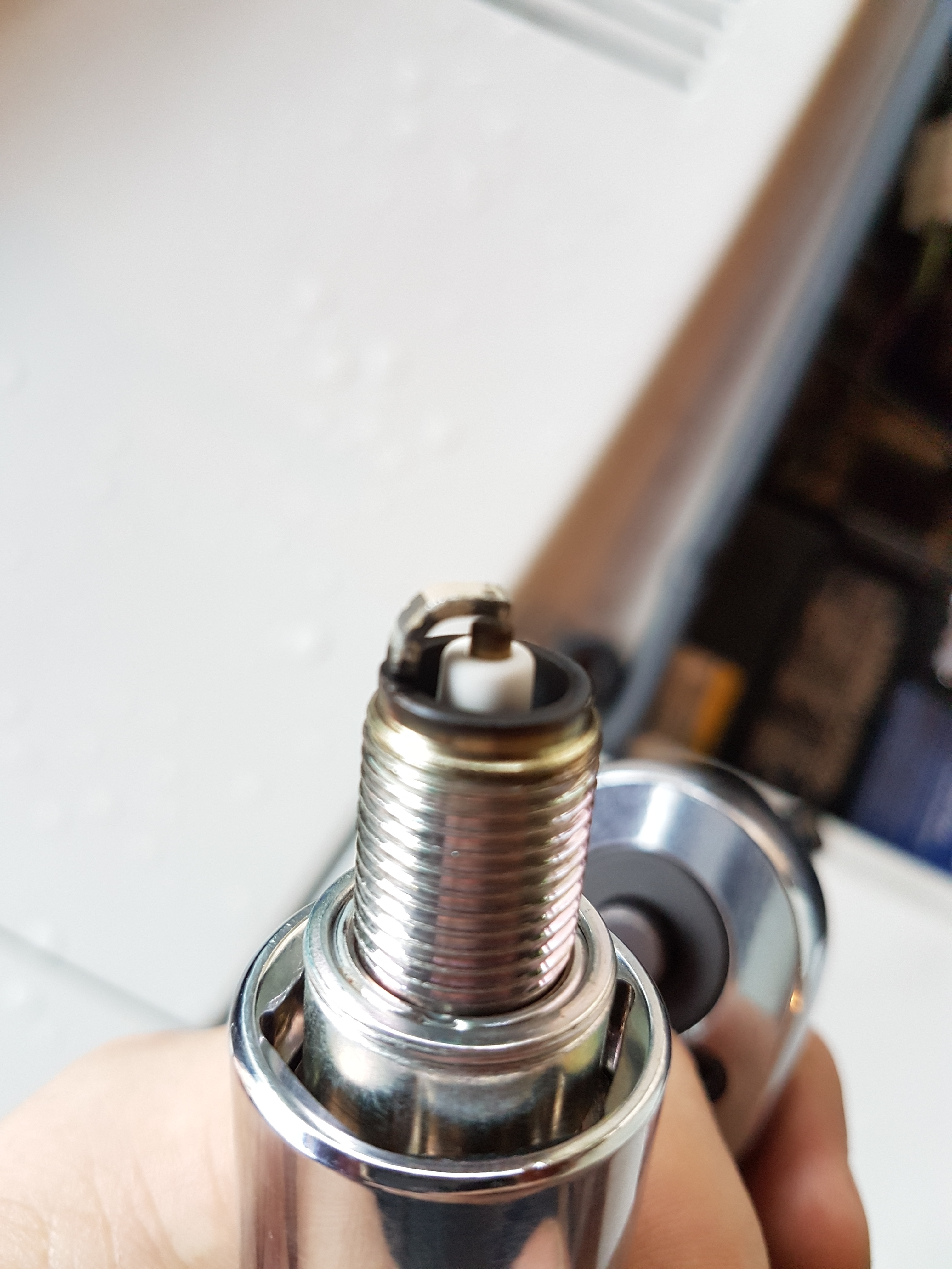

13 hours ago, jalexquijano said:
Well im at 3.5 turns clockwise and this is how its burning the plugs.
They look a little lean to me. How is the engine running? Have you installed the sight tubes on the float chambers to check the float level? In old post by @Bruce Palmer(Ztherapy), he says "Pull the chamber and piston. Look down at the top of the nozzle. The fuel level should be about 1/16" below the top of the nozzle for proper operation. Congratulations! It looks like progress to me.
