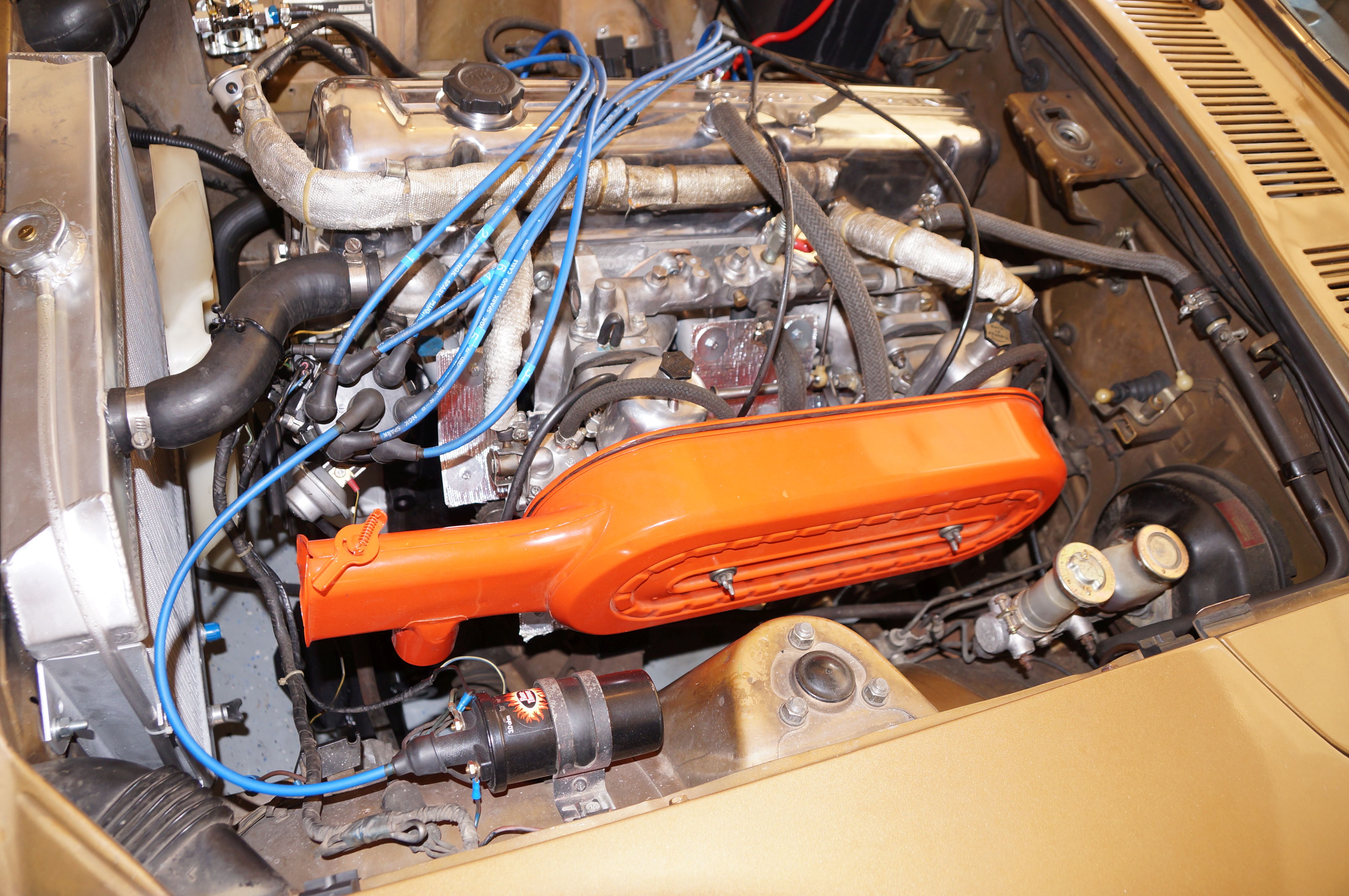

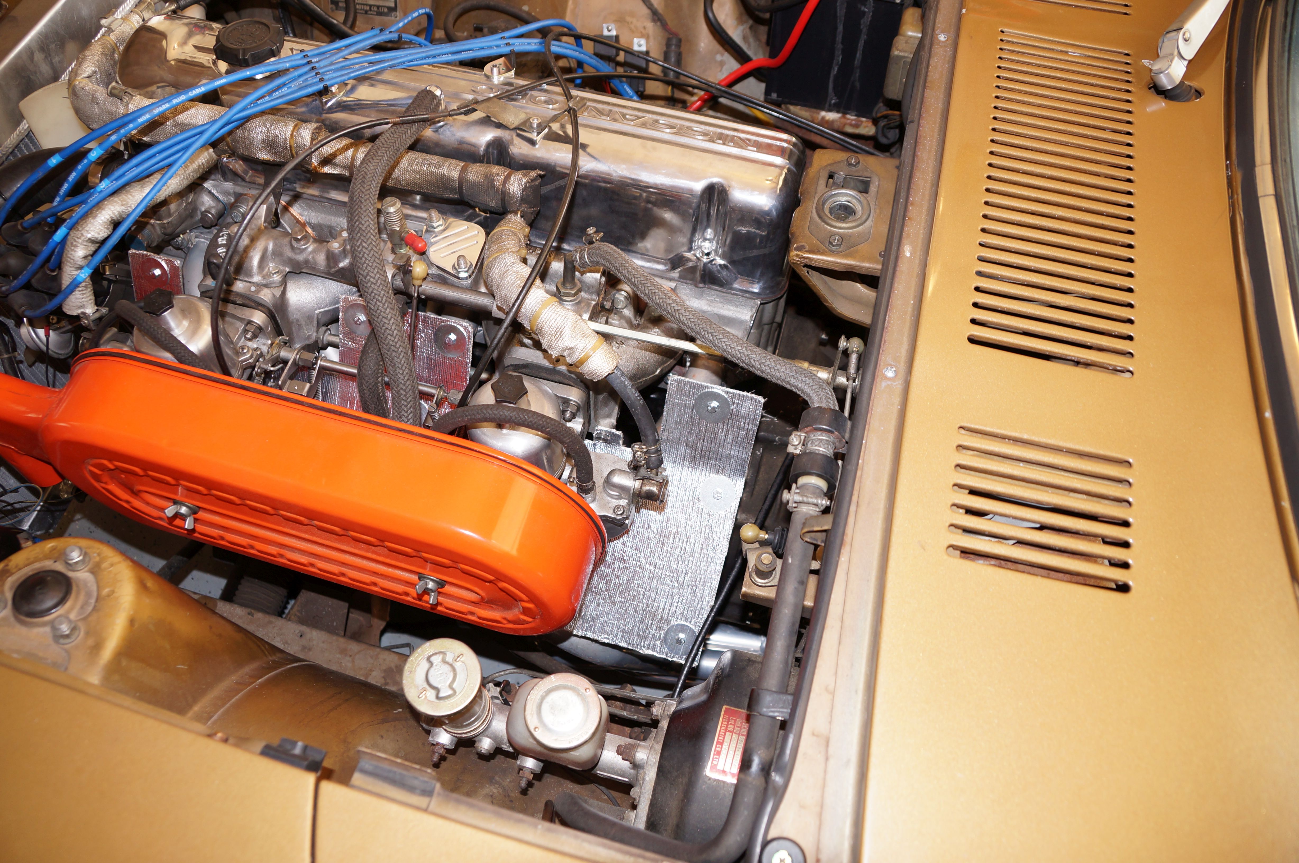

April 22, 20178 yr Author comment_518754 Here are a couple of photos of the heat shield. Maybe I'll take some later without the air cleaner in place. Link to comment https://www.classiczcars.com/forums/topic/57414-cant-maintain-fuel-pressure/?&page=4#findComment-518754 Share on other sites More sharing options...
April 22, 20178 yr comment_518779  Good looking heat shield. Do I see a future garage business in the works? A bolt on answer to the heat soak problem would be a valuable addition to the owners who haven'r solved it yet.. Link to comment https://www.classiczcars.com/forums/topic/57414-cant-maintain-fuel-pressure/?&page=4#findComment-518779 Share on other sites More sharing options...
