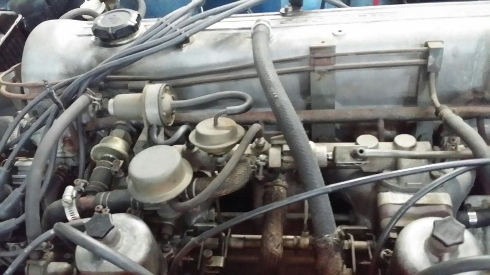

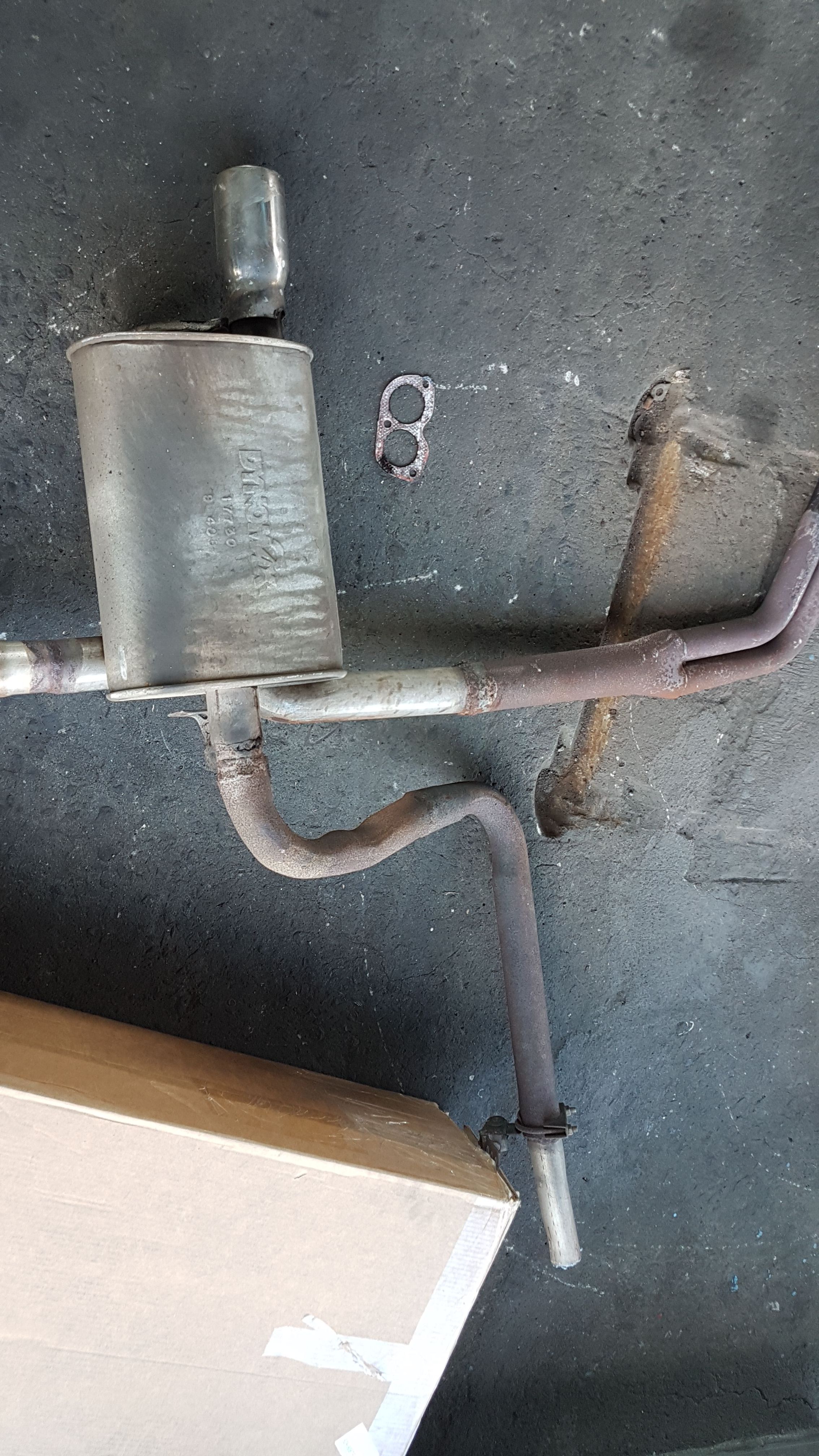

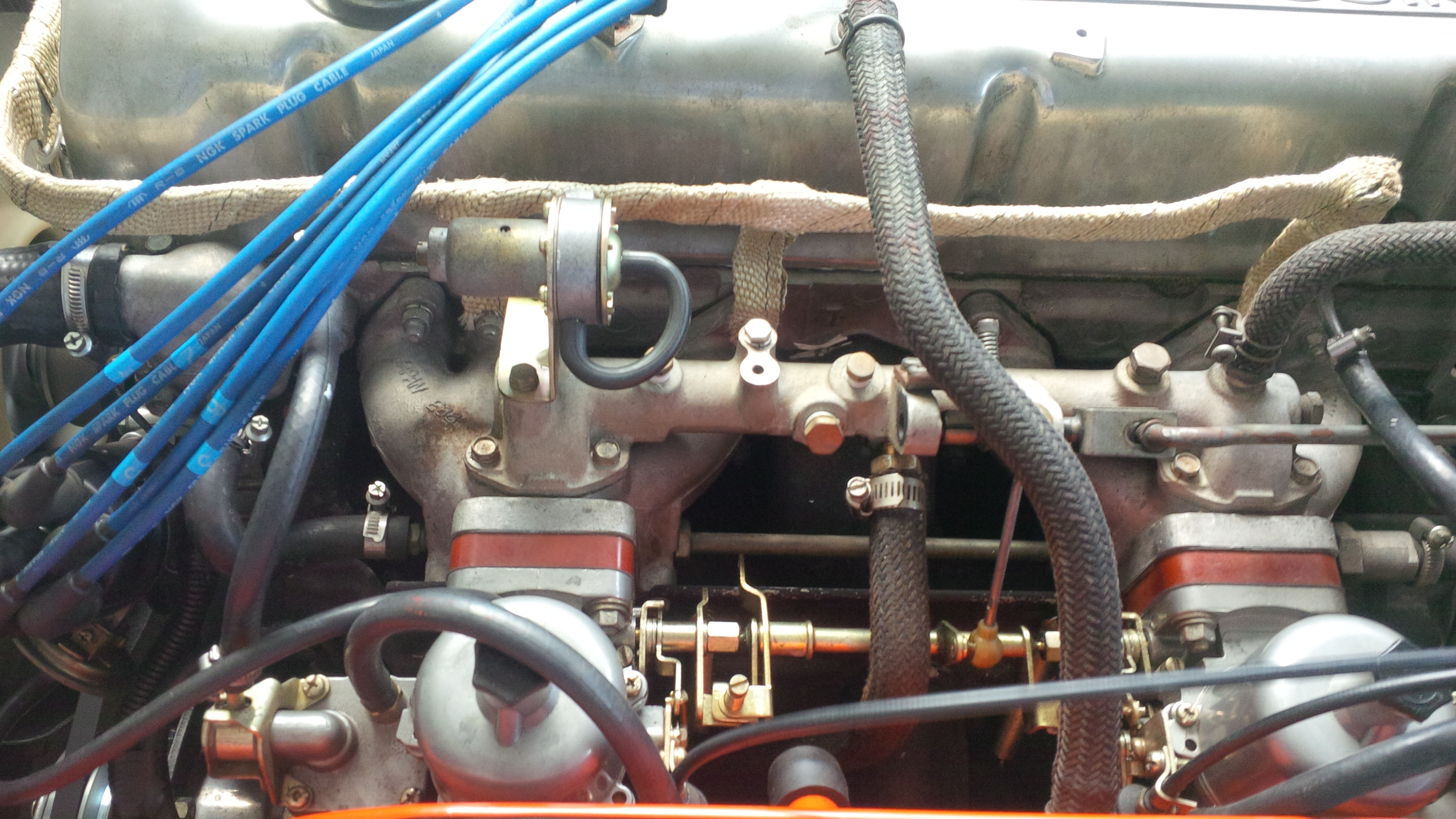

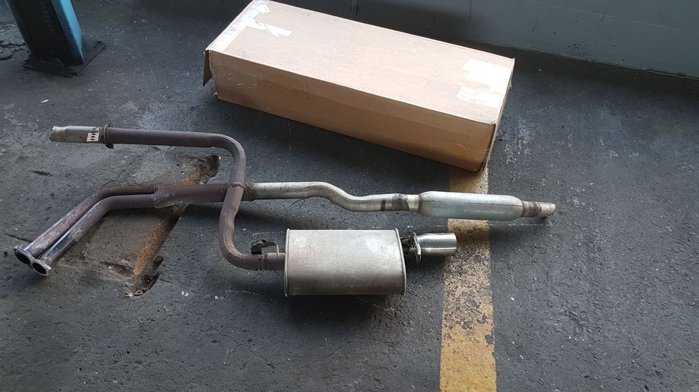

May 7, 20178 yr Author comment_520138 Well honestly my mechanic had removed the anti backfire valve, and emmission devices that where fastened to the balance tube. He also removed the air galley. I dont know if the smog pump was removed or not by Previous Owner. I do believe so as the engine block had the blank space to bolt the compressor bracket to fasten the AC Compressor which i installed last year. Anyway, if i dont have the air galley installed any longer and it forms part of the emission system, even if i source a NOS Anti backfire valve, once installed it would not cause any effect to avoid the deceleration popping at the exhaust. Any other way of preventing the deceleration popping at the tailpipe? Buying a NOS Antibackfire valve is not the solution!!!! I did took a picture of the old Steel exhaust system and only stayed with the original downpipe. The rest was dumped. The last picture shows how my car was when i bought it. I did stored the anti backfire valve but i dont think it is working and the air galley was rotten so i am not putting it back. with the lousy former exhaust i had no deceleration popping so replacing all of the emmission system parts is not a solution. Edited May 7, 20178 yr by jalexquijano Link to comment https://www.classiczcars.com/forums/topic/57338-replacing-exhaust-system-on-my-72-240z-from-the-manifold-to-the-back/?&page=4#findComment-520138 Share on other sites More sharing options...
