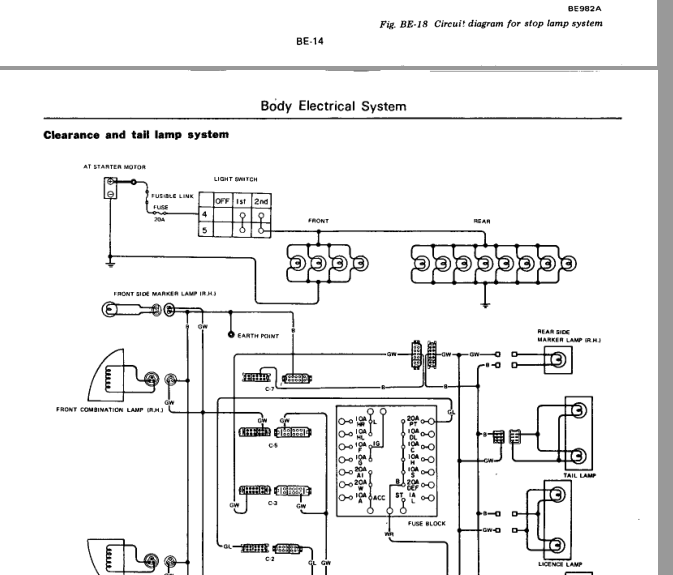

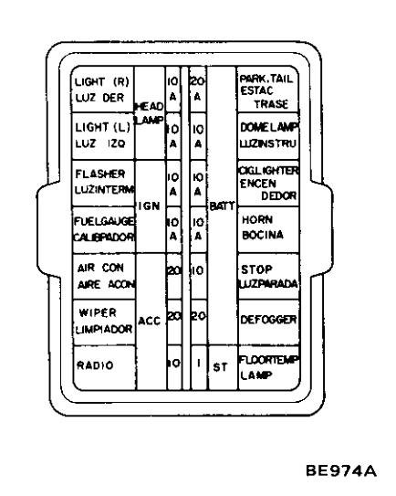

I think that there's only one for the circuit he's talking about.  Brakes are on their own circuit, as are headlights and turn signals.
Edit - just noticed that turn signals are shown as 4th down, but the fuse box cover shows that as fuel gauge.  Nissan maybe ran out of space?  Shown in the wiring diagram though.  FSM weirdness.
