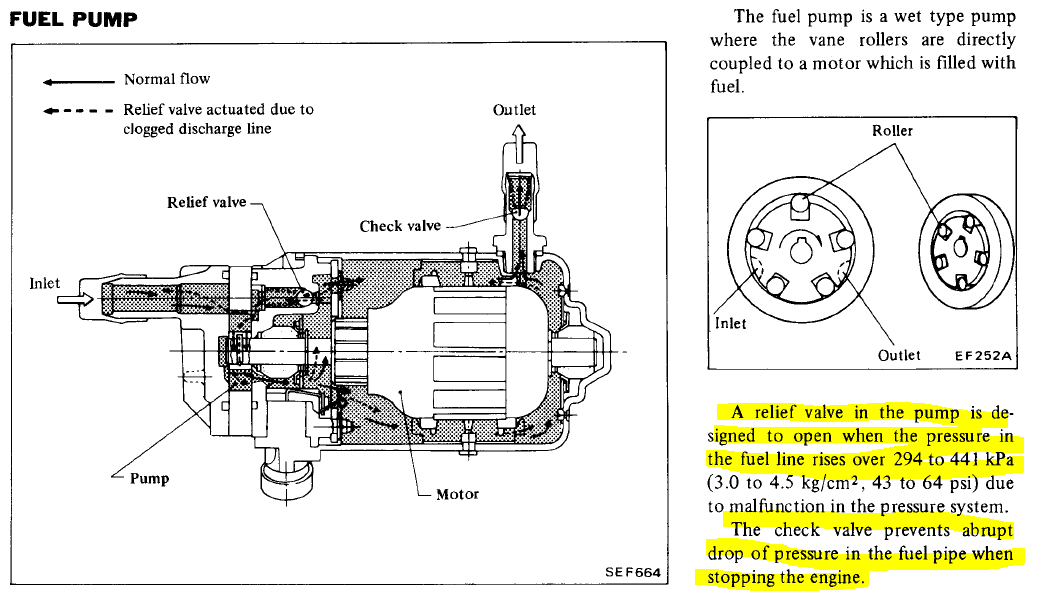

Forgive me but where is the check valve? If there is one I've never known this. Are you referencing the fuel damper right after the fuel pump?
OE pumps had a check valve built in at the outlet. I recently replaced my airtex unit, do not know if the skinny after market pumps came with one, I assume so  but cant say for sure.

I'd be Interested to know when the newer style slender FP came out and if they were ever factory.  I checked both the 82 and 83 FSM and they show the same style as the 77 FSM.  I bet Dave is right your pump check valve is going bad.  See yellow comments.  This is from the 82, but it had the pump pic and verbiage in one shot:

Here's the check valve Captain Obvious used.
