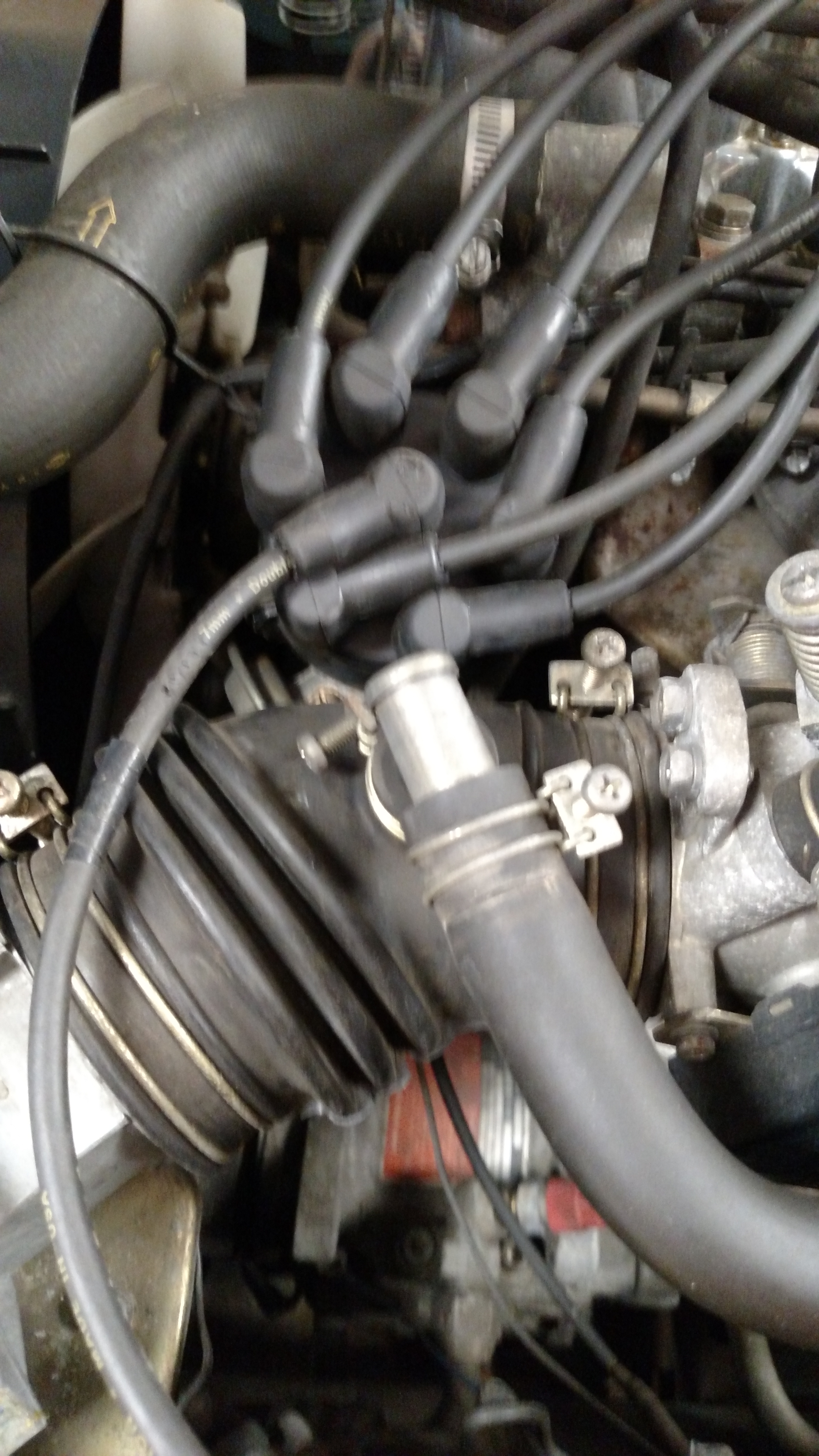

March 1, 20178 yr comment_514067 Those look pretty dark for only 15 min of run time. The boot from the AFM to TB doesn't have any tears in it? Can you post a pic of the engine when you get a min? Edited March 1, 20178 yr by JSM Link to comment https://www.classiczcars.com/forums/topic/56998-engine-rough-running-at-wits-end/?&page=5#findComment-514067 Share on other sites More sharing options...

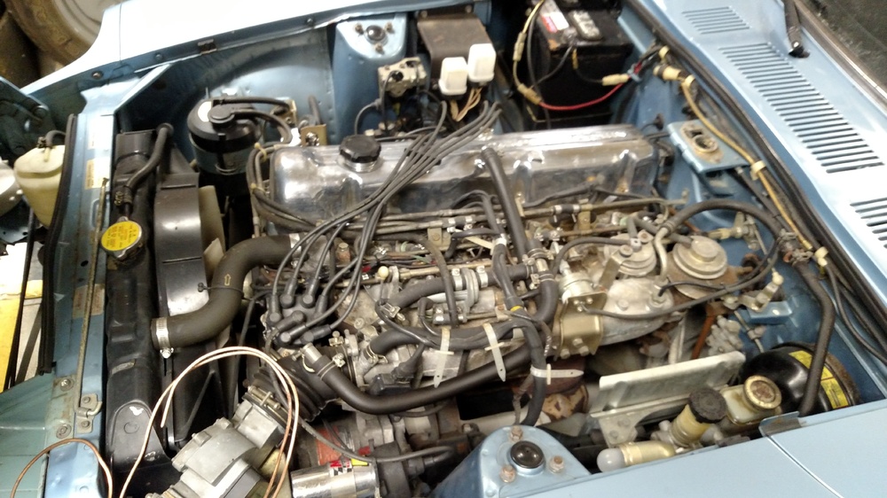

March 1, 20178 yr Author comment_514070 8 minutes ago, JSM said: Those look pretty dark for only 15 min of run time. The boot from the AFM to TB doesn't have any tears in it? Can you post a pic of the engine when you get a min? The boot looks like practically like new. No tears. All the soot has made me think it's running rich. But the popping in the intake has everyone telling me it's running lean. I don't know what to believe. Photo of boot right after I got the car. I've replaced the coil and plug wires since this photo was taken. So disregard the beat up coil wire.  Edited March 1, 20178 yr by the_tool_man Link to comment https://www.classiczcars.com/forums/topic/56998-engine-rough-running-at-wits-end/?&page=5#findComment-514070 Share on other sites More sharing options...

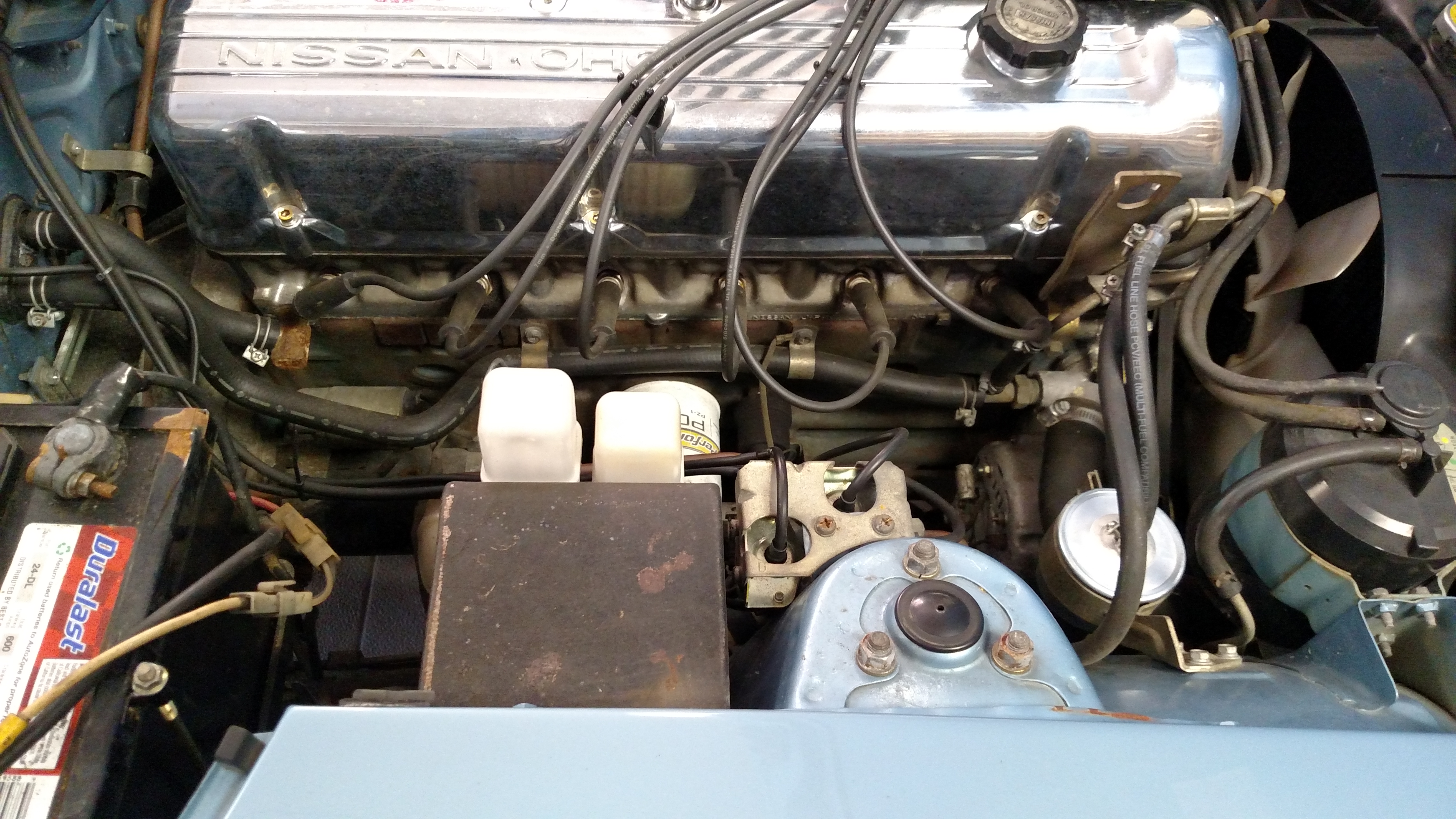

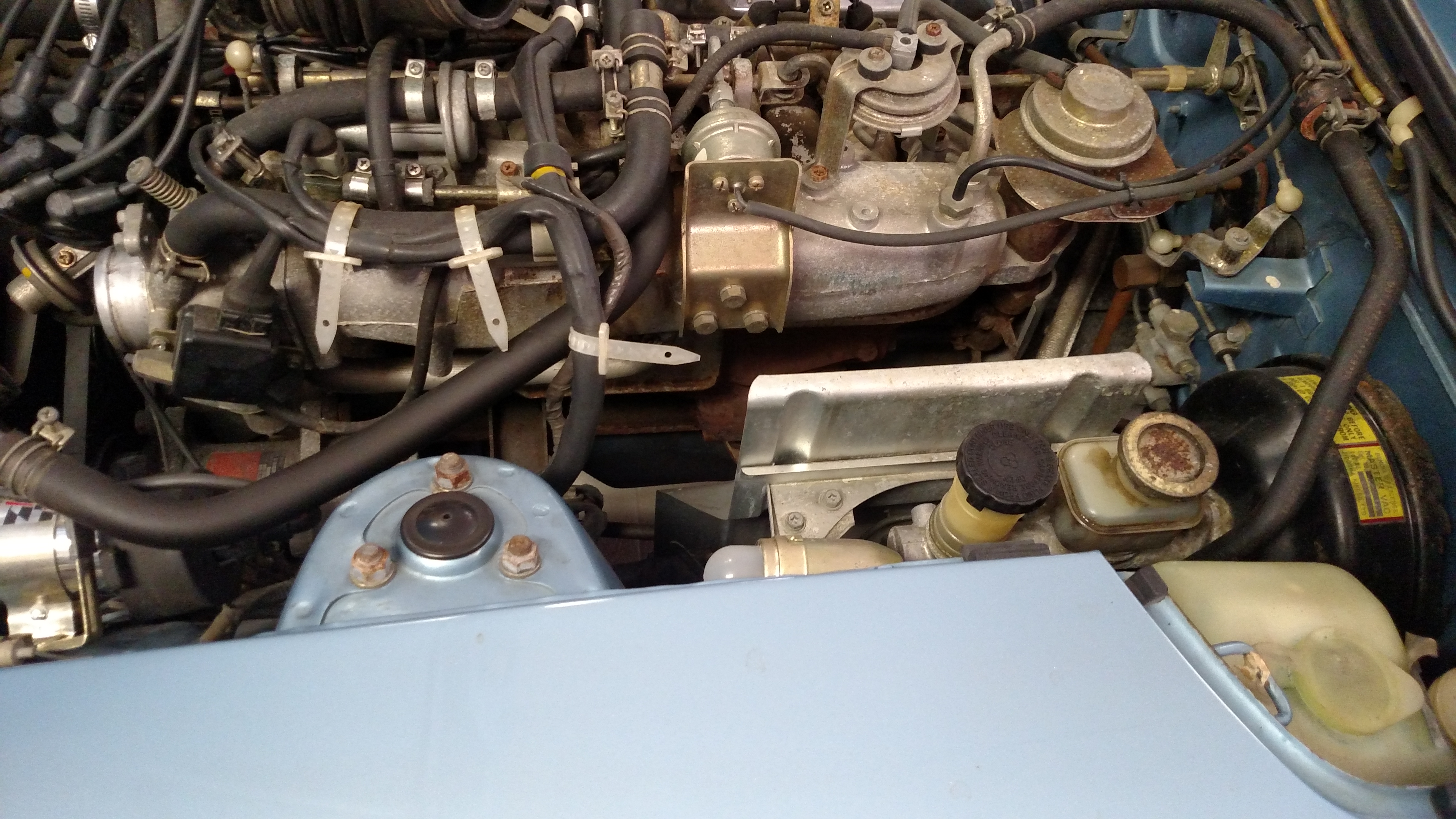

March 1, 20178 yr Author comment_514079 24 minutes ago, JSM said: Plugs don't lie! You have an overall pic? I have one AFM and the car runs perfect. I have another and it pops through the AFM. I have lots of pics. The only overall engine photo is from the day I bought the car (below). The coil of wire around the AFM was what I stuck in it to hold the flap open and let the car run well enough to drive it off the trailer and into my shop, lol. That AFM ended up having an intermittent fuel pump contact, and had been "adjusted" by someone. I replaced it with a known good one from a running car. I've included a couple of closer shots of the sides of the engine in case they help. I've got close-ups of just about everything. So just ask if you want more detail. Link to comment https://www.classiczcars.com/forums/topic/56998-engine-rough-running-at-wits-end/?&page=5#findComment-514079 Share on other sites More sharing options...
March 1, 20178 yr comment_514081 That looks really clean! Â I'm hoping you figure out your gremlins soon. 8^) Â What's the loop of wires around the afm* Edited March 1, 20178 yr by siteunseen Link to comment https://www.classiczcars.com/forums/topic/56998-engine-rough-running-at-wits-end/?&page=5#findComment-514081 Share on other sites More sharing options...
