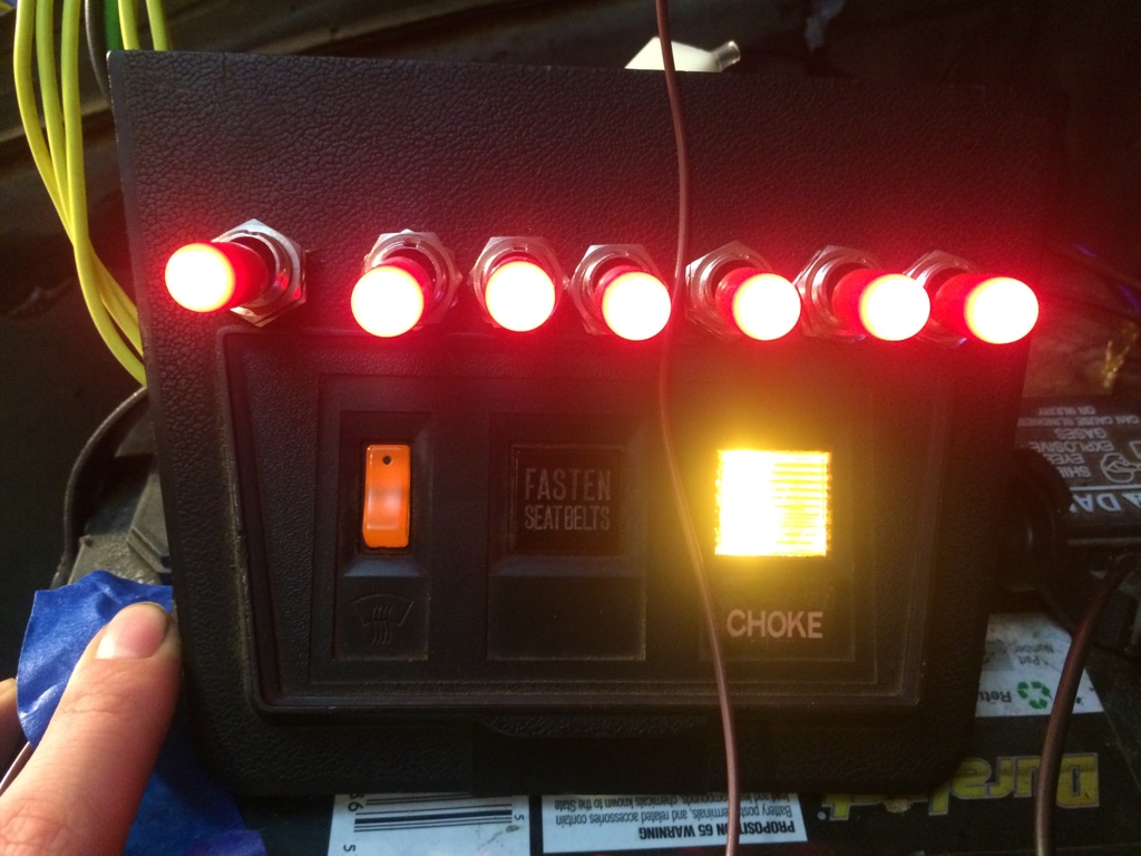

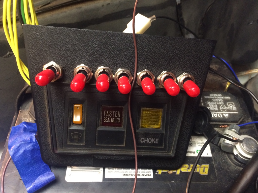

And lastly the center panel with some switch on it. I won't use the fuse box location as it's too small. So a few switches for launch rpm control, dash light, etc.IMG_0401.thumb.JPG.9f5fae9ed62ce2263319bIMG_0402.thumb.JPG.2d0b6b902e6500542196c

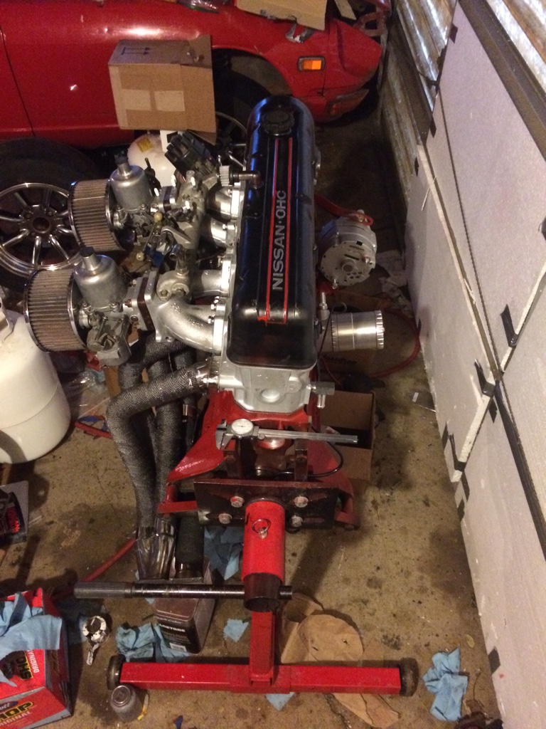

So non-synthetic vr1 or even RP brake in oil? I'm using the stock cam reground by delta. Also sent the rocker arm to renew. New intake and exhaust valves and valve seats, changed the intake to later bigger valves. Nissan head gasket, Kameari timing chain and cam sprocket. Cam tower has been shimmed so the cam will not retard itself. New lash pad and checked rocker pad contact. Everything seems to be in order. Or at least what I see. Now I'm trying to find valve lift using dial indicator. The lobe kept hitting the gauge. I'll post if there's anything unusual.

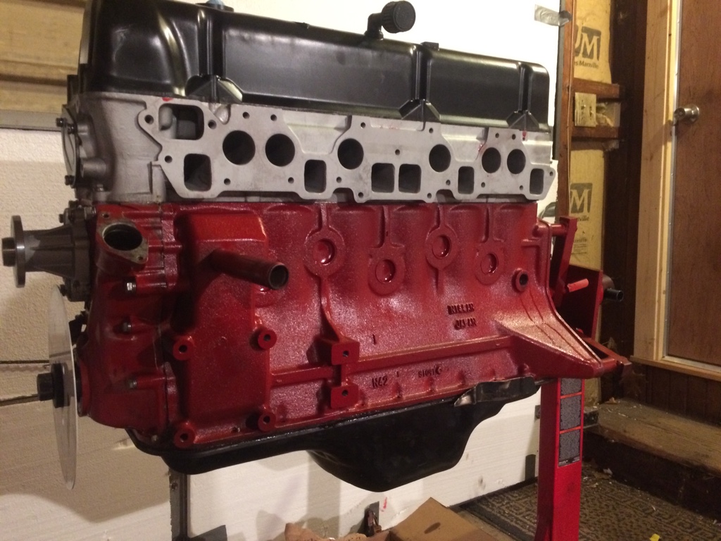

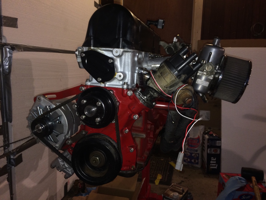

IMG_0423.thumb.JPG.e5eecd6c86381442b28d8IMG_0421.thumb.JPG.002480ea6142d41f62f9f My coolant outlet have the temp sensor stuck in place, and inlet has vanished metal pieces on the neck. Everything else is fine. Probably start putting it in next week.
