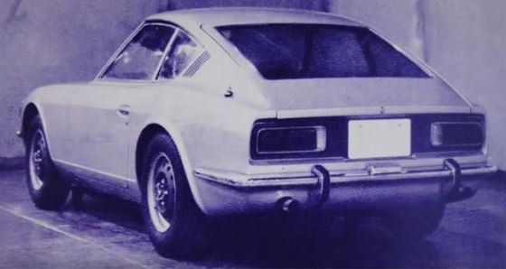

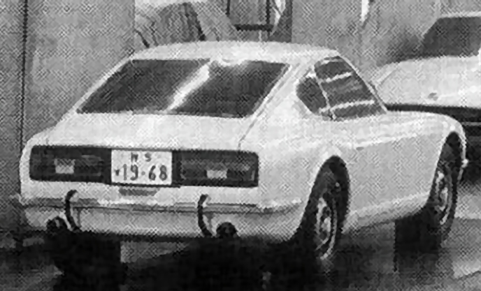

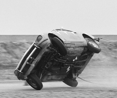

That's because it follows closer the original Nissan design for a twin-pipe system.
Having said that, they sold more single-pipe systems within the JDM and export markets.
The question to be asked is what benefits are there on a stock (and also prepared) engine from a twin-pipe system ? I have my thery but let's hear all yours.:)

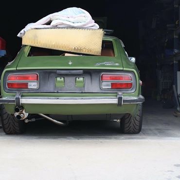

The picture of the red 240z above is the stainless system from Reinhard Japan. It's twin 60mm from the headers all the way through, twin 60mm rear muffler too.
Exactly - Reinhard and thanks for the extra info.
I wasn't aware that it was twin 60mm which is huge (for specific large cc engine applications ?) and a lot different from Fujitsubos' twin 50mm.
For reference, my single pipe is 63mm.

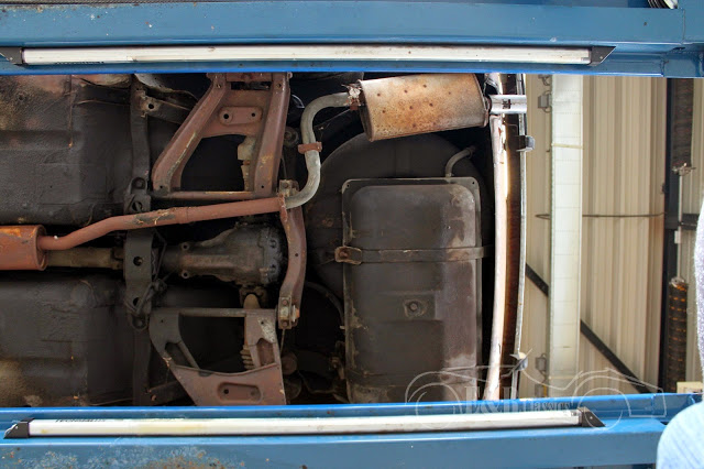

Nice share  - thanks. No fuel tank on the rolled car ? And the size/shape of that which we know must have defined the single-side exit path.....
