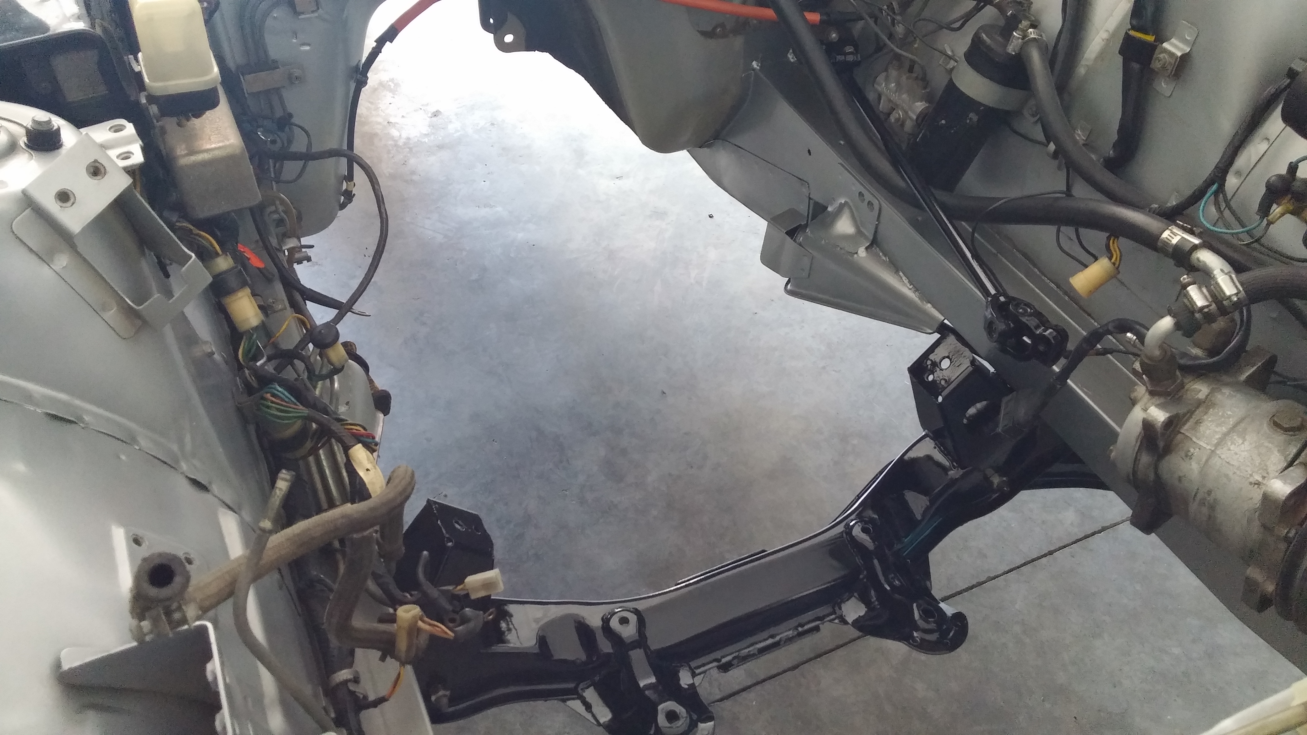

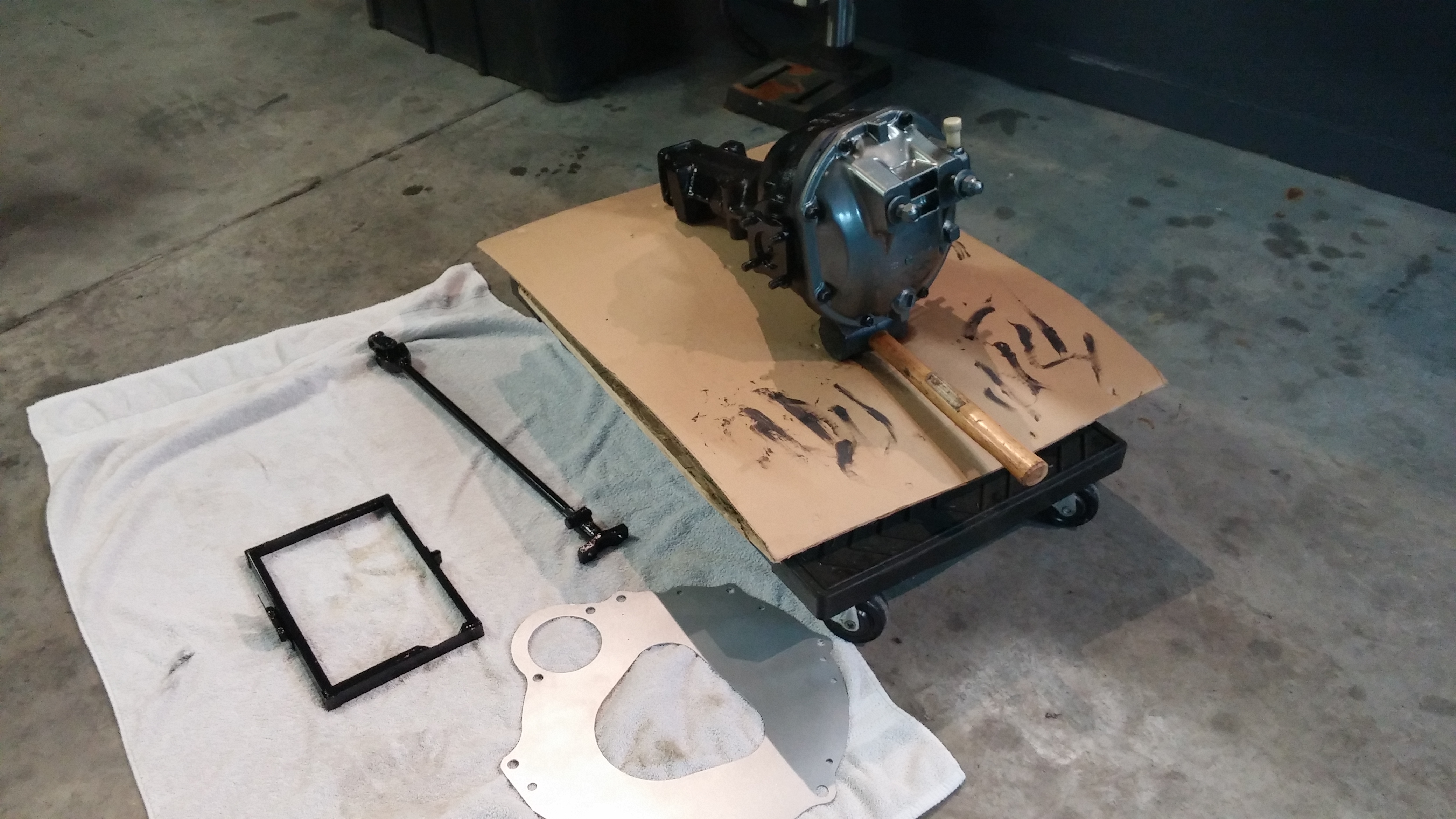

Had a good couple of days at the shop, starting to put a few things together. The non oem motor mounts on Ebay needed the rubber trimmed on each side to fit together properly. Still need the right steering rack bushings, everything else seems to be good, for now.0205171312.jpg
