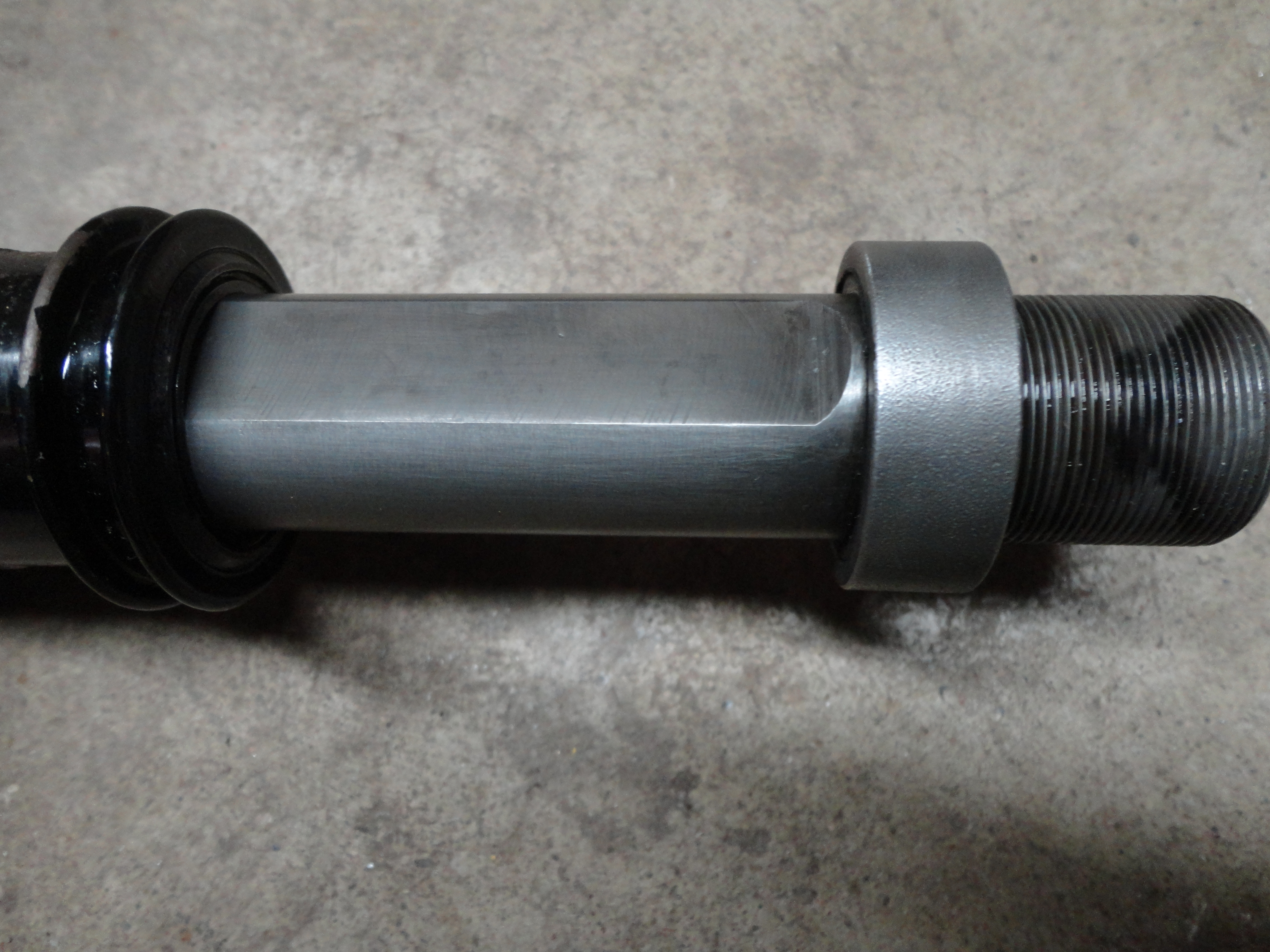

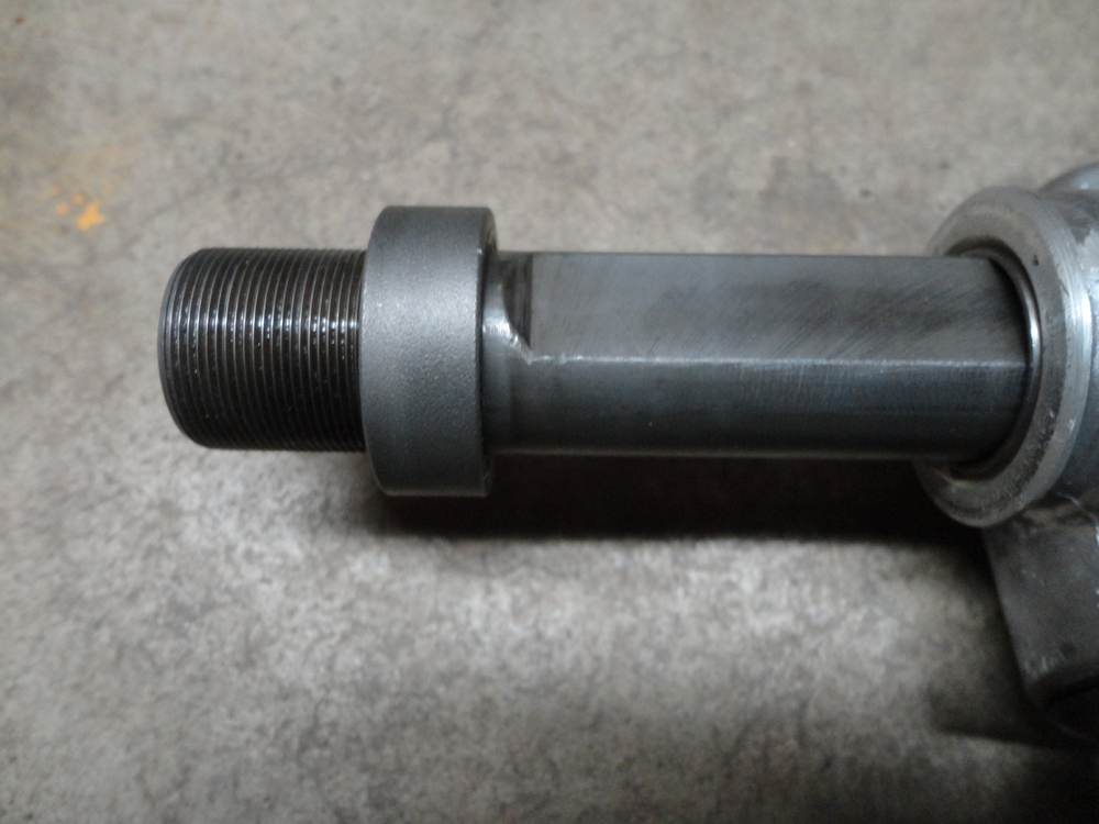

I have a 1972 (July) 240Z.  Can anyone help with my steering rack disassembly.  I have what I am going to call rack stops that are steel rings about 35mm OD on each end of the rack.  They seem to have some type of rubber that can be seen on each side at the ID.  Does anyone know if these are just pressed on and can be removed and then reused.  I want to be able to finish disassembling my rack but the stops are causing a problem.  I have tried twisting but they do not move.  I do not want to destroy them.  I believe this came from the factory as I am the second owner of this car and purchased it back in 1977.

I was just messing with one of these today. On mine I 'unscrewed' them. They are just a steel ring with a rubber lining, covering a zerk port. I tried tapping them off first, but when I tried to turn them, they were about half way onto the threads, so they just screwed off. I figured that was easier on the rubber than dragging them across the threads. I screwed them back on.
Somebody who knows more than me can probably tell us if they are stops, or just covers for the zerk opening, or both.
Now another problem.  Can not get the rack out either end.  It seems like it hits a stop.  Took the top snap ring off and tried to pull the bearing and pinion put it will not come out.  What tricks did you use to get it apart?
You have to get that pinion out in order for the rack to be able to slide out, you could try soaking the bearing/pinion in penetrant and heating the the casing. If you can find a way to hook it up a slide hammer to the pinion that would probably do the trick.
