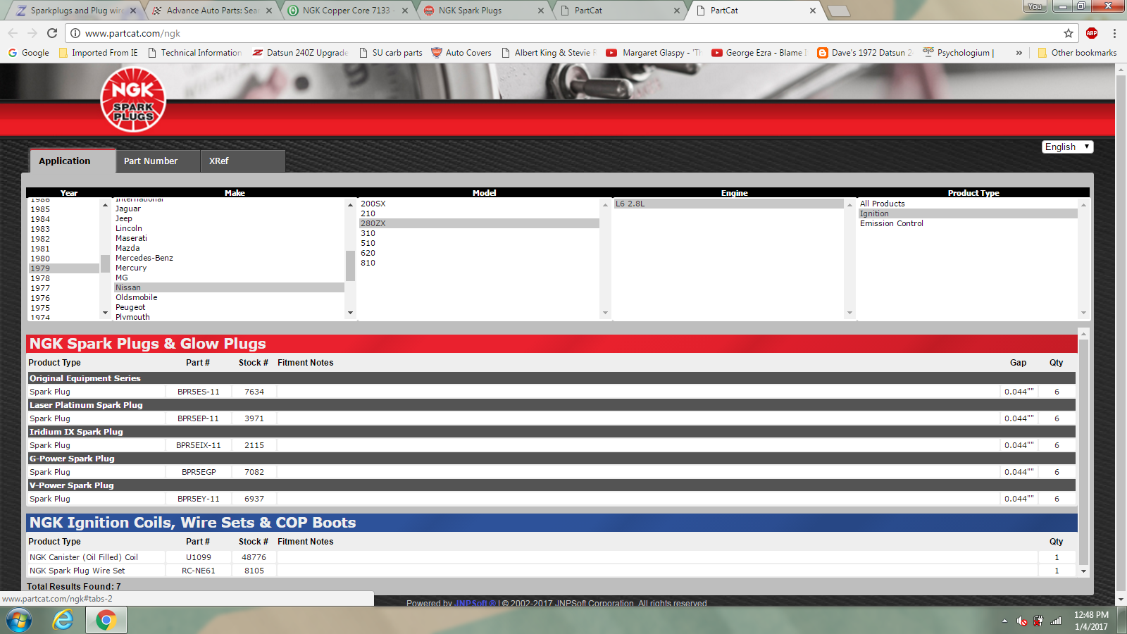

I've always put the BP6ES plugs in my cars.  I did the ZX distributor swap on my 240, '79 ZX dizzy and coil and just widened the gap.
Now I'm bored and go to NGK's website to see what's recommended for the '79 ZX.  They say BPR5ES so I went to a couple of parts stores online and they say the same thing and have them on the shelves, the 6s have to be "shipped to home, non stocking item"

I think I will try the 5s and now maybe I understand the reason they changed, thank you Blue.
