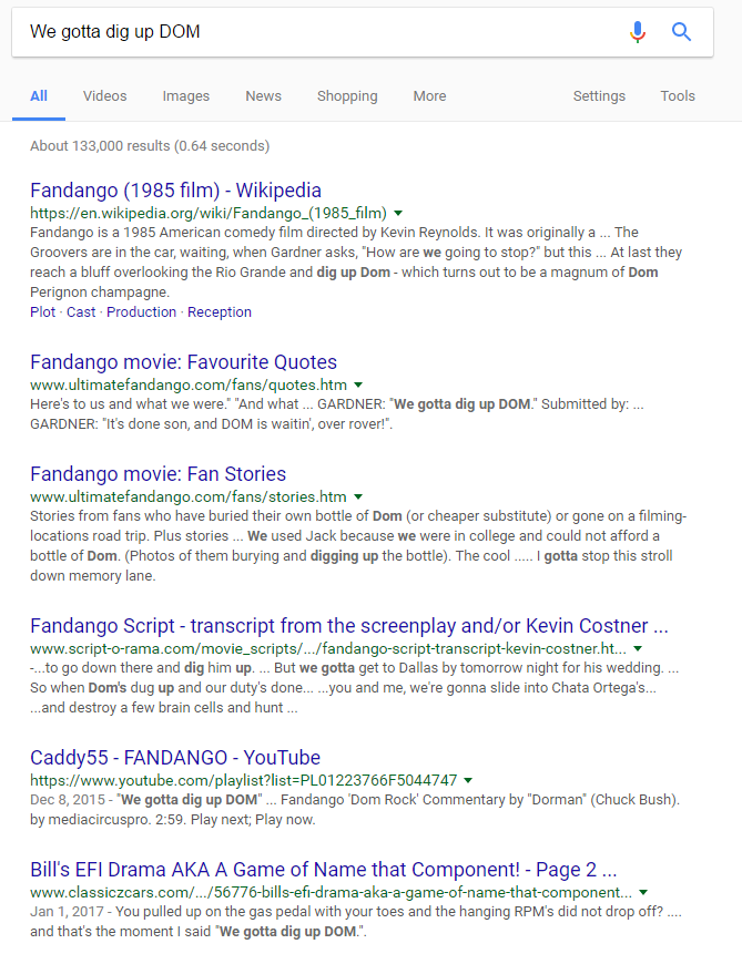

January 23, 20178 yr comment_510895 9 hours ago, siteunseen said: and that's the moment I said  "We gotta dig up DOM." I did not get that reference fairly, and have to admit that I had to look that one up. Methinks you were one of a very select few that actually SAW that movie!!  Link to comment https://www.classiczcars.com/forums/topic/56776-bills-efi-drama-aka-a-game-of-name-that-component/?&page=4#findComment-510895 Share on other sites More sharing options...
January 23, 20178 yr comment_510899 I finally caused you pause, with the best intentions, and you claim obscurity.  That's one of my top ten favorite movies. Are you familiar with the "Hangover" series?  Exact copy. The first VHS movie I ever bought, then Holy Grail. Edited January 23, 20178 yr by siteunseen spelling Link to comment https://www.classiczcars.com/forums/topic/56776-bills-efi-drama-aka-a-game-of-name-that-component/?&page=4#findComment-510899 Share on other sites More sharing options...
January 23, 20178 yr comment_510916 Haha!! Well you certainly blanked me with that one and right after I posted that, I realized took the wrong tact. I shouldn't have suggested it wasn't popular and tried to hide behind a shroud of obscurity... Considering it's one of your top ten, what I should have done was watched it! Link to comment https://www.classiczcars.com/forums/topic/56776-bills-efi-drama-aka-a-game-of-name-that-component/?&page=4#findComment-510916 Share on other sites More sharing options...

January 23, 20178 yr comment_510943 I had to search it myself. Â You made the big time. Â Now we're going to have a bunch of old movie fans joining the site. Â Mike should thank you. Link to comment https://www.classiczcars.com/forums/topic/56776-bills-efi-drama-aka-a-game-of-name-that-component/?&page=4#findComment-510943 Share on other sites More sharing options...
