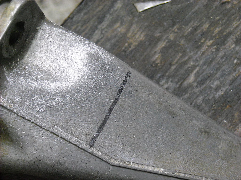

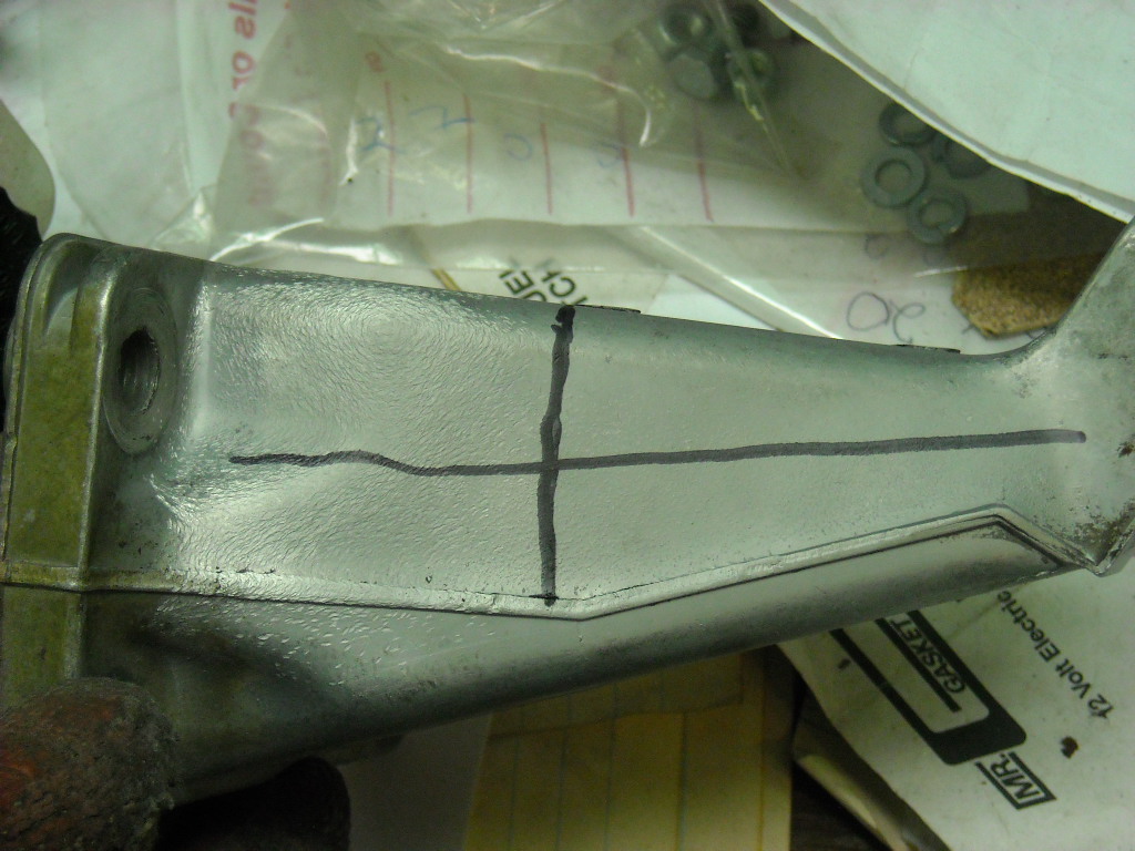

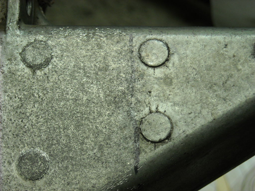

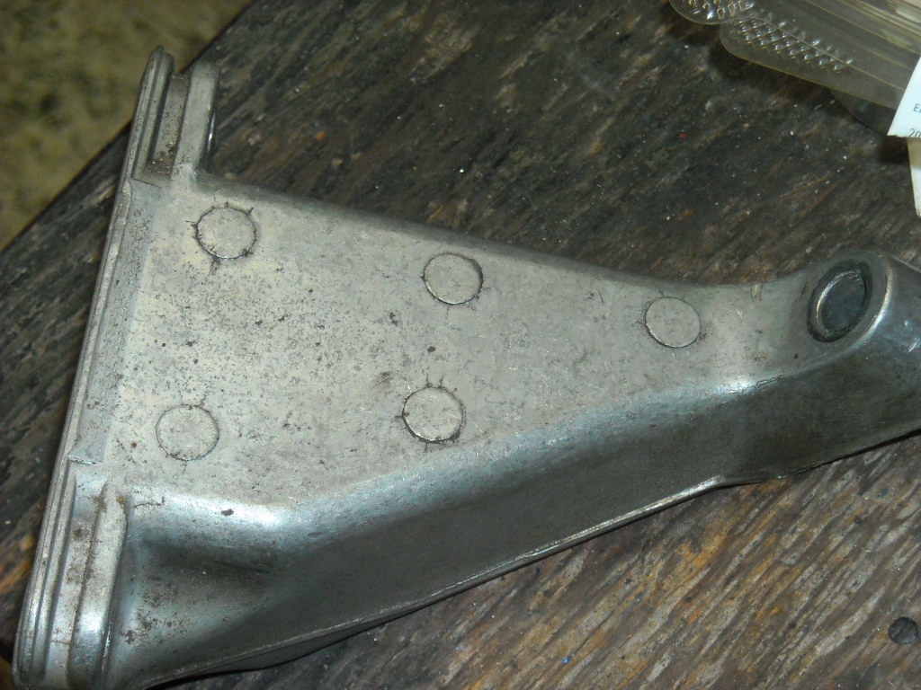

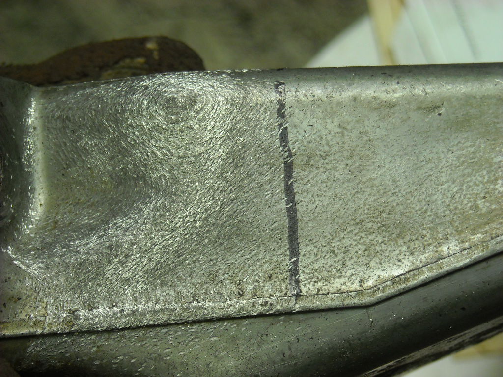

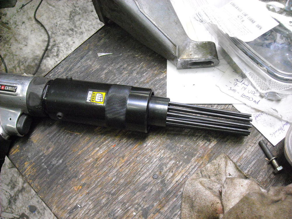

That's a good question, just went out and found an old cast aluminum engine mount and wiped it off with a rag.
 The scaler was used for about a minute on the left side black line. The first two pics are before,
4 hours ago, Patcon said:
Yeah.....No.
That was pretty harsh to the casting
yep. that's ugly
Now it could be because the needles on my scaler are still new and still have a sharp edges and that will round off with use.

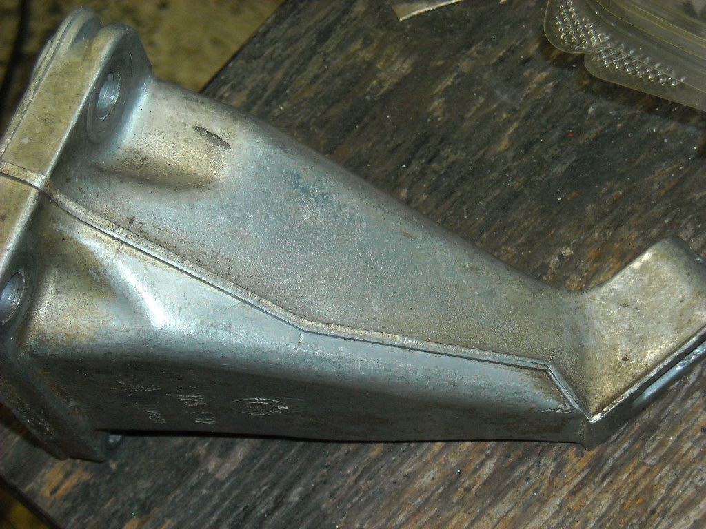

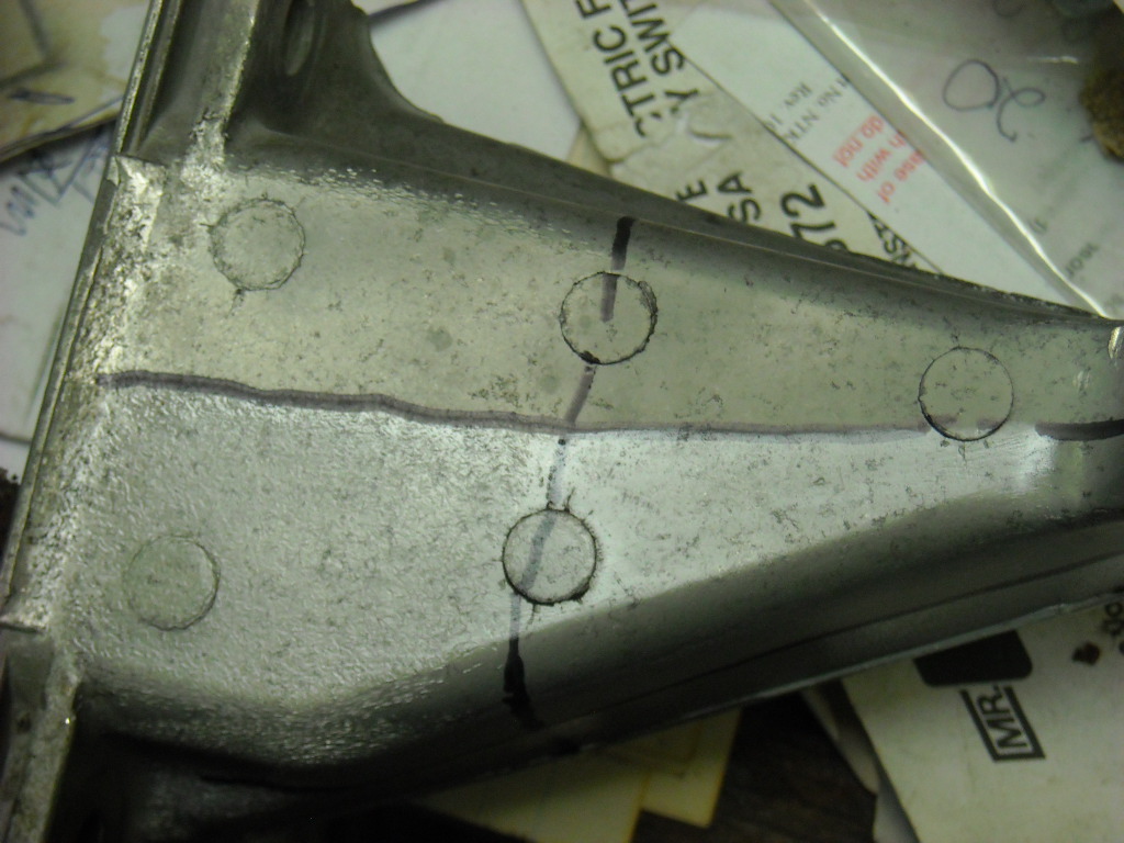

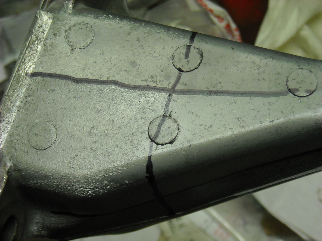

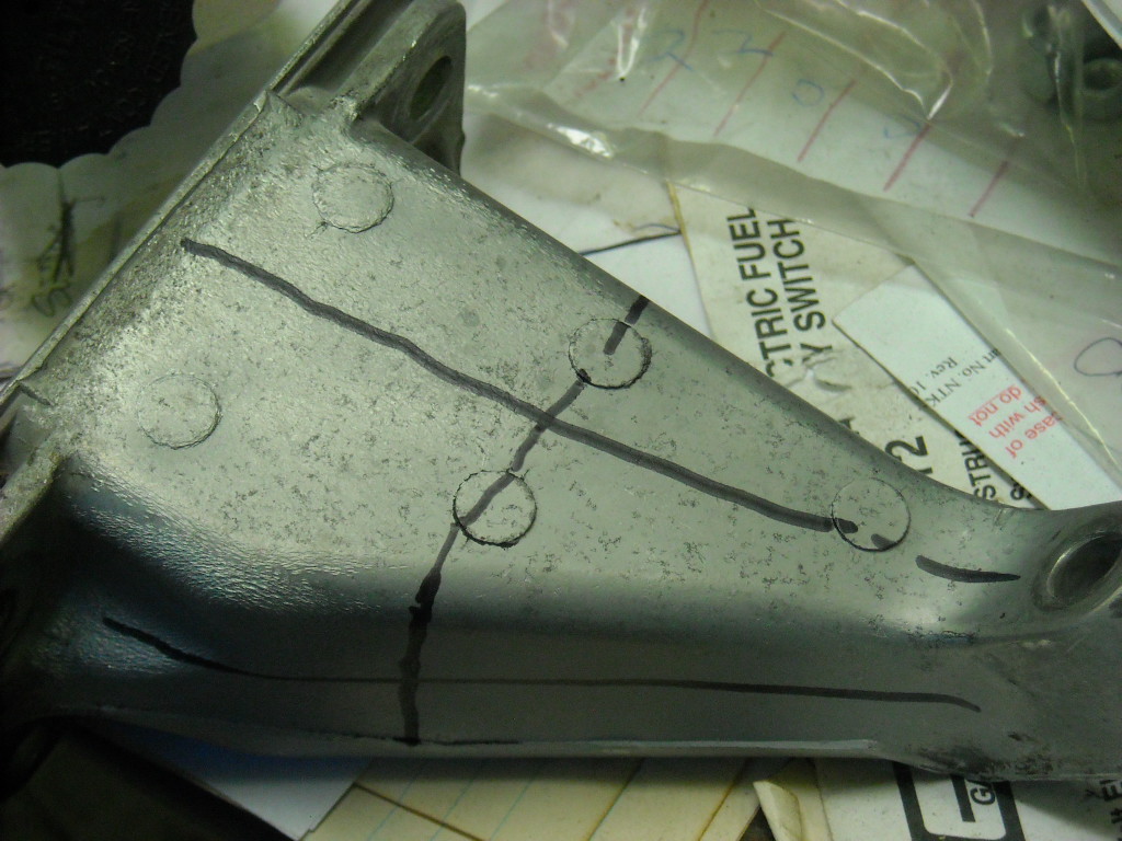

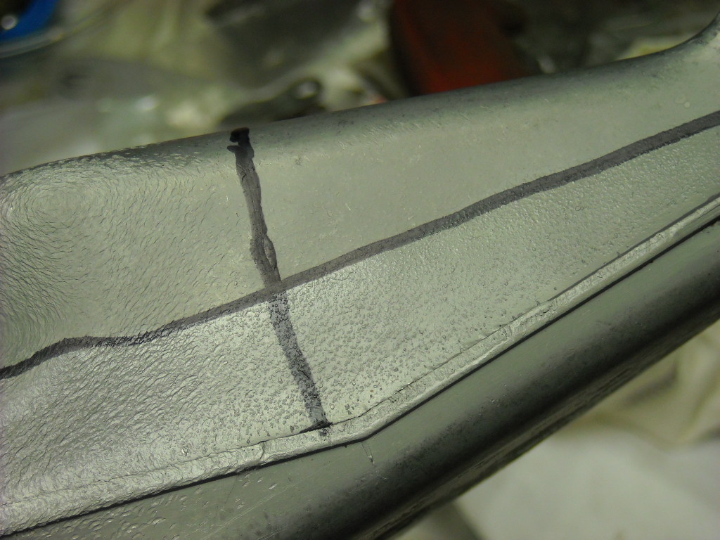

Just for fun I pulled out my very expensive Mcgyver type soda baster and basted both sides of that engine mount,
Then with a Q-tip I coated the bottom two quadrants in each pic with GIBBS wonder oil, let it sink in for an hour or so and rubbed the excess off with a cloth.  I don't know if is an original look or not but it's a good look I think, certainly easy to take care of, you just apply more.
