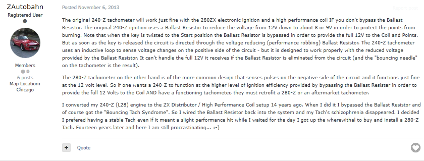

I installed the new dizzy and got the timing all set.  Took it for a spin Friday afternoon and it ran great and pulled hard! But, once you got over about 3.5K, the tach would start bouncing all over the place. So I stopped for gas and reconnected the resistor in an attempt to fix that.  Well, I started the car and it died after about 10 seconds. Long story short, I fried the ignition module. Had to get a ride from a friend back home and got the old dizzy and installed it and got the car home.   So, I ordered a new ignition module and I guess I'll have to look for a 280z tach to install.

I finally got around to trying to install the 280z tach here while it’s winter.  Quickly realized I can’t remove my stock tach as my car has a full dash cap on it and blocks the tach from coming out. I don’t want to force anything and break the cap or tach.
    So...anyone know of a aftermarket dizzy that will work with a stock 240z tach?  I haven’t searched yet.  Also...anyone need a 280z  tach or rebuilt dizzy? ?

Sorry, I meant that I had a 280zx dizzy that I was installing. I did try it with my 240 tach and it's fine until about 3K and then will bounce like crazy.

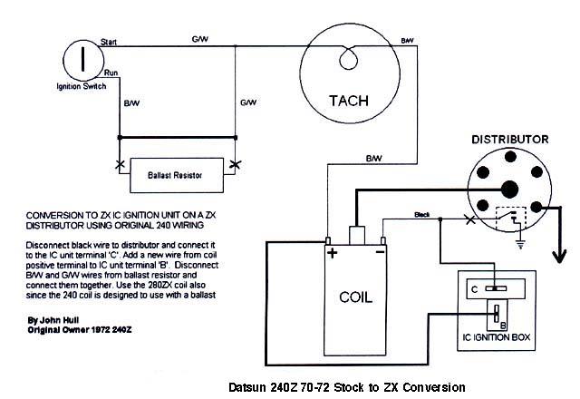

I followed the diagram on "blue's tech tips zx distributor on a z". Google that and go to the next to last drawing I think.  It had to be easy, mine works great. LOL
I used a zx distributor with my stock 74 tachometer. Lots and lots of people have zx distributor with stock tachometers and no problems I think. I'm inclined to suggest try a different stock tacho before a different distributor. Maybe there's a problem with your tacho.
Yeah, the problem is I can't get my tach out because of my full dash cap blocking it in.
Sounds like some people have issues with the swap and some don't :
https://forums.hybridz.org/topic/122001-240z-tach-issues-with-280zx-distributor/
Im wondering if there is any dizzy out there that will work with a 240z tach without issue...other than a stock 240z dizzy. Aftermarket?
