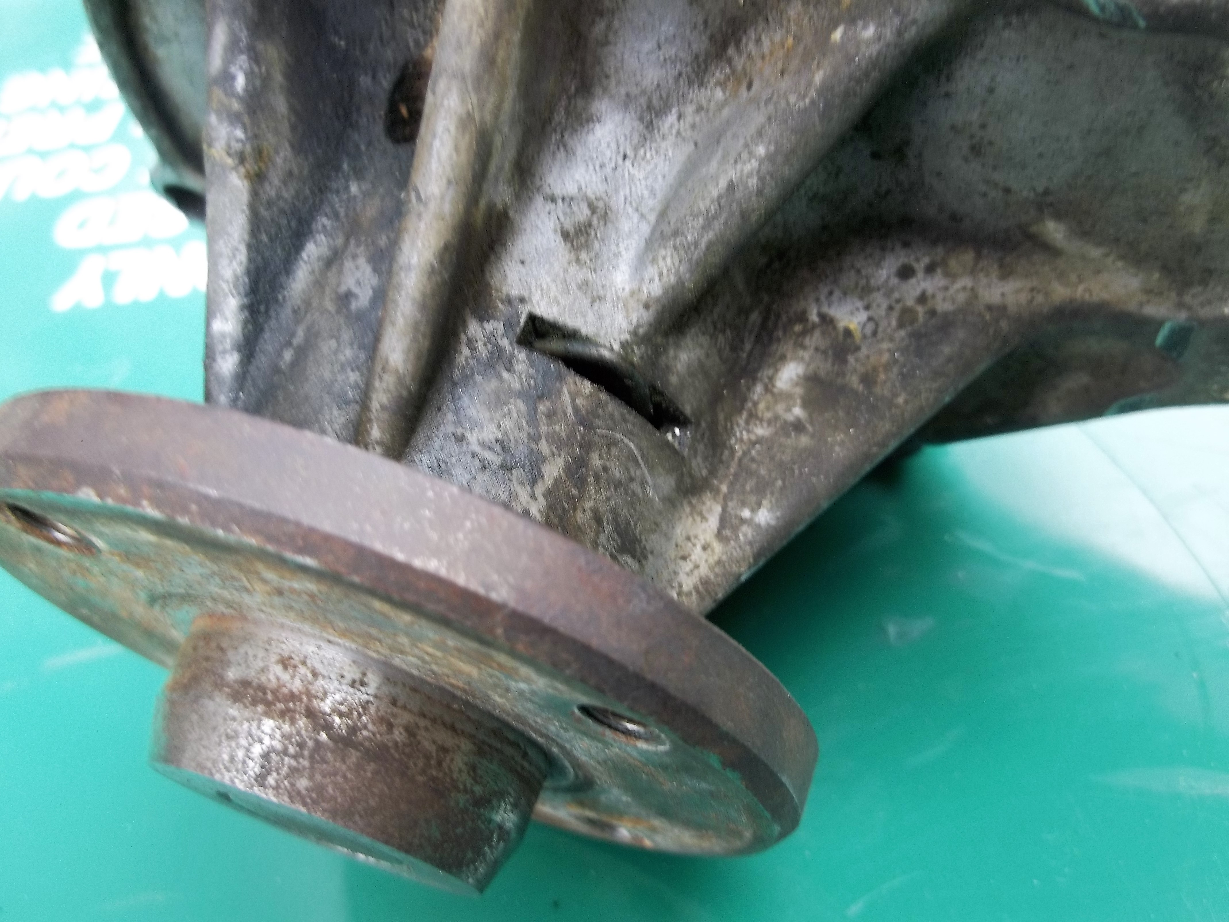

So what happened?  The seal and bearings went bad on the old pump and you had a slow fluid leak?  Out the weep hole?  How did the old pump look?  You didn't give it to AZ as a core did you?  Learning opportunity here...
And no over-temp on the gauge?
Edited by Zed Head
No warning signs of water leakage, if did get noisy maybe over weeks and I did not pickup on it. I would always check the engine bay after running and the rad after cooling, there was no loss of coolant, but most of my rides are short, just a few miles. The long trip high speed did it in. I did keep the core, will post up a video later to others can see/hear. I did not look it over to closely yet, but after getting it out it was clearly noisy and rough like shot bearings. My last Z (240 I had in the early 80's) threw a fan after breaking the pump shaft, taking out the rad on a lonely part of I-10 on a cold rainy night, not fun, this time I got lucky.

no service history on the car, I have had it less than a year so no idea on how old the pump was. I should have replaced it before but I was so freaked out about horror stories on snapped bolts I had decided to leave it be if the was no weeping or excessive noise. I clearly must have missed something unless its possible to fail the quickly with no real warning signs. Of course like I said the noise "may" have been there before the trip started and I had just overlooked it. I am pretty sure there was no weeping bit its not impossible that it was slight and just went unnoticed.
I think that the bearings go bad because the seal leaks and lets water get to them.  So the rumbly bearings are a sign of a bad seal.  And the seal is going to leak more when the system is pressurized.  Might not leak much at zero pressure differential, so hard to see at the beginning.  The fluid that leaks is going to be warm and be blown back on to a hot engine.  So you could get steam without blowing the radiator seal.  I'd imagine that the only sign you might find is a very clean area around the weep hole.  Maybe fan shaped.

Looks like the impeller vanes are worn shiny at the outside tips from contact with the front cover.
If that's the case, then no wonder it was noisy! You had metal to metal contact!
On edit - And if there was contact inside, what did the front cover look like?
Edited by Captain Obvious
gotta admit I did not pay attention to the front cover. I don't recall seeing anything shocking though that I would have made a mental note of.
