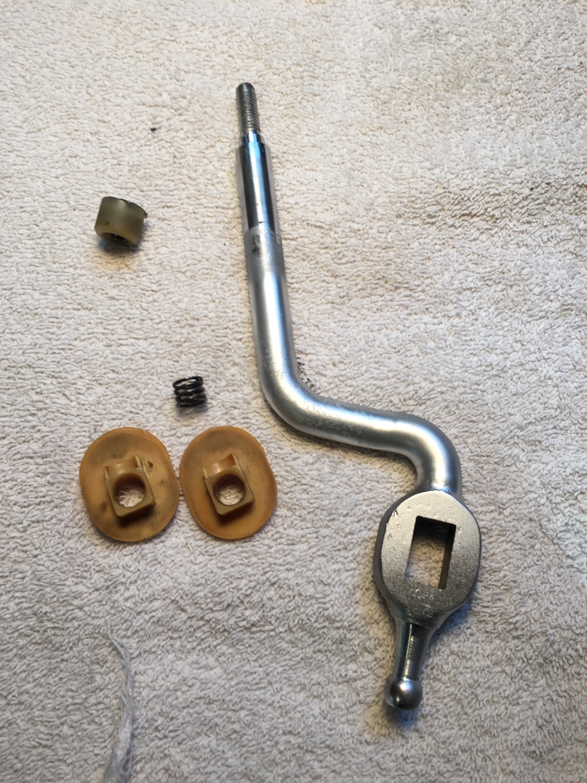

May 22, 20178 yr comment_521502 38 minutes ago, 7tooZ said: Don, tell me about the shifter in the background. Link to comment https://www.classiczcars.com/forums/topic/56296-half-shaft-u-joint-rebuild/?&page=2#findComment-521502 Share on other sites More sharing options...

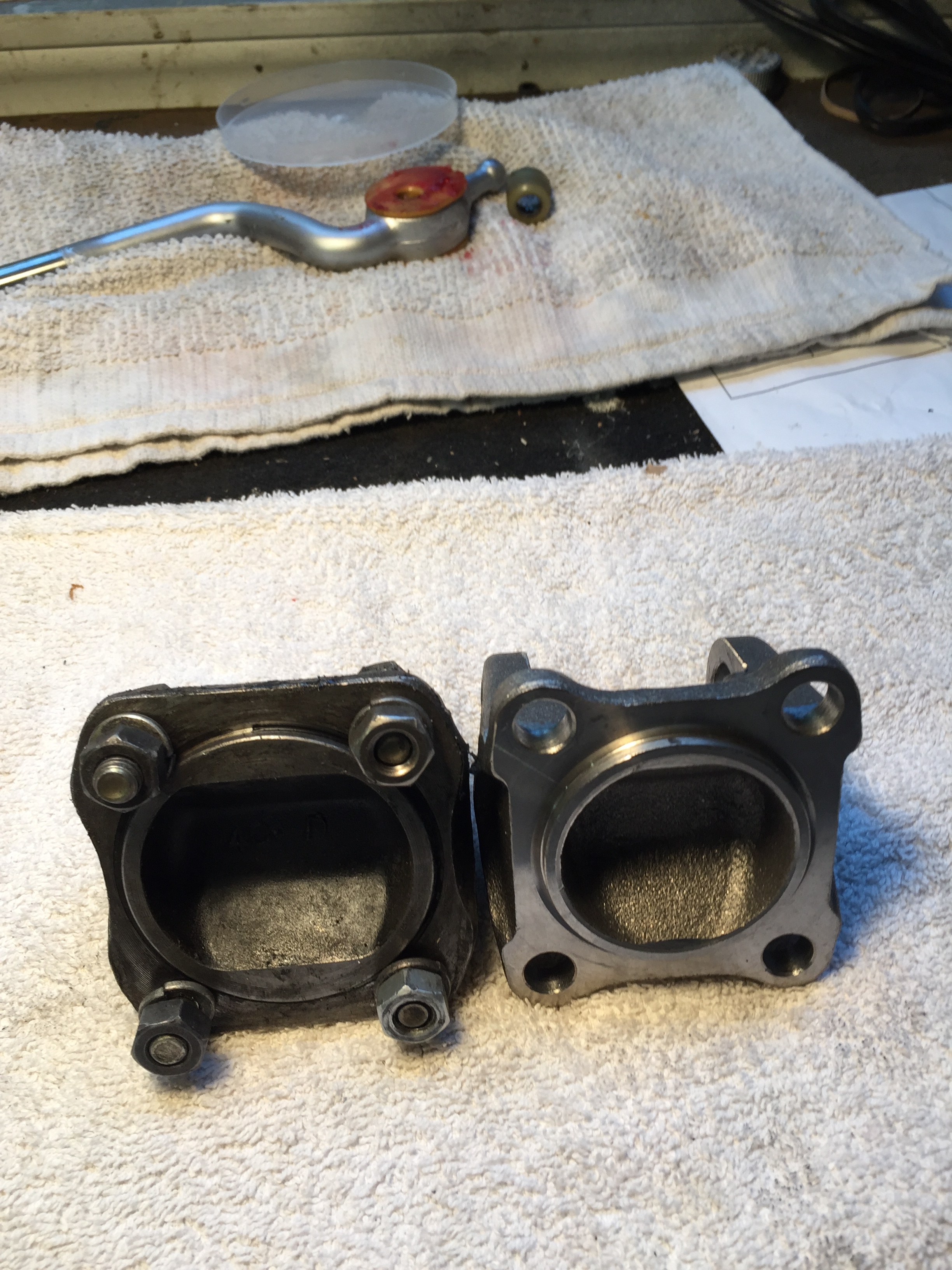

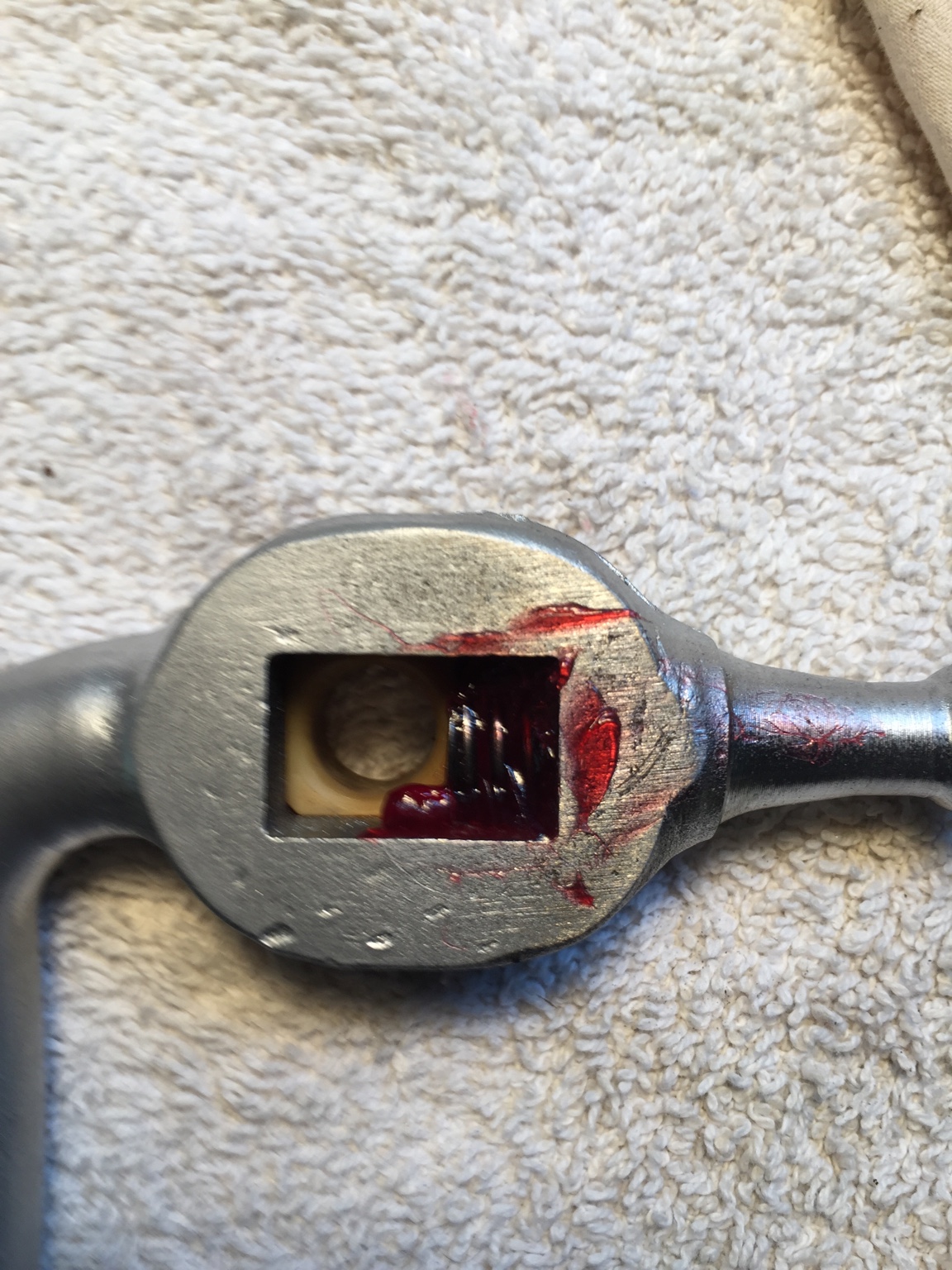

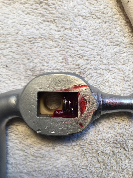

May 22, 20178 yr comment_521505 Yah so you know I have a series I console that I refuse to cut. plus I wanted to maintain the short shift lever I am used to. So I made up my mind I find a solution. first I reversed the location of the fulcrum pin which dropped it further into the trans without any negative effect. Then I took a lever from a 83 Zx which is nearly straight and put it in a vise and started working on it with a benzine torch and a floor jack handle. Kept working it till it cleared the console. Once that was done I needed it to go up into the inner boot and the console boot. So far it clears everything. Final test will be actually driving. Put the R200 in today and drive line is perfect except the rear yoke. Length is good and So i experimented with taking out the u joint so I can add the new yoke. Havent done that in a while and the Nissan yokes are a royal pain. Installing should be easy. Really erked me to remove a good joint. Two days ago I was about to abandon the change over project but took my anger out on Zed Head. Then decided to prove I was wasn't s total idiot. I'm done with that now. I'll give keep you posted. Don's iPhone using Classic Zcar Club mobile Link to comment https://www.classiczcars.com/forums/topic/56296-half-shaft-u-joint-rebuild/?&page=2#findComment-521505 Share on other sites More sharing options...

May 23, 20178 yr comment_521588 Nice. If it looks like a ........Okay so I replaced the rear Driveline joint and added the R200 yoke. R200 is in installed along with drive line. Question: is there a left-right half-shaft? Is one shorter than another? Can I use the 240 shafts?Don's iPhone using Classic Zcar Club mobile Link to comment https://www.classiczcars.com/forums/topic/56296-half-shaft-u-joint-rebuild/?&page=2#findComment-521588 Share on other sites More sharing options...
May 23, 20178 yr comment_521596 I have heard the trick is to flip the bushings over and change the pin position. I like the bends you made, I still have the straight ZX shifter too, and a straight 510 shifter along with a 720 shifter. I should be able to make something work. I thought the R200 used clip in half shafts, not the bolt on with the Diff stubs. I could be wrong. The later K diffs had clip in for sure, thats what I am going to use. The half shafts should be the same length except for the VLSD which had different R to L. I have not gotten far on my 5sp swap yet. I keep cleaning and painting all the other parts.  Link to comment https://www.classiczcars.com/forums/topic/56296-half-shaft-u-joint-rebuild/?&page=2#findComment-521596 Share on other sites More sharing options...

May 24, 20178 yr comment_521608 By flipping the pin mechanism over it extended the lower part of the shifter a 1/2 inch. Seem to work fine. I haven't measured the total movement of the shifter ball yet for comparison. More to come as I progress. Forgot to order Redline and don't have enough. So have to find some. Don's iPhone using Classic Zcar Club mobile Link to comment https://www.classiczcars.com/forums/topic/56296-half-shaft-u-joint-rebuild/?&page=2#findComment-521608 Share on other sites More sharing options...
