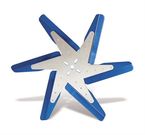

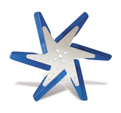

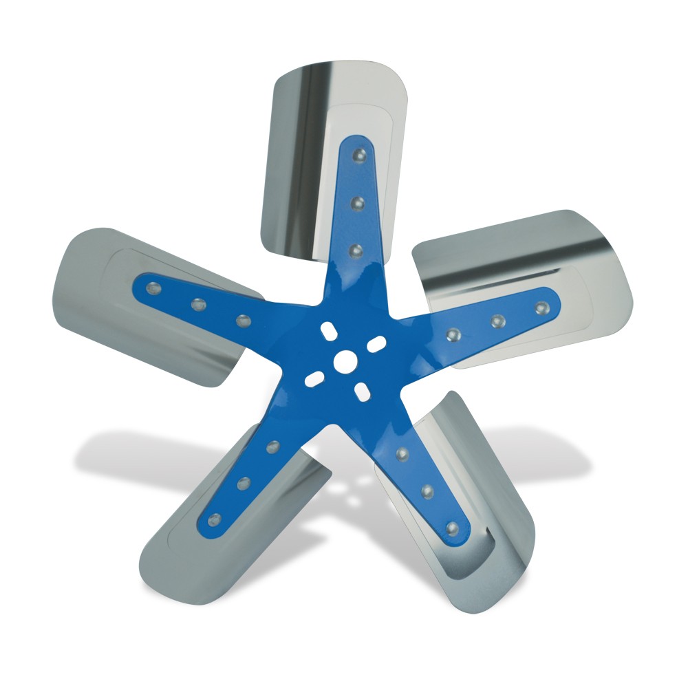

I've been looking into the flex fans, specifically the Flex-A Lite fans, and the variety of fan types is confusing.  You can get 6-blade fans, 5-blade fans, fans with "wide blades and narrow ones:
The first photo is a reverse-rotation fan (I think) and the other two are normal-rotation fans.
I think I would select the 6-blade fan with the narrow 'paddles' although I'm not too sure what the difference would be between the narrow and wide ones would be, besides the amount of air flow.  Any advice would be appreciated.  I think it's a normal rotation fan.
I'm not in a hurry;  this would be a winter project.  It'll take that long to figure out hot to get the top half of the shroud off ;)

Don't overlook the possibility that the 'reverse-rotation' fan may be just a flipped photo image.  Does this look better?...
What's your goal in changing to this style of fan?  More CFM?  Less noise?  Weight reduction?  Hi-tech look?

I used a flex fan for decades after my original fan took out my radiator when the water pump broke.  The style I used was more like the wide vane five blade unit in your pictures.  It was a little loud, but threw a lot of air.  I changed back to a stock plastic fan with clutch a few years ago when I upgraded my AC and added electric fans.
Dennis
Edited by psdenno
 I ran a flex fan on mine for many years too. It was the style in the second pic with the big flaps. My theory was, lighter is better (it replaced the original heavy steel fan and clutch), it would pull more air at an idle, at low RPMs and at low speed than the skinny ones. Any faster than 10-15 mph, no fan is needed IMO. The big flaps flatten out at high RPMs reducing drag (HP loss). It functioned as expected and was a great mod on my first Z.
