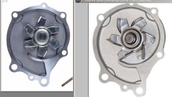

The're definitely more desirable to some people for supposed benefits.  The topic rolls through often.  If you look around the internet you'll find that the design of the stamped blades isn't even consistent.  Some stamped steel blades might have actual engineering design efforts behind them, others might be just shaped to look right.
http://www.classiczcars.com/forums/topic/55214-water-pump-options-and-where-to-get/
Put Gates and GMB side-by-side, from Rockauto.  The housing is even a little different, one of the bolt reinforcements is missing.  I'd probably trust Gates over GMB but still, no supporting data.

The manufacturers all say the stamped impeller is the same or better as the cast one but never show data.  So it looks like just standard cost-cutting.
This is the the wrong forum to mention Tony D.  His abrasive forum manners aren't popular here at all.  He doesn't contribute.
The one I received is a GMB, made in Thailand. It is the same as ZH's photo above missing one bolt hole reinforcement.

Just to finish the circle - how are you defining quality?  That's the real question here and the difficult part.  We know what looks right and we know what the factory did.  We don't know much about these replacement parts.  No offense, but just because you'd put one in your car doesn't really tell us much.
I don't want to be negative but everybody wants MSA to be successful.  The perception about the stamped steel blades is out there and will be hard to replace.  Hate to see you pick a low-seller.
