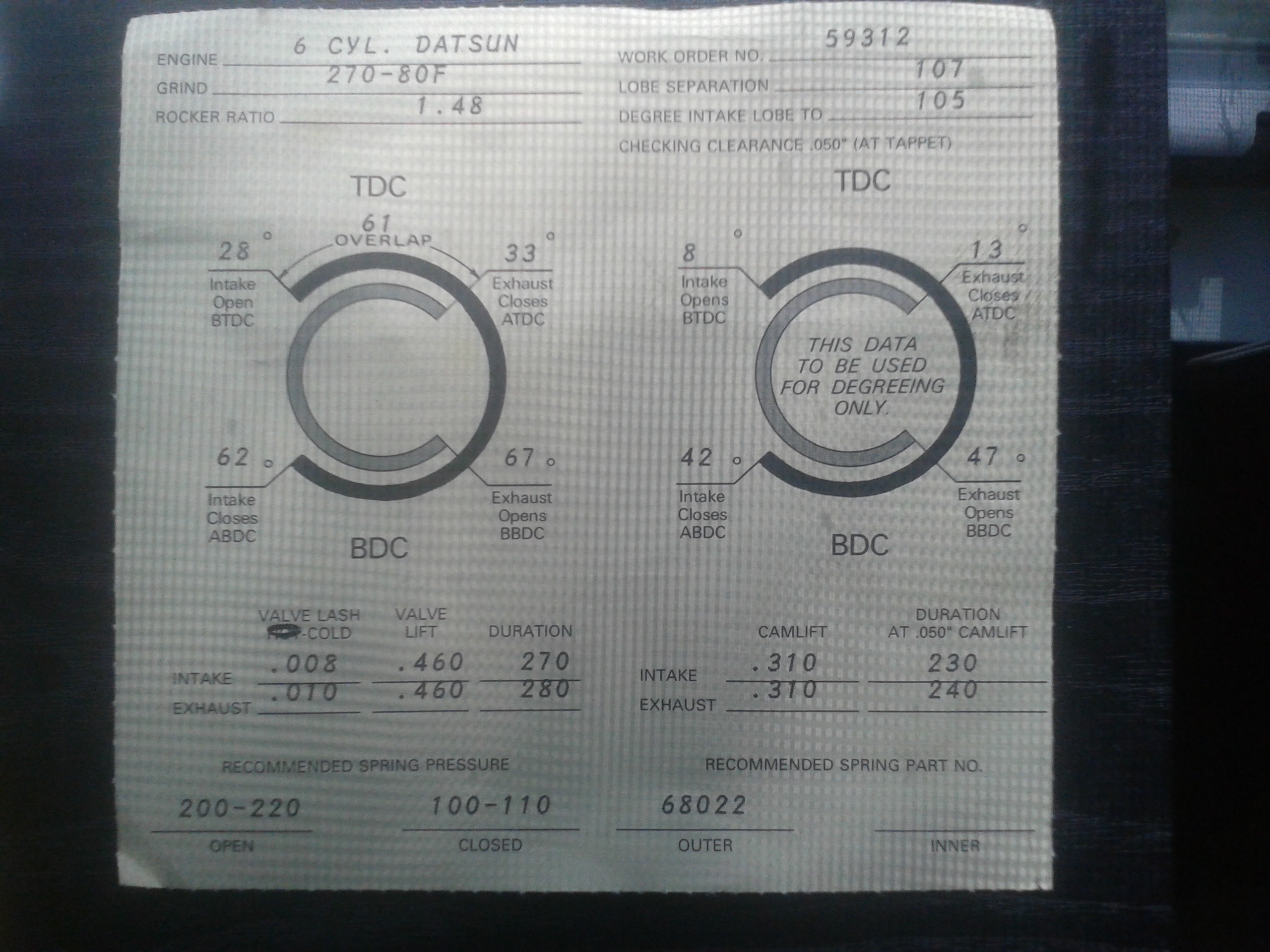

^ Note the wording in the Shneider card at right upper corner. Checking clearance at .050" ( at Tappet ). Not at valve.
Also note duration is checked at .050" Camlift ....  not Valve lift.
Isky has a warning about checking at Valve lift because of measurement errors introduced by clearance ramps and rocker arm ratio variances. A sliding finger follower is particularly, bad because the ratio varies as the cam lobe wipes across the rocker pad. All pushrod engines are checked at Tappet lift and you must use a solid tappet. The Tappet is really just a solid spacer to get the Dial Indicator located on. OHC engines are usually measured ( these days ) directly off of the cam lobe. Back in the 70's they used to measure off the Valve retainer... but that introduced too many errors.
I'd call Isky and ask if the specs are checked at the Cam Lobe  or Valve stem. Cam Lobe is much more accurate and is the standard these day.

Hey all - thanks for the replies.  I'll see if I can get some of your questions answered.  I have received two very different L-480 cam cards from Isky - both for a Datsun 6 cylinder L series engine.  I have attached both for reference.   The card with the writing on it is the most recent one they sent me.  I have been working with madkaw on this since he has far more experience dialing in cams than I do, but he is stumped as well.
Zed Head is correct in that I don't know if the cam card is wrong or if the cam is wrong.  This was supposed to be a regrind of my original cam, but I can't tell if I got back the one I sent them.  The markings on the end of the cam indicates that it is a customer supplied cam and the grind date matches the time frame that Isky had my cam according to Ron at Isky.
Since my cam gear is adjustable, I have been able to adjust so that the intake was closing at about 36* ATDC (35* ATDC per cam card), but the open was at about 12.5* BTDC (3* ATDC per cam card)- so I'm almost 15* off on the open.  Since we were so far off on the open, we didn't try to dial in the close # at this point.  Measurements were done with zero lash and .050 valve rise per Ron, but he didn't get specific as to where to take the measurement.  The dial indicator is sitting on top of the Isky valve spring retainer since that is about the only "flat" spot to take a measurement from.

I'll make note that we think error is with Isky because he did the same to me as far as supplying the incorrect cam card with the cam.
I have dialed in my cams using the retainer as the measuring point. Schneider had no issue with this method but warned of faulty numbers because of the inconsistent rocker arm ratios .
I try to be careful to get the dial indicator in line with the angle of the valve . Reading are only done at .050 valve lift which in my understanding is the standard to method so help deter the ramp effect .
The other problem we are seeing is that cam lobe center numbers don't add up to the card based on my math, but I am truly a novice at this .

Personally, I would check the Cam lobe lift as per the first card. At the Cam lobe. Make sure that the dial indicator is lined up EXACTLY 90 degrees to the crank center-line. Don't forget that the engine is tilted about 6 degrees from vertical and so the Dial indicator must be aligned the same.  I'm thinking the numbers will come out correct then.
You will likely have to add 180 degrees to the timings on the card. Reason being is that they are a generic card printed for Domestic pushrod engines. The Cam on those is beneath the tappet and pushes upwards. The L-series OHC engine has the Cam located above the follower and pushes down... so that changes the Cheby/Ford/Chrysler cam card readings 180 degrees.
If Ron made even a minute miscalculation in the rocker ratio, his numbers will be off. And the Rocker ratio of an L-series engine is not symmetrical like that of a SBC or other engine with round tappets. One other thing. Back in the 70's and 80's all you could buy was OEM Datsun rockers. These days you can get aftermarket rocker arms. But it's already been proven that the ratio can vary from factory. So that throws even more errors into the equation.
Edit: In the original Racer Brown article ( Page 99 on How to Modify Datsun Engines . by Bill Fisher and Bob Waar ) he mentions that Datsun produced two different rocker arms. An Early and a Late style. The early ones could be " fudged " to produce a 1.5165 to 1 ratio. The later arms could be " set up " as high as 1.5438 to 1. Some aftermarket rockers these days are as low as 1.48 to 1. And where the lobe is positioned on the wiping pad also alters rocker ratio ( see " fudging " ).  All in all there are just too many variable in the Datsun finger follower design to measure at the Valve Retainer.
Bottom line. Measure at the Cam lobe for the most accurate job. It's funny that Isky doesn't even follow there own advice... Ed would have never allowed that.
Steve. Don't forget Lash Caps if you don't already have them. Stock ones won't work. Link that ZH supplied shows you need .175" Lash Pads with that regrind. . Stock is around .120"
I don't know- most everywhere I have read and seen it is using the retainer to measure off of. I've also read it is important to have the dial indicator in line with valve angle - nothing else. BRAAP on hybridz has a nice thread on degree ing a cam which he shows the dial indicator on the retainer .
I believe the numbers supplied are not correct , but open to any ideas
