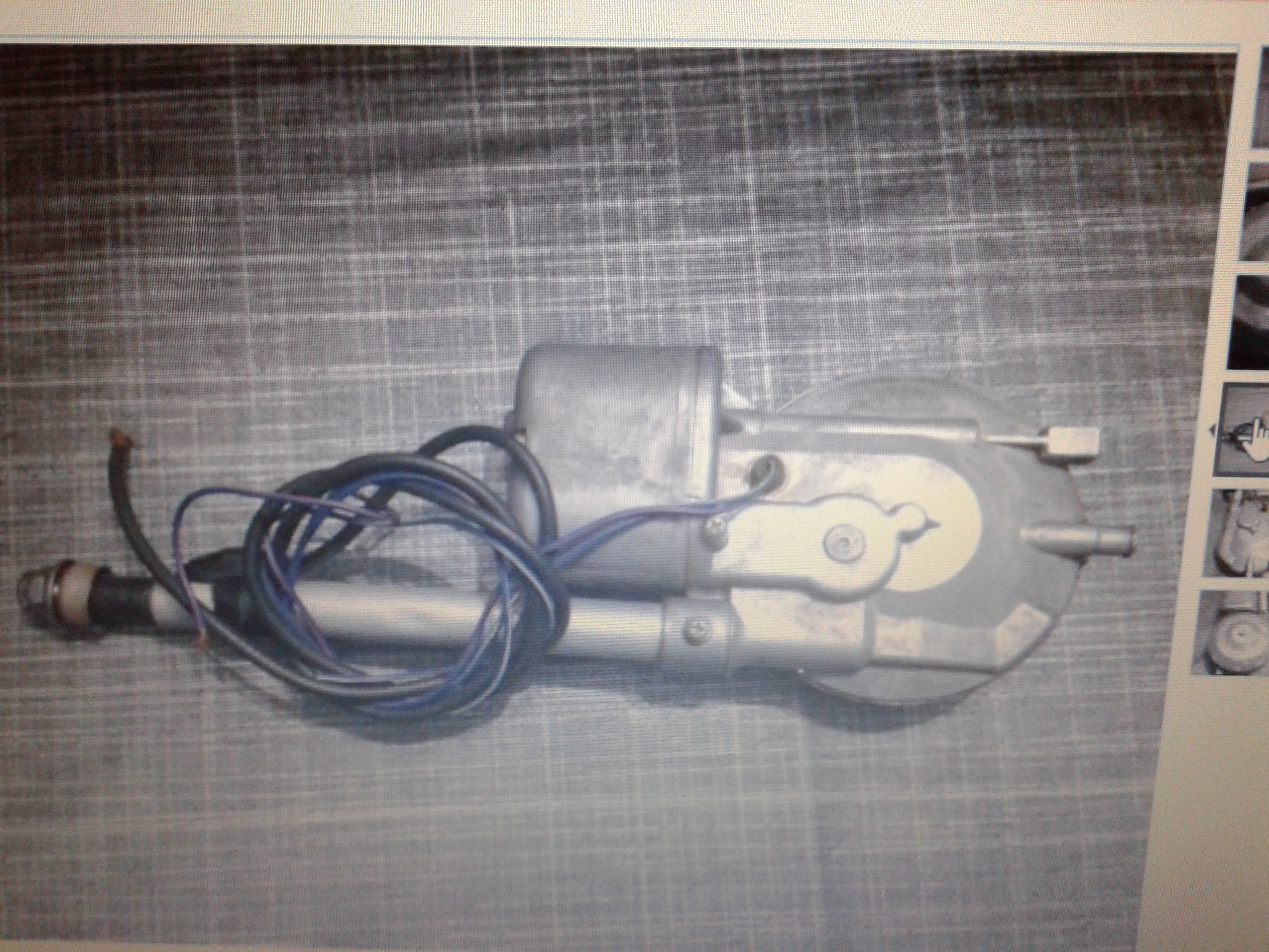

Btw. it was a electric original with metal casing NOT plastic as far as i know.. very similar to the 280zx antenna..
Like in the picture.. not sure if this is a 240 or 280zx antenna

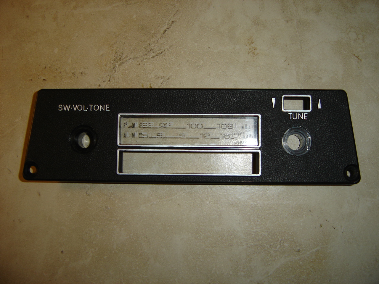

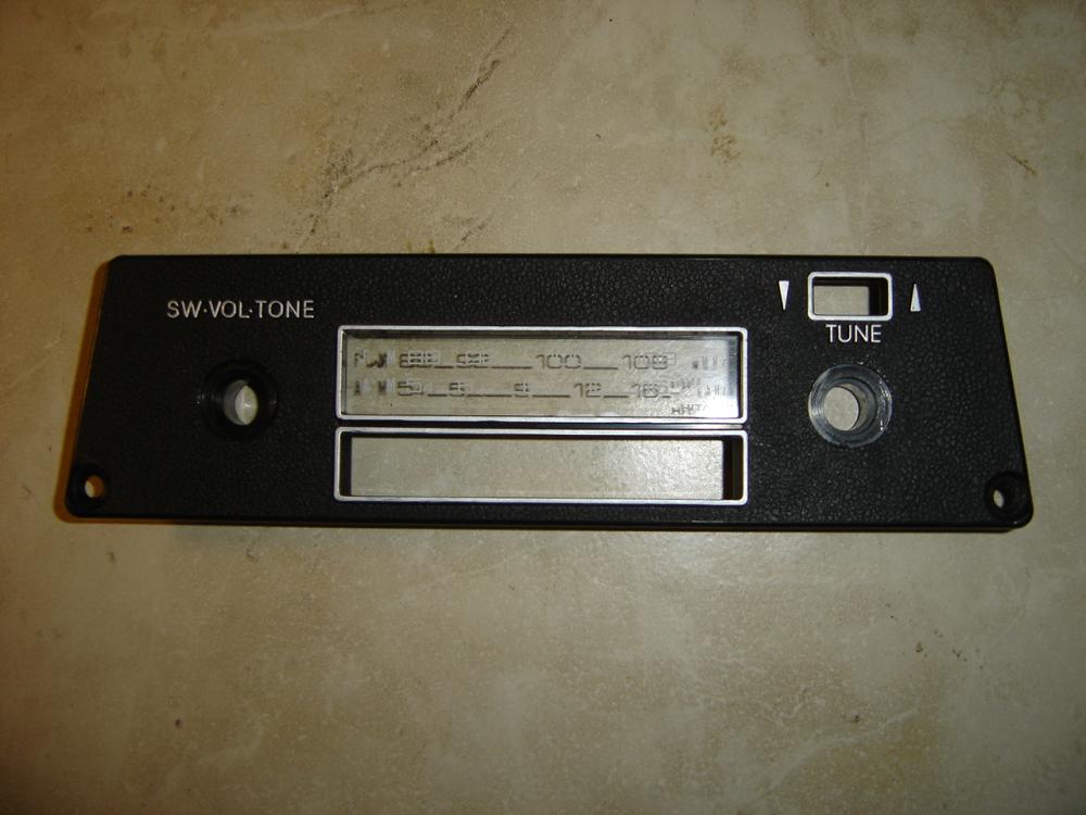

The antenna switch goes in the space above the word TUNE.  Those arrows are for the antenna UP and DOWN.  This is my faceplate off my 01/'72
