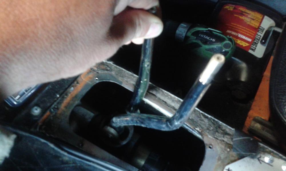

I've been reading up on the shifter's pin hole to ball length.  I am using the 4 speed rod in the 5 speed.  I will find the right shift rod and try it.

I'm going to find all my shift rods in a few minutes but the L shaped one is in my other 4 spd 240 as well as the 5 spd 280. I think I have a basterd shift rod from something and the 4 spds are shaped the same but the pin hole to the ball is a different length or depth.  Pretty sure I'll be carrying it to Caitlyn Jenner, the tranny guy. LOL
One problem resolved, 100 more to go!
I put in a zx transmission but used the wrong shift rod.
Now I have all five forward gears. 8^)
The one that's straighter is the zx rod. I like the other one better but I'll lose fifth.
