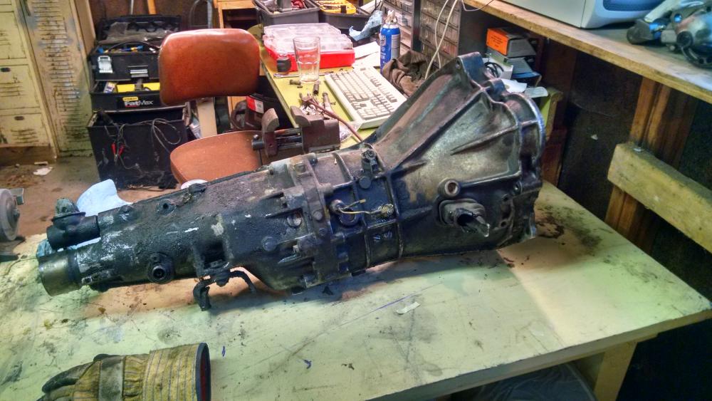

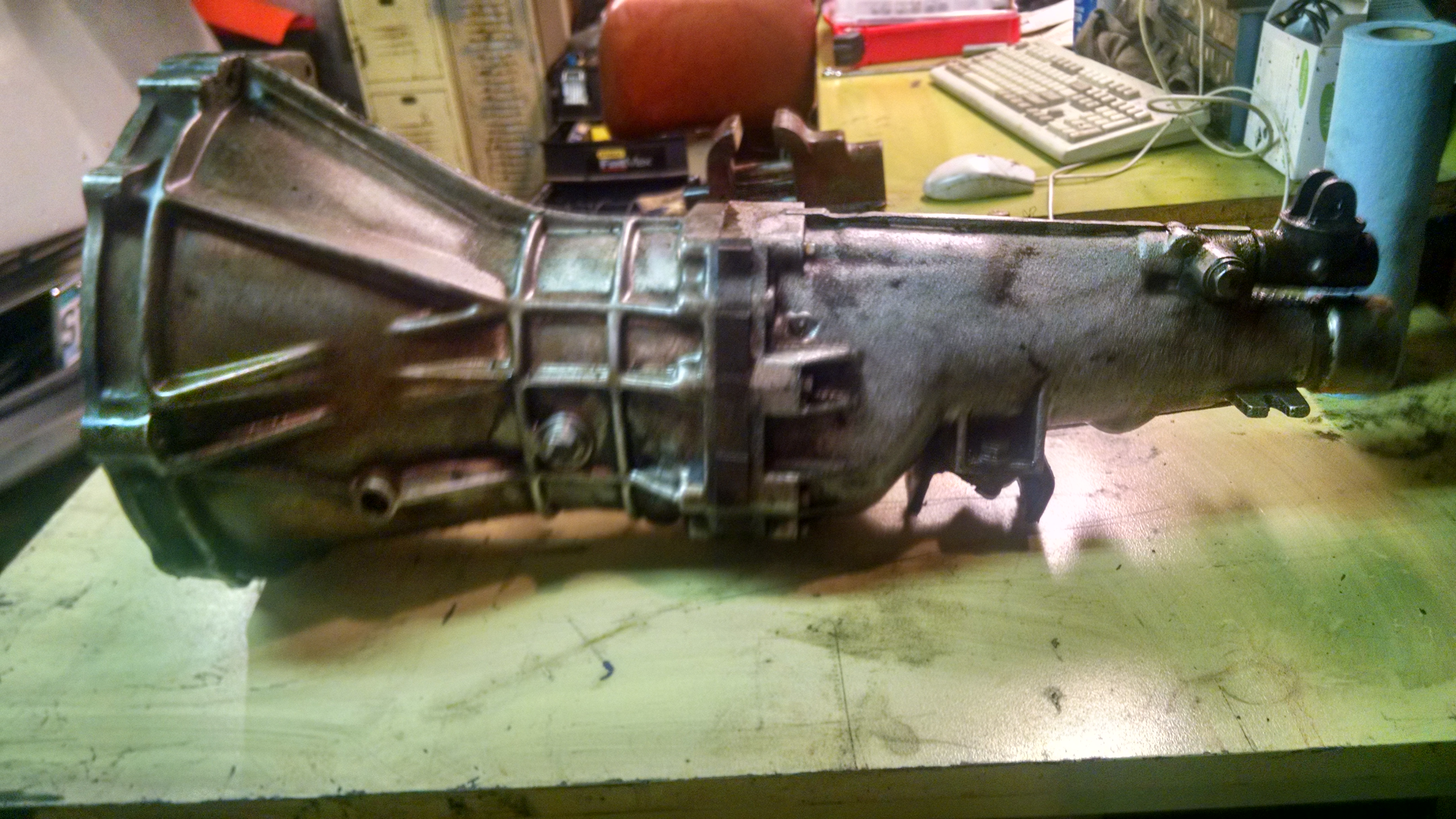

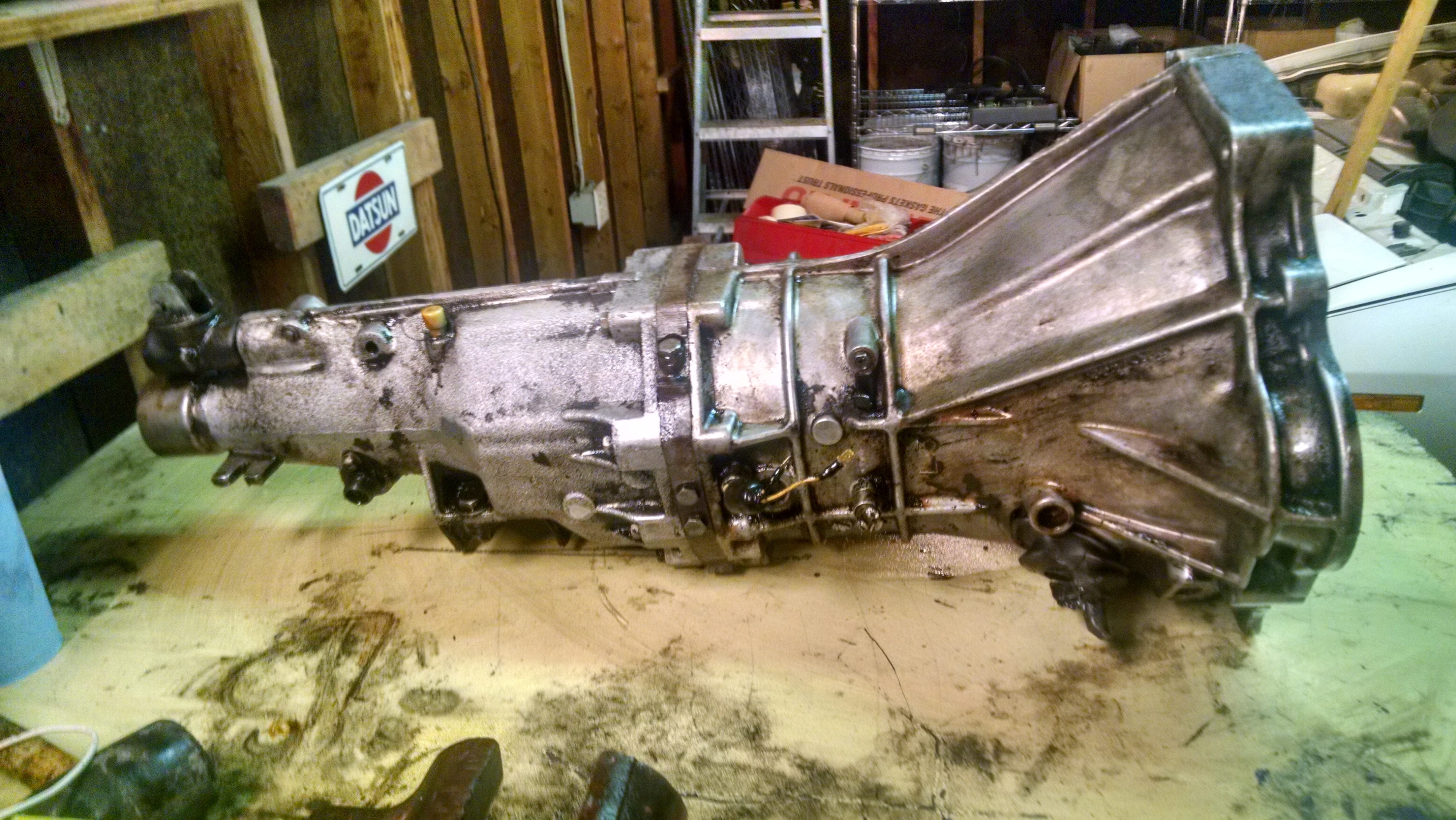

Ok, it's out and I cleaned it up.
My trans looks a little different than "normal" 280z 5-speeds I'm seeing on ebay. I've got a second switch where the fill plug seems to be on other cars -- my fill plug is on the driver's side.
Thoughts?
Also, what comes next? FSM isn't too clear on removing the spring and the bearing up front. I want to pull the gearbox away from the bell-housing to see which one of these bearing cages got chewed up.
Not positive but I think that Maxima's or trucks had the fill plugs on the driver side. How long is it?  Truck boxes are shorter.
Nobody's ever confirmed that the various numbers and letters have any meaning.  you have to measure and look; ratios, length, speedo bolt position, exhaust hangers, etc.  You have two hangers which would be Z, not ZX.  Not sure about Maxima or truck though.
I think it's the same length as a standard Z transmission -- that is to say, I've got a replacement driveshaft for my Z, and it's the same length as the one that just came out of it... at least it sure looked like it. I'll have to double check now. Maxima in the 70's and early 80's would have been the 810, right?

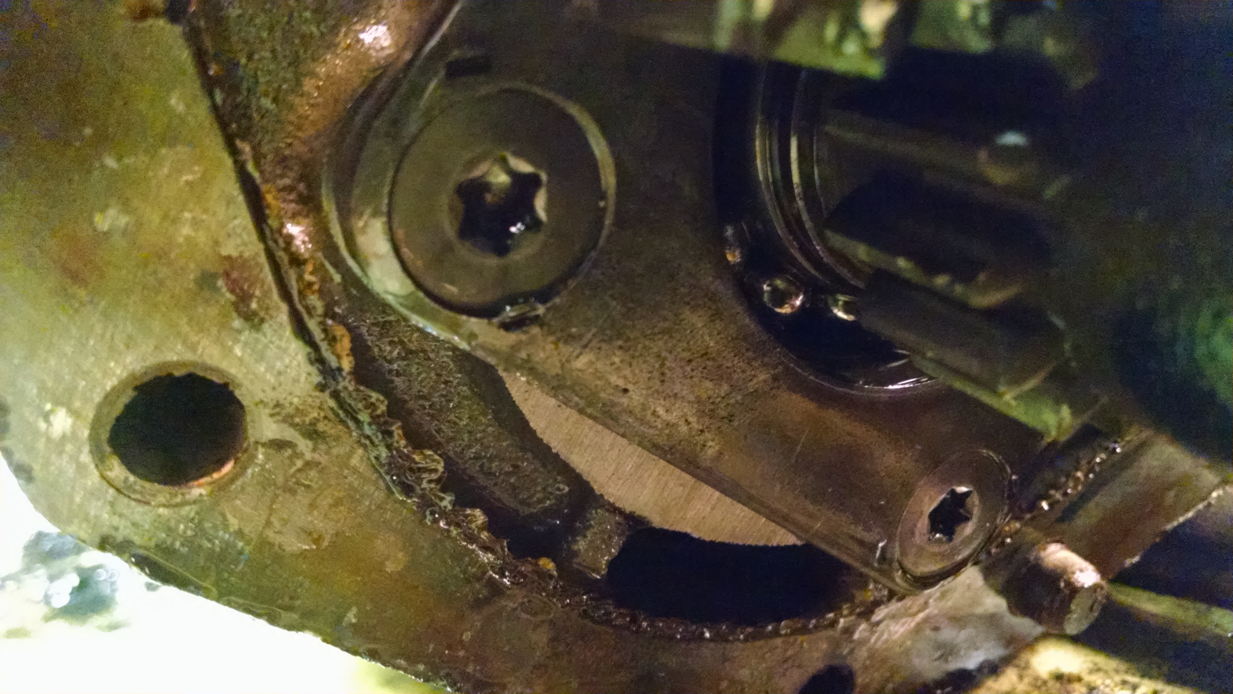

I've started dis-assembly, and I've reached a bit of an impass with the front cover -- I got all the bolts off, but I can't get the cover itself to budge.
I got the back cover off (I can see two of the bearings/cages and so far these ones look ok) -- and I can see some starbit/hex bolts ... do those need to come off to get the front cover off? I can take some pics tomorrow of where I'm struggling if need be.
Thanks for all the help so far everyone. I never would have made it this far without you guys. :)

I measured the transmission -- it's 31 inches... so... standard Z-length as far as I can tell.
The bell housing looks like the Maxima bell-housing, but with the early Z 5-speed rear-half... The two ears are the giveaway on that right?

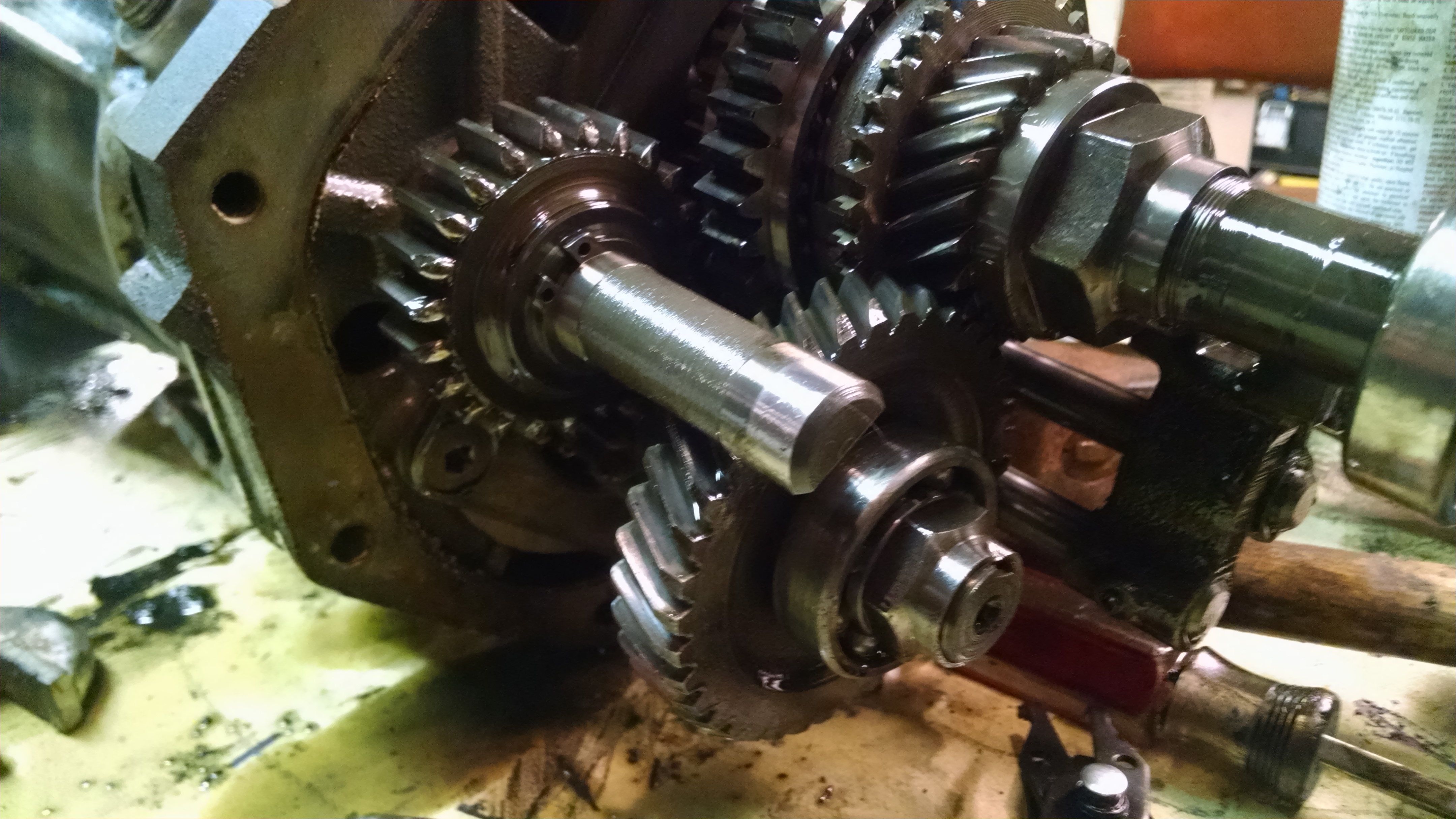

Also, I think I found my busted bearing culprit... It's the one right in the middle down below (second pic) ... is that the countershaft?
