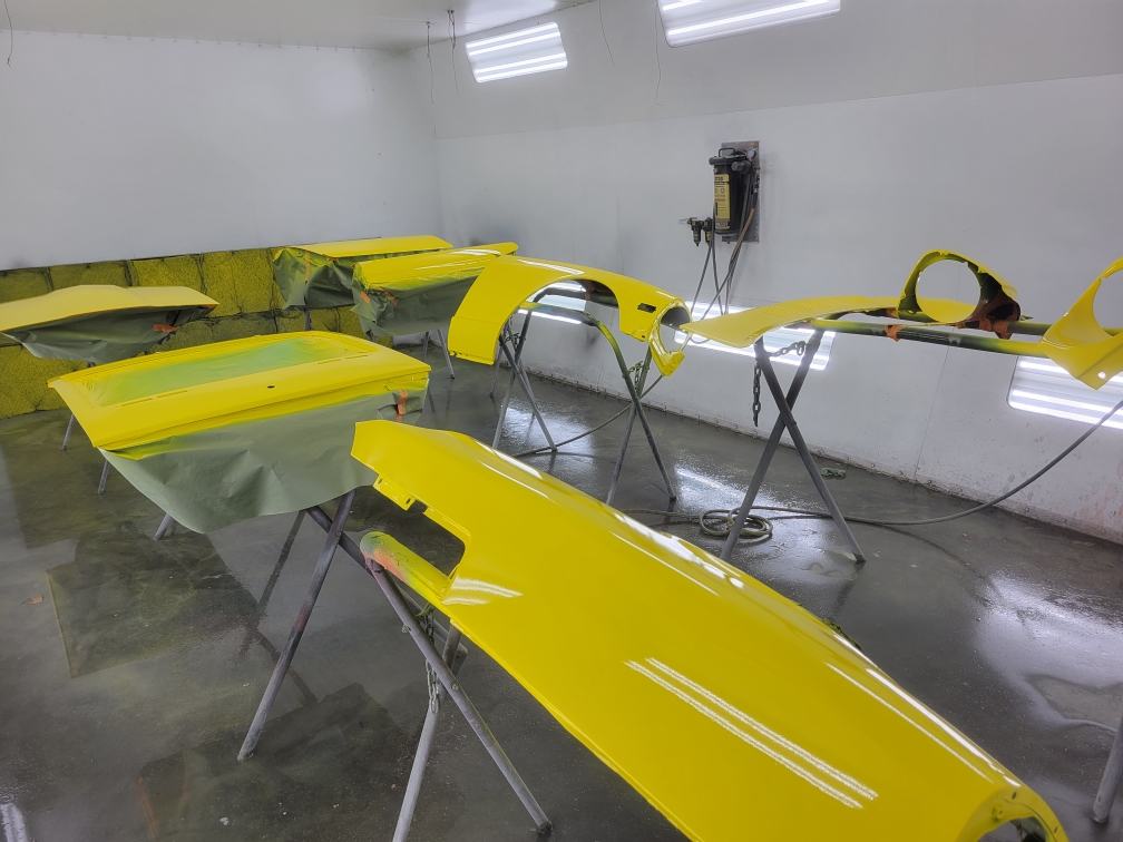

Very Nice my friend! Love to see a shop that does the panel painting.
They paint salvage cars for me sometimes and do a lot of panel painting. Good guys and they turned out pretty good. $650 and I supplied the material. He did some prep work to augment mine and blocked everything to 500 wet.

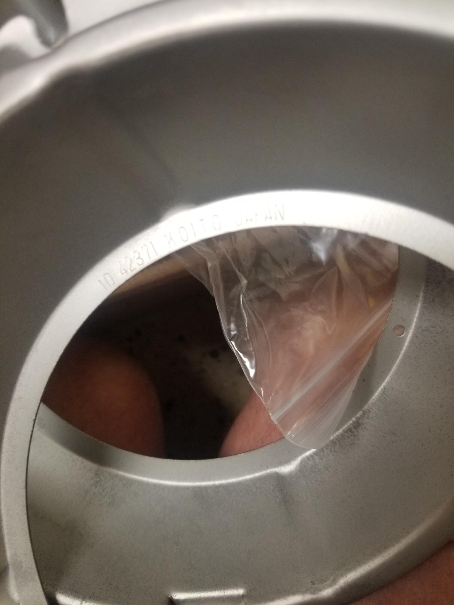

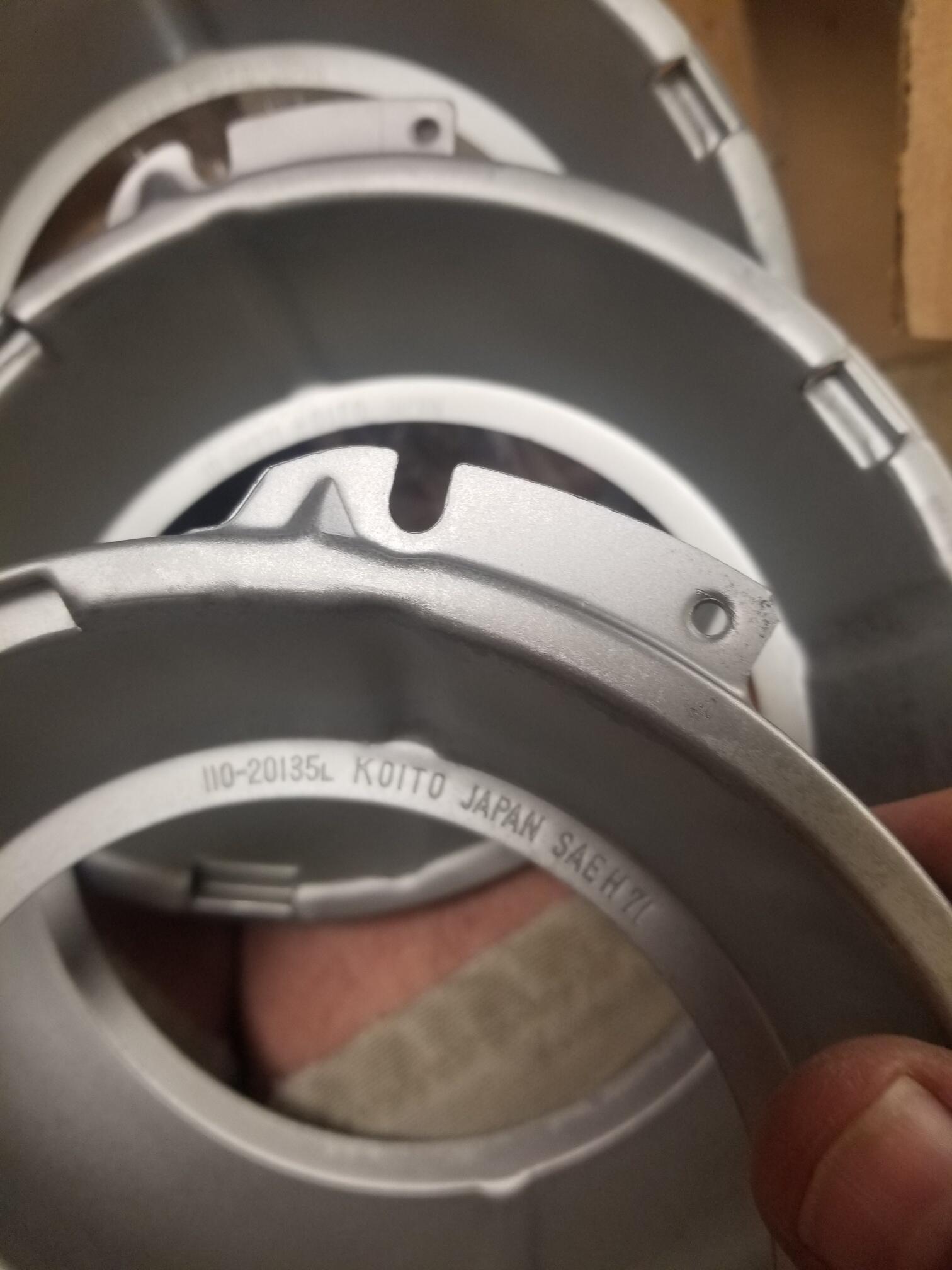

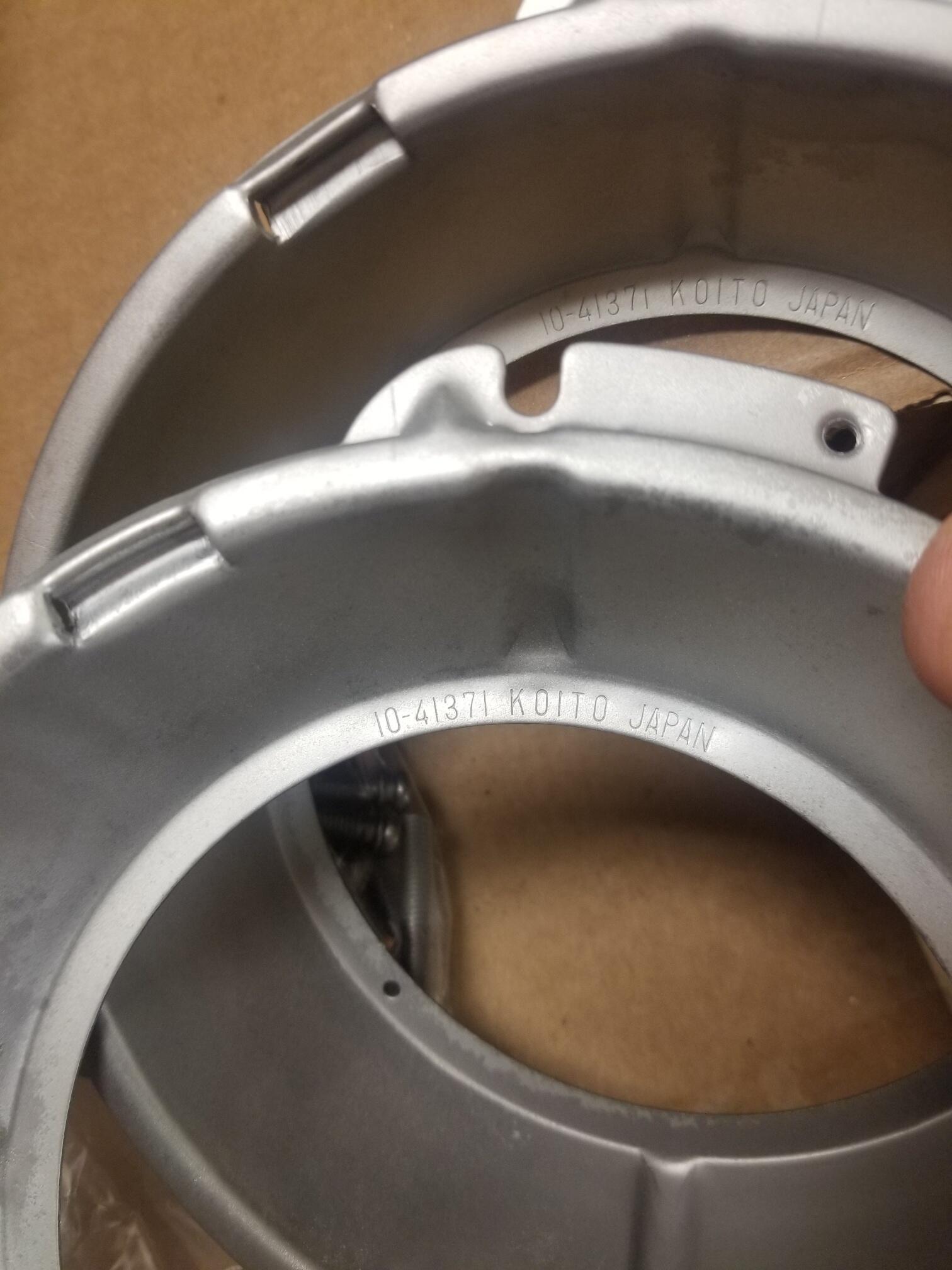

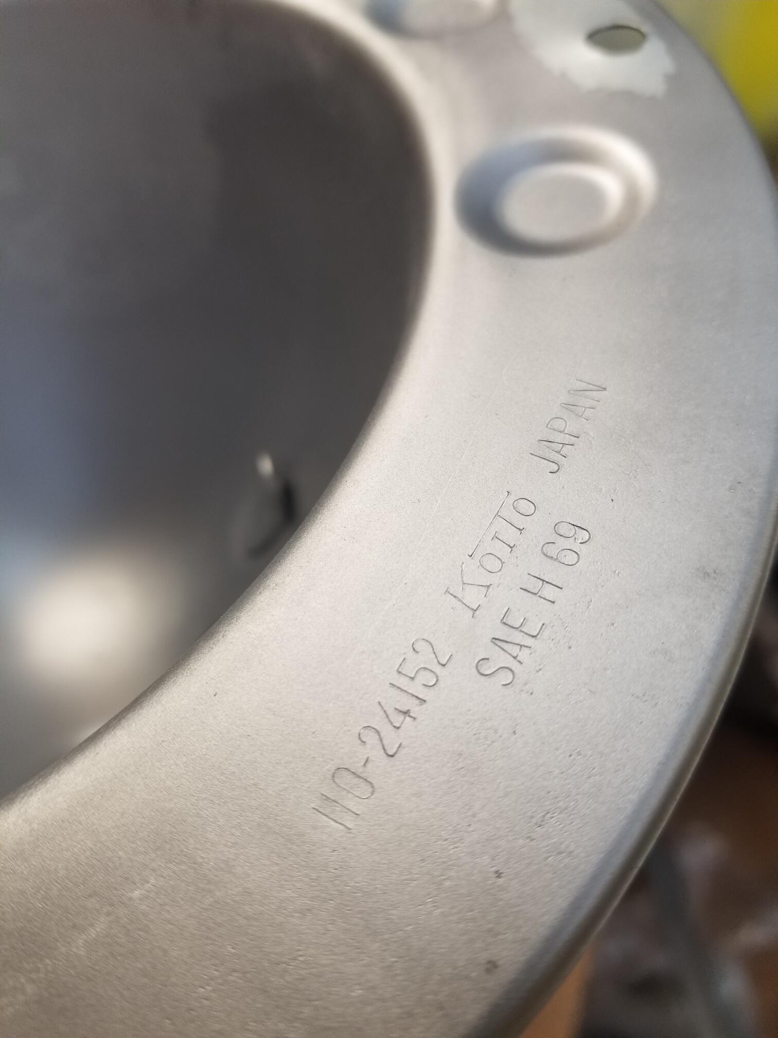

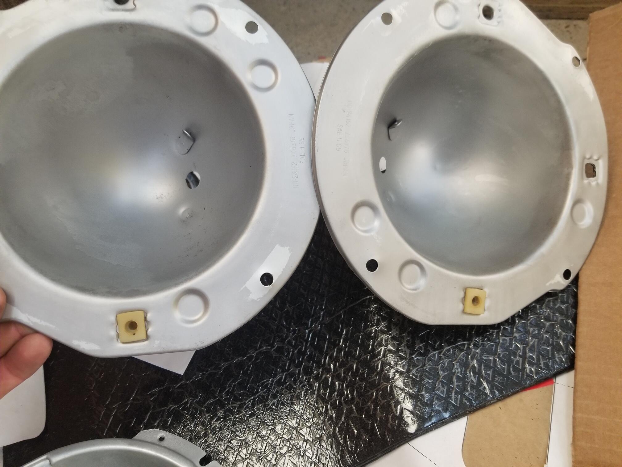

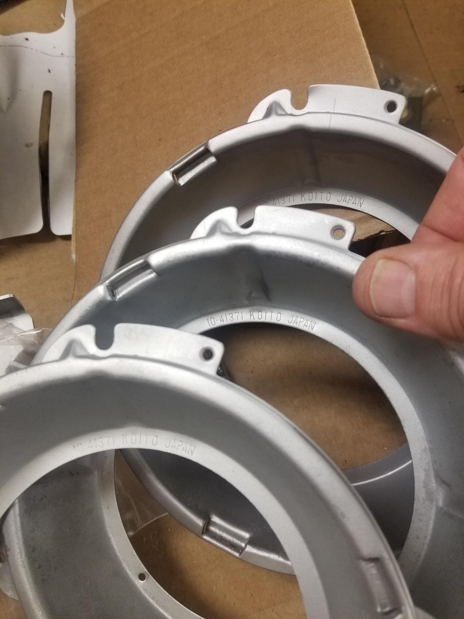

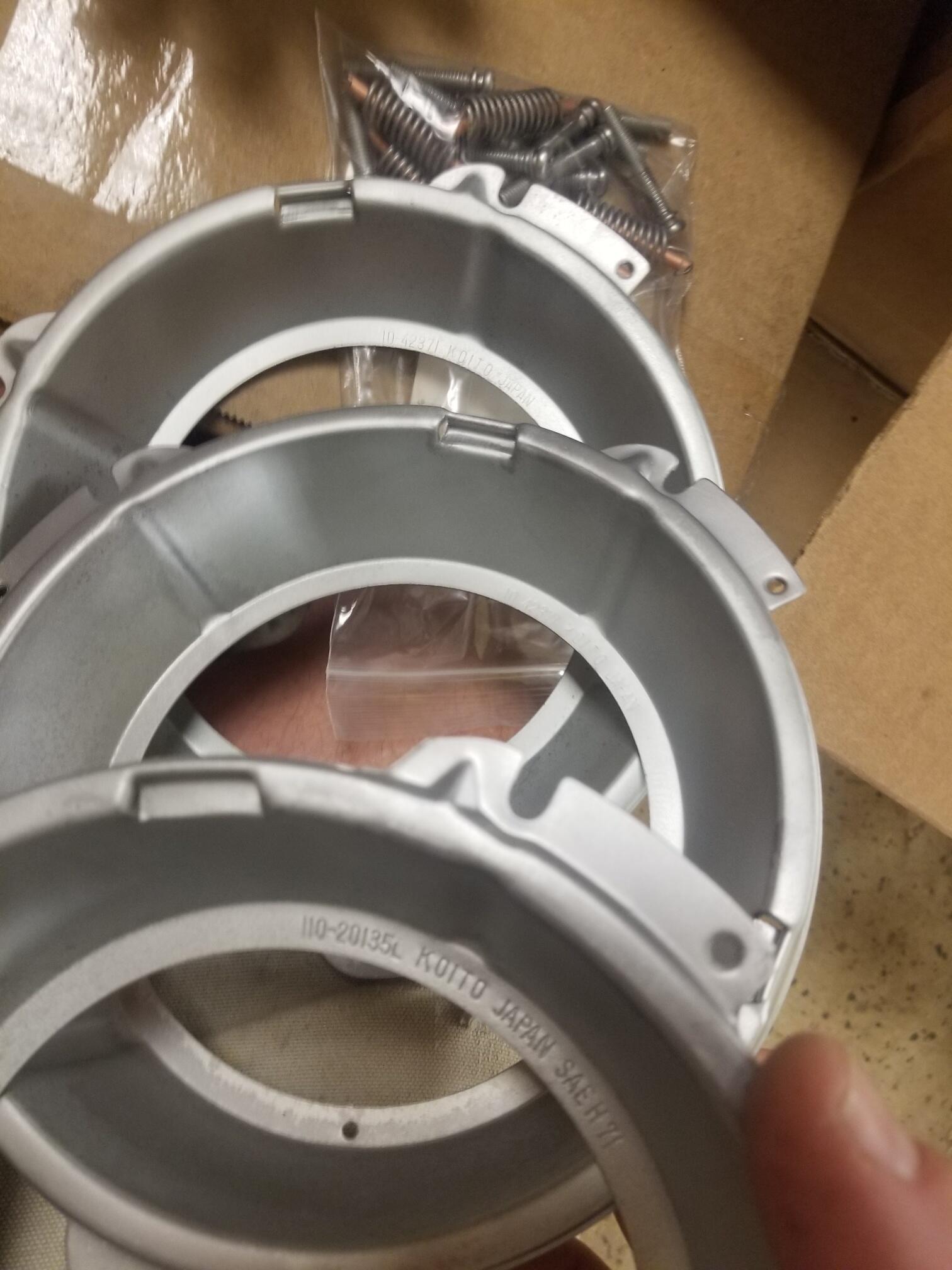

I have been pulling some larger items together for plating. I have 3 pairs of headlights and thought I would post up some observations on the factory parts

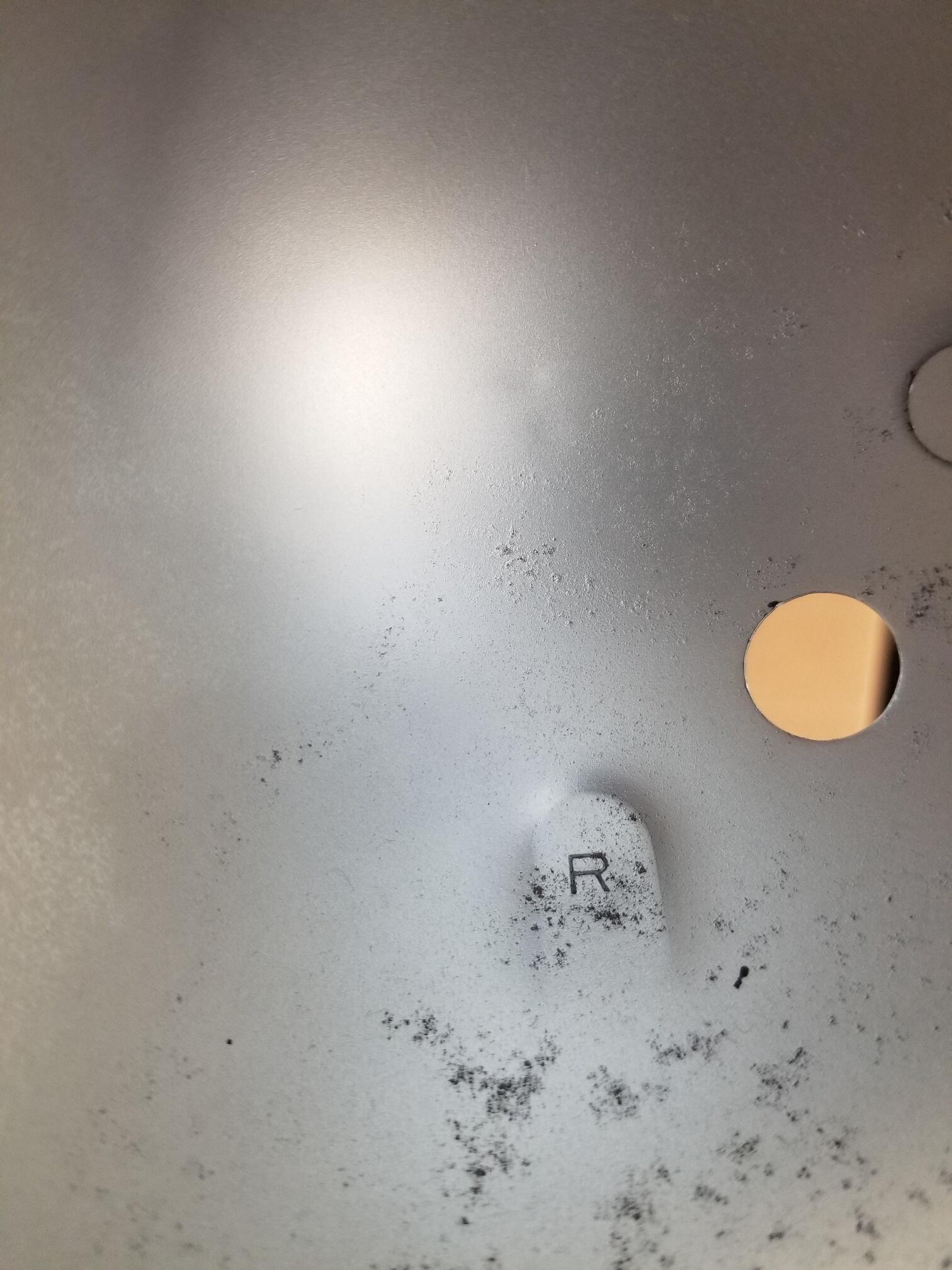

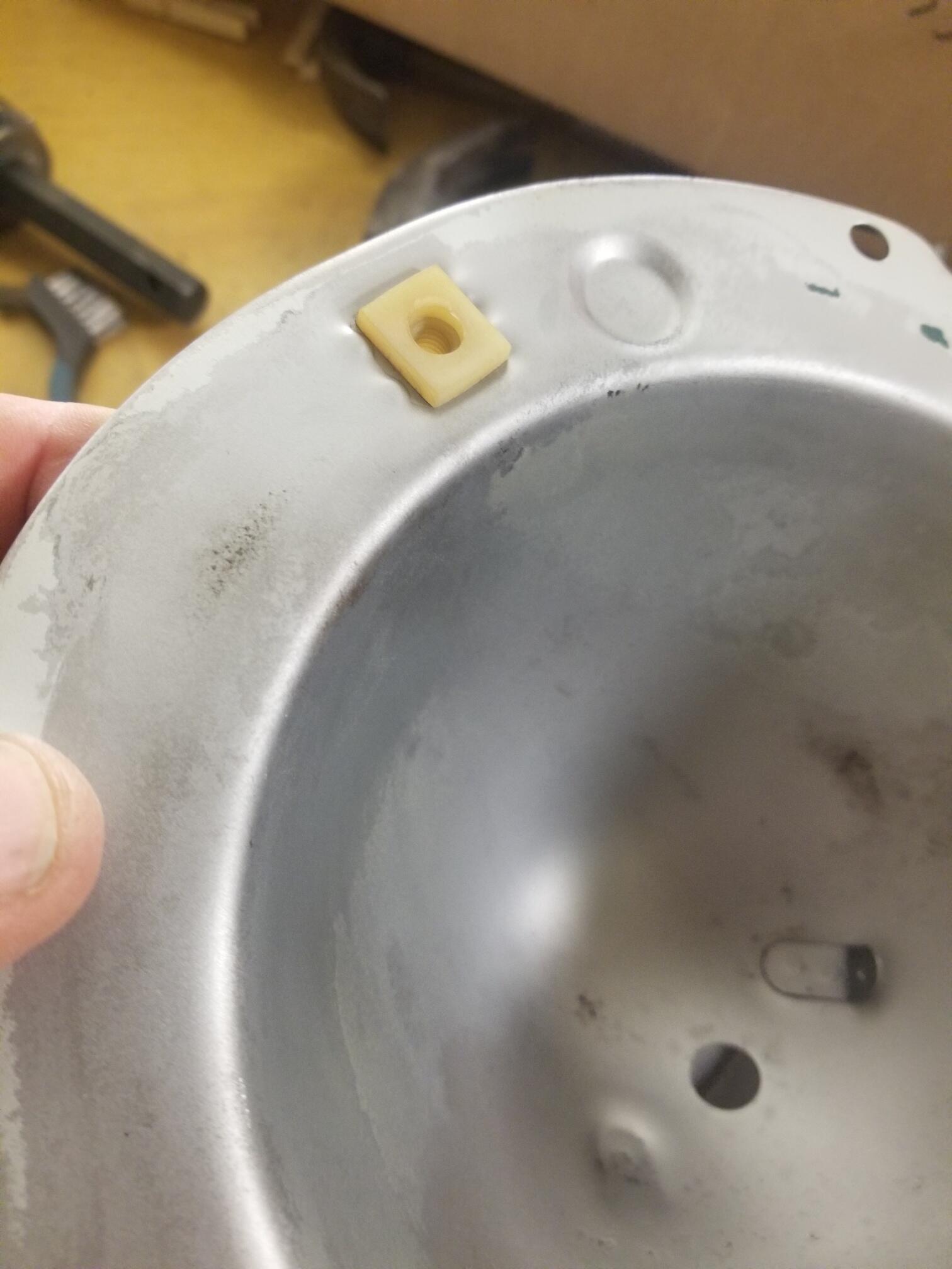

The buckets themselves look like they are probably all the same stamping. They clock them 180d out to make L and R side buckets. Then the spring tab gets added, which covers the R or L stamping location
The headlights buckets have the exact same part numbers no matter L or R
The lamp rings are made for either the left or right side
