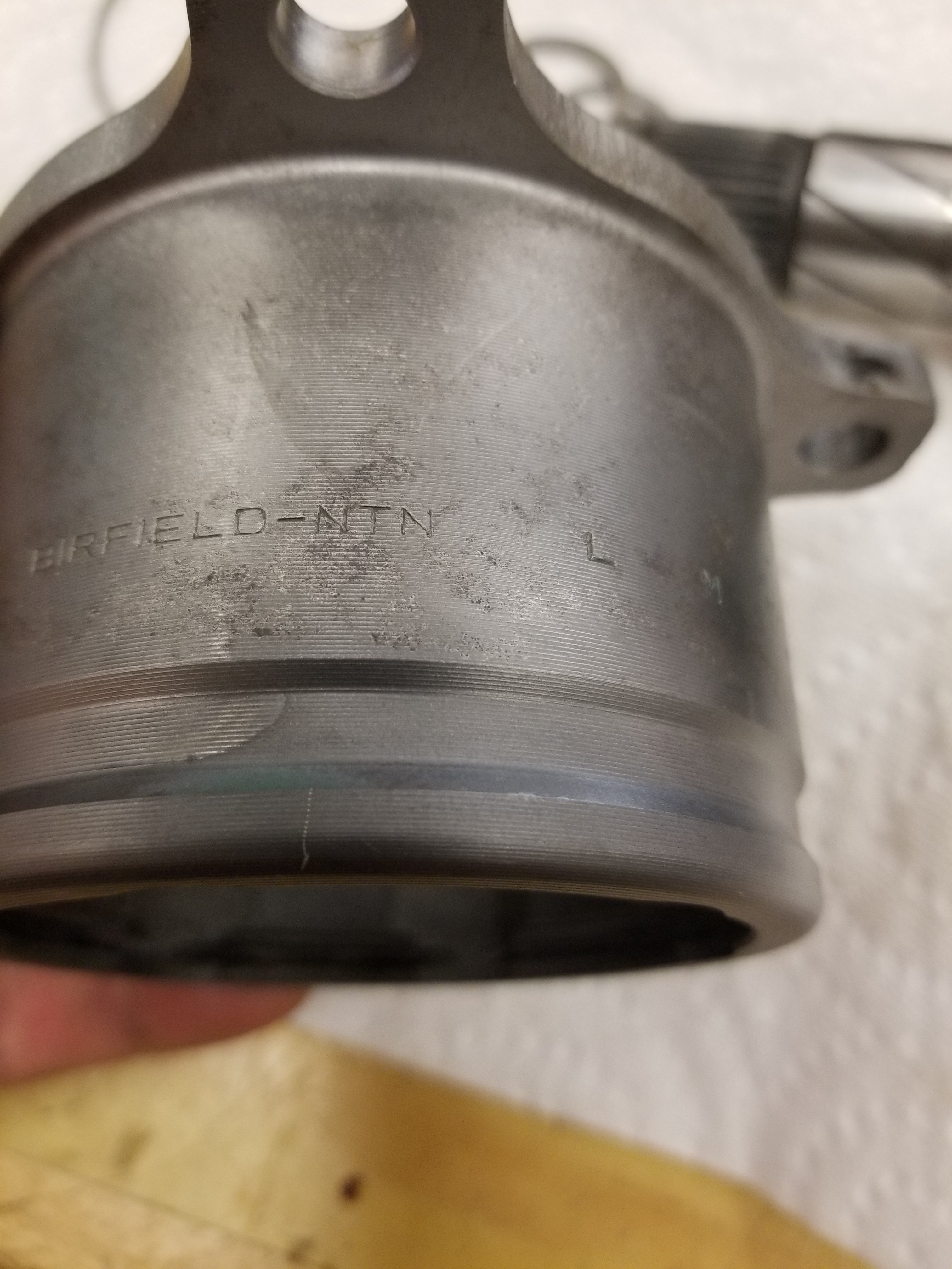

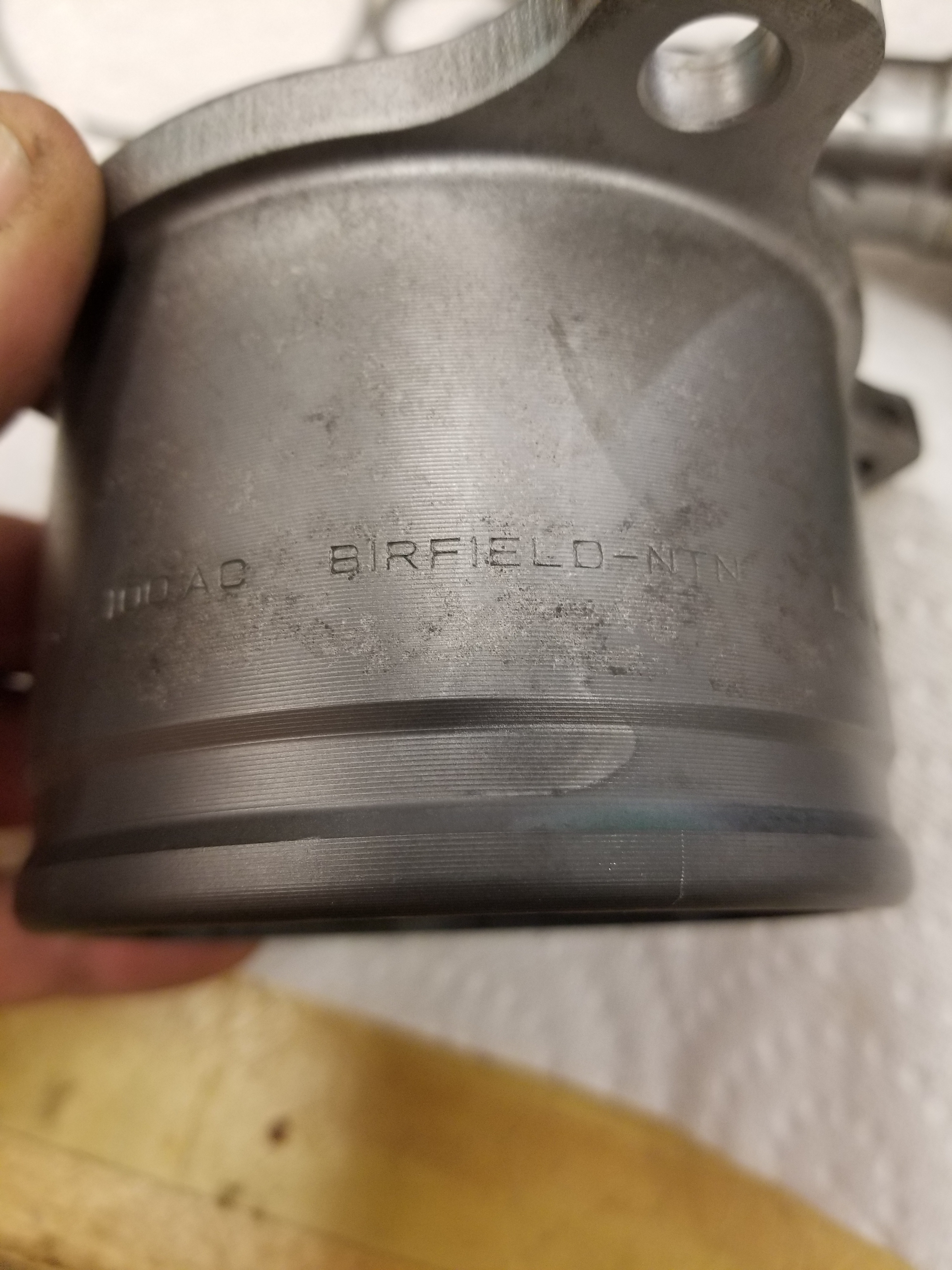

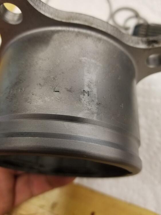

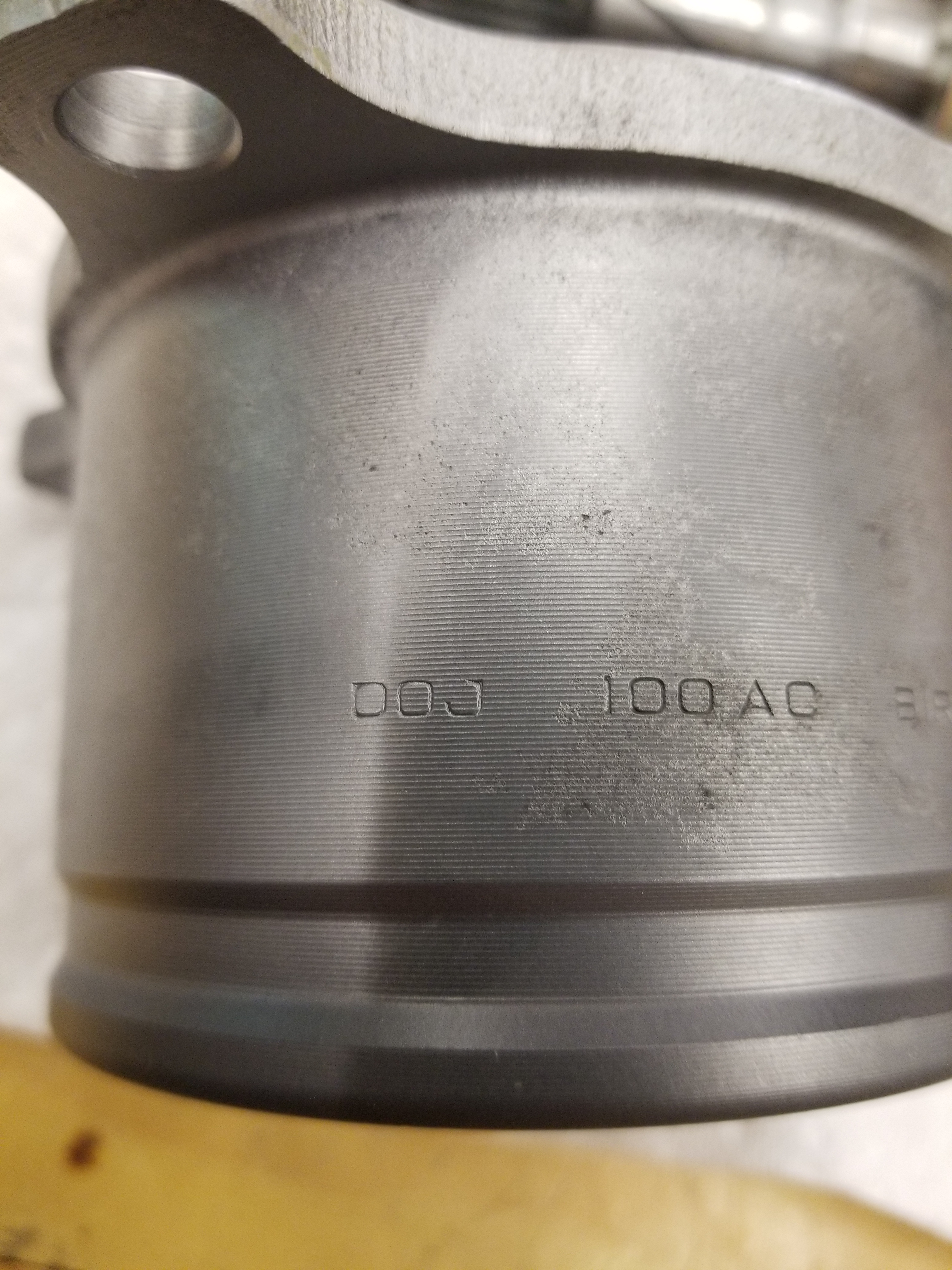

July 25, 20214 yr Author comment_625705 624 days since a post!!! Pffttt! Depressing... Any way the car is still out of the shop and covered up and the Goon is occupying premium space but I did tinker a little today. I pulled together about 20#'s of metal to go to the platers. It's an experiment. I did very little prep work other than degreasing. We'll see what I get back. I also worked on one of the Cv axle halfshafts for the CLSD rear end. It's been sitting on my bench for almost 2 years. I found these numbers on the hub. Might be useful or cross-referenceable Link to comment https://www.classiczcars.com/forums/topic/55369-1971-hls30-14938-lily-build/?&page=36#findComment-625705 Share on other sites More sharing options...

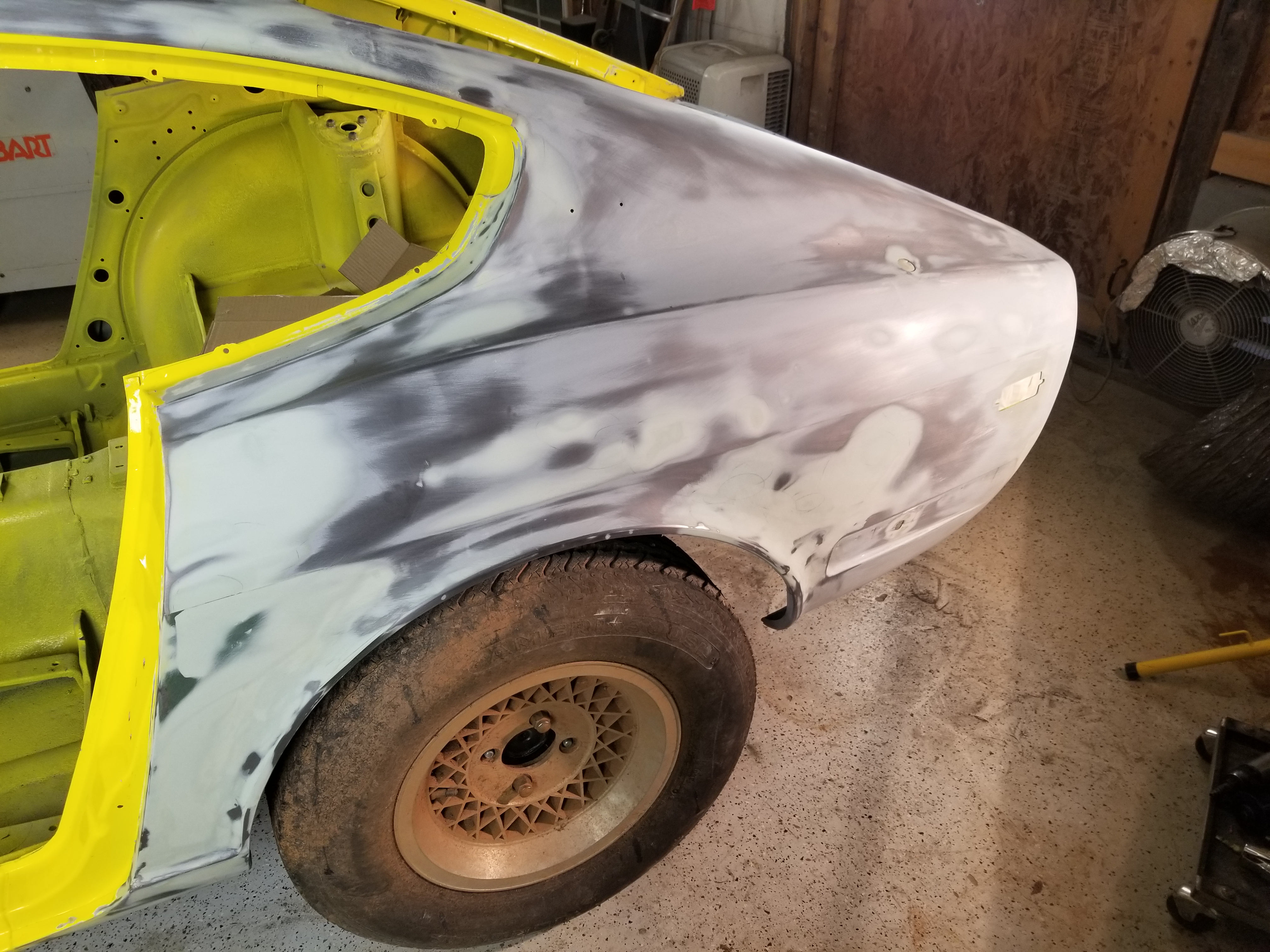

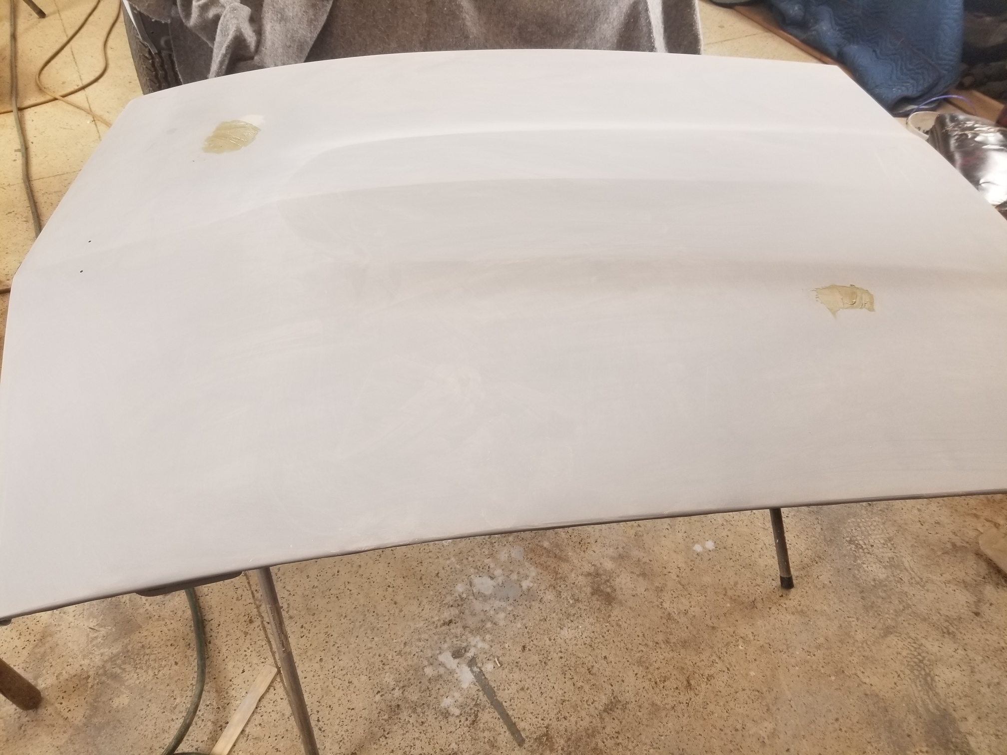

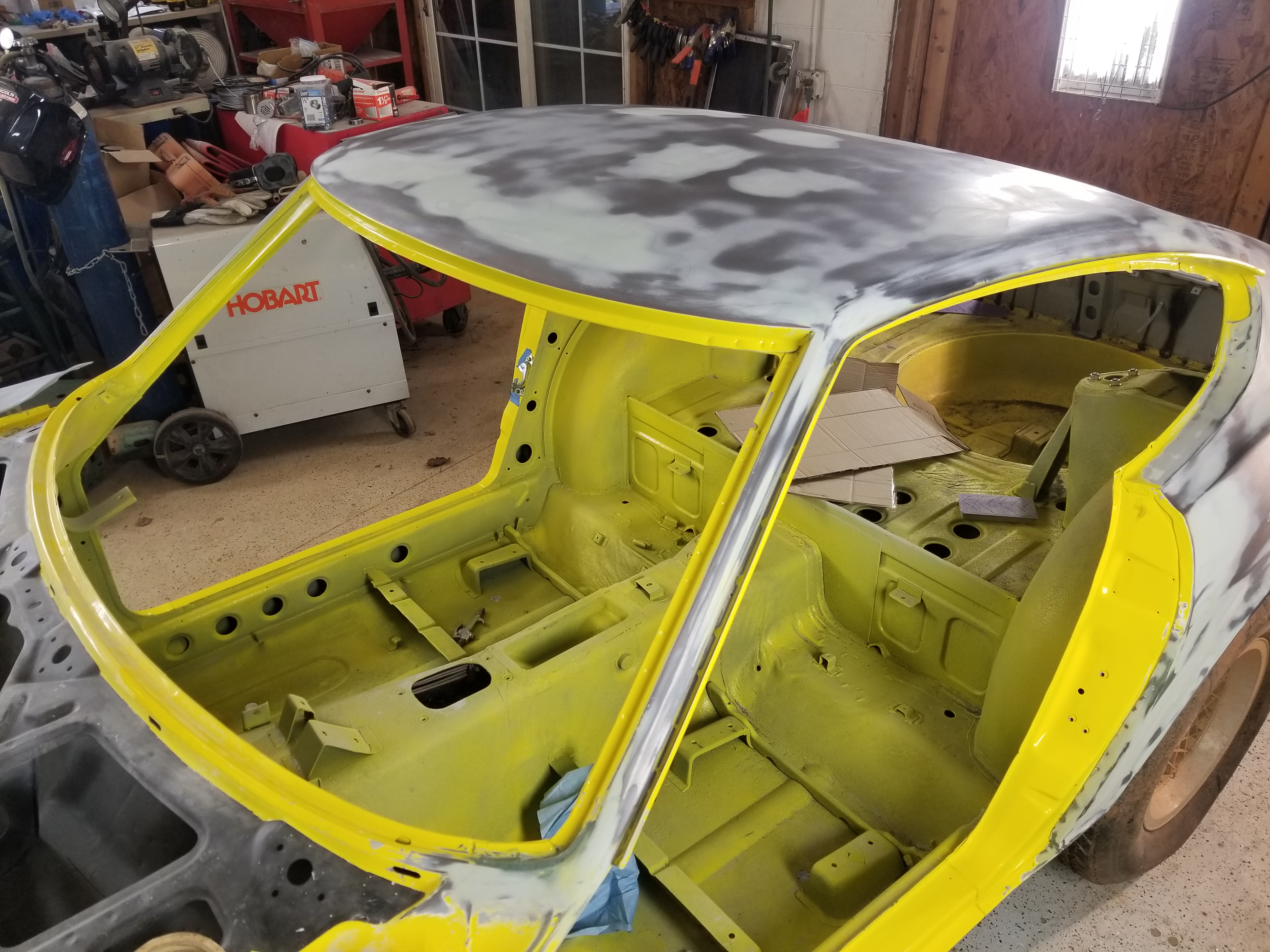

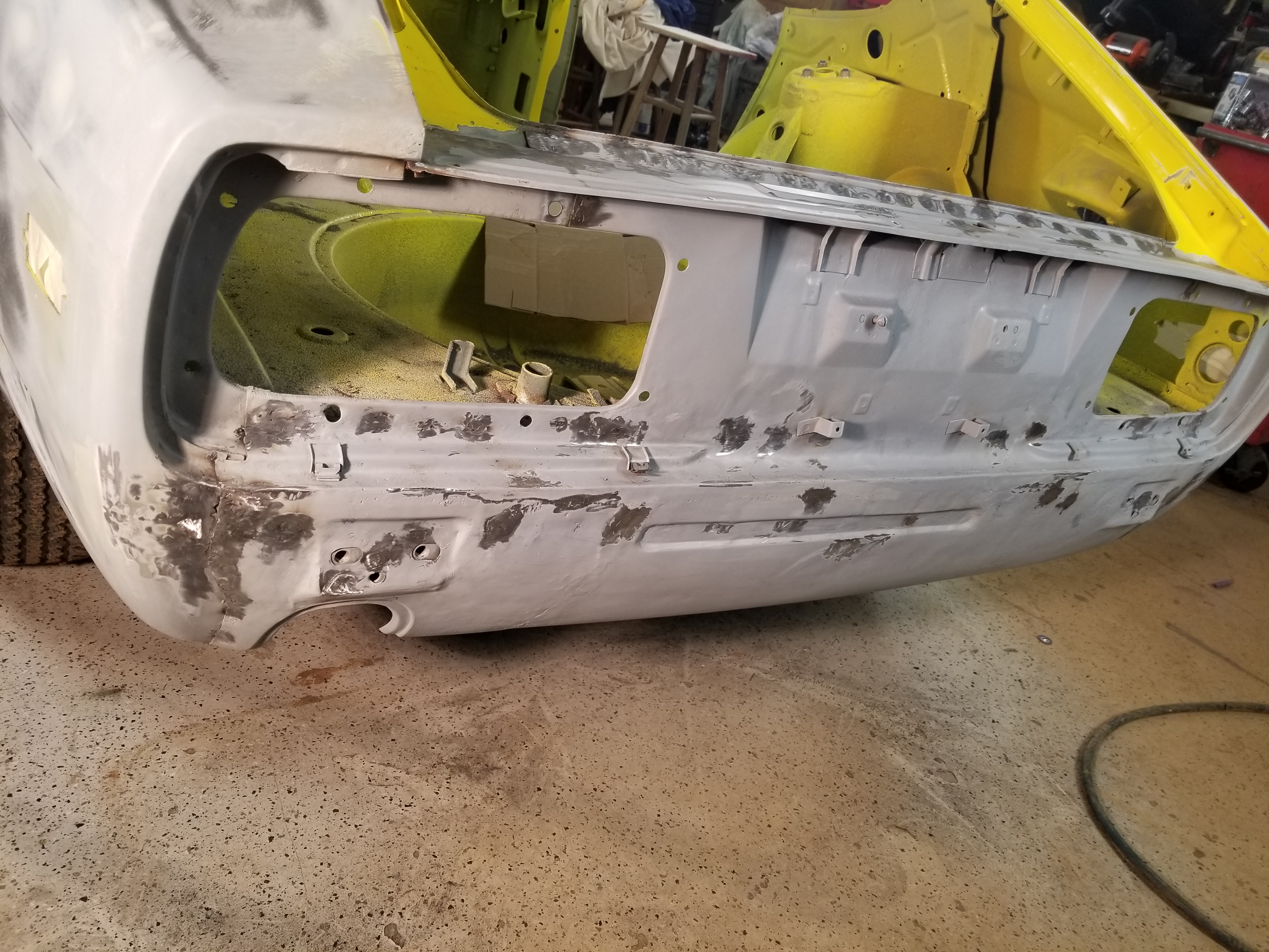

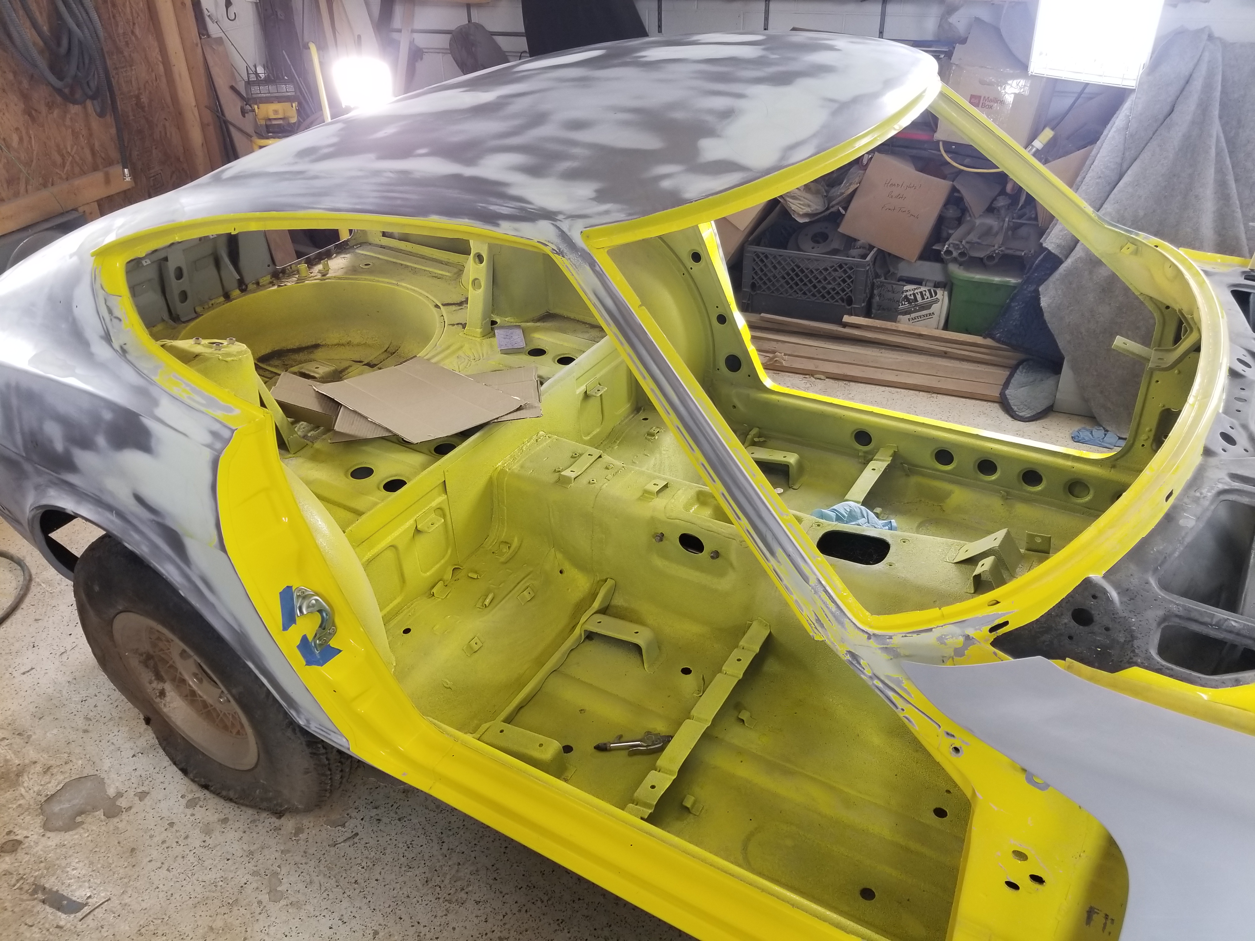

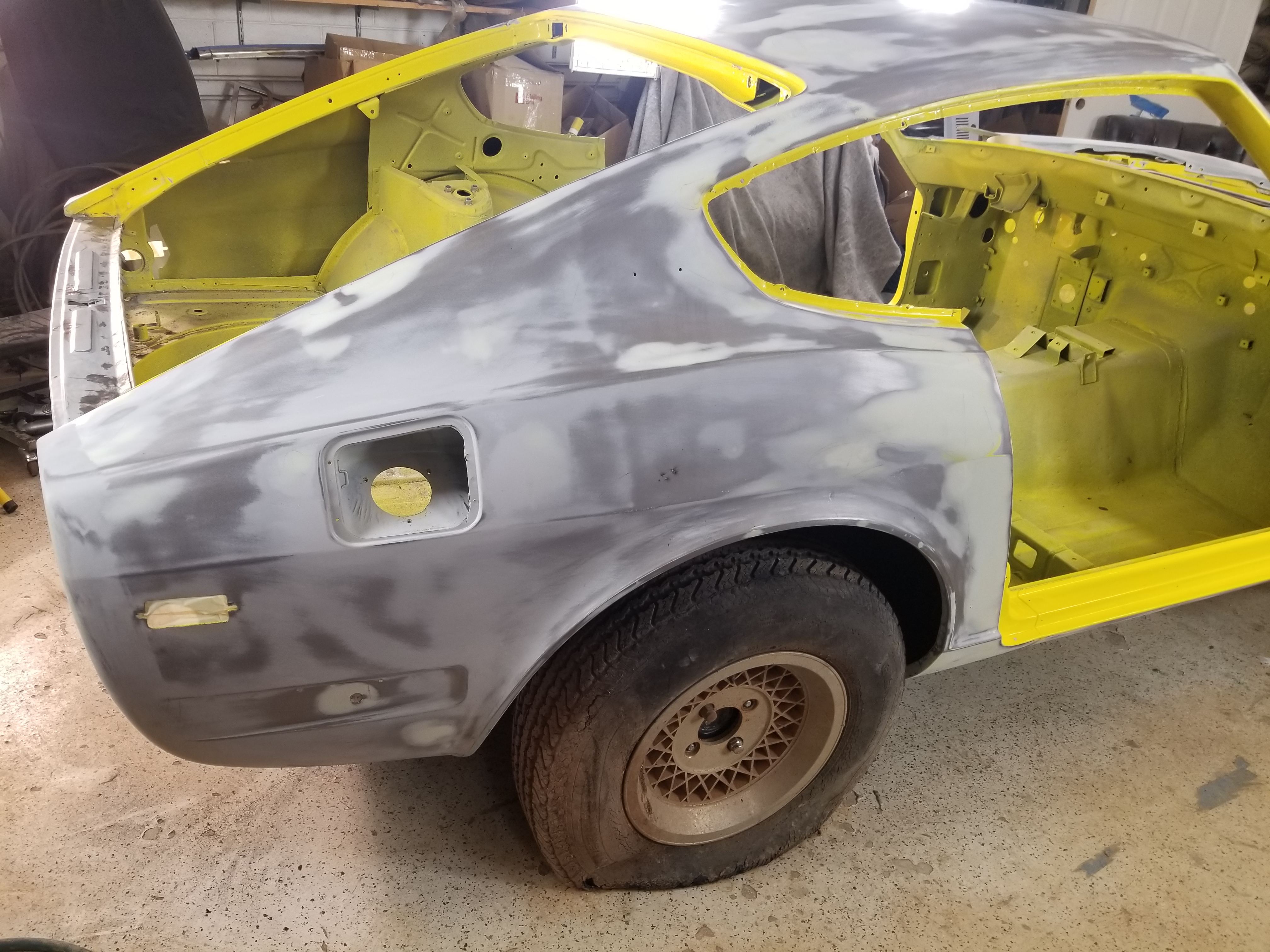

October 30, 20213 yr Author Popular Post comment_630719 Blocking panels and wet sanding to 600 grit I have a number of them ready for color. Most of them were pretty close to ready before I got pushed out of the shop by the Goon a while back. I may roll the chassis outside tomorrow and shoot some epoxy on it. We'll see Link to comment https://www.classiczcars.com/forums/topic/55369-1971-hls30-14938-lily-build/?&page=36#findComment-630719 Share on other sites More sharing options...

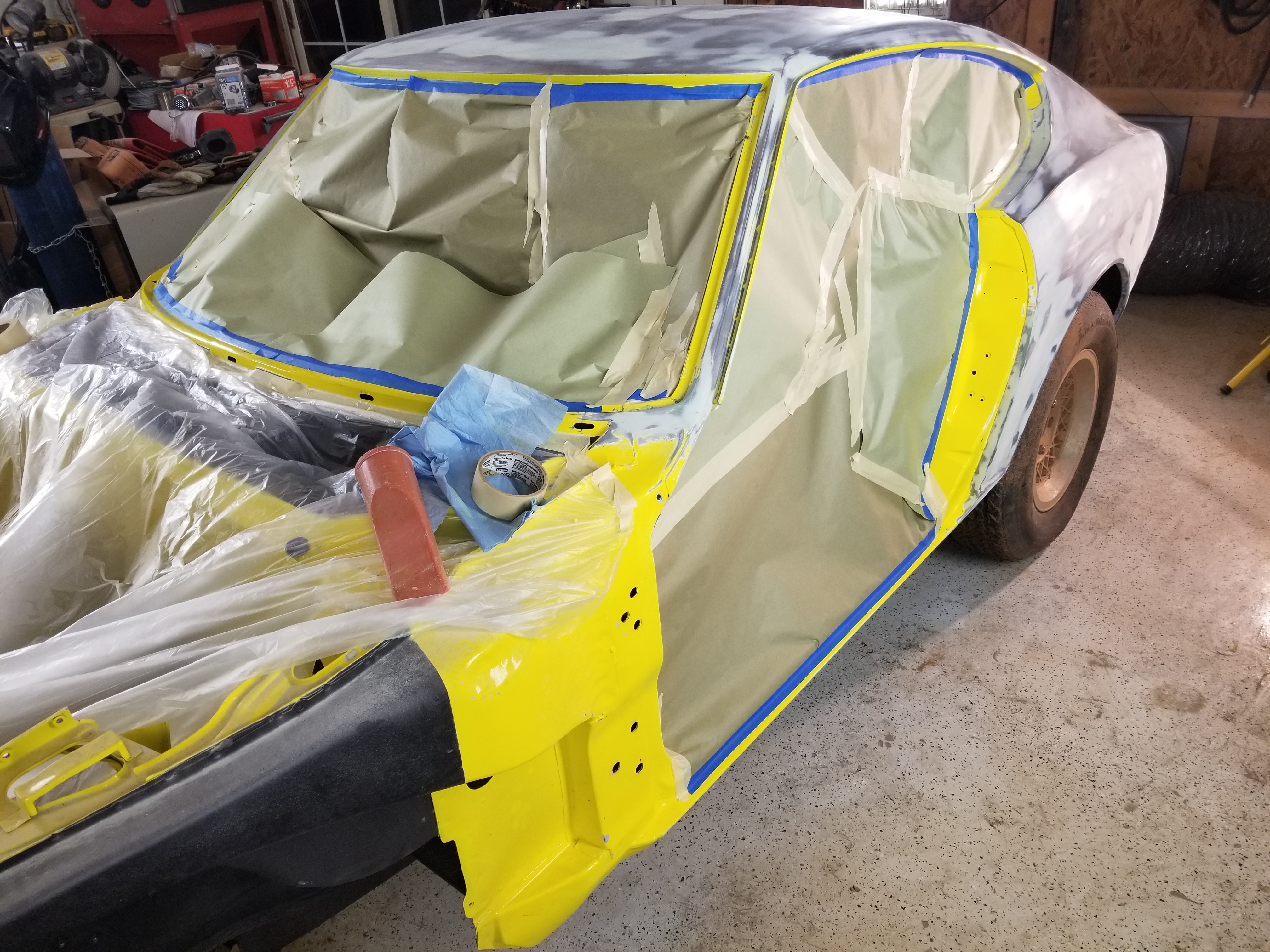

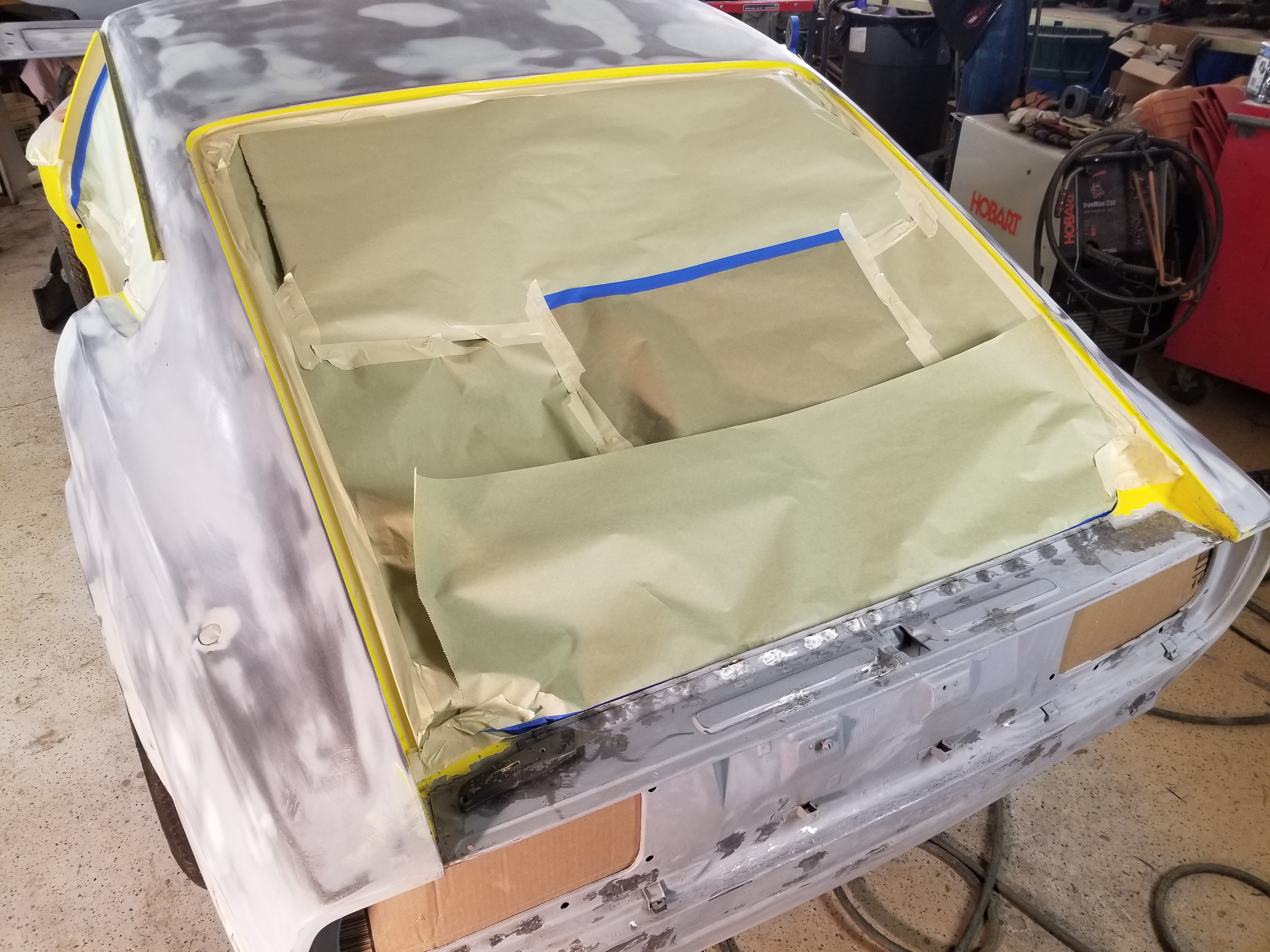

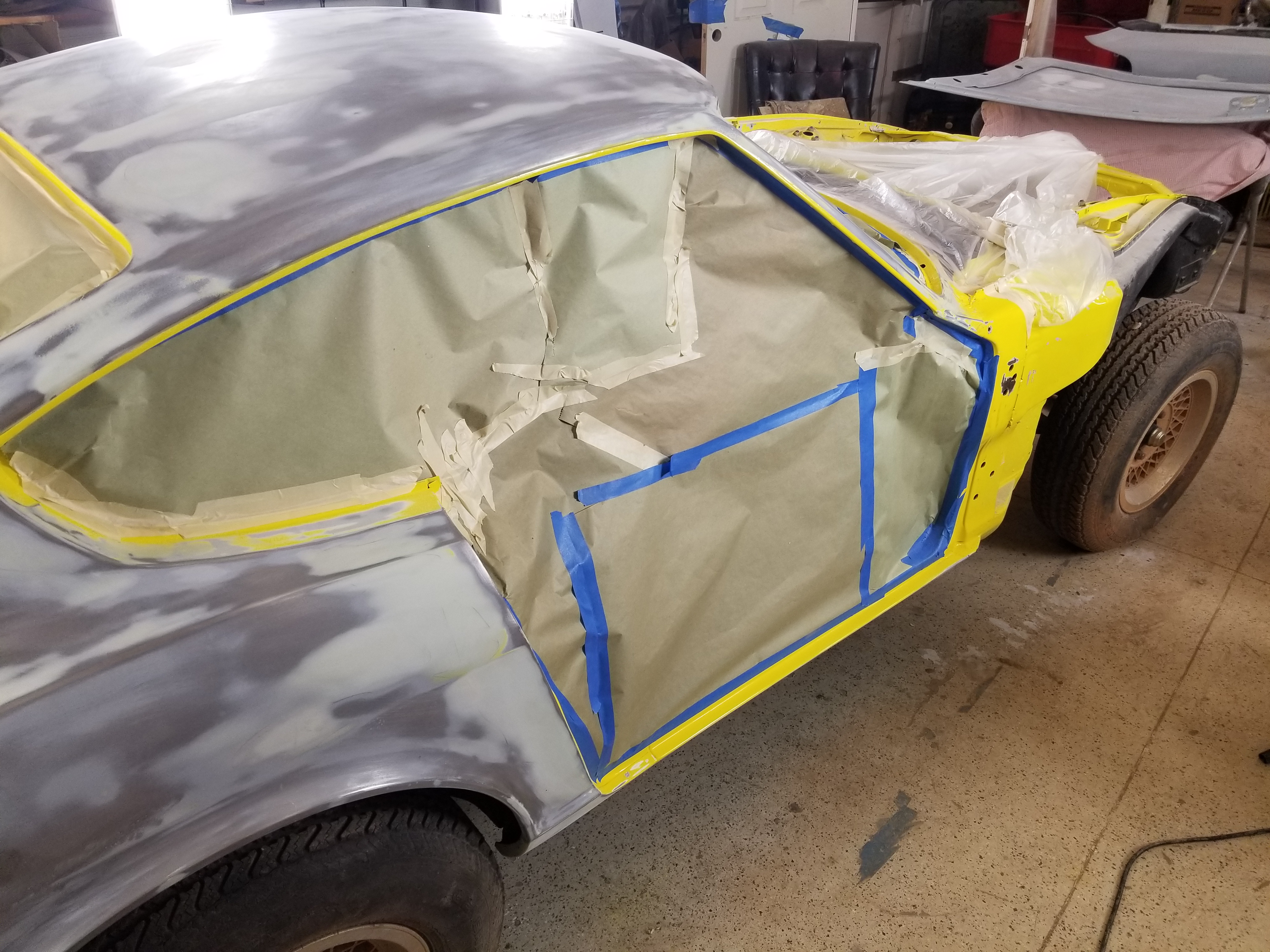

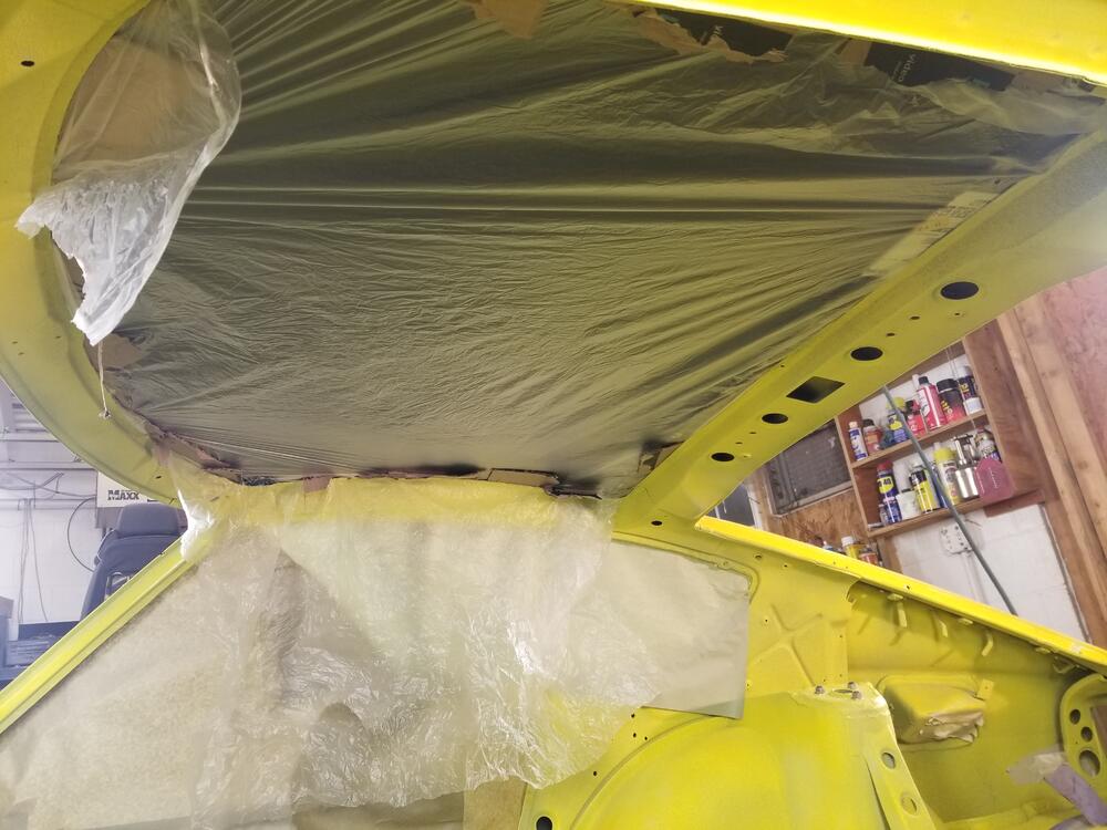

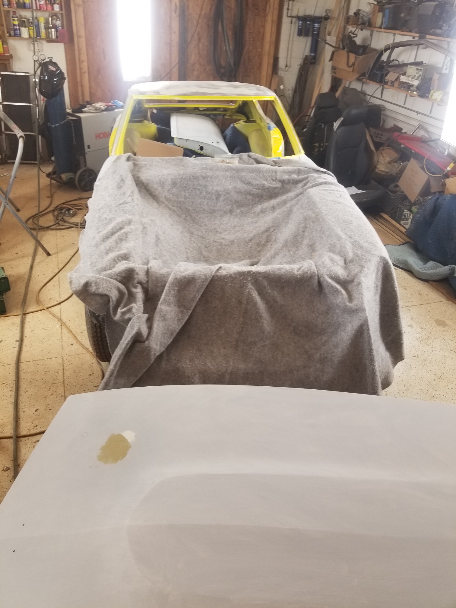

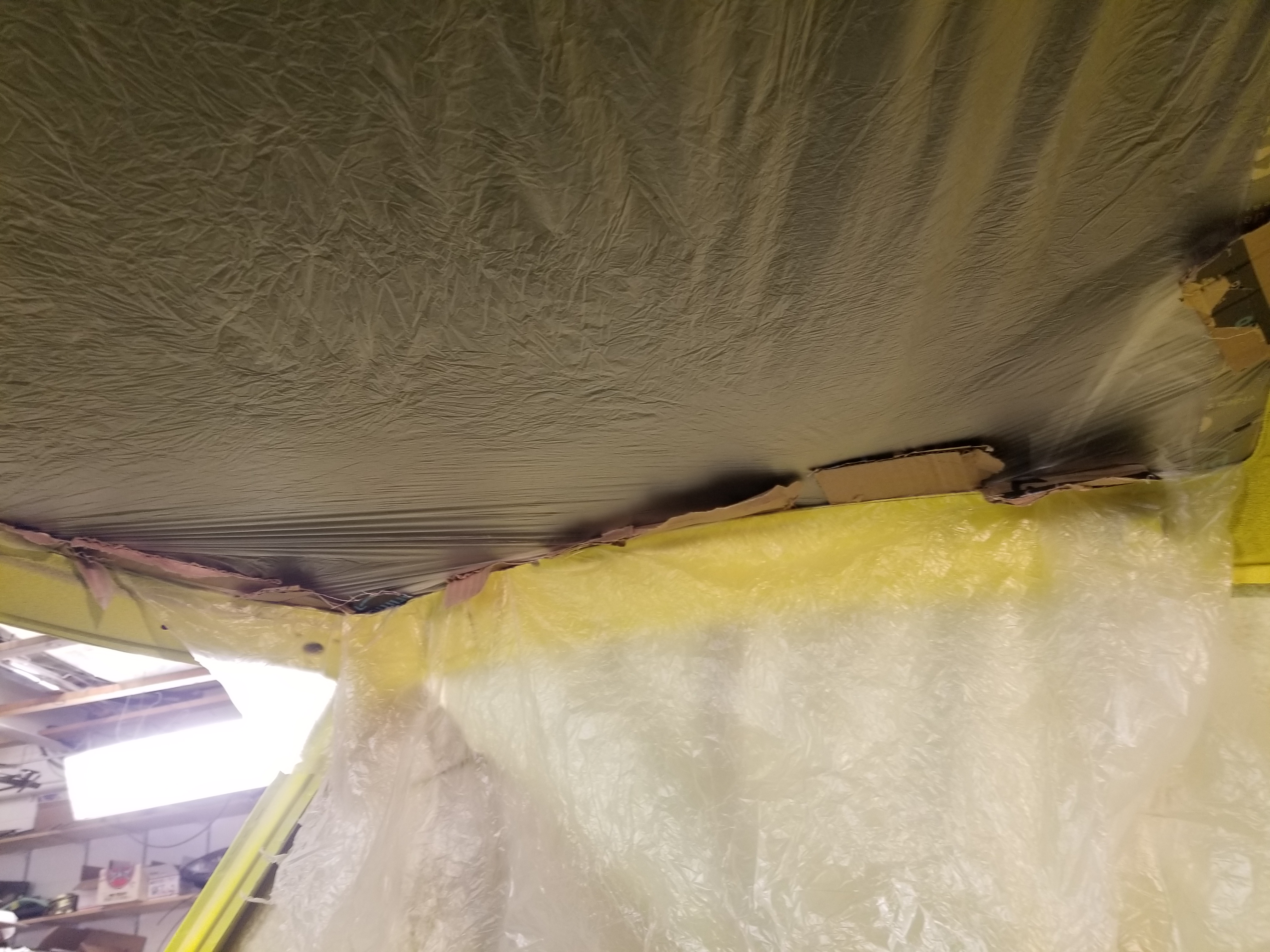

November 7, 20213 yr Author comment_631154 So brought the car inside and cleaned it up. Used some Ospho on it. Then a couple of days later I sanded it all with 320 on a DA. So I realized that I might get some over spray on the headliner, which I installed while it was on the rotisserie. Then got it wrapped up So all wrapped up and was going to spray some epoxy but the idiot running the shop forgot to check if we had some!! Link to comment https://www.classiczcars.com/forums/topic/55369-1971-hls30-14938-lily-build/?&page=36#findComment-631154 Share on other sites More sharing options...

November 8, 20213 yr Author comment_631168 Wish I could sometimes! Me, myself and I are the only three working on this thing 😉 As a note, I jambed out the car with single stage but after ruminating on it for a while decided it would be easier to finish paint if I included portions of the hatch area and door jambs in my final paint. It makes it easier to tape up and not have a noticeable start / stop point Link to comment https://www.classiczcars.com/forums/topic/55369-1971-hls30-14938-lily-build/?&page=36#findComment-631168 Share on other sites More sharing options...

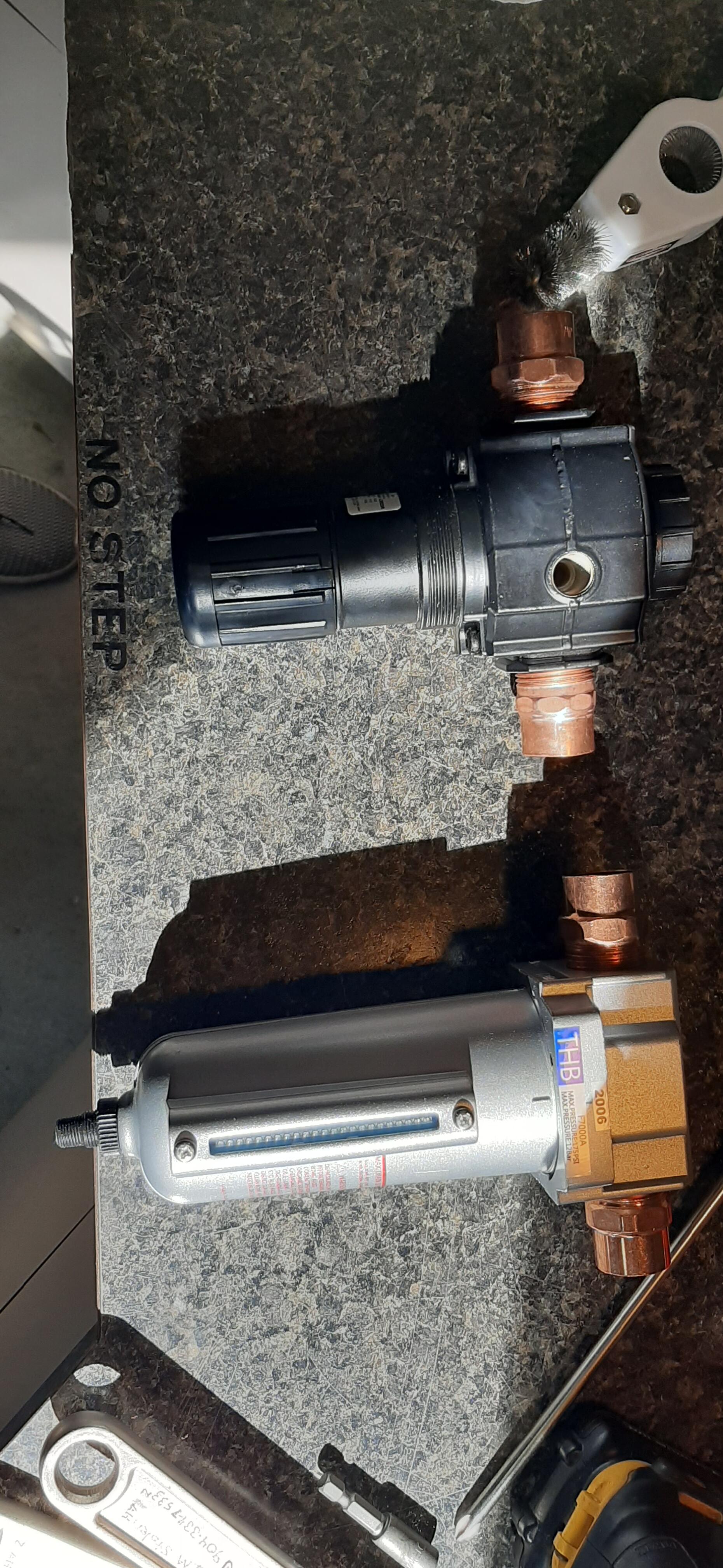

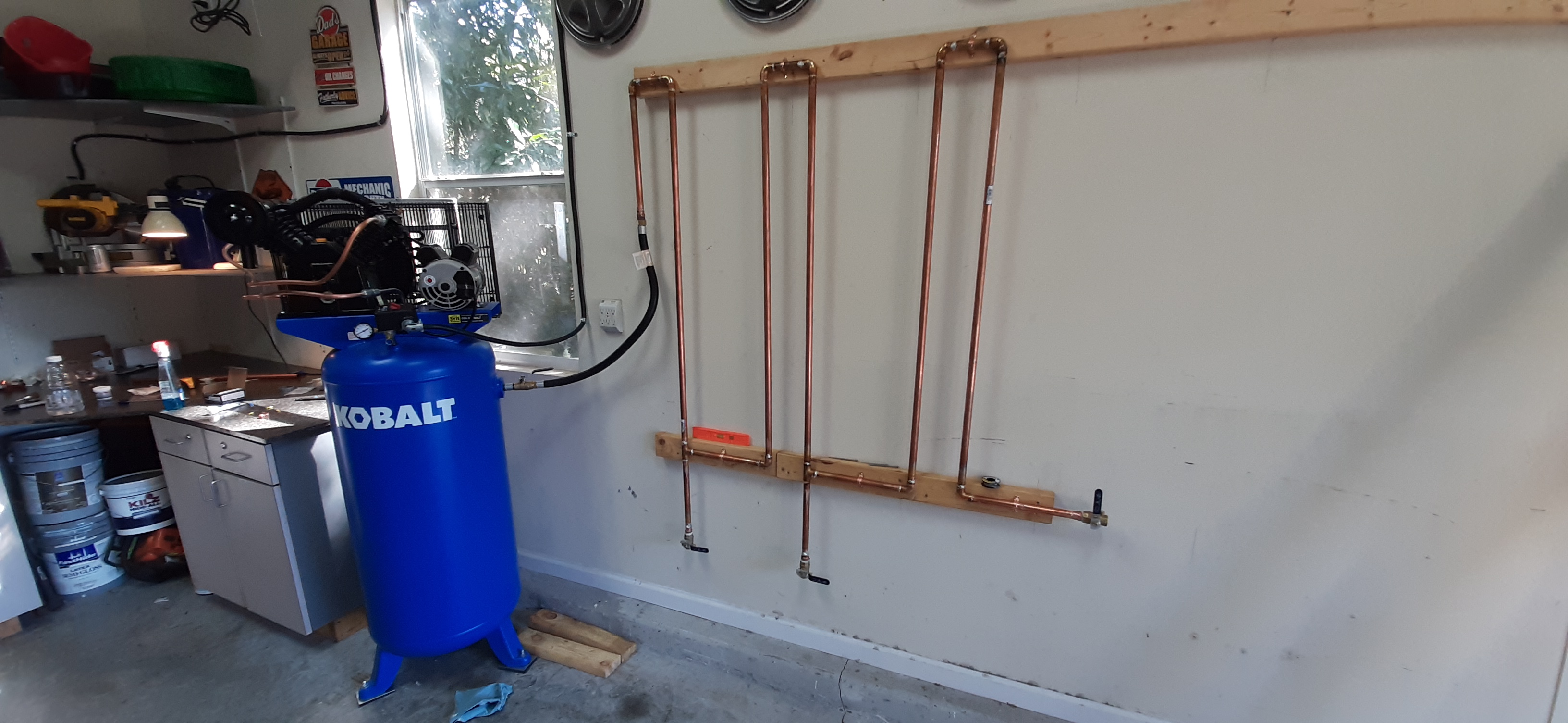

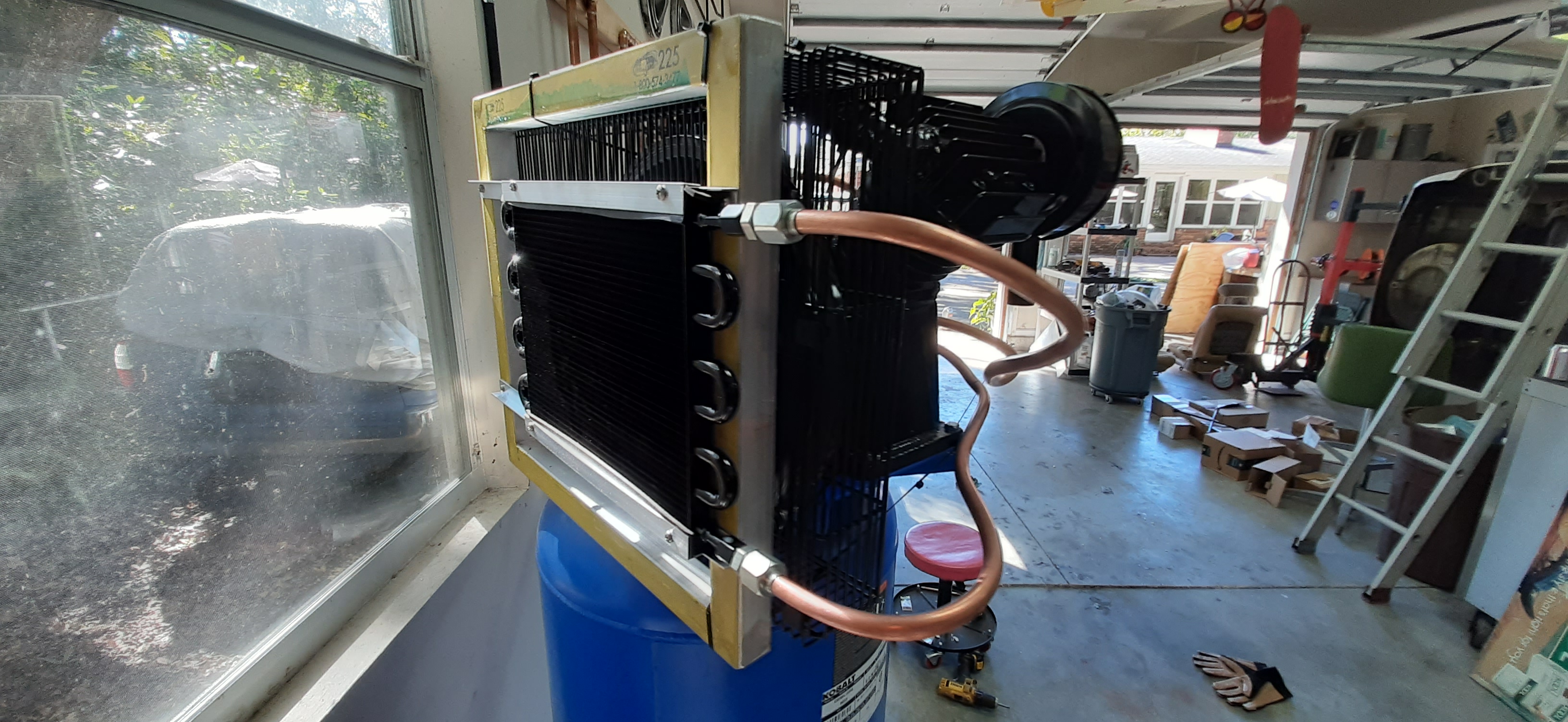

November 8, 20213 yr comment_631178 3 hours ago, Patcon said: Wish I could sometimes! Me, myself and I are the only three working on this thing 😉 As a note, I jambed out the car with single stage but after ruminating on it for a while decided it would be easier to finish paint if I included portions of the hatch area and door jambs in my final paint. It makes it easier to tape up and not have a noticeable start / stop point Can you share a pic or two of your paint setup? Shop air, dryers, etc? I rigged up a transmission cooler on the fan of my compressor, it brings 300* air down to about 70* before entering tank. I want to believe that it reduces the amount of condensation in the tank, although I still drain some out of it. Edited November 8, 20213 yr by DC871F Link to comment https://www.classiczcars.com/forums/topic/55369-1971-hls30-14938-lily-build/?&page=36#findComment-631178 Share on other sites More sharing options...
