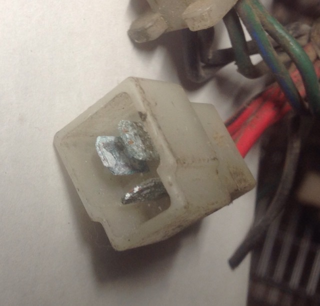

So I find myself building a headlight relay upgrade harness for the 71 project car I'm working on. I've been making my own for a long time, can't justify the $158 USD cost of buying one from MSA. Especially with the exchange rate the way it is.

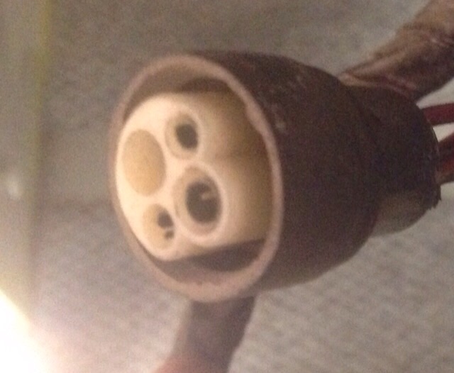

While building this one, it reminded me that a friend had asked me to build him one for his '76 280 last fall, so I thought I should do two at once and save a bit of time. Then I remembered the "detail" that makes the 280Z harnesses a royal pain. There are no sources for the round 4 pin weatherproof connectors that the 280's use to make the harness plug and play. You are forced to hack into the harness or replace the plugs with 240 style plugs (not simple, and removes important weatherproofing). Yuch!  Can't just hand him the harness and say "go plug it in". Has to come in and get it "wired in".

So naturally I started doing a bit of research trying to find a solution. It's not simple. Those round weatherproof plugs and pins are just not out there to just go and buy at any price.

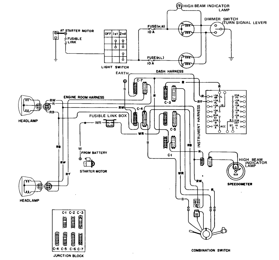

I can't remember the details but I think that the 240Z and the 280Z use different methods for powering the head lights.  The dimmer system is different I believe.  Dave Irwin wrote a few posts about how a 280Z relay setup would be more difficult than the 240Z setup, if I recall right.  I think that he offered but didn't get a bunch of takers.
I've looked at mine and I think that you would need three relays - one for power to the lights, and one each for the grounding of each filament, high beam and low beam.  The extra difficulty, besides the fact that 280Z lights don't seem to be as bad as the 240Z lights might be the reason Dave and nobody else has put one together.  Plus the fact that Dave Irwin has a 240Z, not a 280Z.
I put a single relay on the power supply side for my 280Z, and find that the grounds in the dimmer switch don't really need any help.  So, one relay in front of the fuse box takes the load off of the switch on the column, and the dimmer switch doesn't have much resistance to worry about.
The running lights are a different story, I had to dig up in the harness to find the power supply wire to get a relay installed there.  Those are the two contacts on the 280Z column that get hot and pitted, the running lights and the headlights.
Anyway, if you search back through Dave Irwin posts and check the 280Z diagrams you might change your mind.  Or decide to go for it.
I don't see any difference in how the 240 or 280 circuits work. The HL switch on the combo turns on power to the pair of fuses in the fuse box (L and R), which then power the common terminal of each head light through the R and RY wires. Then the dimmer switch grounds either the High or Low beam side to decide which is on at any time.  The only true difference is the dedicated HL fusible link on the 280z.
The only slight year related difference is in the early 70-71 switch where the HL combo switch acts on the GROUND side of the circuit, at the center common line to the dimmer switch, while the battery + side power is hardwired to the two fuses in the fuse box.  The dimmer still grounds either the HB or LB side of the head lights. Even the harness wire color codes out to the head lights stay the same across all years. I'm pretty sure the early issues were totally about the lack of connector availability.
While there other ways to approach this problem, including the one you mention to just put a relay at the HL combo switch contacts, Dave's harness that puts the relays way out at the headlight connectors, and moves the power supply directly to the battery, is the best overall solution for one very important reason.
It removes high current requirement (and the resulting voltage drops and heat buildups and failures) from ALL switch AND harness connections AND fuse box fuses areas in one fell swoop. All components (switches, fuses, connectors) are reduced to relay trigger level power levels, which even the worst condition stuff is capable of handling. The only areas the user has to improve, clean or replace might be the pin contacts at the head light connectors where the new harness splices in.

Maybe it's just the connection points then.  Found some of your old posts on the subject.

It "could" work just fine with the 280's as well, but the problem is with the new round, 4 pin (only three are used) weather proof connectors on the 280's. No one (including Dave) has found the plugs to build the head light harness to connect in at that spot. This is why I have seen discussion about putting the relays into the harness at the combo switch. But as you mention, there are differences in the plugs across the years at the switches.
