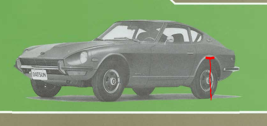

Ok Tonights experiment.  I placed the jack in front of the rear passenger tire and jacked up the body until it was level between the strut towers in the rear hatchback.  I measured the same distance from the fenders to the floor.  There was still an inch difference between tire clearance and the fenders.  All tires still on the ground.
What is the difference between the top of the fender wells on each side, with the strut towers level?  We're trying to figure out if the body is square/level/copacetic with the strut towers.
Have you confirmed that the tires are the same diameter?  Fully inflated?  Sorry, just can't see these things that are probably obvious if the car is right in front of you.  Just missing a key point or two.
If the car is level across the strut towers and the wheel arches both measure 25 1/4" to the floor on both sides, the problem is somewhere else.
Recheck the spring locations like Rossiz suggests and check springs lengths at the same time like Chuck suggested. You're getting closer...
25-1/4" to the floor.  Both sides the same when the strut towers are leveled up.
This is a what you wanted.  A good thing.  The steel-box of a body appears to be in good shape.  The problem will be in a part or parts that can be unbolted and replaced.
